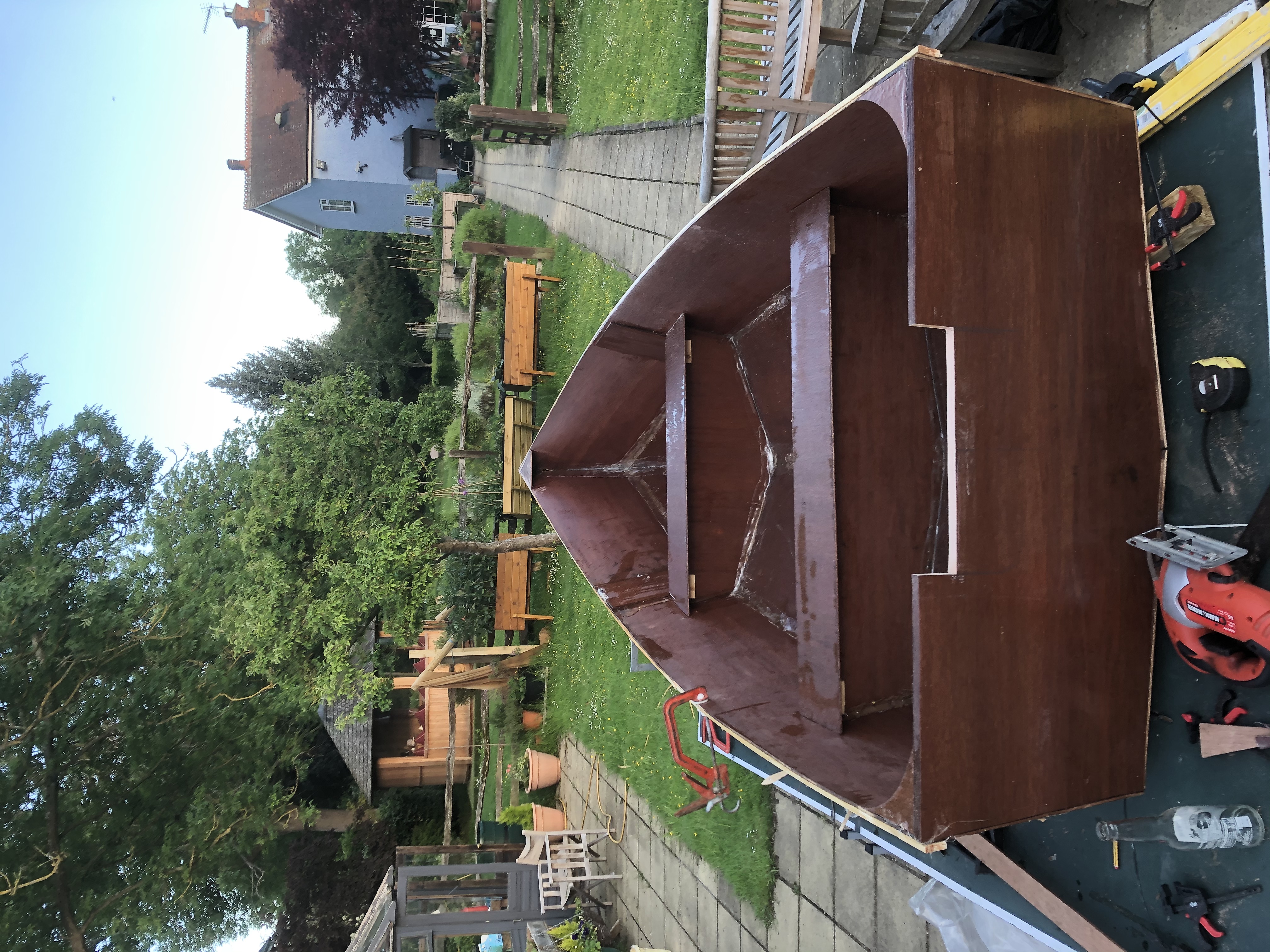

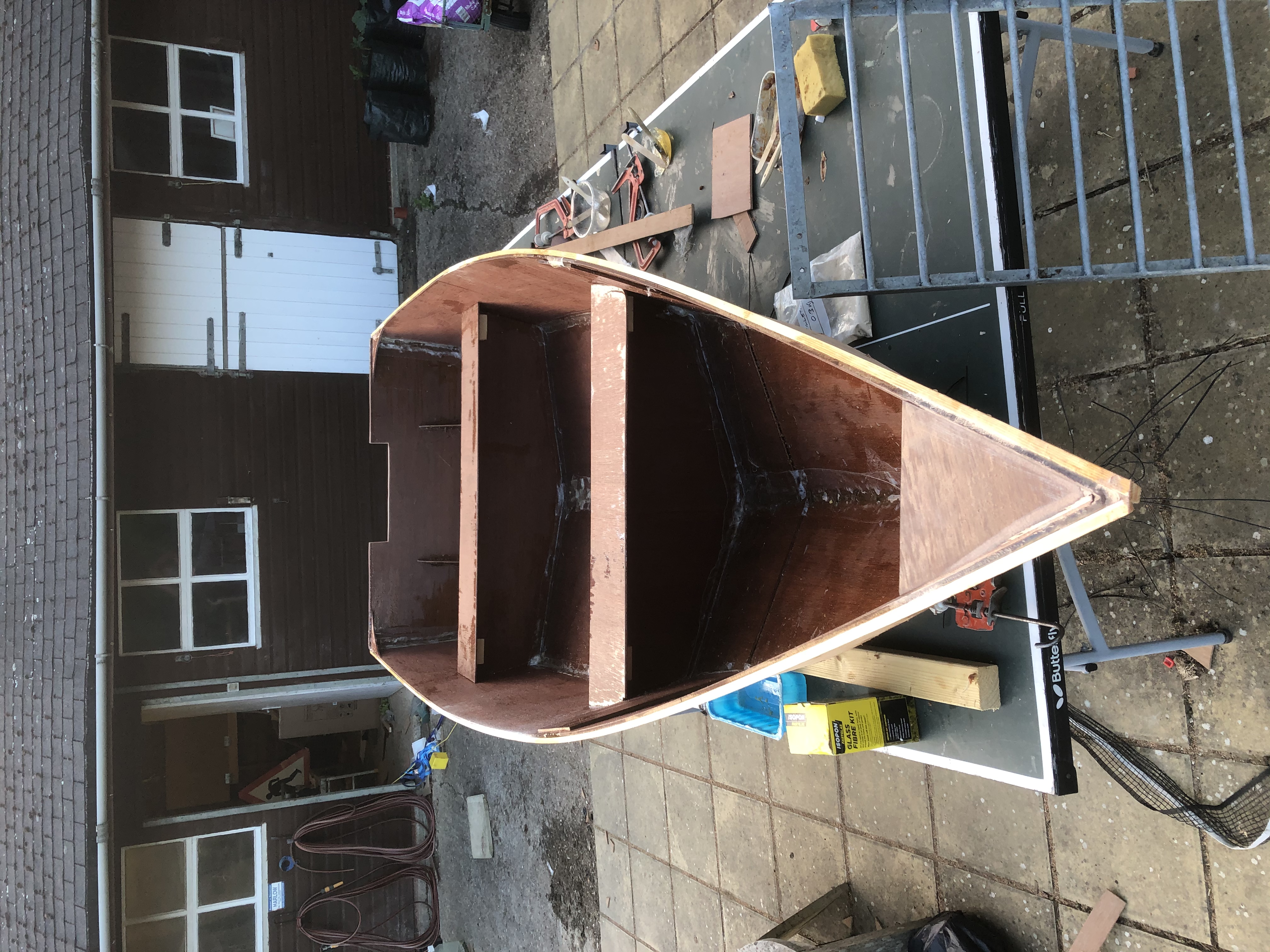

Thought I would start a thread detailing the boat I’m building at the moment. Schools over, weathers lovely, so seemed like the perfect time. The LOA is 11ft 3 inches, the beam is just under 4ft and the transom height is 15 inches. Drew the plans by looking at lots of other boats and hopefully taking the best bits from all of them. Design criteria was fairly simple, must be car toppable, must be fairly light, and must be cheap. Total cost so far is just under 300 quid, which even for me is not the end of the world. This has included the price of materials, tools and resin, of which I had none of to start. All the tools needed were sourced at the car boot ( jig saw, clamps, sander) so this helped with the cost a lot! I’ll put some pictures below, tonight I’ve just about finished the inside, a couple more bits to do before I flip the hull and start sanding!
I will post more pictures once it’s been painted, and hopefully one of it floating some time in the next couple of weeks.- Collector Inspector

Re: Boat build
We need to see a photo of it upside down. Do you have any planning straights on it?

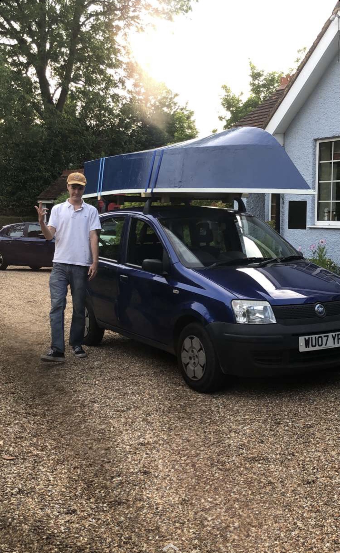

well it’s car toppable and light (32kg), it’s fate will be decided in the Thames tomorrow morning!
Re: Boat build
Nice build! Any more photos of finished product?
How many hours did you put into it if I may ask? And transom, is it 3/4 inch ply? Thinking of a similar size build myself and obviously want to keep it as light as possible.

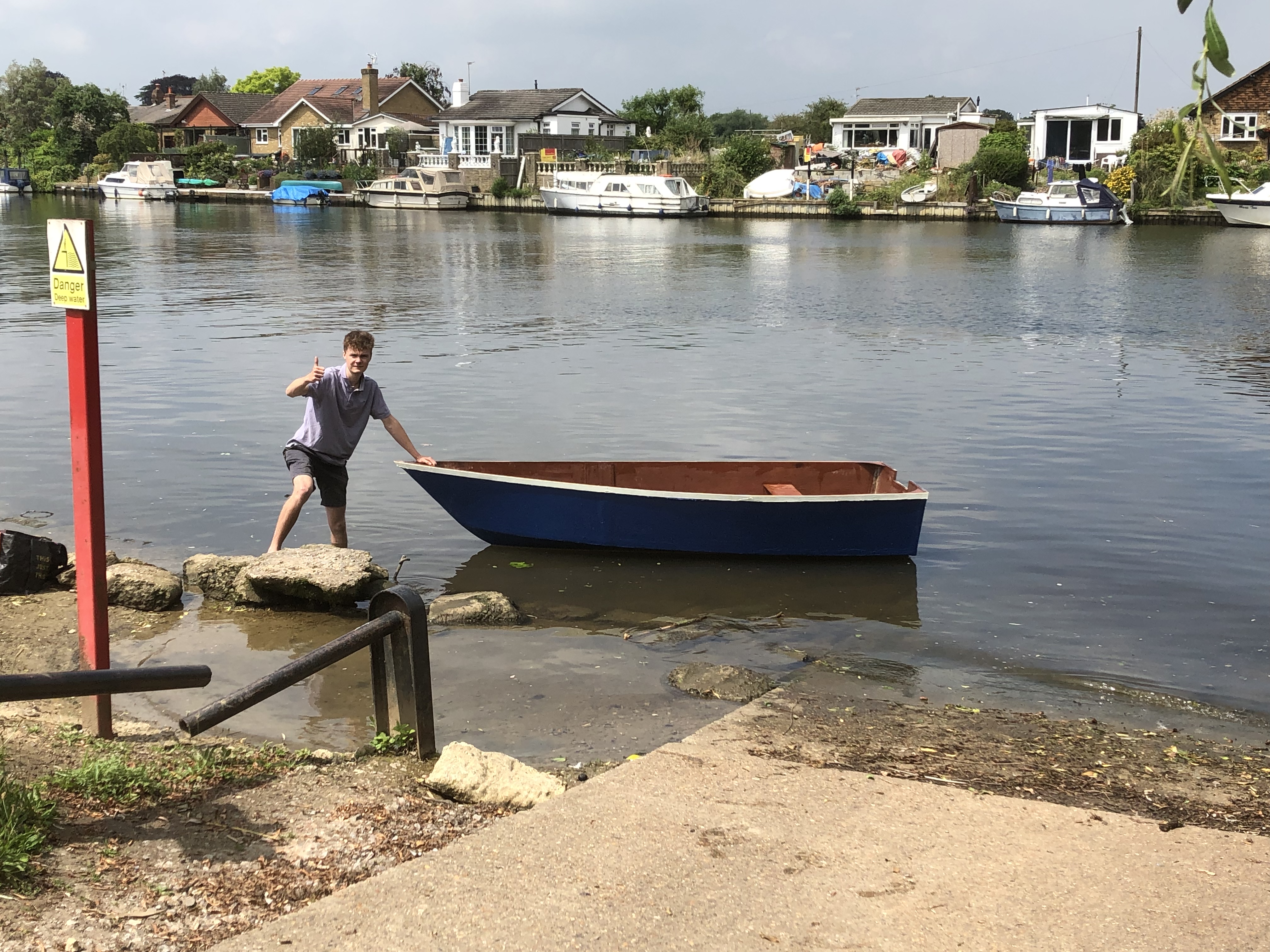

Re: Boat build
Success!

I’ve really enjoyed making it, a month start to finish working a couple of hours here and there when I had time.

Re: Boat build
Well done Ed, it works and looks like it goes well.
