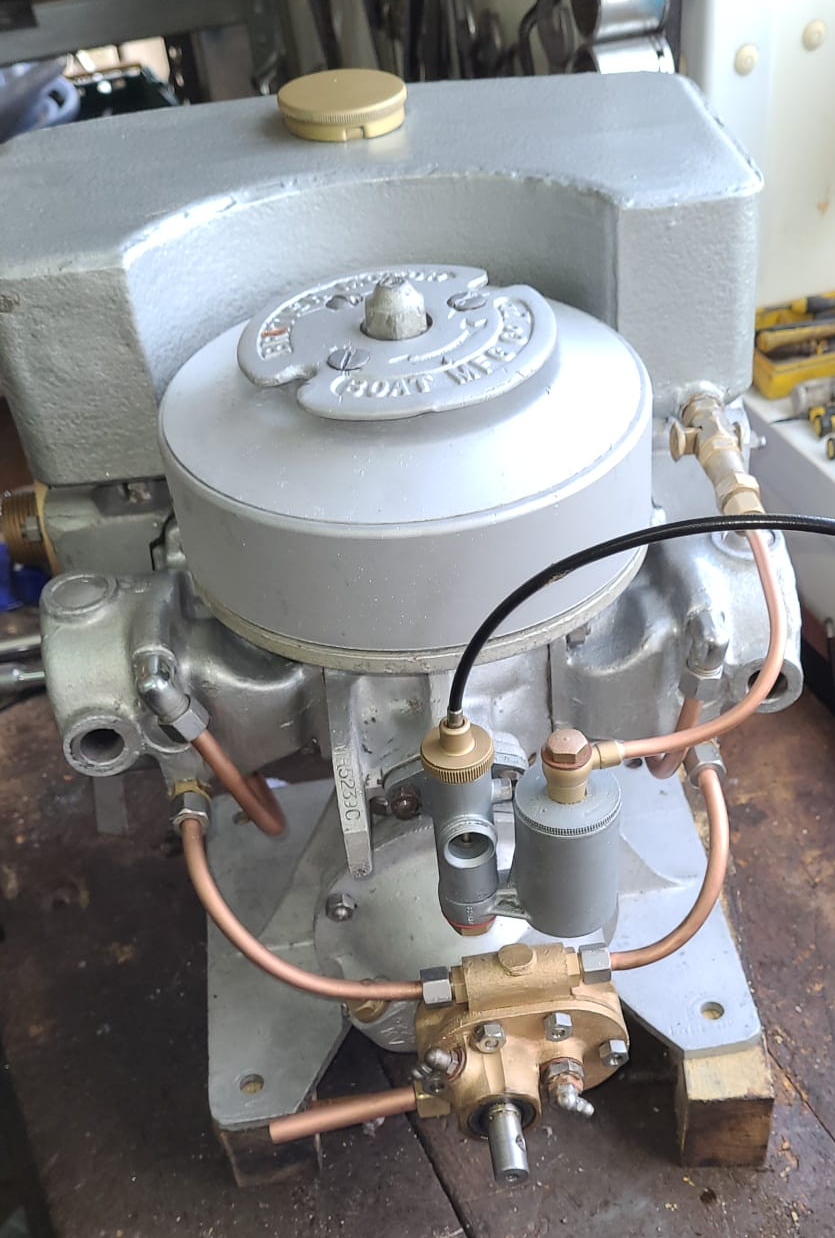

I have just acquired a genuine 'barn find' aluminium 12' boat which I estimate dates from the immediate post-war era. It still has a 1974 river licence disc which I suspect was the last time it got wet!
It's fitted with what I believe is a B.M.B. Mariner inboard with a direct drive coupled to a shaft and a feathering prop arrangement for selecting forward/reverse. The tiller is a curious, side-mounted arm that folds down inside the boat when not in use and up to the horizontal to provide a 'push for port, pull for stbd' steering arrangement.
After reading some very informative threads on this forum I've found that I need to get the 'Twin Spark' coil rewound but hopefully that is all that needs doing. The engine turns freely with good compression. I'm tempted to strip the water pump and gearbox but leave the rest of the engine intact as I suspect that I may have trouble sourcing any spares required for a full strip and rebuild.
I must admit I'm intrigued by the design of the 'top end' with no separate cylinder head and the side-mounted spark plugs. Was this a common design or unique to this family of engines I wonder?
A couple of pics attached and I look forward to any replies from others who have come across these engines.

Thanks - I decided to do a full strip and rebuild after all.
Really pleasantly surprised how easily it has come apart so far and a really pretty engine.
A couple of points of interest though.
Opposite the water inlet connection to the water pump there is an adjustable needle valve (pic attached).
The only purpose of this would be to restrict the flow of cooling water - why would that be required? Might the engines run too cold and need the flow reducing to help them run at optimum temperature?
The pistons have no pins to prevent the rings rotating althought the ends of the rings are stepped. Just wondering why?
Thanks,
Bernie

Re: B.M.B. Mariner
Looking quite pretty now. Just waiting for the coil to come back from a rewind and we'll go for the first start since about 1974!
Re: B.M.B. Mariner
Coil back from rewind - we now have sparks!

Re: B.M.B. Mariner
I was hoping to be able to post a video clip of the engine running by now but no joy - I may need some help please.
With a healthy spark and the timing as suggested I'm struggling to work out why it won't start.
I managed to get it to fire for a couple of seconds by squirting easystart into the plug holes but that's it.
The engine may have been apart before so I may need to check on any errors that could have been made putting it back together again.
The only variable I can think of is the orientation of the bronze plate that sits over the rotor on the lower part of the crankshaft.
I've assembled it with the fan-shaped cutout facing the inlet port in the casting as I asume that it's job is to direct the fuel mixture to the rotor that then pulls it around and into the crankcase as the pistons rise. Can anyone confirm that please?
Anu other suggestions are of course welcome!!
