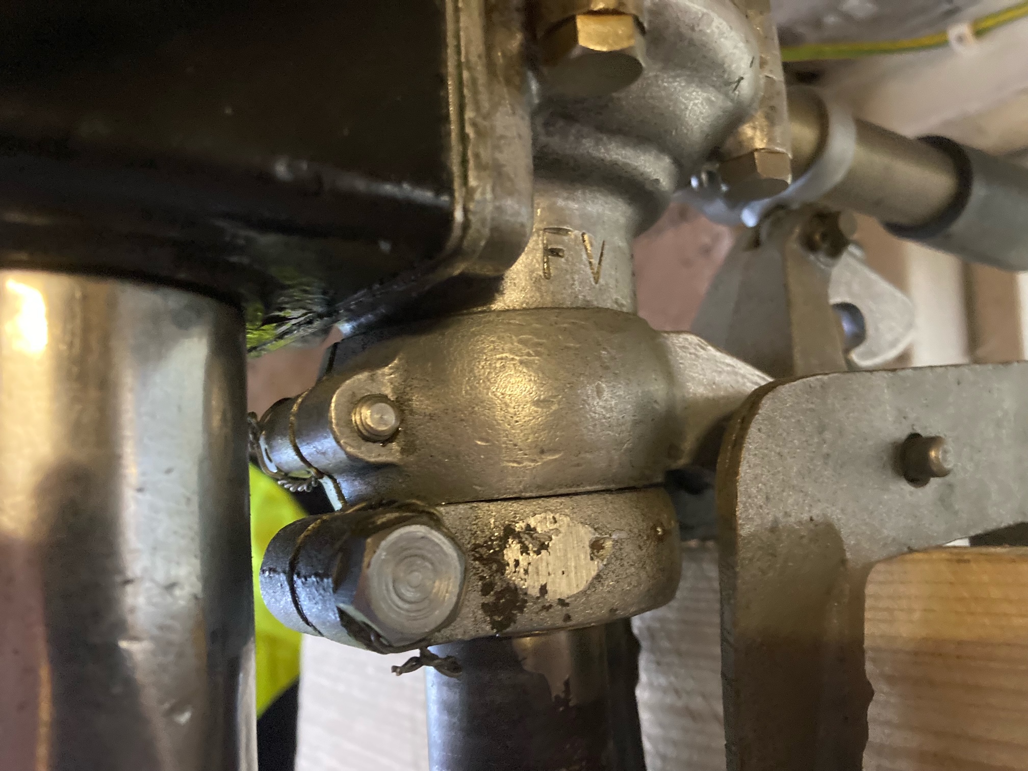

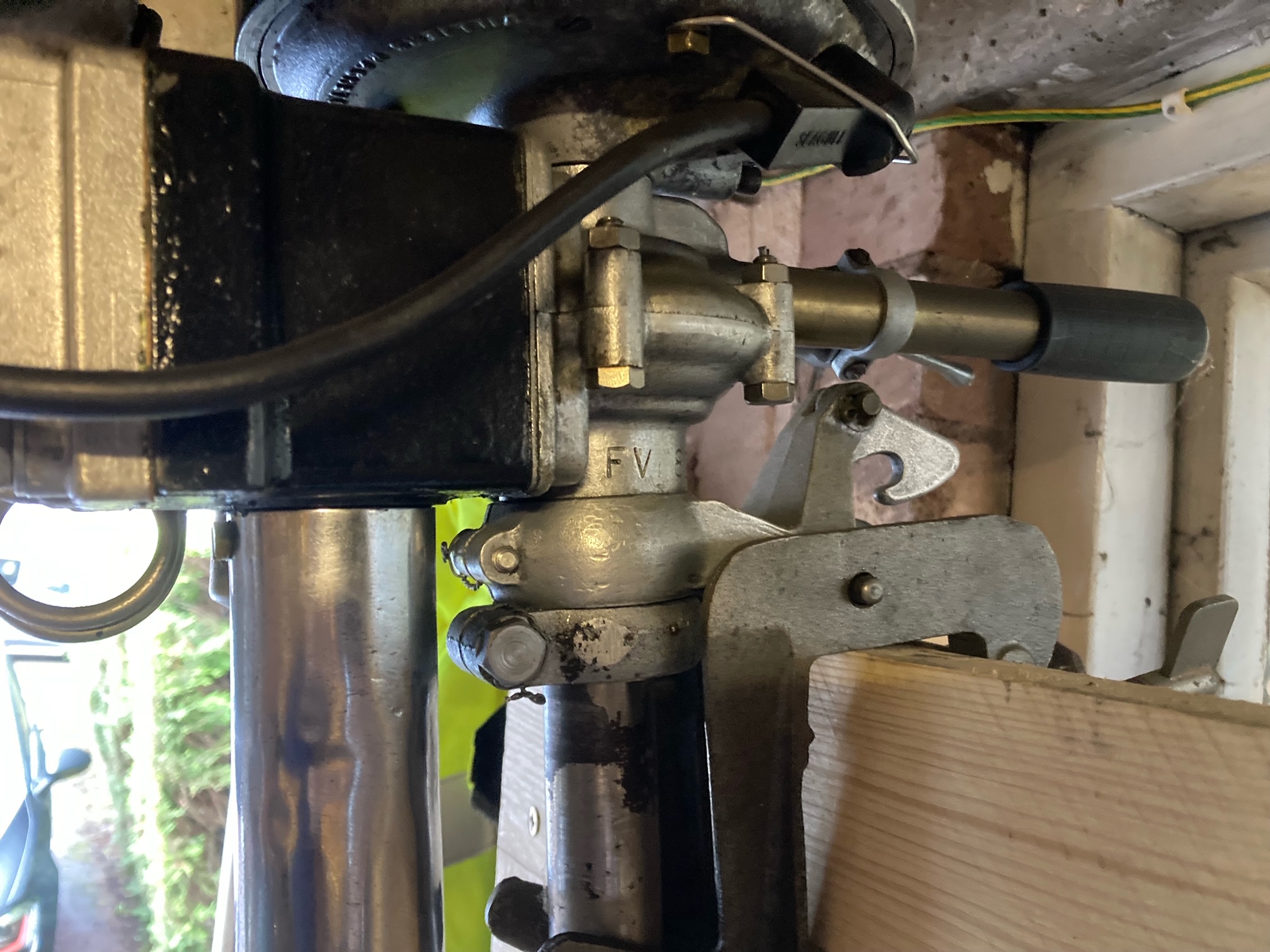

Later bracket with plastic tilt lock, skeg missing, later dome nut, no idea what’s going on with starboard side of the tank. Getting close? :D
Re: Can you work out what is wrong.
Cold, very cold.
I would like to see an inclined tank.....
The engine mount bracket is incorrect, there should be two clamps, one securing the drive tube, the other securing the mount bracket. This is mine.
Yes, basically, a later crankcase on an early motor, something you would see on a later little forty or an early LS, with the FV 2525 number restamped, which looks nothing like the original stamp.
I didnt notice the crankcase was replaced, nice spot Keith :P
