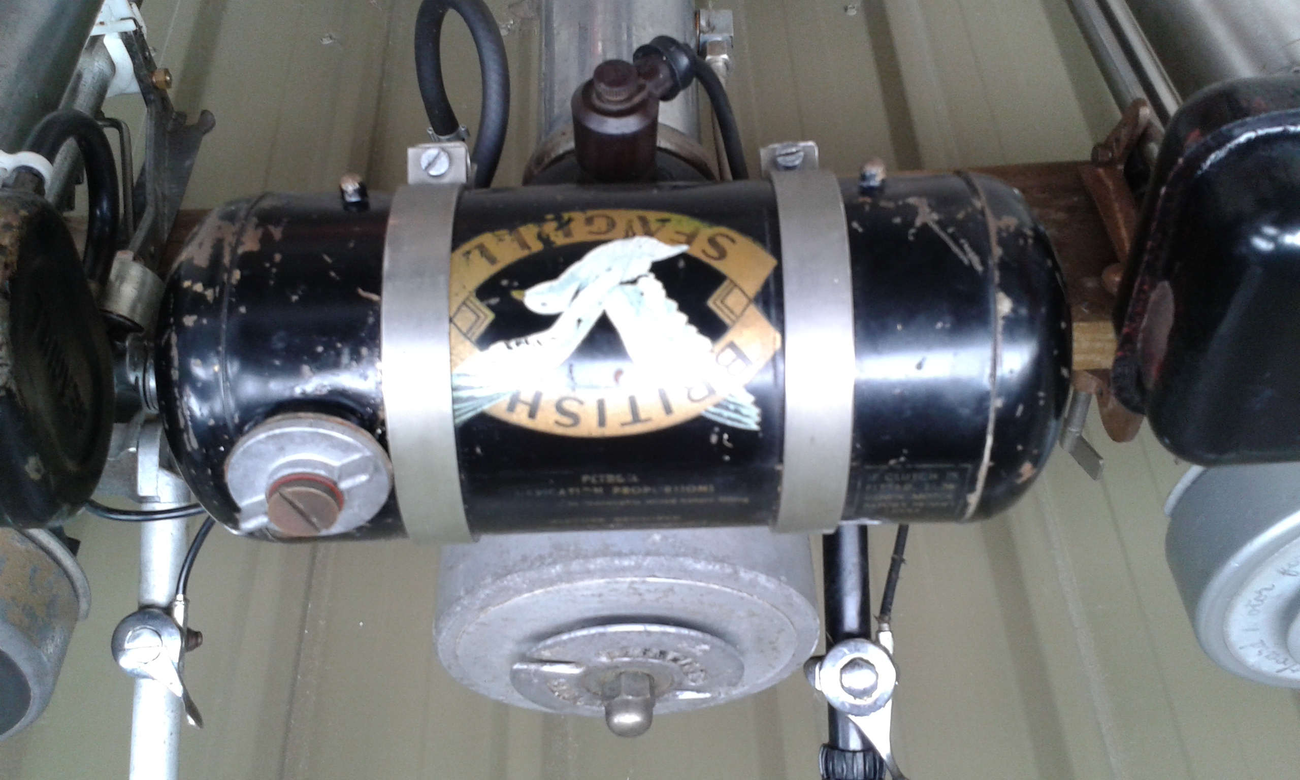

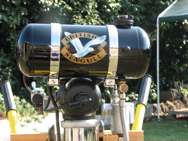

If you check out my post and photo above, which has an original set of transfers untouched since applied by Seagull, it is clear that the transfer was placed in the centre and that the birds wing and part of the banner on the stbd. side was partially covered by the clamp. Why the transfer was made so large for this to be the case is a mystery. But any way the correct position was centred with transfer partial covered by the strap.
Once again the photo I posted is upside down seems very random occasionally it is correct but not often.

looks better centred, but all the old photos I have seen, also a couple of my 'original' engines, have the decal partly covered so I always assumed the stbd. strap covered the tips of the gold bands.. Just another oddity of BS

An original Tank and decal placement.
Re the photo thanks B', I found Nuii GPS software was running in the back ground checking for updates, as you suggested I closed it and photo posted. Just upside down, bugger!!!!

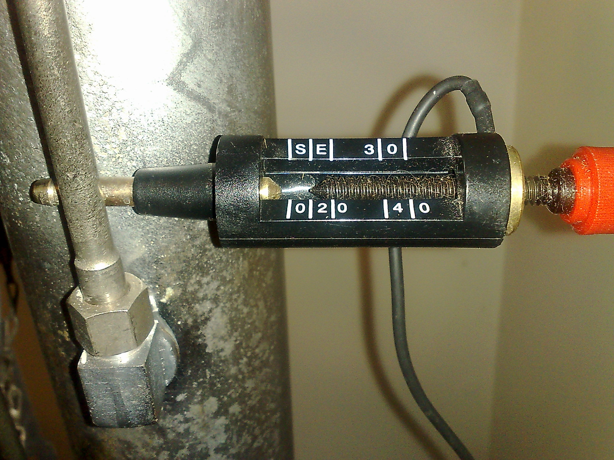

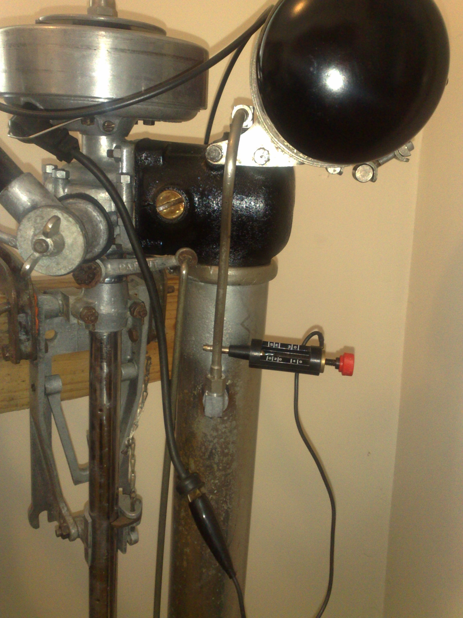

I did an air gap on the other work in progress so seeing that AC17964 is complete, on a stand and inside next to my dining table laptop.........do one on this as well aye?
Maxed the gap out until only one spark roped over hard and backed off so that continuous sparks.
Impressed. It is the correct everything as far as the mag goes.
0.210"
0.210"

You gotta love a good ol 102.
Nice healthy spark on that one B.
Should run good and strong all day like that.
(are you not tempted with a sneeky test run while nobody's looking)

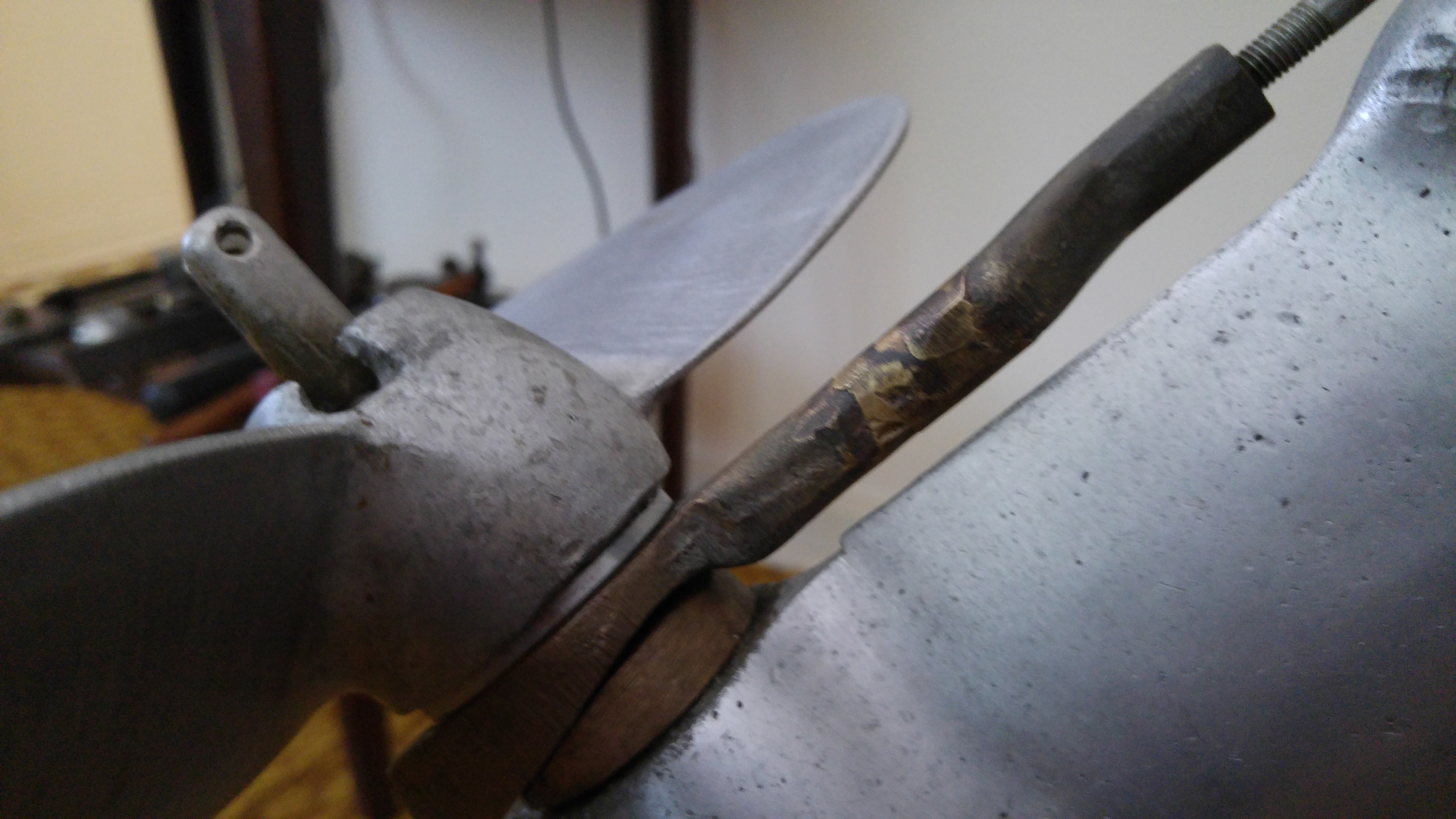

Just having a look while "brushing up" the lower unit.
Why would someone do adjustment/repair to this?
Over the years were there different lengths and centres for the bits?
Only one that I have with brazing.......I will look further through bits to check of course.

As far as i can work out there are only 2 lengths of clutch fork on the 102's. The "normal" one for the 2.5:1 gearboxes as you have there, and then there's the "bargepusher" type which is about 2 inches longer. Basically the same pattern, just one is longer than the other.
I have spares. (some brand spankers too, never been fitted)
If you need one, let me know.
All good though. Hope it fires straight up so as to avoid any embarassment. (
fingers crossed B, your a braver man than me)

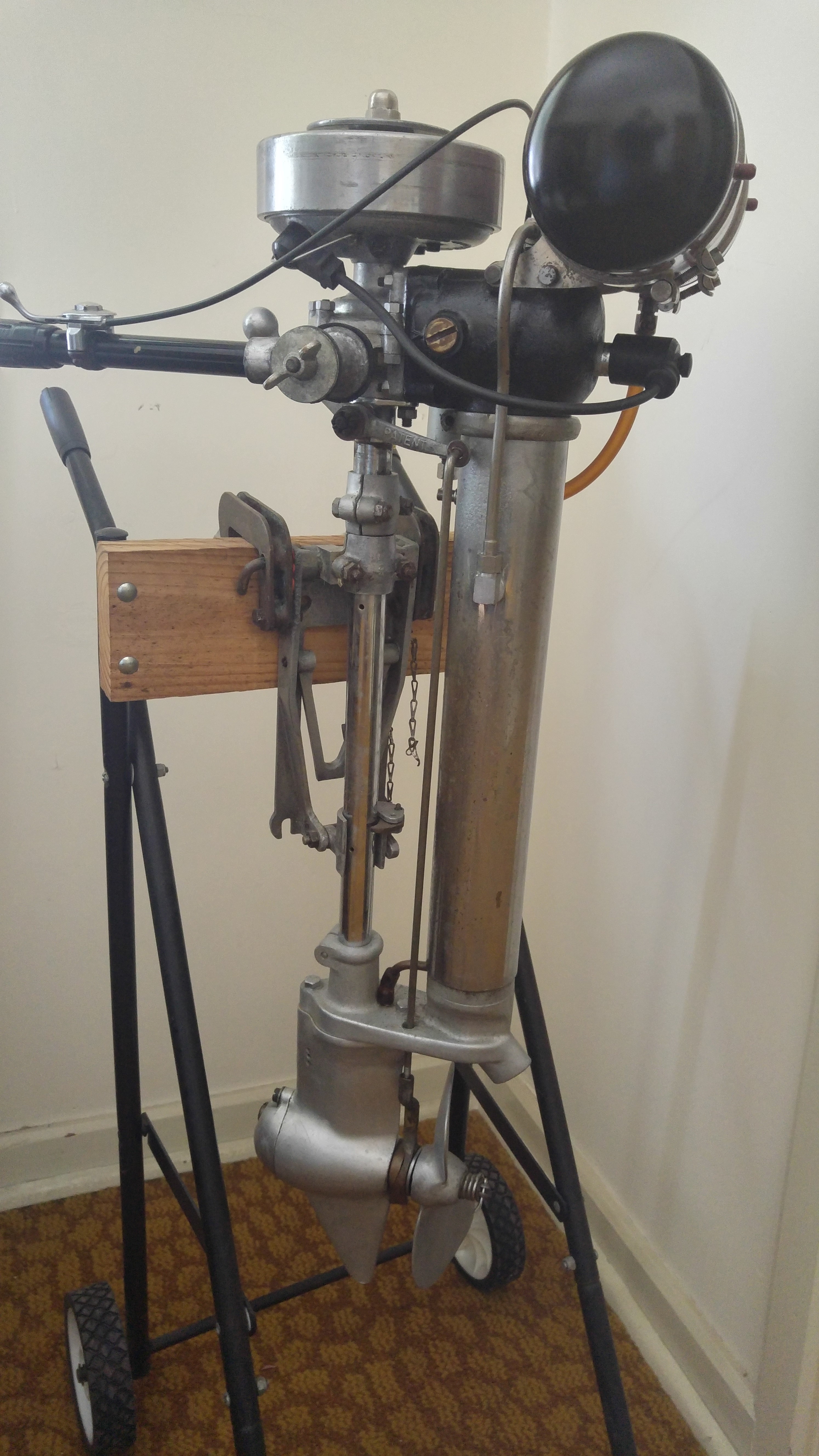

- Posts: 4196
Re: Australian Delivery AC17964

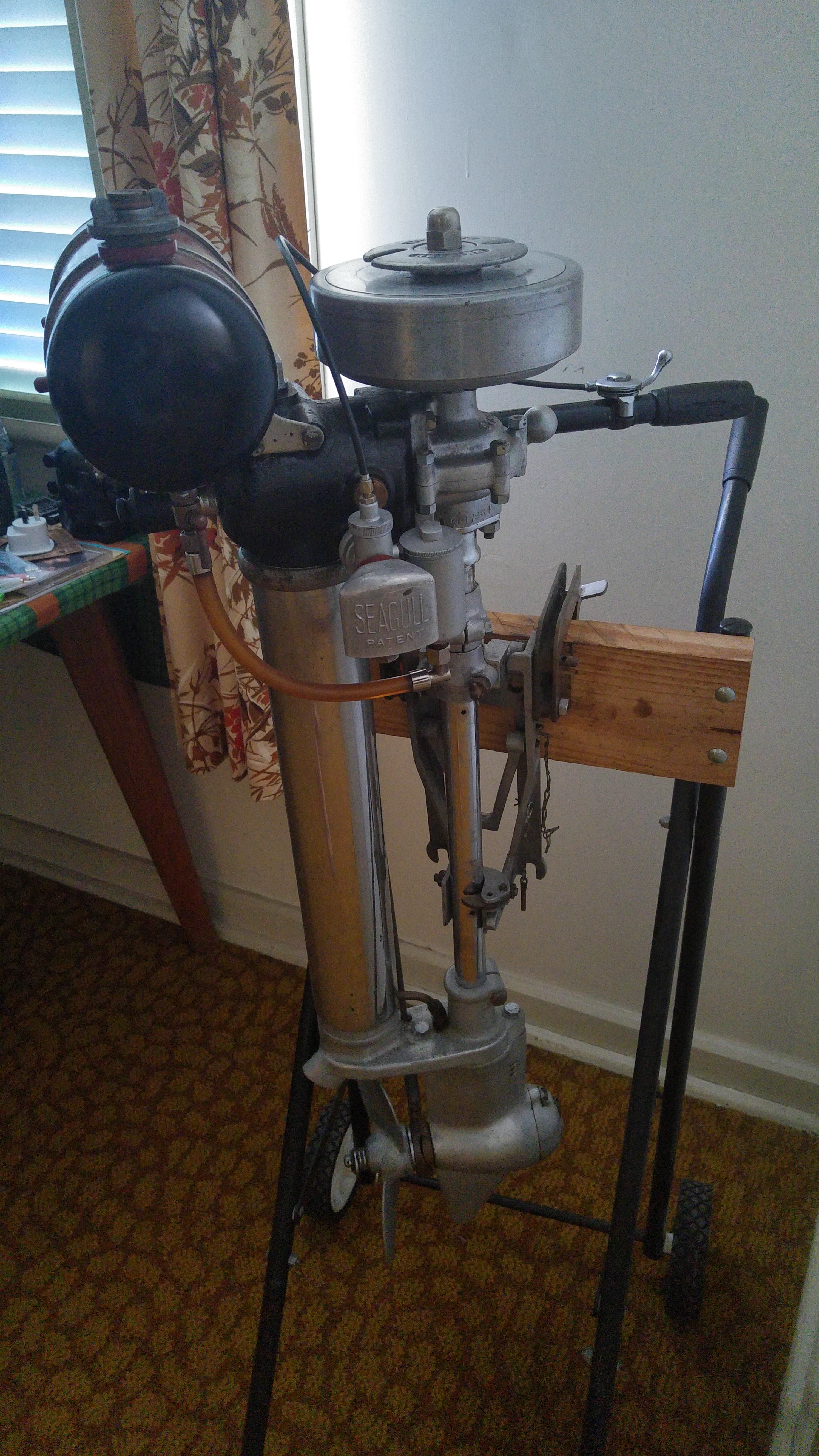

All ready for show and perhaps success.
Fuel tap is for no leaks on the day.
Fingers crossed but what could possibly go wrong?
B[/color]
