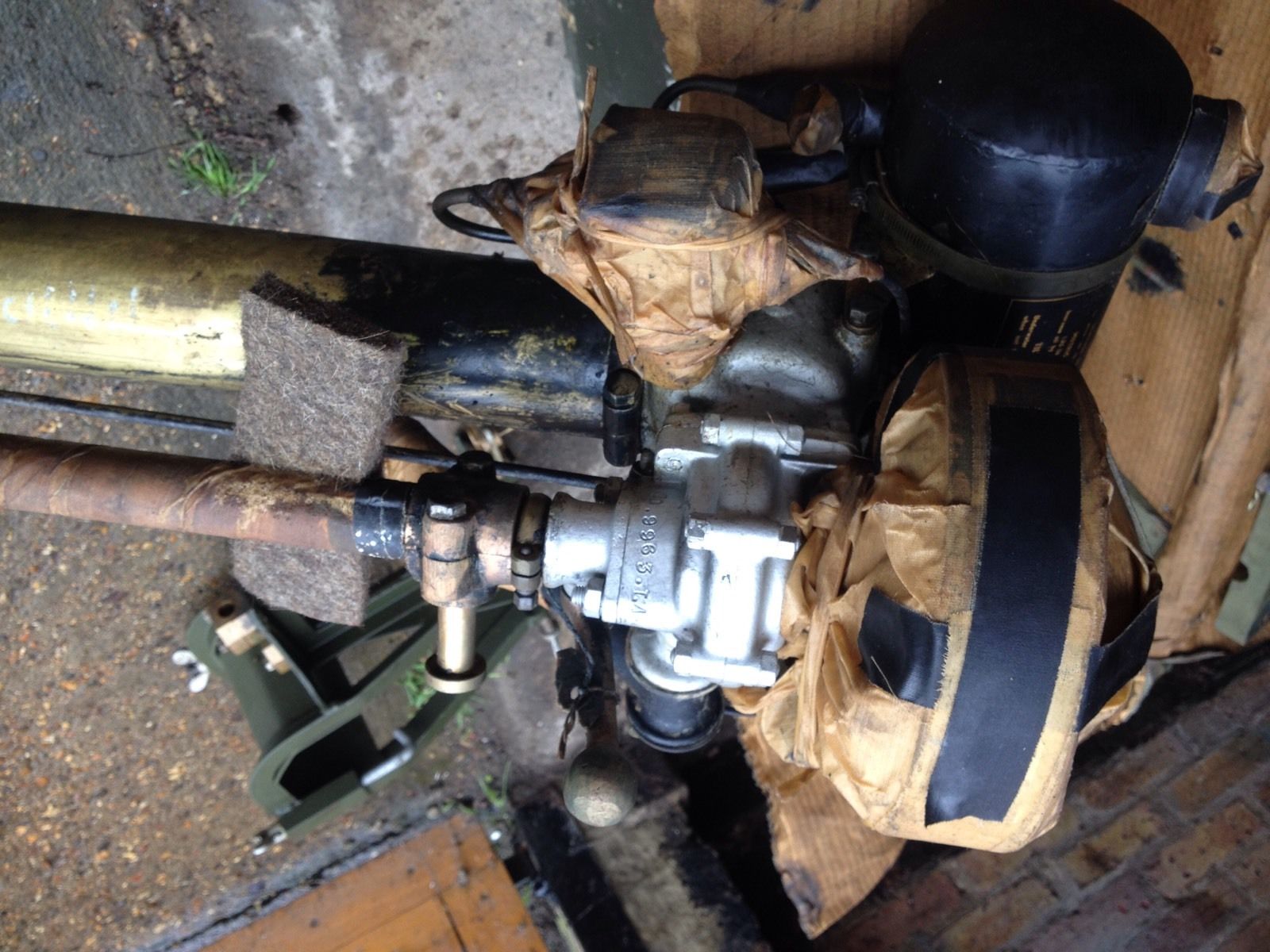

Here, you can see it under the paper:Hugz wrote:Do you have a pic of the crated one that shows a cowl Jacob? I think you maybe correct. The 'D' and 'C' adverts show the cowl and we know BS have a gradual change so it is unlikely the SD range finished with the trumpet.

Hi Jacob,
Indeed it does look like a cowl and definitely does not have a trumpet attached. Maybe an optical illusion but it seems to be further over towards the float chamber than the carb body. Maybe Keith might be the chap to cast his eye over it and give an analytical view point. Thanks.
Re: SD 102
I have seen another one original wartime with a cowl and living in the crate, it would make more sense having a cowl.
Re: SD 102
Yes, all four of mine had the cowl before I changed two of them to the trumpet. Be interesting if we can find out when the trumpet was discontinued. I would hazard a guess around the time tank saddle became brass.... but not a shred of evidence. Need to keep an eye out for photos to see if we can spot the cowl on pre '45 motors. We don't have a parts list printed during the war do we?

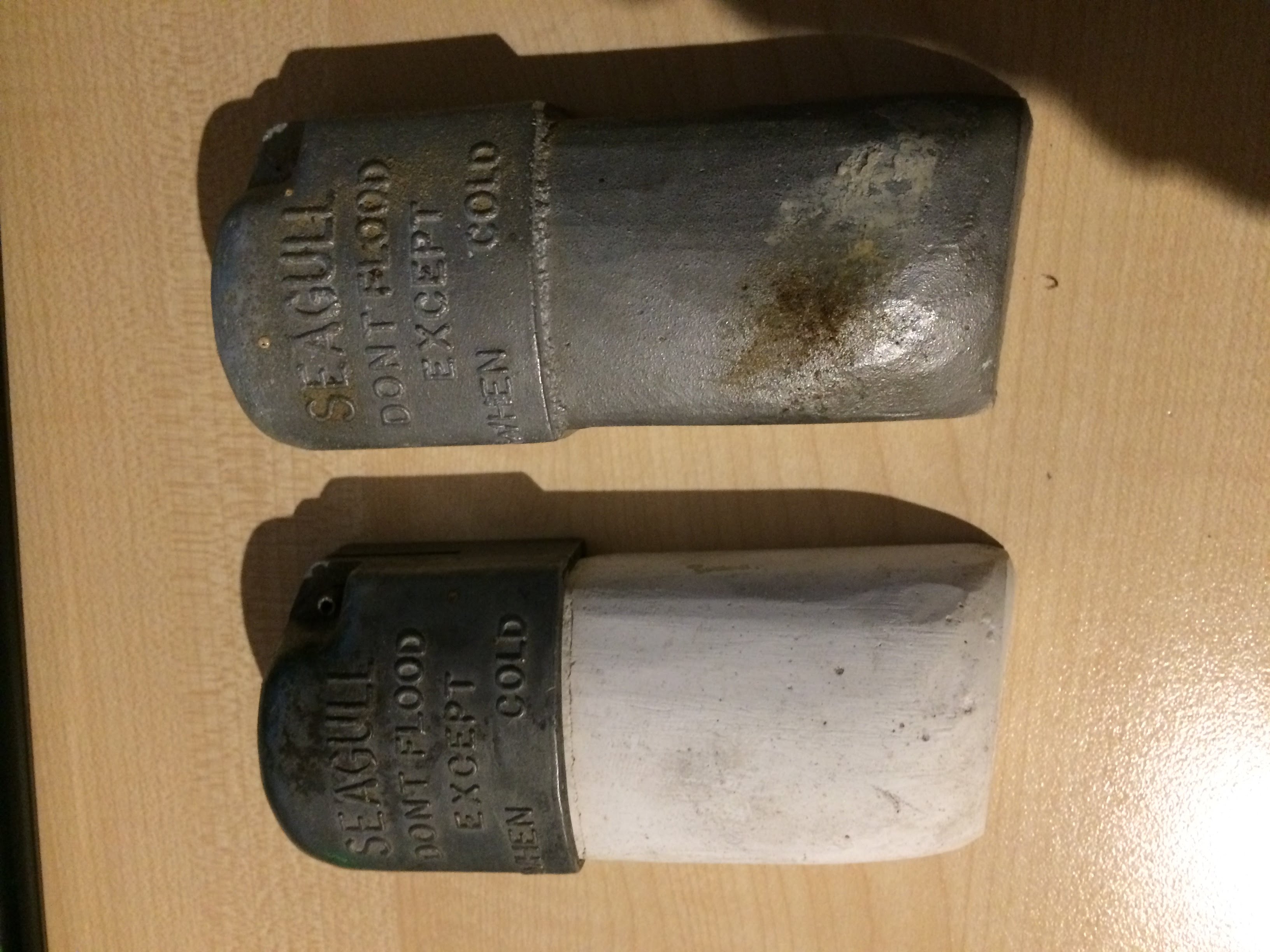

Im going to say the trumpet would a LOT easier, faster and cheaper to make!
The core is made out of sand and sodium silicate and is gased with CO2 untill it is hard.
The master pattern would be rammed up in sand, the part that hangs out of the cowl it used to support the core.
Once you have the raw casting it needs to be cleaned up and put in a lathe to cut the thread to fit it to the carb.
Not a very quick thing to make!
I would be guessing they would have die cast the cowl, but still a lot more work and effort to make than the trumpet.
I was lucky to have a cowl to use to make a master pattern. I had to make a patttern to make a core box... to make core (the void on the inside of the cowl) I used plaster of paris (the white bit) to start making the master pattern then the same plaster part was remaved and used to make the core box The grey part is the core box, this is used to make the core.Nudge (as our resident casting expert) can you comment on how the cowl was manufactured & what tooling & fixtures would be required.

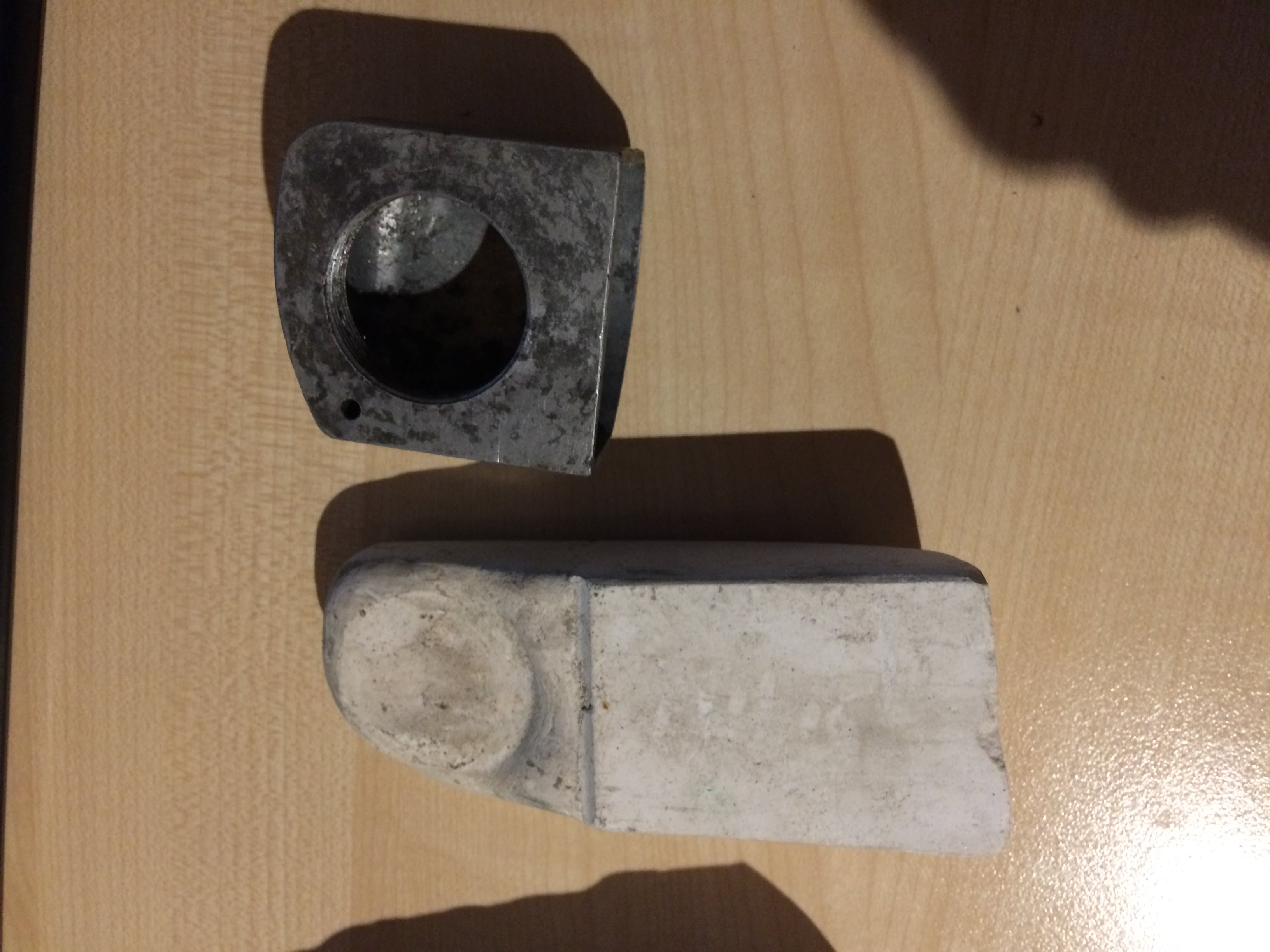

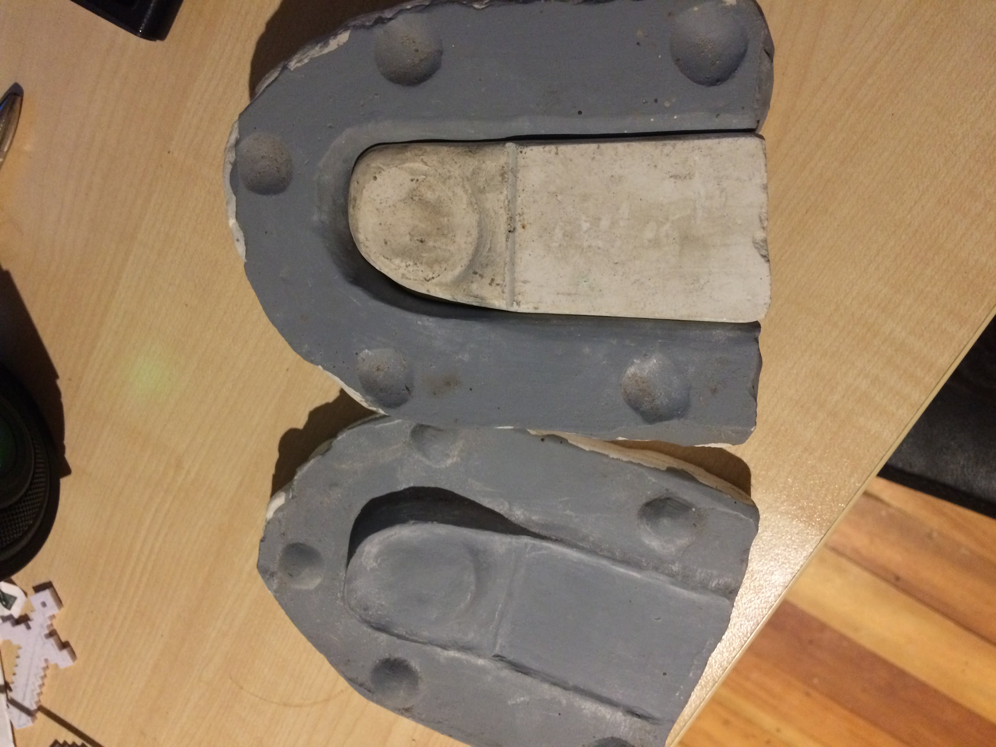

Obvious trumpet.Nudge wrote:Im going to say the trumpet would a LOT easier, faster and cheaper to make!I was licky to have a cowl to use to make a master pattern. I had to make a patttern to make a core box... to make core (the void on the inside of the cowl)Nudge (as our resident casting expert) can you comment on how the cowl was manufactured & what tooling & fixtures would be required.
