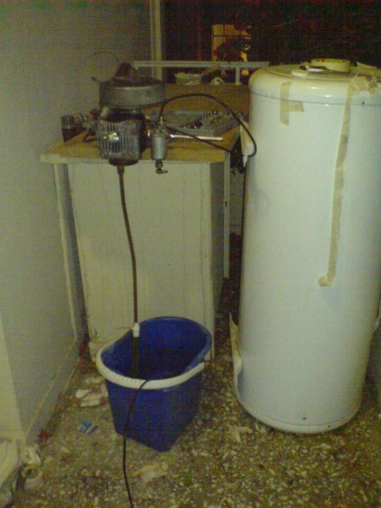

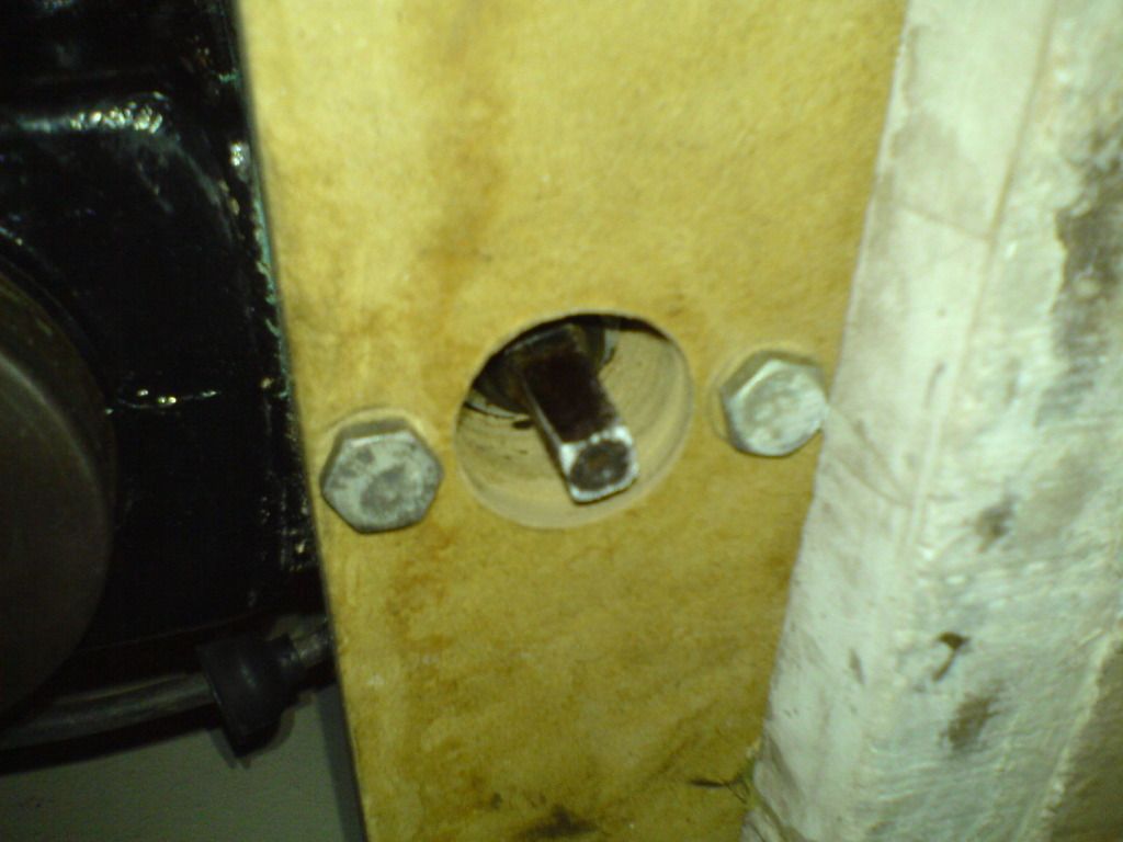

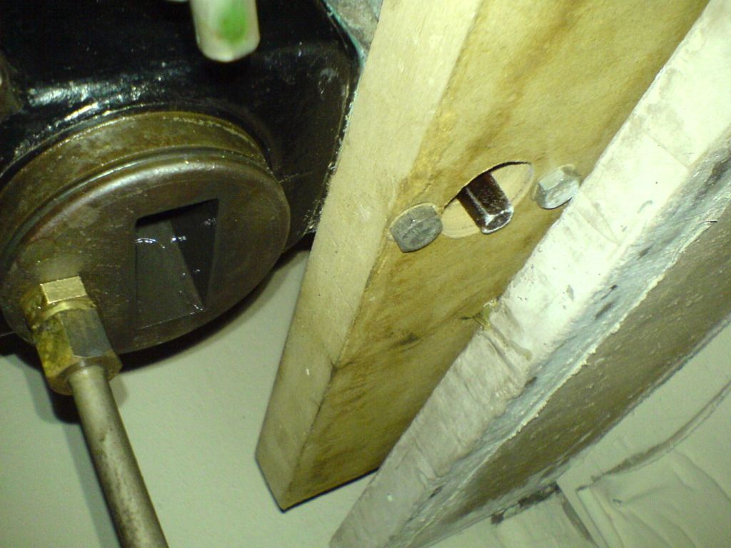

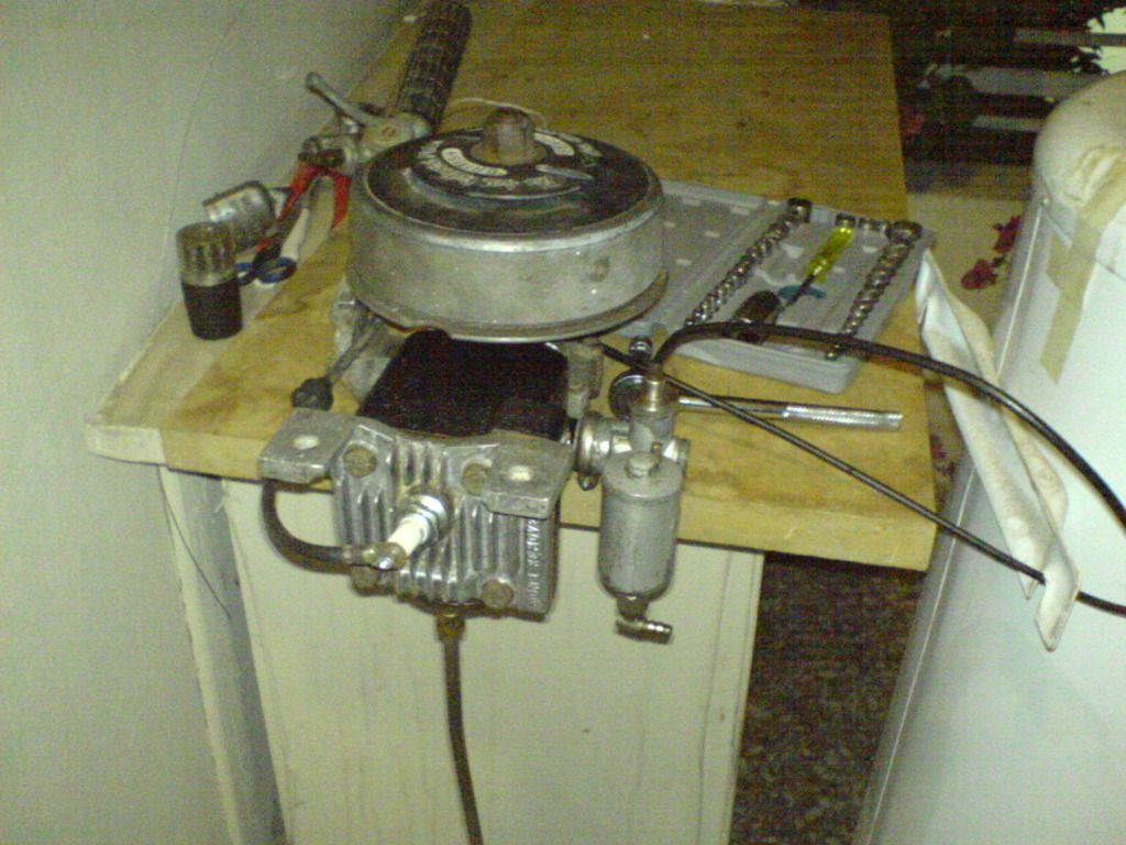

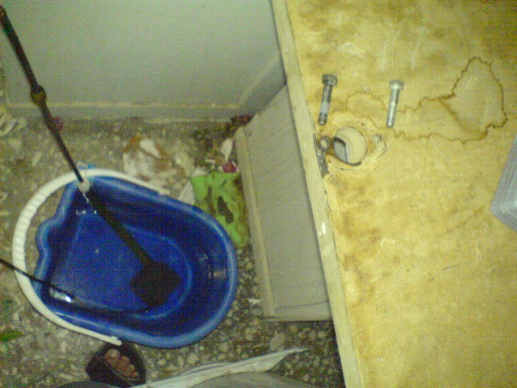

Hello to everybody. Sorry for the delayed photos, I was on vacations.
I have good news! The one, this without any problem, worked!!! I am realy happy! I did some things to test it.. You'll see in the photos.
First of all some essential holes on a wooden (mdf) board to attach the powerhead..
Then I attached a water pump to the coper pipe to tranfer water to the block.

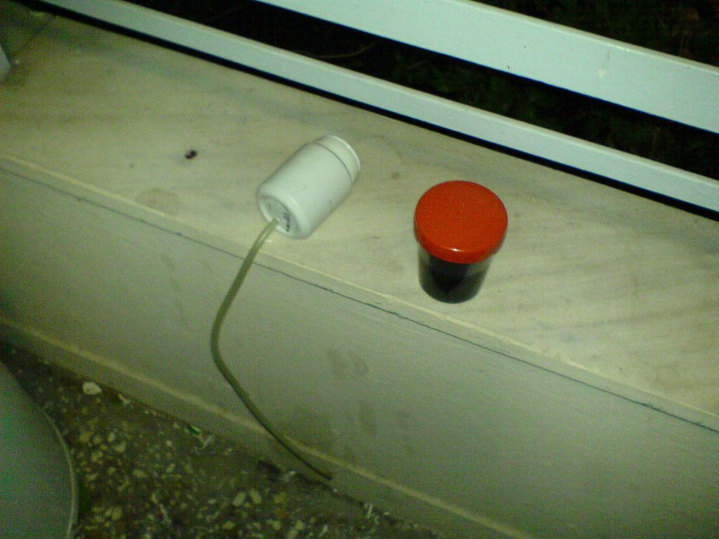

The red cup is needed to measure petrol and oil, the white thing is a DIY tank!!! I don't have a tank as it cannot be posted from UK. I 'll do something to make one, for the testing that was OK.
And everything assembled apart from the DIY tank(!), with the second pull start firing hard.
