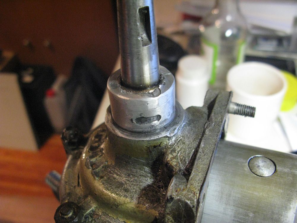

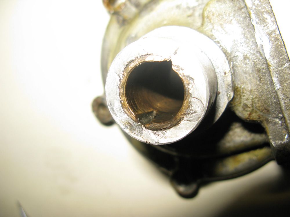

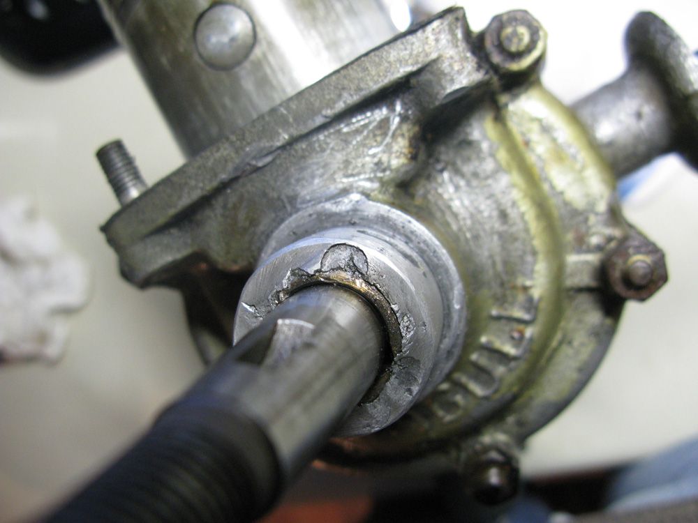

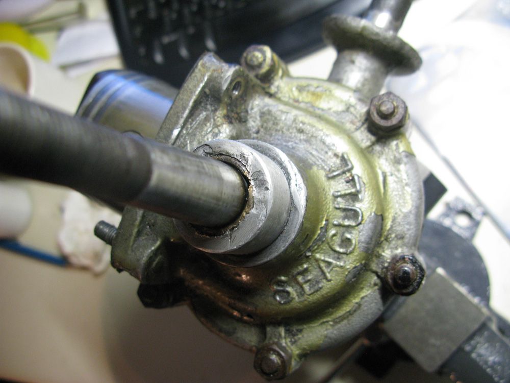

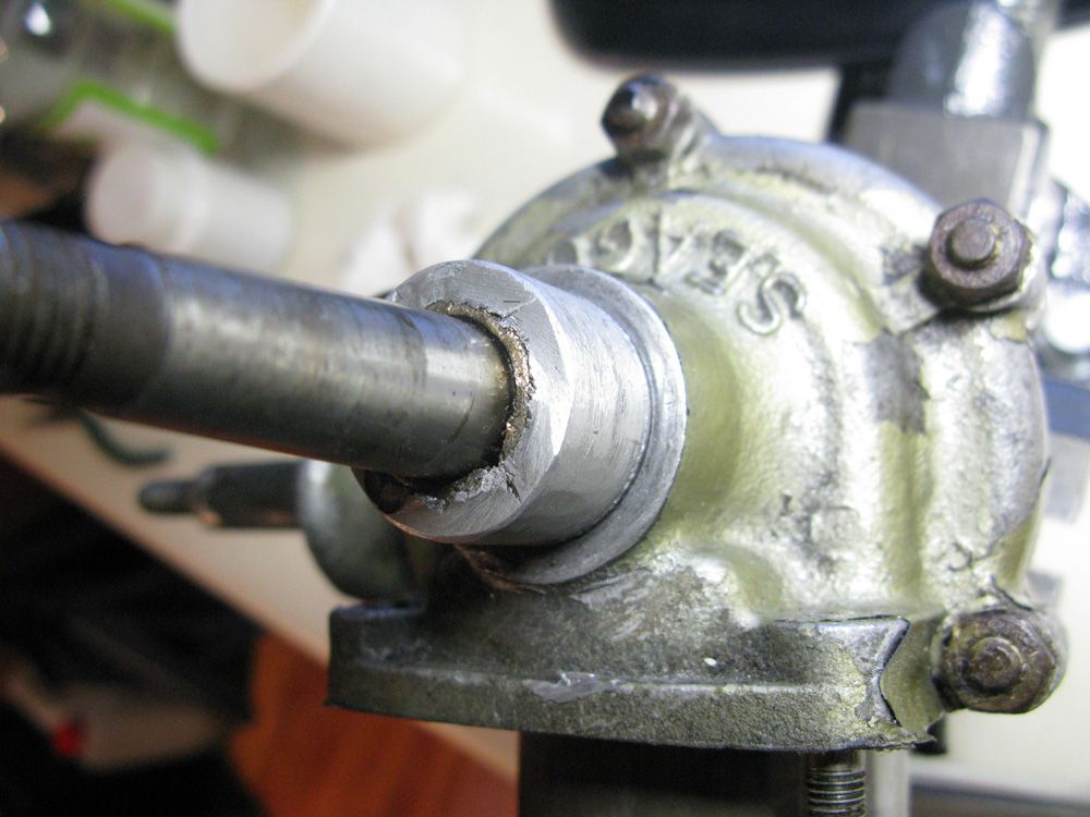

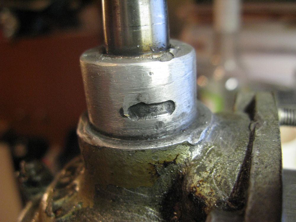

Now after dismantling the engine unfortunately I came across this...
I am thinking that the upper cylinder, where the backplate is fitted, is rasped. The next question is why? Maybe in order to be fitted the later ignition?
So now I would like someone to verify if there is difference in the backplate's diameter between the first villiers ignition (coolie hat) and the later one.
Now.. I have seen, in the main site I think or in a manual, the way to drill again the timing hole, the question is how am I going to find the correct point to drill. Could anyone make a suggestion according to the sign that the timing screw has made?
About skeg stamp. There isn't any, just written 1960 both on the gearbox and on the gearbox cap.

Just get it running and you can move the base plate slightly [while its running]to get it running smooth as you want them mark its position with a center punch

I can do that. What about diameters of the backplates and the worn area around the bearing. Does that seem possible to fail?

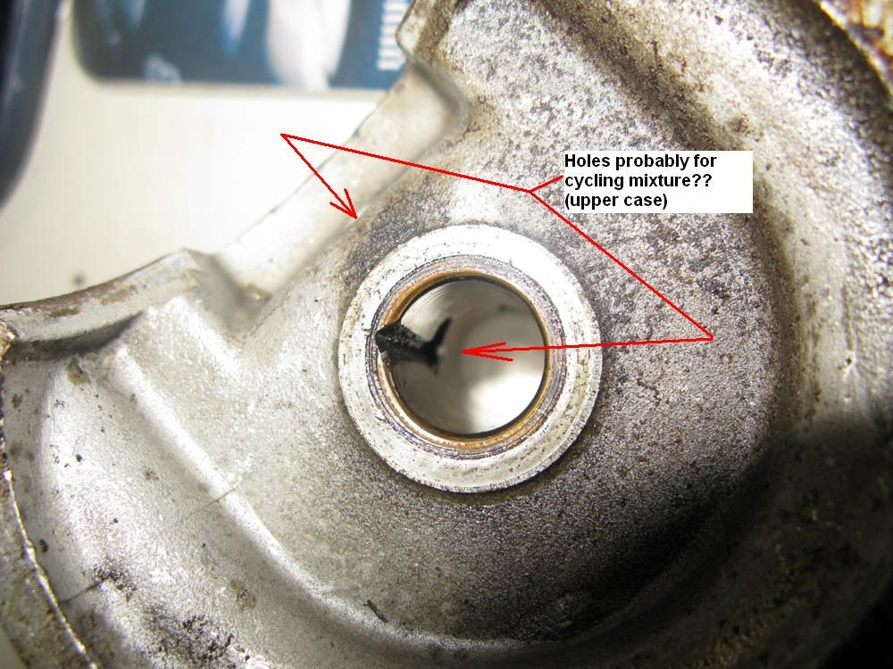

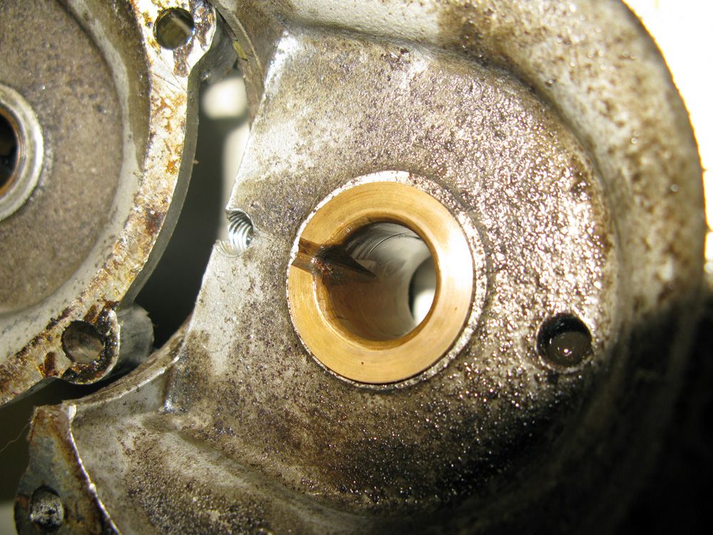

Now about bearing both have notches and the upper one has also a hole which seems that it is over there to cycling the mixture for lubrication. The notches were usual on bearings? On silver century I haven't seen any. In the main there is indeed a free play. What do you suggest? Replacing bearing (main or both) or replacing the whole crankcase?

Send those crankcases back to Santa Santa will send you some other "SD" crankcases he has
unscrew the tiller stud as its heavy[This is what you may need a blowtorch for..freeing things off.
also keep the bolts
send the crankcases to Santa
Santa will send you new ones ...got that?
also keep the bolts
