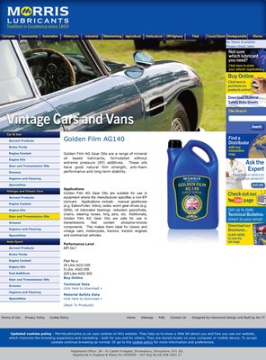

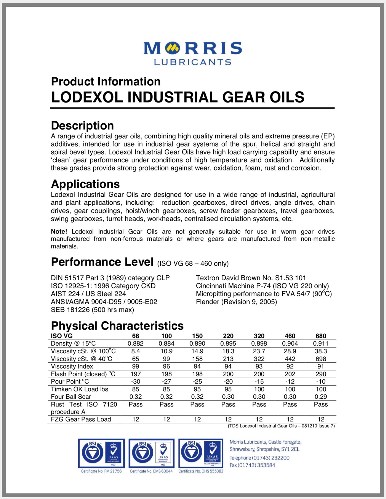

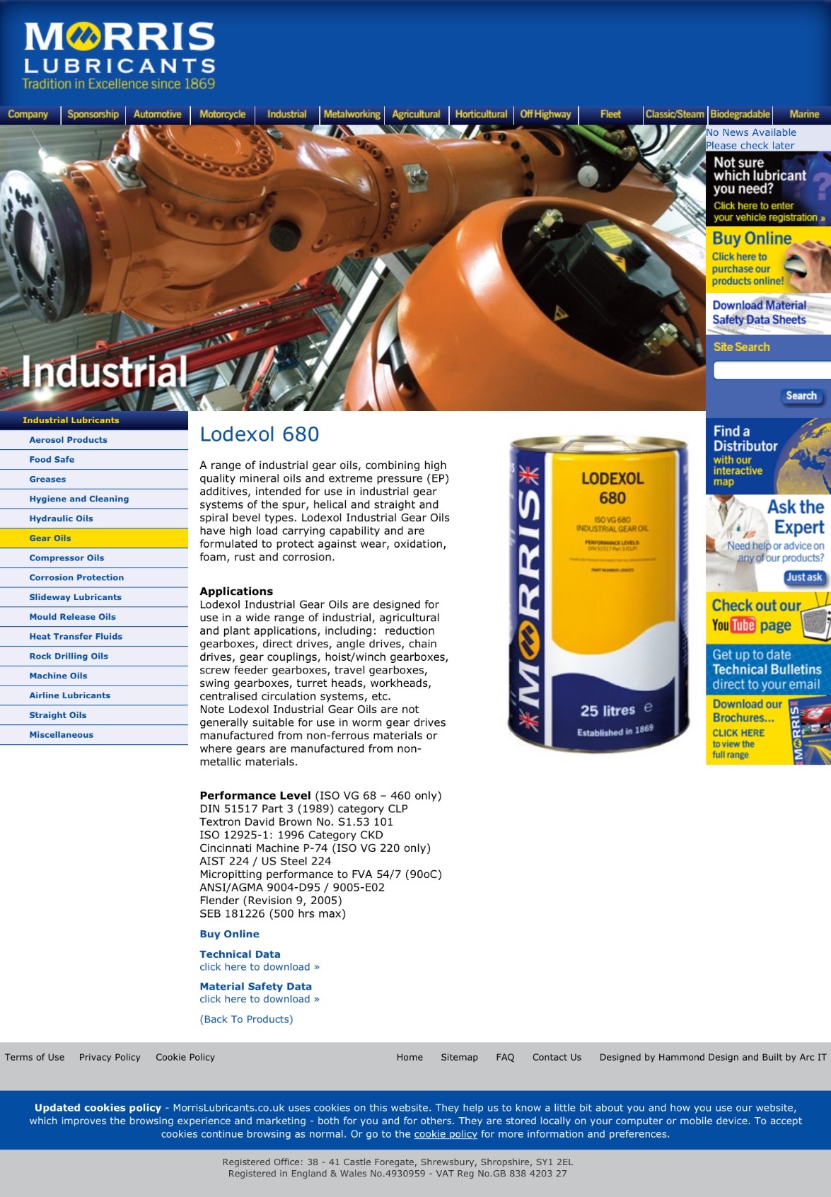

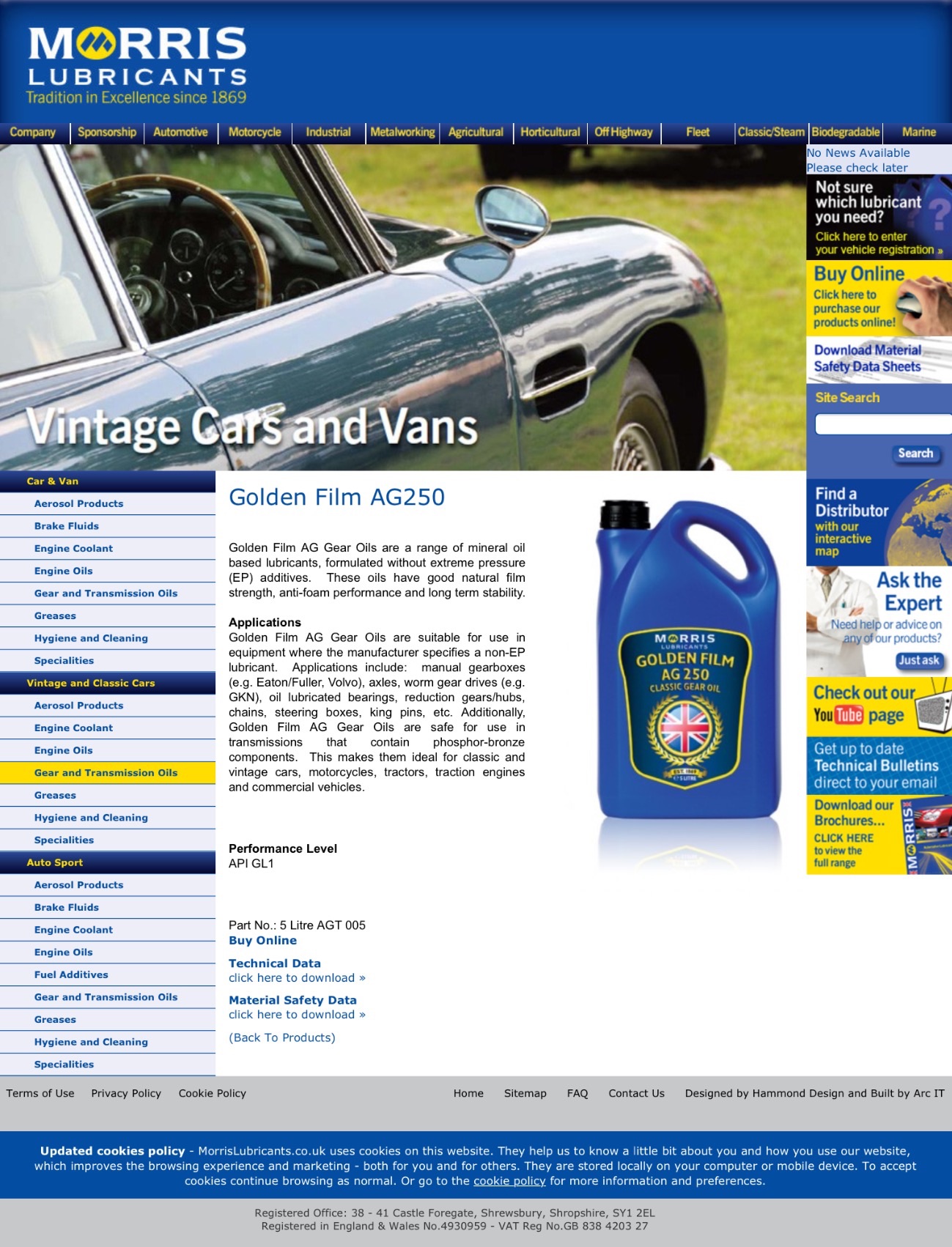

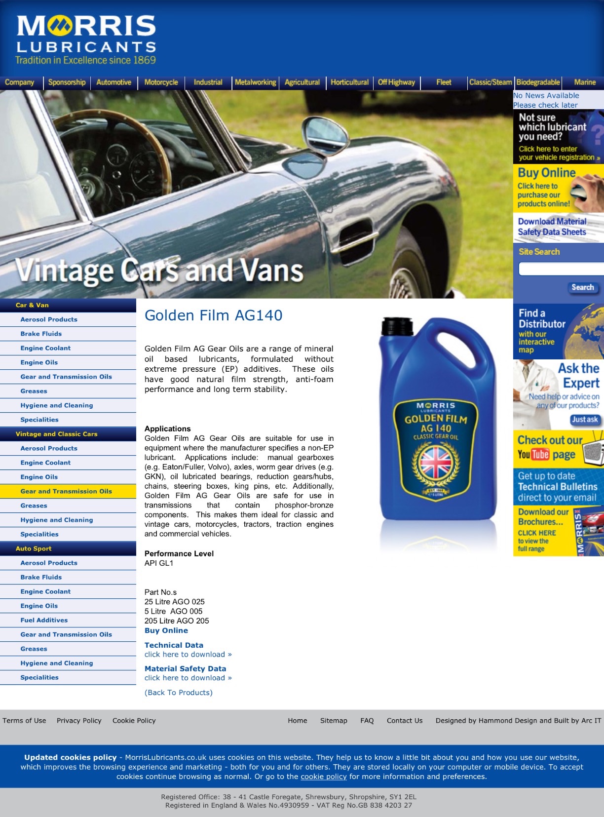

These are the gear oils I use and pretty cheap too, I only pay £19 for 5 litres from my local suppliers. They also do an SAE460 but that comes only in 20 litre cans.
Re: Gear oil
Not automotive stuff, rock crushers, car bailers, timber shredders,shipping channel dredgers & don't tell them you only want 1 liter, just ask fro a sample to see if it will suit your application, I was given 2 litres of SAE460 & that was perfect for Marston boxes!
It stayed in there & flows!
Re: Gear oil
These guys also do SAE460 and SAE680!! Thick stuff....only in bulk though.
