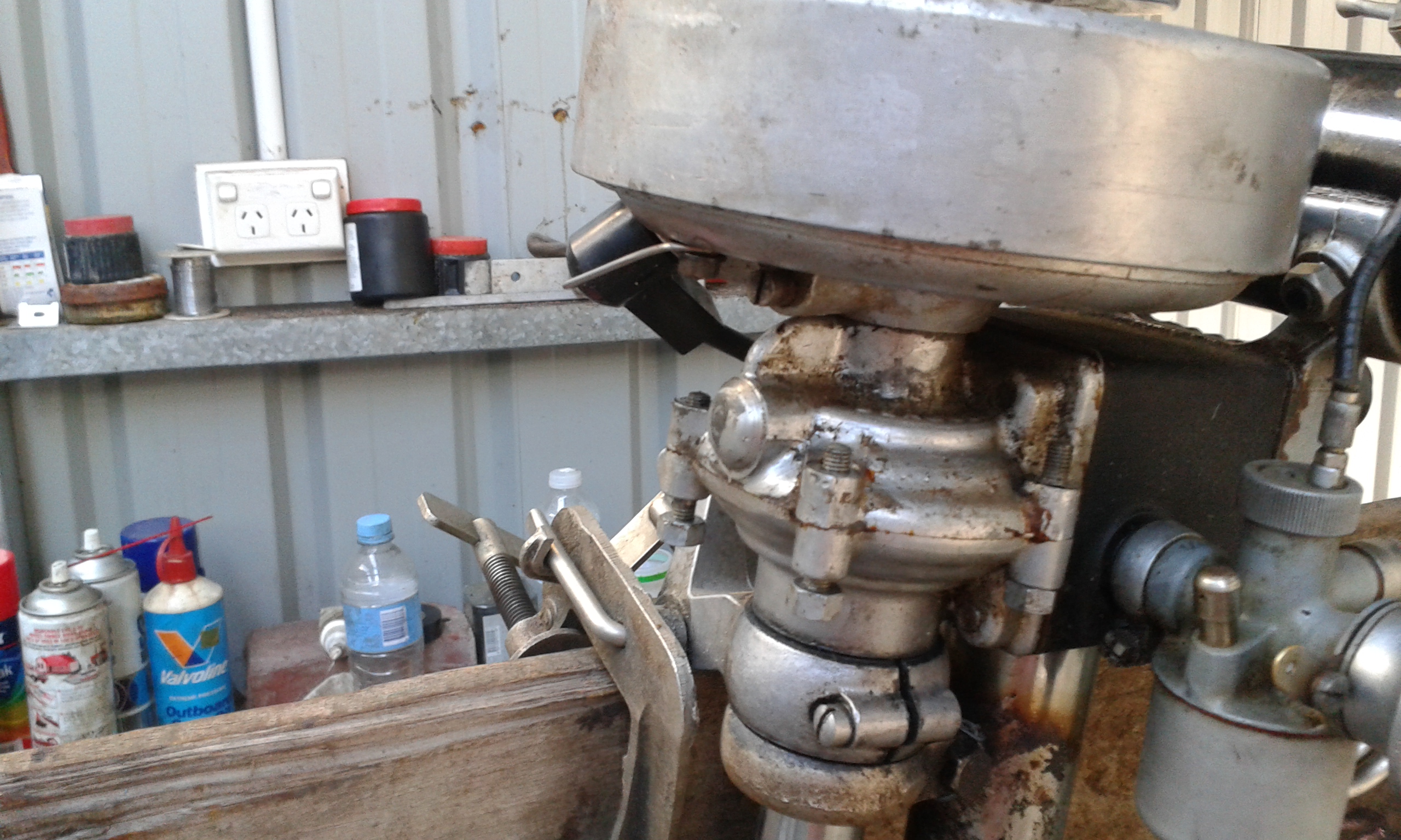

Looked at the extra fin again and have posted a new photo below I am 100% sure that this is cast not welded see photo

Yep, looks cast to me now. What about under it?

I think its just a trick of the light Hugz, but I can see what you mean, The crank looks right for a tilt tiller, if it was or wasn't before, who knows .

yes got you now it is the light bouncing off there is no weld.

This extra web is CAST.
It was introduced round about this time:-
FV1867T hasn't got it
FV2682 hasn't
FV2821 has got it
FV3048 hasn't
FV3364 has
FV3481 appears from a photo to have it, but I cannot be certain - perhaps Garry could comment.
FV5141 has it and I guess all subsequent one have it.

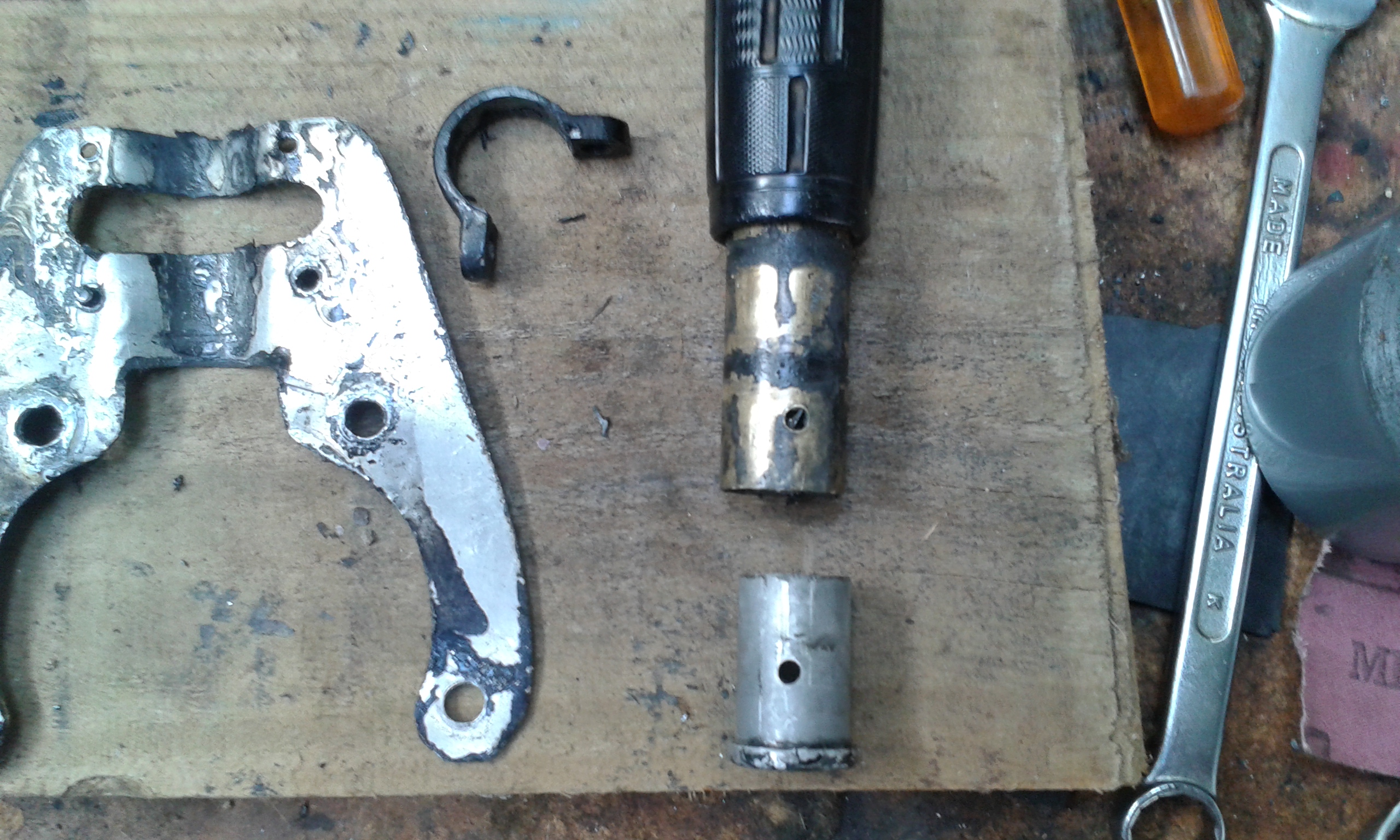

Adrian, what is the small (1.5"ish long) cylinder or sleeve in your photos? Is it the broken end of the stub or is it part of the 'new' tiller?

Jeremy the small plug is a solid machined aluminium insert with a 1/16" collar at one end for the brass tiller to butt against. It is there so that the bracket clamp can squeezes the brass of the tiller firmly. It is also drilled and countersank to allow a screw to be inserted, giving positive location. It has been machined from a piece of aluminium stock and is most definitely not part of a broken crank case. The stub cast onto the crankcase does not have the collar.
I believe if you expand the photo you will see all the details Jeremy.

This motor is basically a tiller version now, was it original, don't know, is the plug that's still in the end of the tiller from the original crank case, hard to tell.

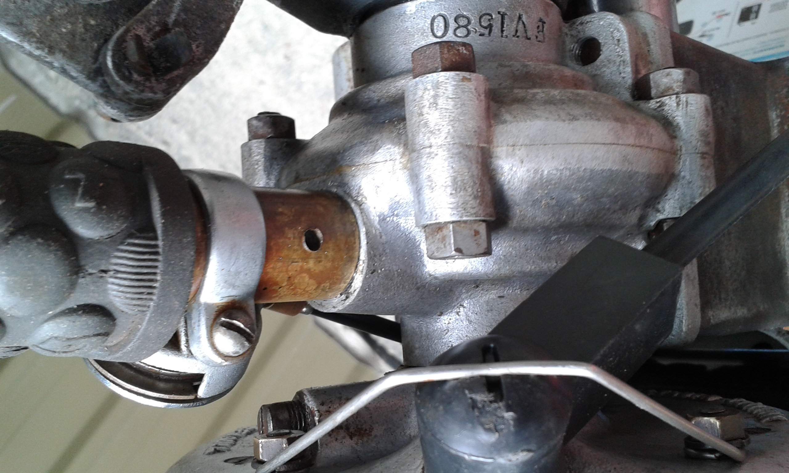

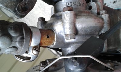

FV 1580 does not have the fin. Note how the brass tube pushes right up to the crankcase with no lip. When you look at the plug you can see a clearly machined flange. That lip means that the plug could not have been machined from a broken crankcase stub.
