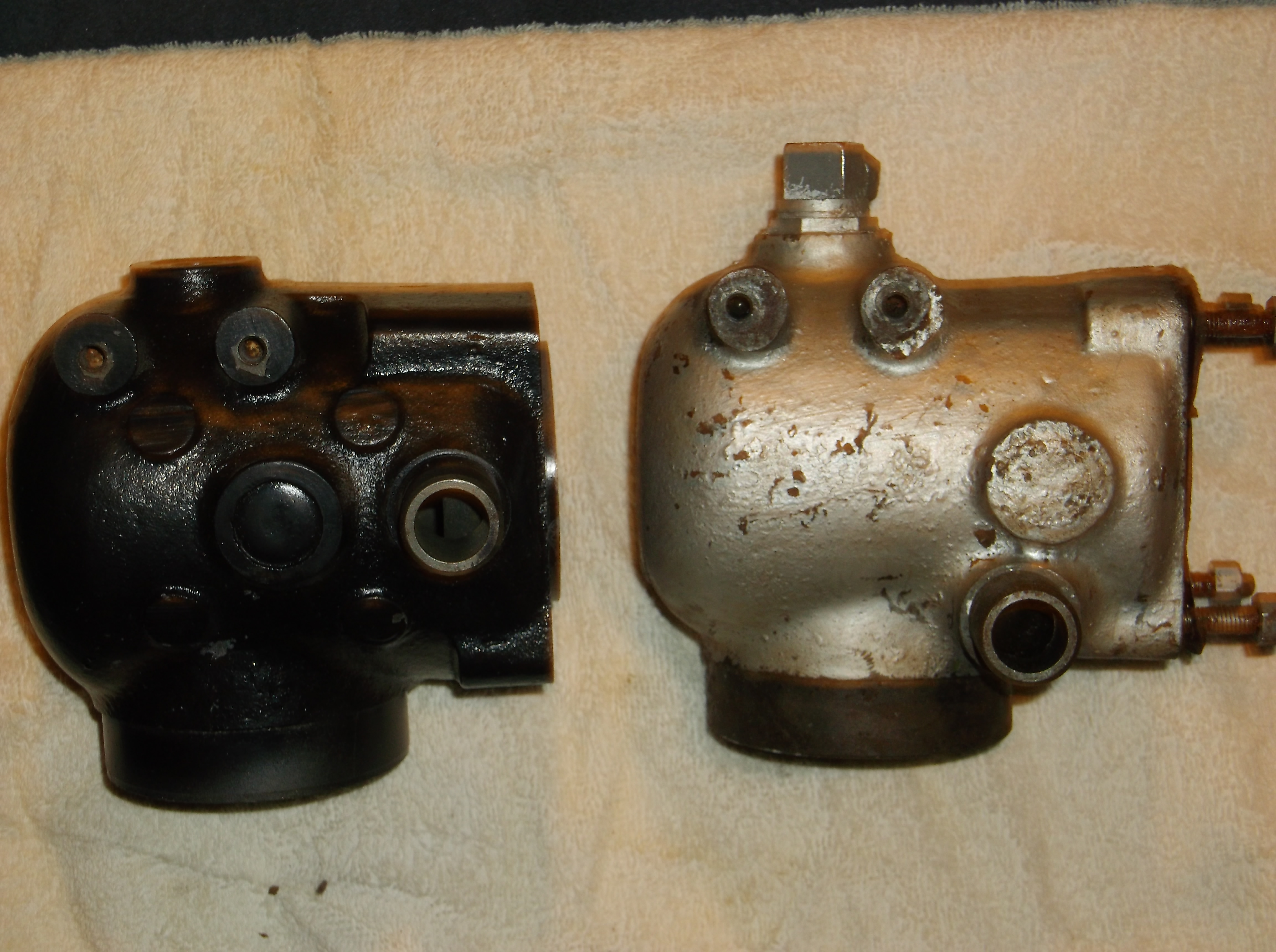

Cylinders.
At the time of typing this i am only aware of 1 basic type of cylinder fitted to roundblock 102's. Ignoring the fact that earlier variants have a brass core plug and any other changes to port dimensions over the years, to the best of my knowledge the position of the inlet stub remains in the same place. That is to say quite close to the bottom, whereas in the square block century's the inlet is cast around half way up the side of the block (thus allowing a little more room for turning)
Or have i misunderstood this? I have yet to see a roundblock 102 with it's inlet stub cast halfway up the block. I was under the impression that the height adjusting block was provided to get around this problem with whichever mounting or carb was used.
I remain hopeful that the more we research/look into this the more clearer it will all become.

Jon try the steering on your pre 1950 102s, when the float is on the right (crankcase side) does it restrict the amount of steering movement?
Why would the SDP & HSD be any different to the SD?
Oil nipples are a different shape to grease nipples so that people didn't put the wrong lube in the wrong location as grease guns make an obvious mess on an oil nipple.
Bridged ports need entirely new patterns & cores, I'd guess that including the SDs that there were 4 or 5 different "roundblock"102 cylinder types.
Didnt you realise there were different configs of inlet stub? No idea when this came in. I would have thought this needs to be included in data logging?
Charles is of course the master :lol:

Re the cylinder configuration: I believe the change to the central stub came with the WD's
My late TD..J4 (1964) still had the off centre stub but the WD..mm3 (1973) and WD..gg4 (1974) were fitted with the central stub, all be it 9 years later.
That is why with AD4331, which has a corroded cylinder, I was looking for the old style cylinder with square core plugs as a replacement.
The motors produced between 1964 and 1973 should be easily located to define precisely when the change was made.

Charles uk wrote:Bridged ports need entirely new patterns & cores, I'd guess that including the SDs that there were 4 or 5 different "roundblock"102 cylinder types.
I didn't know that. I'll have to have a look at my ED being one of the last. Was the D and C the same as AD and AC?
And the Olympia??
