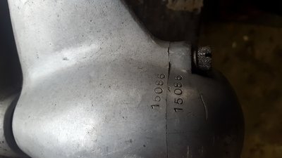

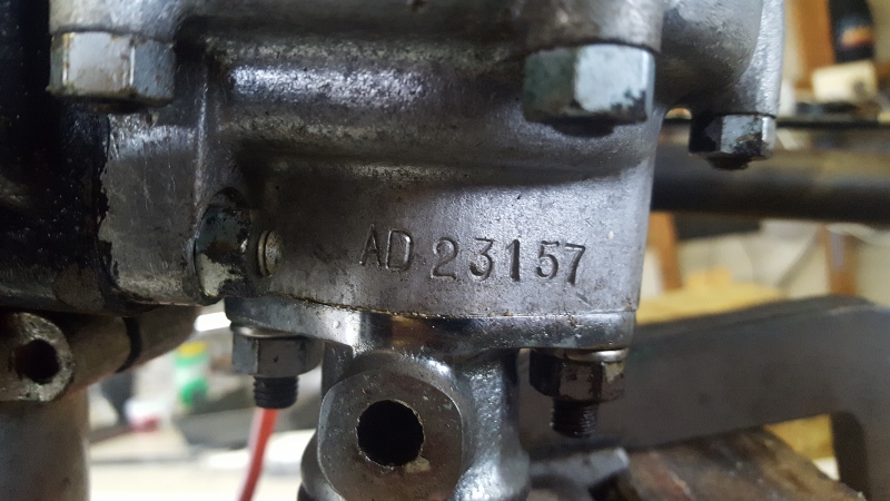

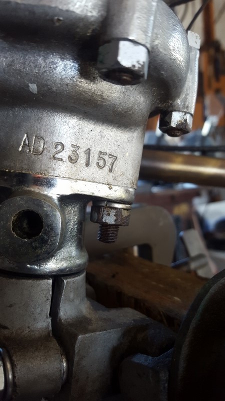

Hi Jon how are you? I've sent the engine number for your records. I am fairly new at all the seagull so I thought I'd add a photo of the gearbox and rear cover matching serial numbers. I don't know if this is common or not but it just took my interest seeing matching numbers.

Your seagull has now been added to my list. Welcome aboard! Numbers on the gearbox and end cap are nice to see, it shows that the lower unit retains its original end cap.Its easier to keep track of which part came from where, especially if you've got several 102's in bits laid out on a bench all at once. Quite common. But very clearly visible which is rather nice.
As per Charles suggestion, when you re-assemble the gearbox, to assess the wear with any degree of accuracy you really need to have the end cap fitted along with all the thrust washers as well. Give everything a good pull/push and from side to side on the prop shaft. As mentioned previously the prop shaft bush is very prone to wear after some serious neglect and very often is the first place where most of the gear oil will leak from. Dont overlook the drive pinion either. This is the second place where a lot of wear occurs. Oil leaks out from the box and water takes its place. Pinions can sometimes be tricky to remove although Hugo has just posted a rather good you tube video showing how he removed one from an older 102. Well worth a look.
I like to use my 102's rather than just look at them longingly. Quite a lot of these 102's are approaching retirement age (a lot of mine are over 60+ years old, with the odd one or two now over 70
) so they could well be quite tempramental after being sat inside a box for years. Periodic maintenence might have been overlooked by the previous owner (see previous gearbox pics) so at this point i think you'd be wise to go through the entire motor in the same fashion. Better to be safe than sorry. Easy enough to do, just take your time with it and dont rush. If you get stuck on anything just yell. One of us will jump in and help i'm sure

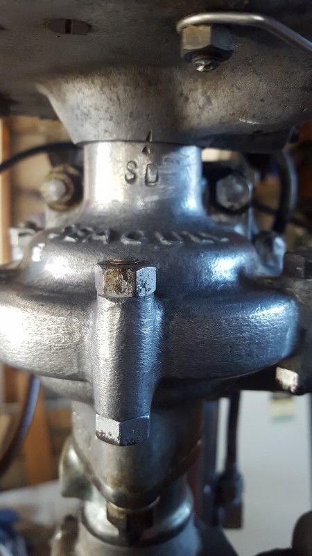

Hi again I'm glad I called this thread Silly Question cause here comes another one! I noticed this stamp on the 102 and was just wondering why it was there? The bottom of the crankcase has the engine number and on the top half of the crankcase SD is stamped under what must be timing marks. There probably is an obvious reason and everyone else knows but. You get that when our learning.

Been mentioned in the past china sd was probably the geezer that built it although i have never seen any other initials over the years (looks like there could be many pics to follow) ....

I also have an AD (similar serial number) with the SD stamped into the upper crank case like yours. If Tam is correct (and I have no doubt he is) this fella must have built quite a few.

Actually Tam is wrong, the SD stamp doesn't refer to the assembler, as their code was stamped on the tiller arm stub during the period that they were paid on a piece work basis & wasn't credited to them until after the motor had successfully passed through the testing procedure, but refers it's believed to the wide transfer port notched crankcase.
We have no documents supporting this, only tales from ex staff members, so don't bet your house on it.
