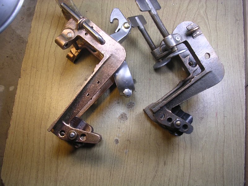

Yes, Those shown just a sample. Many more different parts. thrust blocks, torque tube clamp caps, rope sheaves, aeven bronze transom clamp parts.

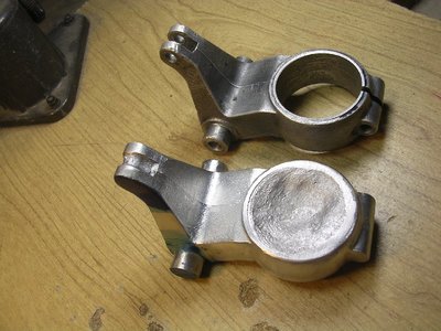

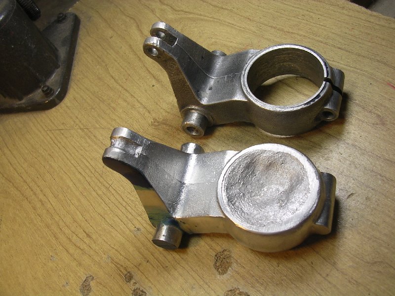

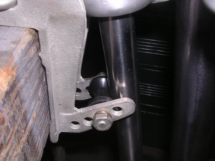

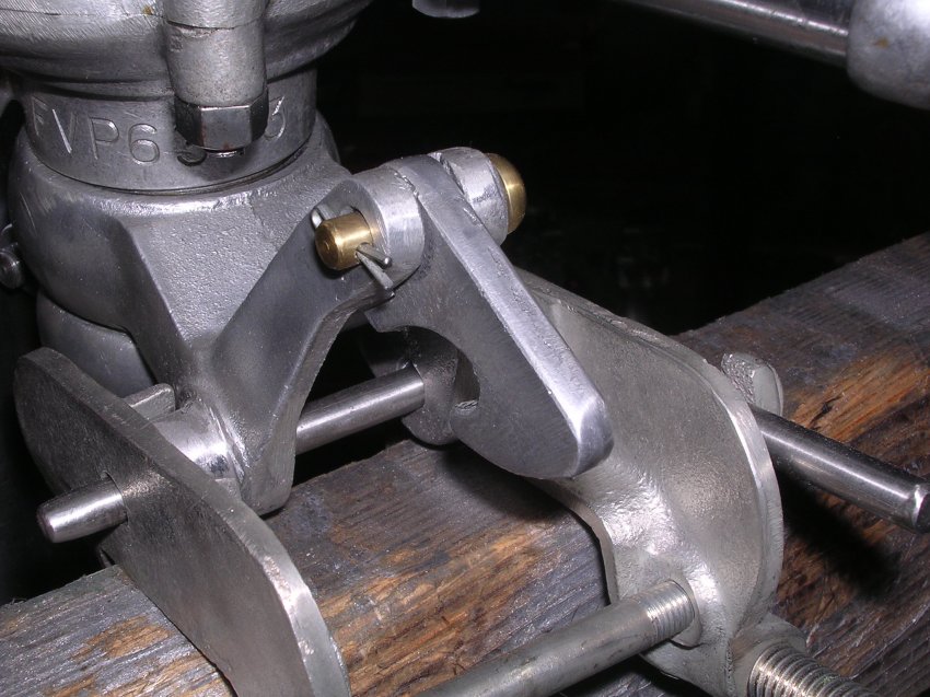

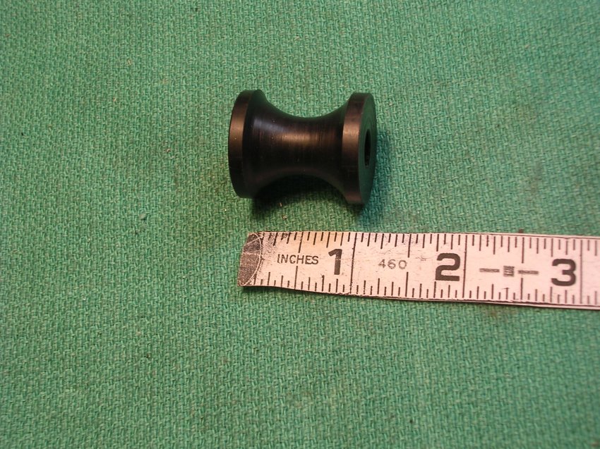

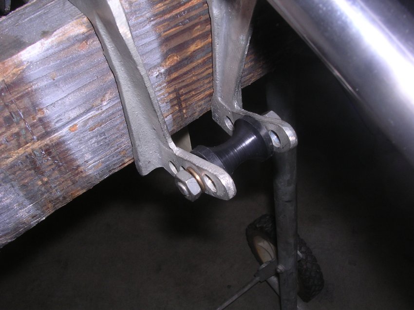

Made a couple of spool thrust pieces today. Pictures Do they look OK? Also picture of tip up hook. still need to switch to a brass split pin. WB

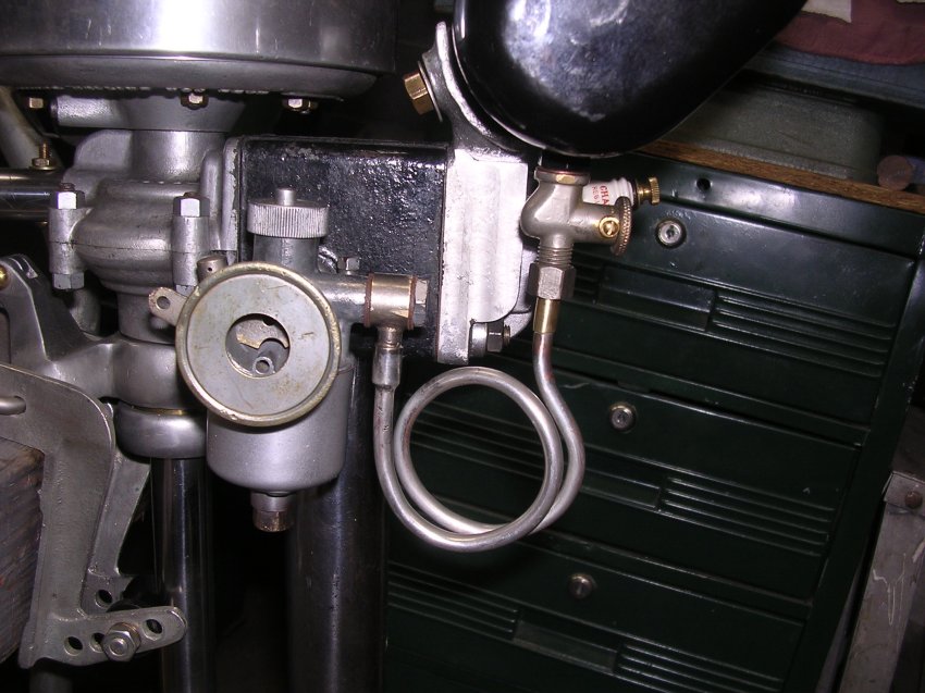

One more picture Fuel tube attached.
Re: fvp
Outstanding between you and keith we could all have new outboards fuel pipes looking good... :mrgreen: :mrgreen:

All looking the goods Art!

Fantastic spool thrust block. I'm assuming on well used motors they wear down. Is there a market to make a commercial quantity of them?

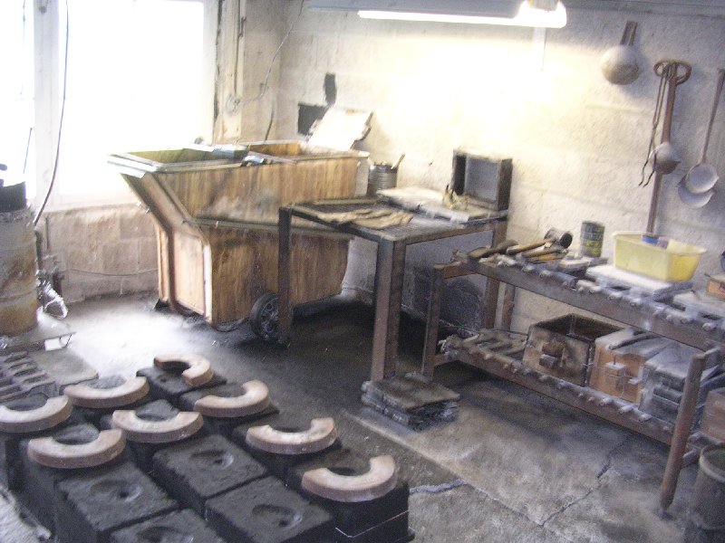

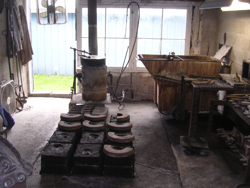

Nice castings!
Green sand or petrobond?
What is the diameter are the props?

Various questions answered: I use Petro Bond sand. Will post a couple pictures of my foundry. It is 15' X 30' and is a n attached room to my Garage. Made my own melting furnace. Have had it and used it since 1976. Same sand, just revitalized every few years. Much fun. Thrust spools : I made from a 1" dia Delrin plastic rod. I made a 1/2" Rad. cutting tool to make the curve diameter cut. It took about an hour, Market for them ? Who will pay an hour labour for that piece? How many F or FV or FVP are there needing them. Anyone with a lathe can make one in an hour as well. Right now I used up my black 1" plastic rod , will need to find some more. Props and diameters: I have cast about 6 or so different props, two blade for 102's , three blade for 40+ and little forty minus, etc. Those I have needed for my Seagulls. Please PM Me with specific need , and I will see if I have one cast.

Water bug for an 1" 1/8 diameter drive shaft tube, I would guess the radius ought to be 9/16", & if I remember right they were made from Bakerlite, (Keith would know for sure), Delrin should make a perfect modern replacement, cheap with a bit of flexibility & less likely to damage the chrome.
