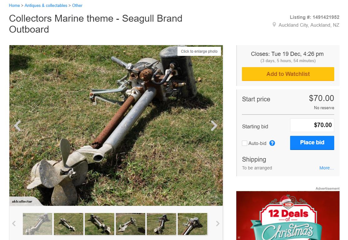

We are into fixing anything here in New Zealand!
When you see the prices of some of the crap that people are trying to sell and say it is usefull!
Ok now I'm not saying that I would buy this, as the only thing that may be usefull would be the fuel tank (maybe). But you see my point about the cost of things!
Re: New (to me) 40+
That in my eyes could be a good source for spares if it comes apart without too much fuss. Is that an LS?
I can see a fuel tank,powerhead, exhaust tube, gearbox and prop,transom bracket,tiller arm,throttle lever,throttle cable,fuel line maybe even half a carb all ripe for salvage on there. The drive tube is shot to bits as is the drive shaft by the looks of it, but this is the sort of thing that could breathe life into 2 or 3 more LS's with missing parts. £36 or $70 NZ might sound like a lot of money for a pile of crap, but we've seen all too often that motors get broken up for spares and the value of spares on their own seem to command a much higher price than a complete motor. The way of the world i suppose.
That's one thing i find interesting with this hobby.
How other folks get around certain problems that would absolutely scupper some people, and yet to others it's down to their ingenuity that keeps these old gulls going.
I guess it's unfortunate for you guys on the other side of the world that shipping costs play such a big part in what you do over there.
It's somewhat easier for us in the UK that we CAN just pop down to our local supplier or buy online the bits right off the shelf if we needed.
At the end of the day it boils down to how much you'd be willing to spend in time and money resurrecting an old seagull. Only YOU will know if it's too expensive as there will always be somebody else out there with deeper pockets than you.
