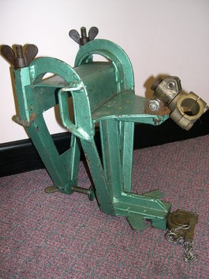

More clamps
Re: SD4985L3
That is an interesting bracket Rene. Same colour as mine but yours has a pivoting top driveshaft clamp. Have you had it for long? I haven't seen it before. That makes about 5 that l know of. Anyone else have an SD side mount bracket?
Good to see you back too.
Cheers, Hugo.
Re: SD4985L3
Hi Hugo, the green clamp does not belong to me, it’s just a photo I found a while back, mine is the black one the previous page, it’s amazing that so few have survived, there are probably more Marston twins than side mounted SD brackets.

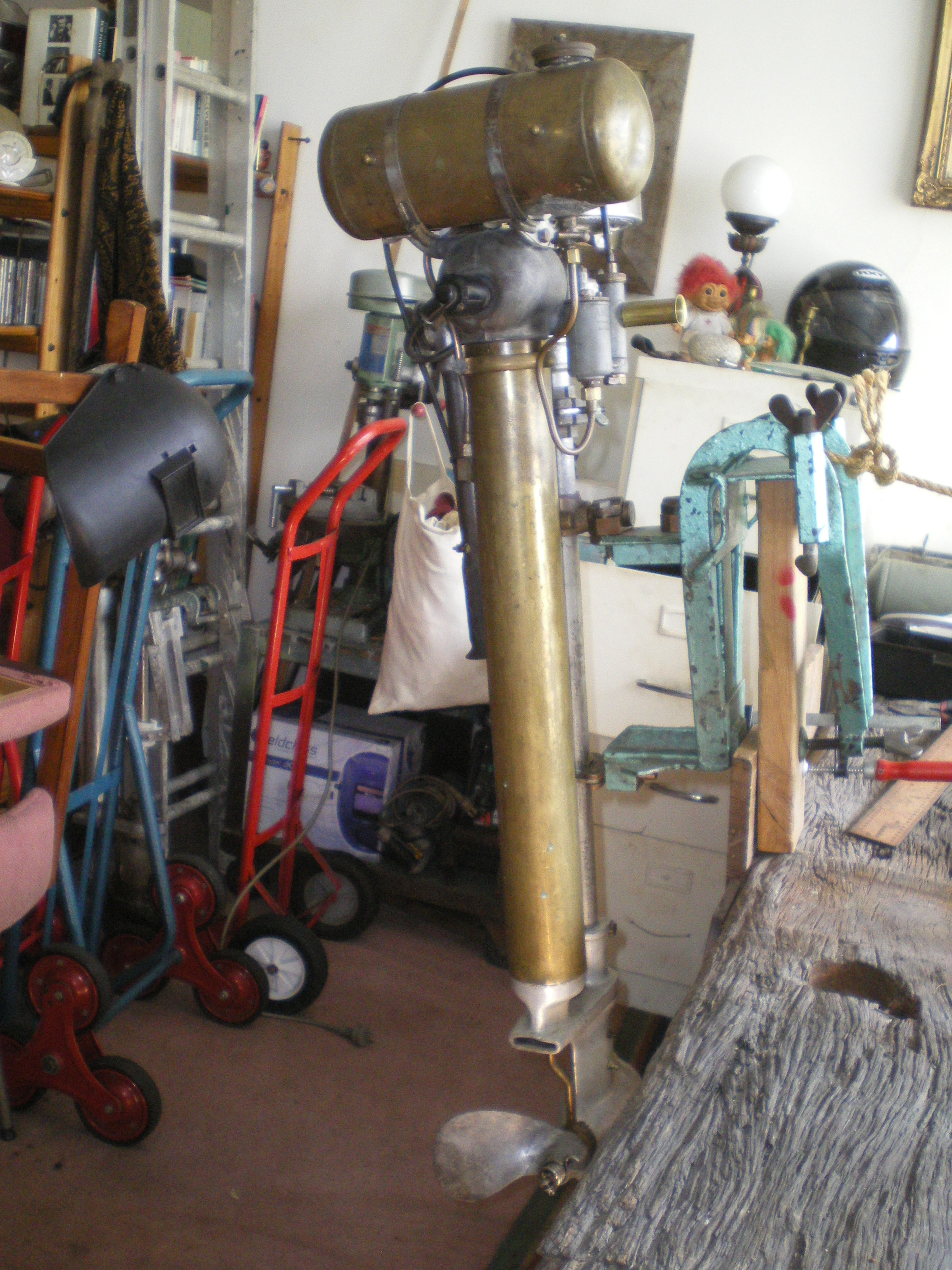

Nice motor, I like them in “working mans clothes” interesting height adjuster you have there,
Also, Hugo I seem to remember that welding mask.... in fact I sure I saw your wife wearing it....
Excel.... I’m in the same boat as you on that one, it’s easier to take a photo of hand written notes :oops:
Re: SD4985L3
The height adjustor I believe is a Marston component. That motor in question was painted completely blue when l found her but she does have a steel tank someplace to reacquainted with. Interestingly none of the three steel tanks l have have any remains of a decal so there is a mystery why some have decals and others not. A theory is circulating that they were cleaned up by the likes of Arthur Bray and the decal was added then but if that was so why was the remains of the side bracket left attached to the drivetube if they where pimped up for resale? We need to find some more period photos to work out what is going on with the decals.
Yes you recognise the welding helmet René. Fortunately she wasn't a wife and her welding skills weren't acceptable so l had to let her go. It is hard to find women with welding skills these days. Their mothers have a lot to answer for.

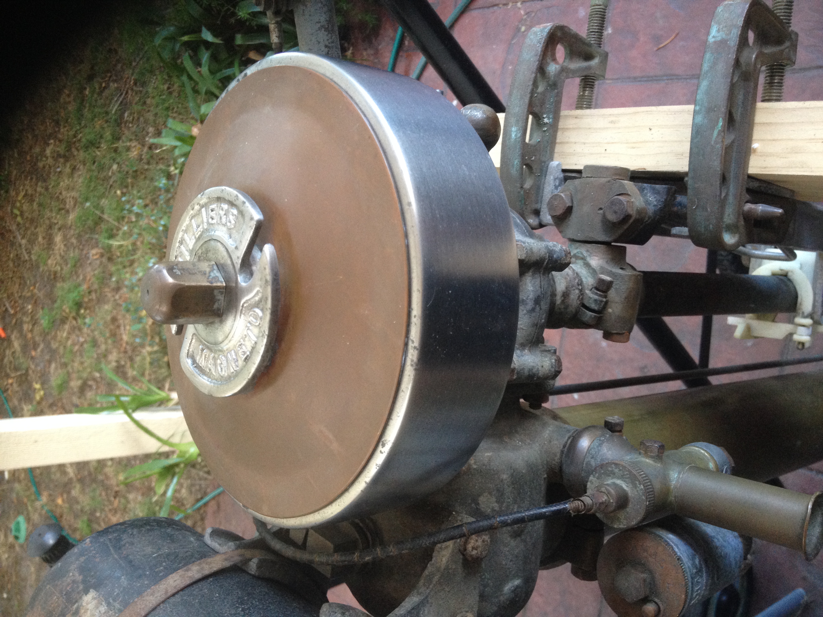

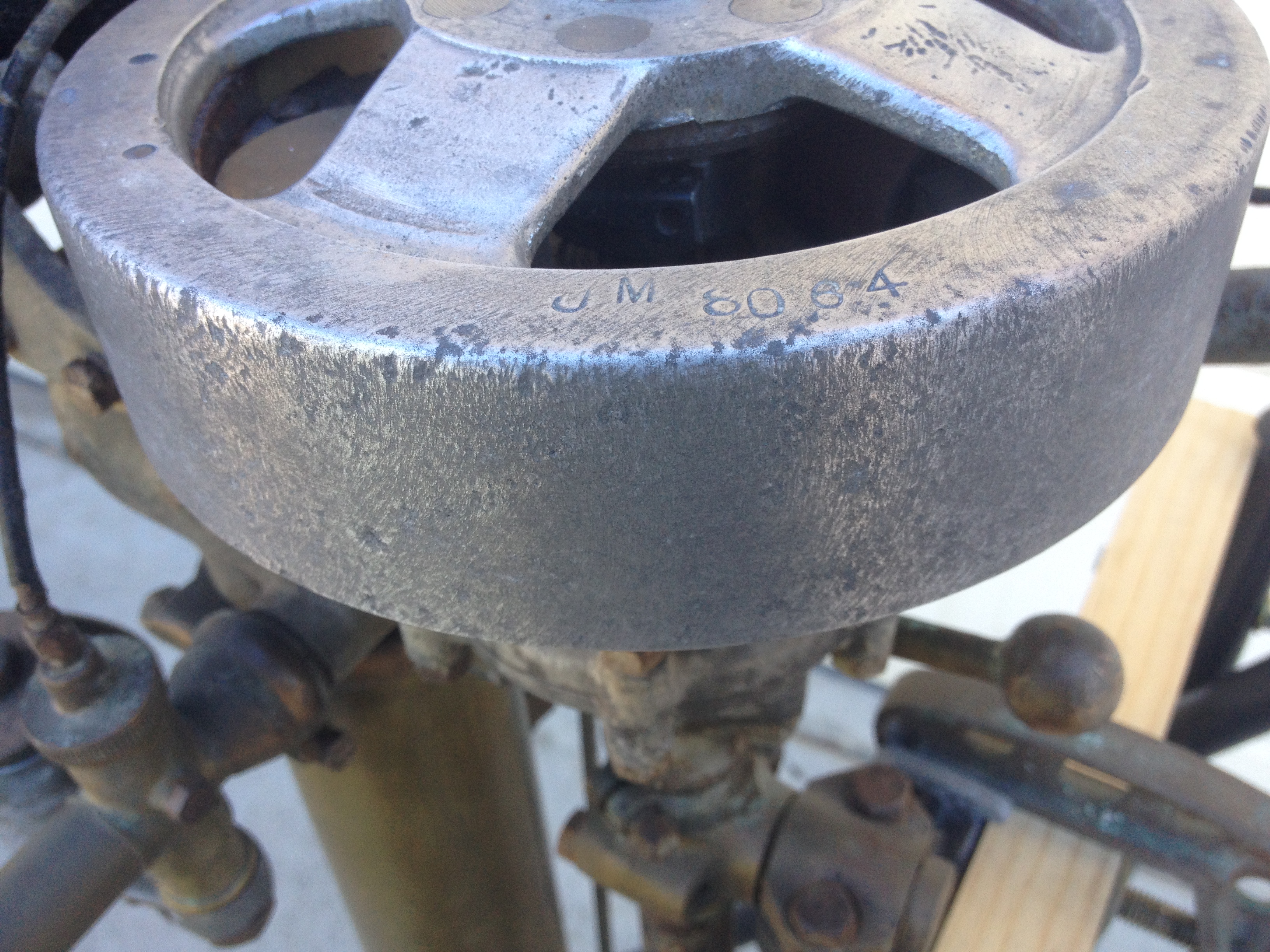

So I've had the SD for a couple of weeks now and having been attending to it whilst also working on the Commando and a Verity. A few pics to give some idea as to the issues noted so far and the progress? made.
I thought I'd better start with the flywheel as it desperately needed some attention. Very rough to start with but now in far more acceptable condition.

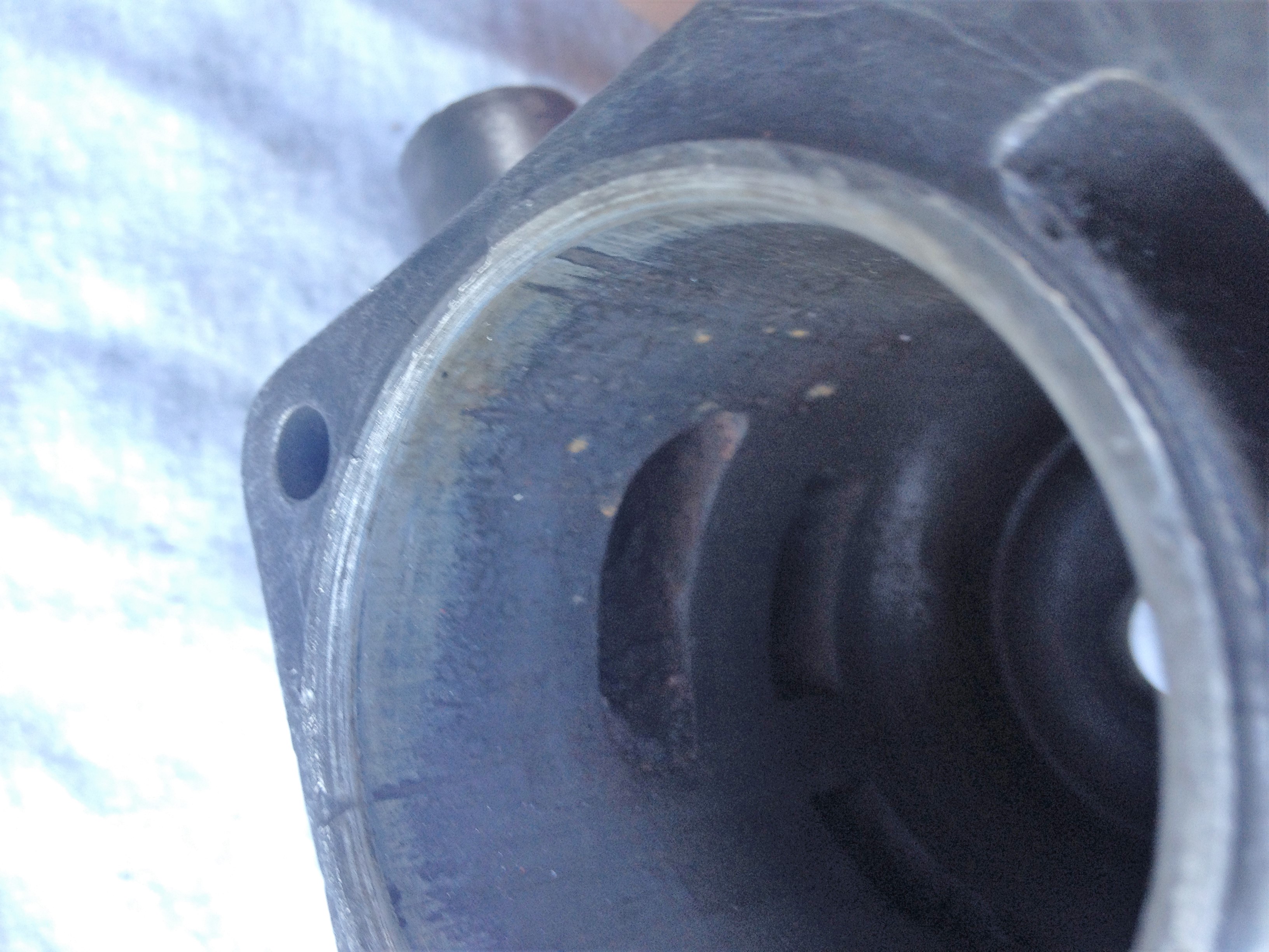

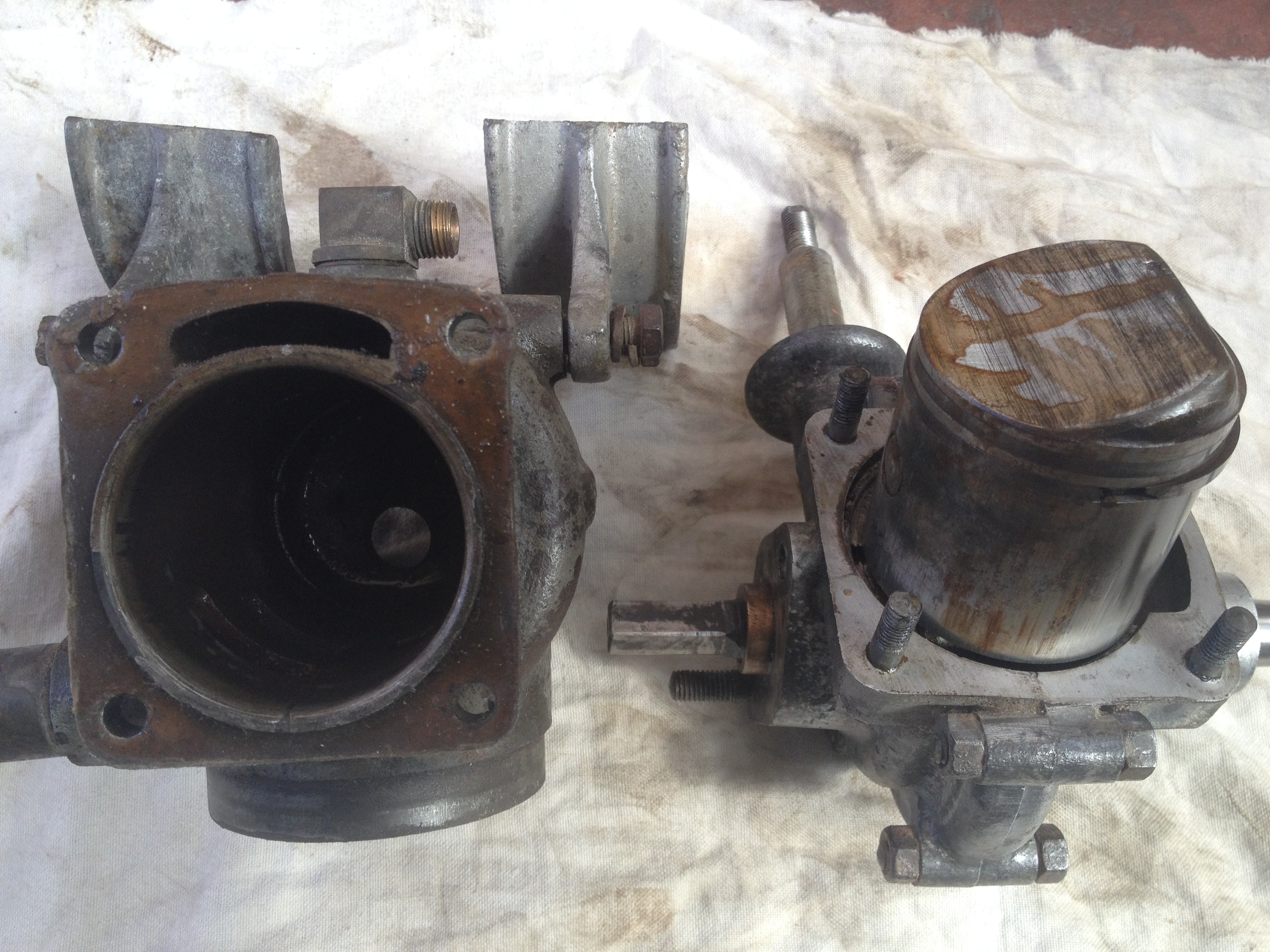

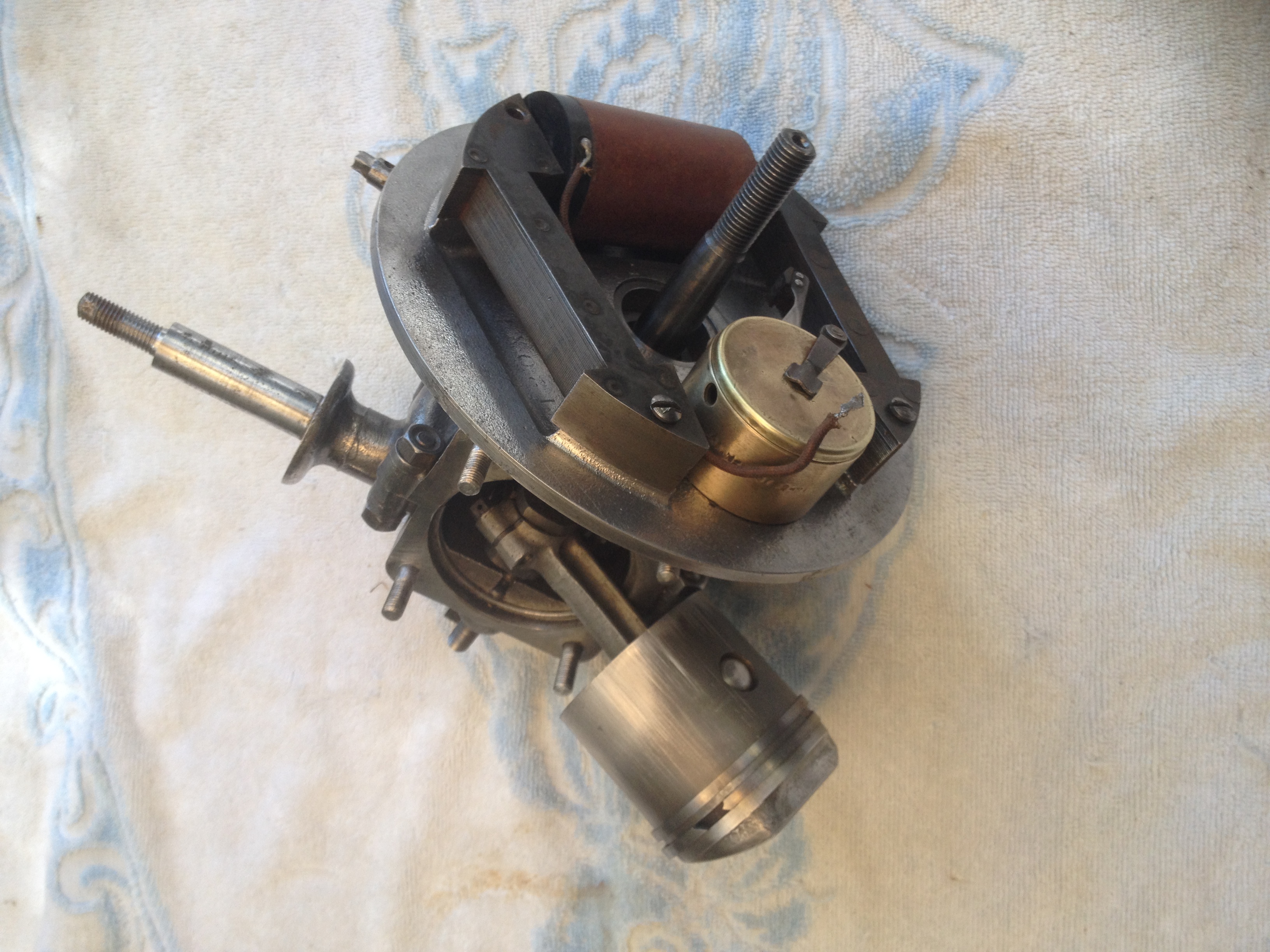

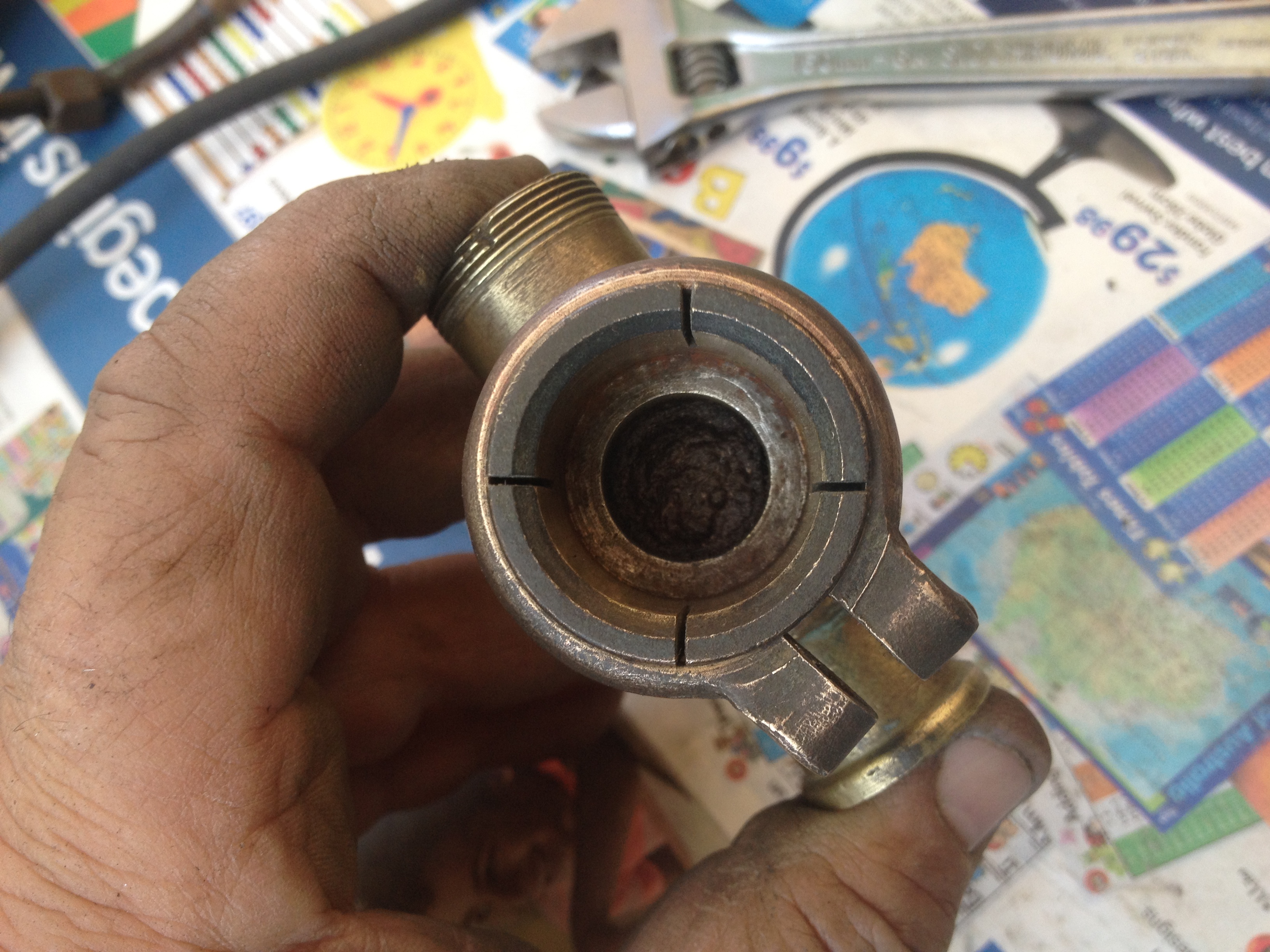

Engine didn't feel quite right to turn albeit that there we no odd noises, and there was some compression. Open inspection revealed a hornets nest (no uncommon in Qld), moisture in the bore and stuck rings.
Re: SD4985L3

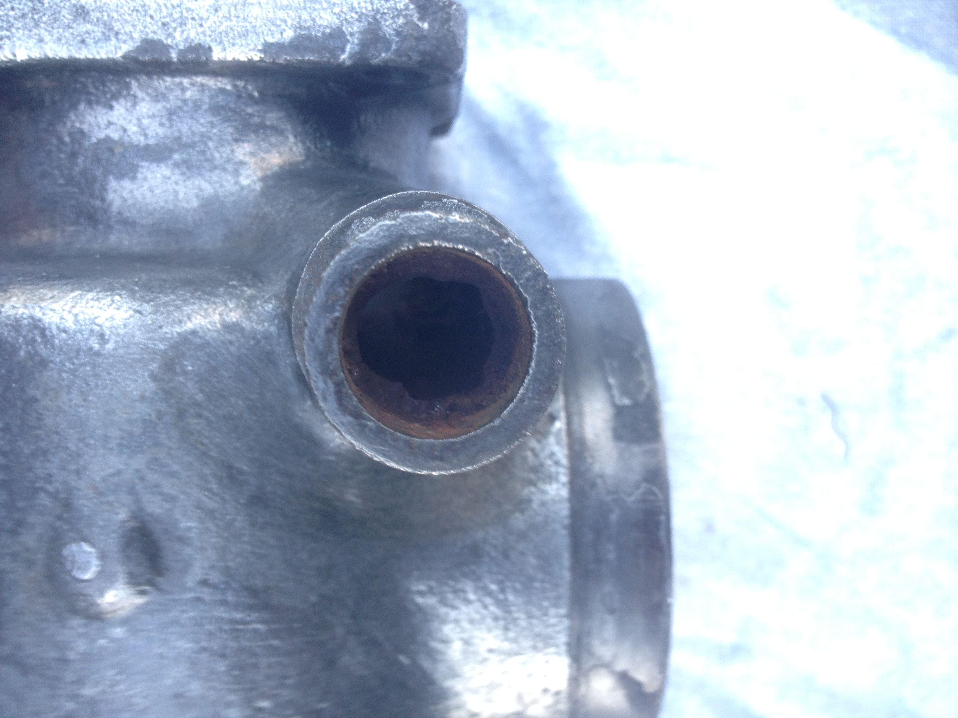

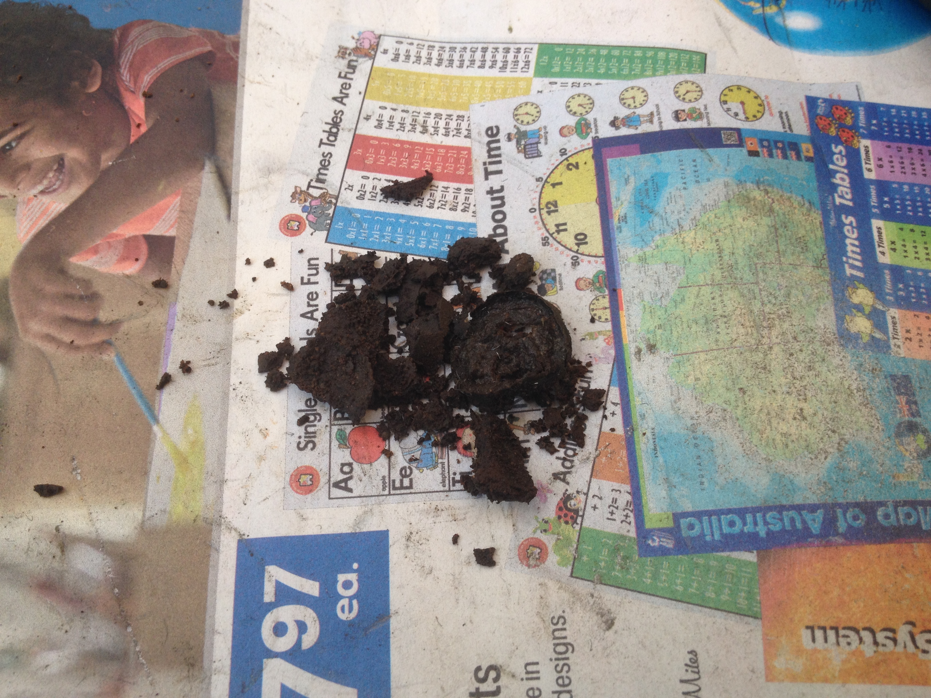

Hornets mud inside the intake and entering the barrel.
Rings freed up and some external cleaning before a further strip down.

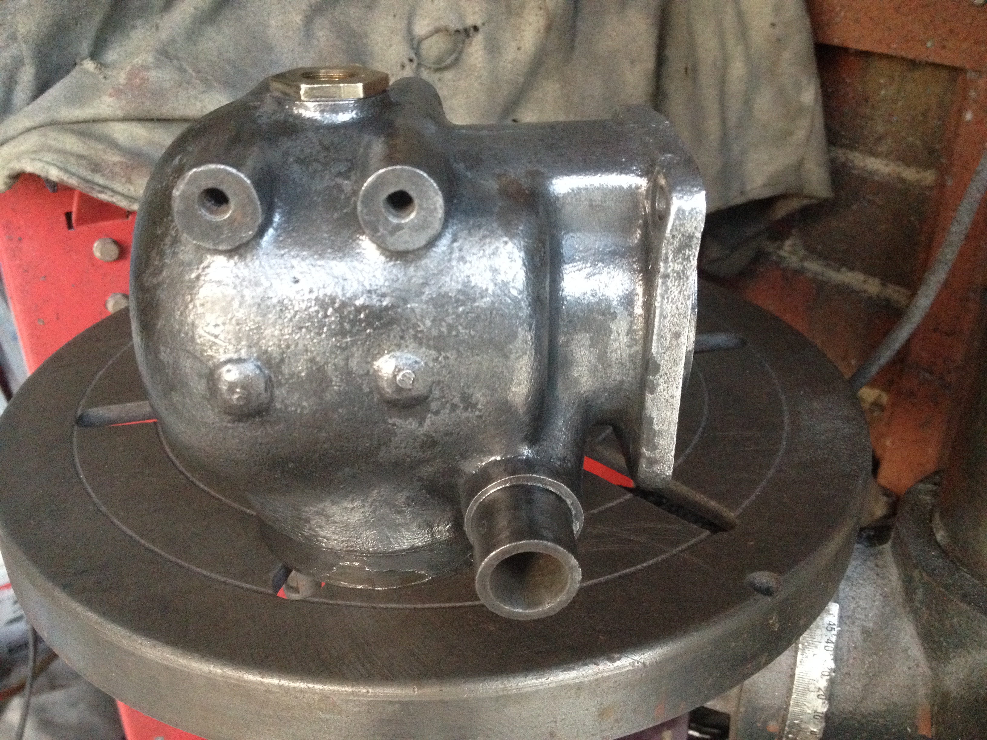

Was surprised to find that barrel still has much of it's external plating. Not sure now how to proceed eg oil or clear coat to help preserve or paint. Interested to get your thoughts guys, as to what course of action you have taken when faced with a similar situation.

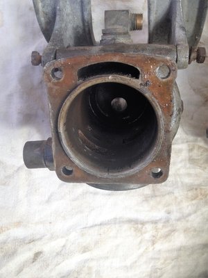

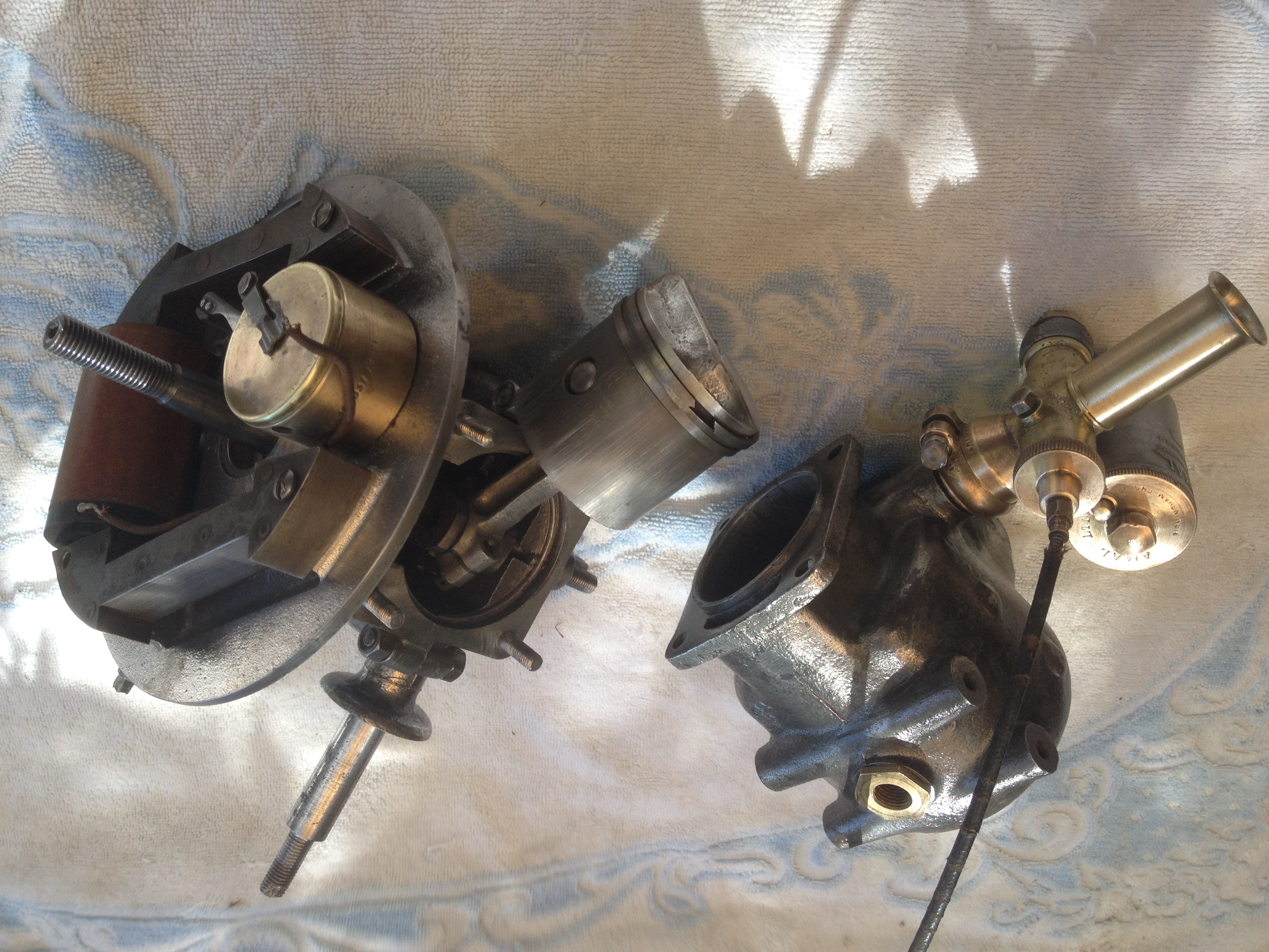

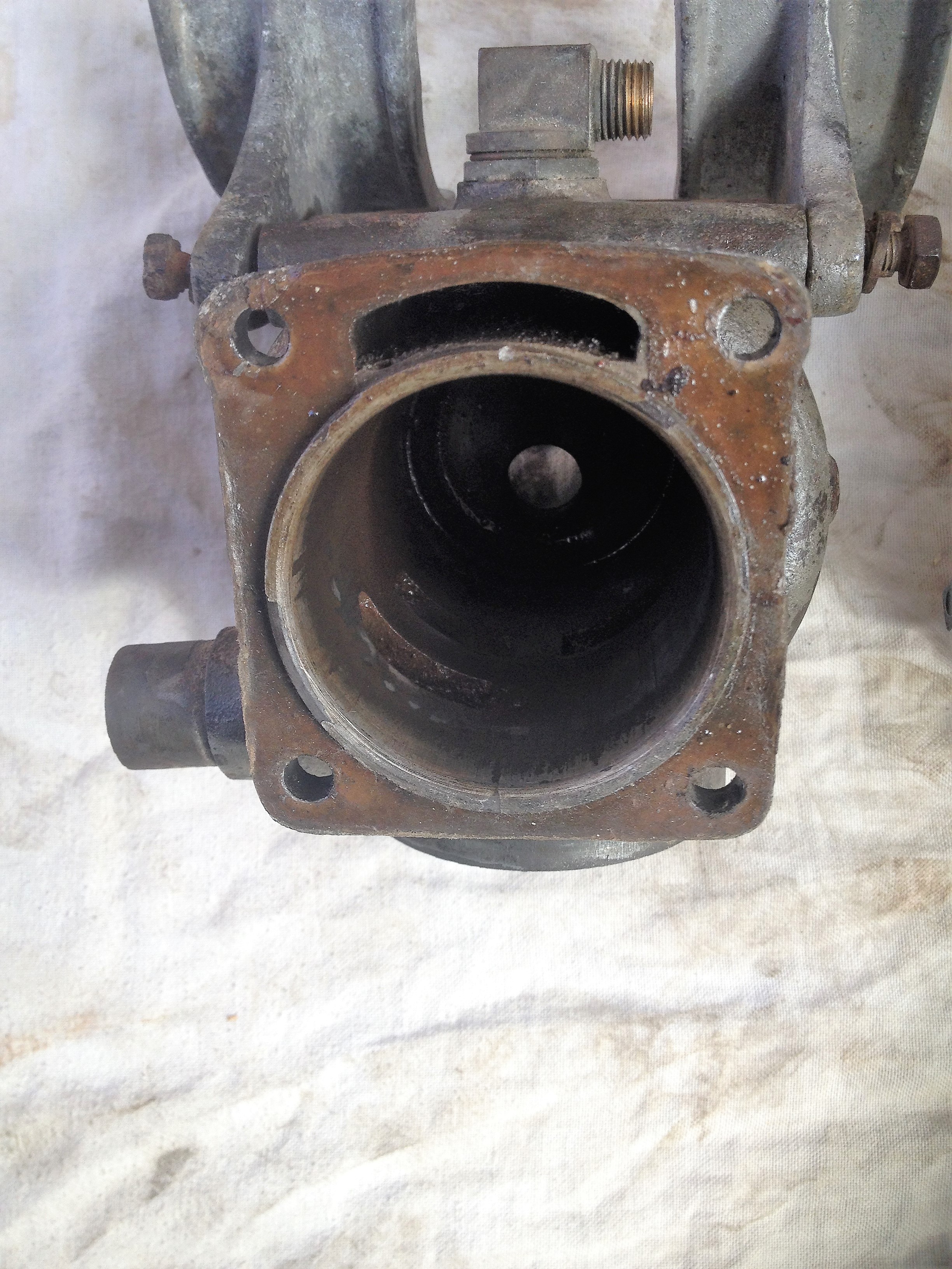

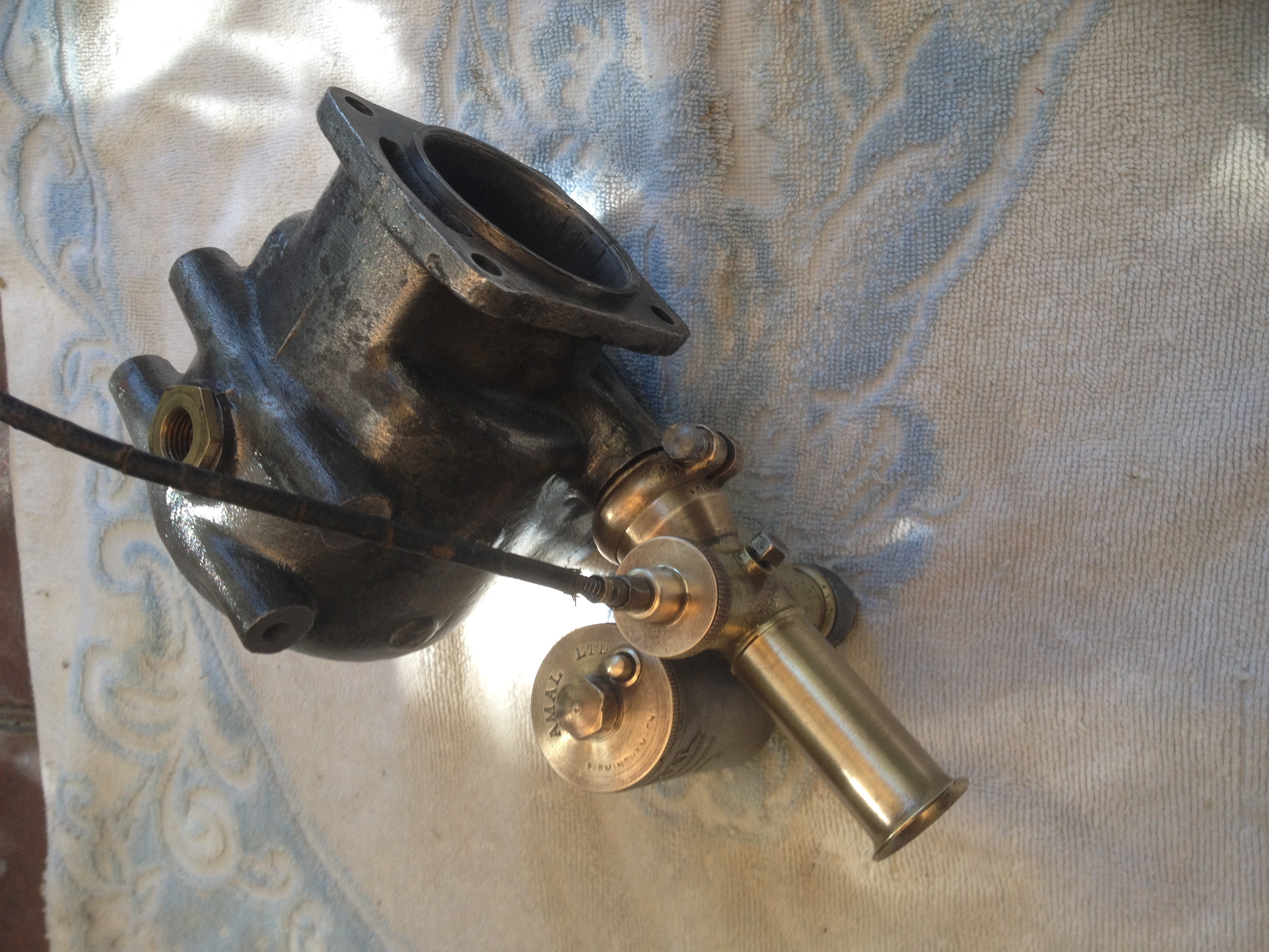

Attending to the carburettor and magneto.
First two image shows extent of the hornets nest, carburetor intake completely blocked up and amount of mud removed ie just from the carby.
And after a bit of a tidy up. Carburettor doesn't clamp up tightly against the intake, so will form some thin sheet of brass to take up the slack.

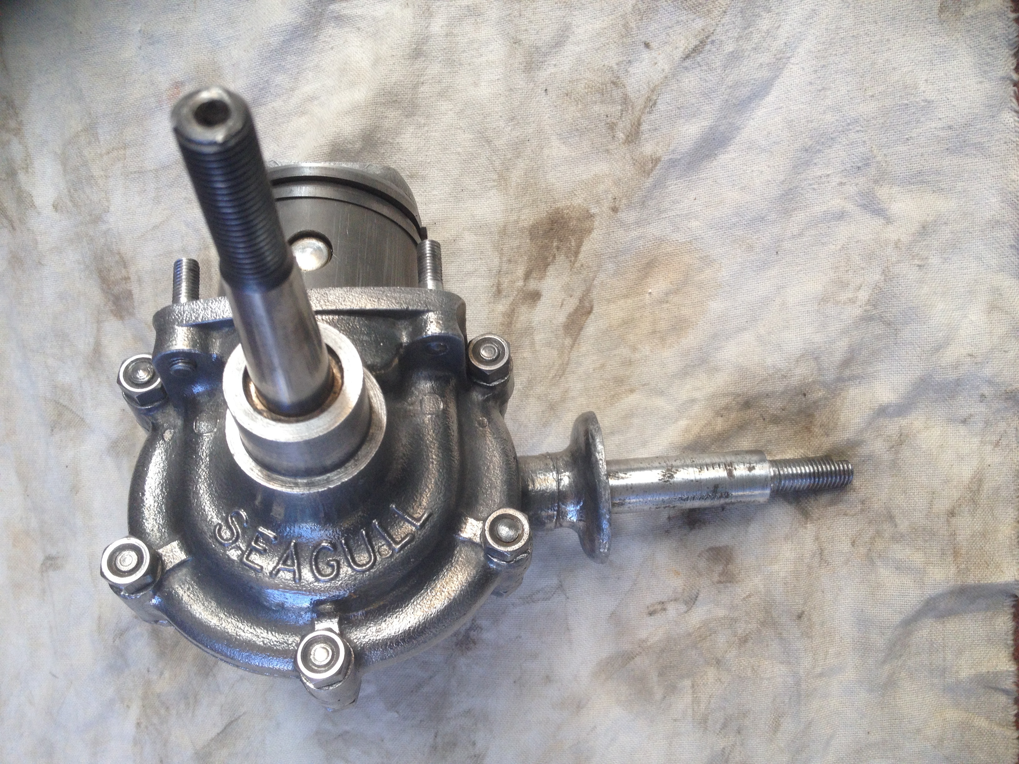

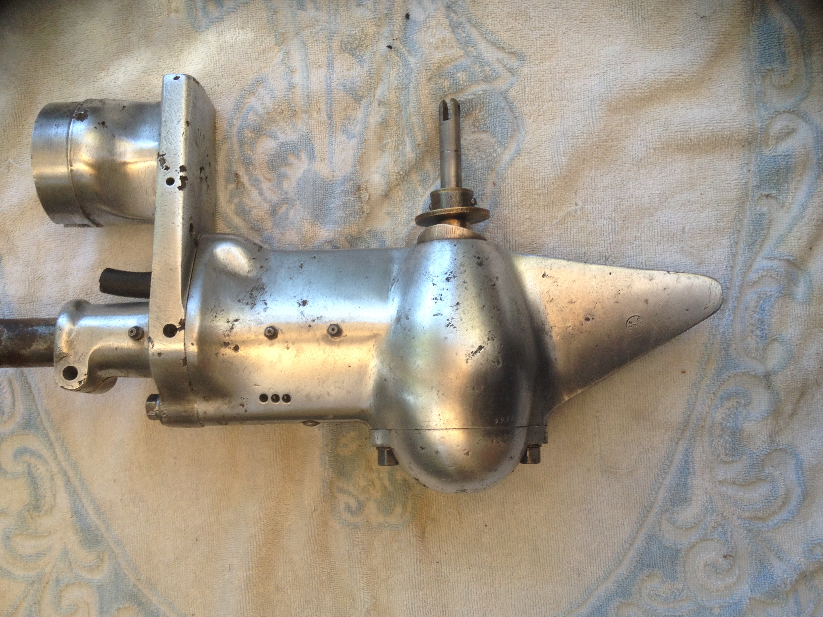

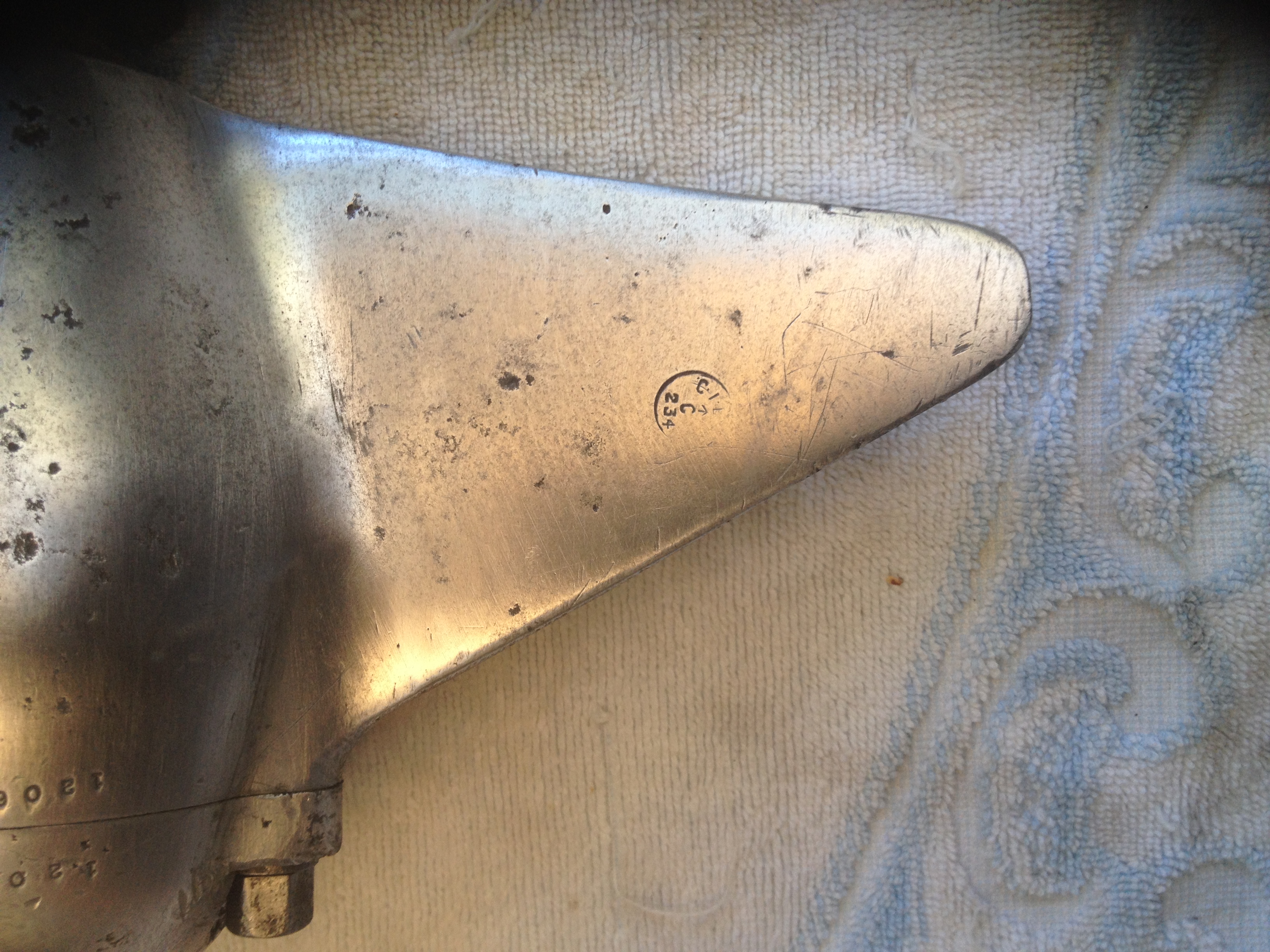

Quick external clean of the gearbox and prop. Am yet to disassemble completely, however there are no signs of excessive wear on the shaft or bearings noted thus far.

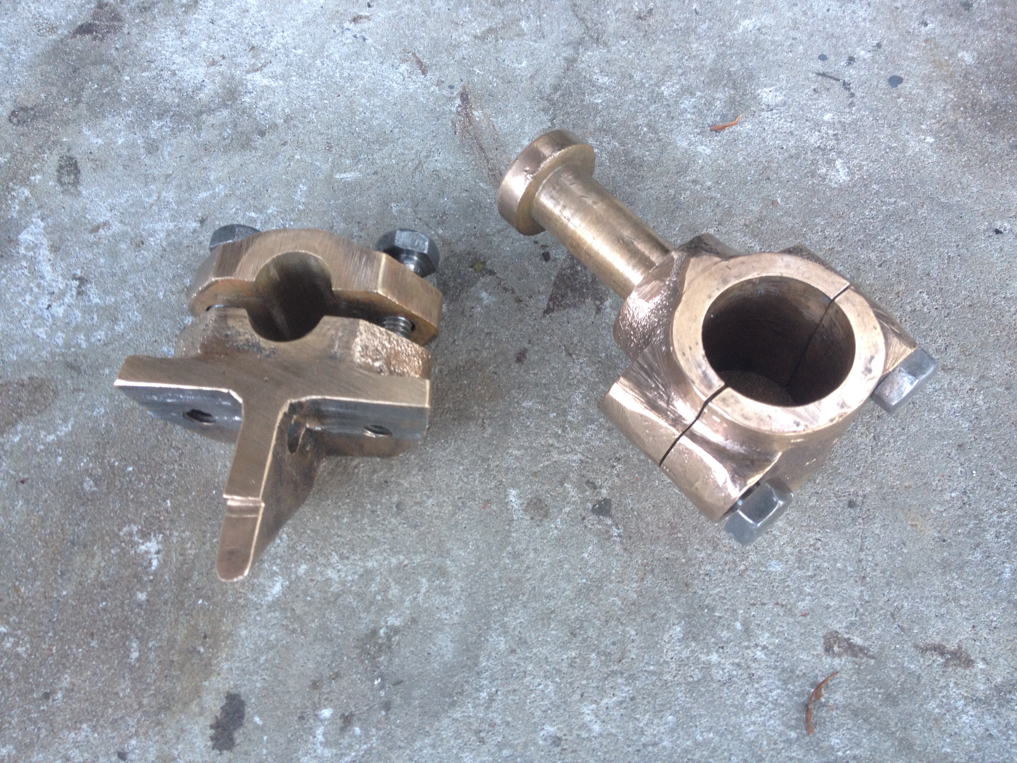

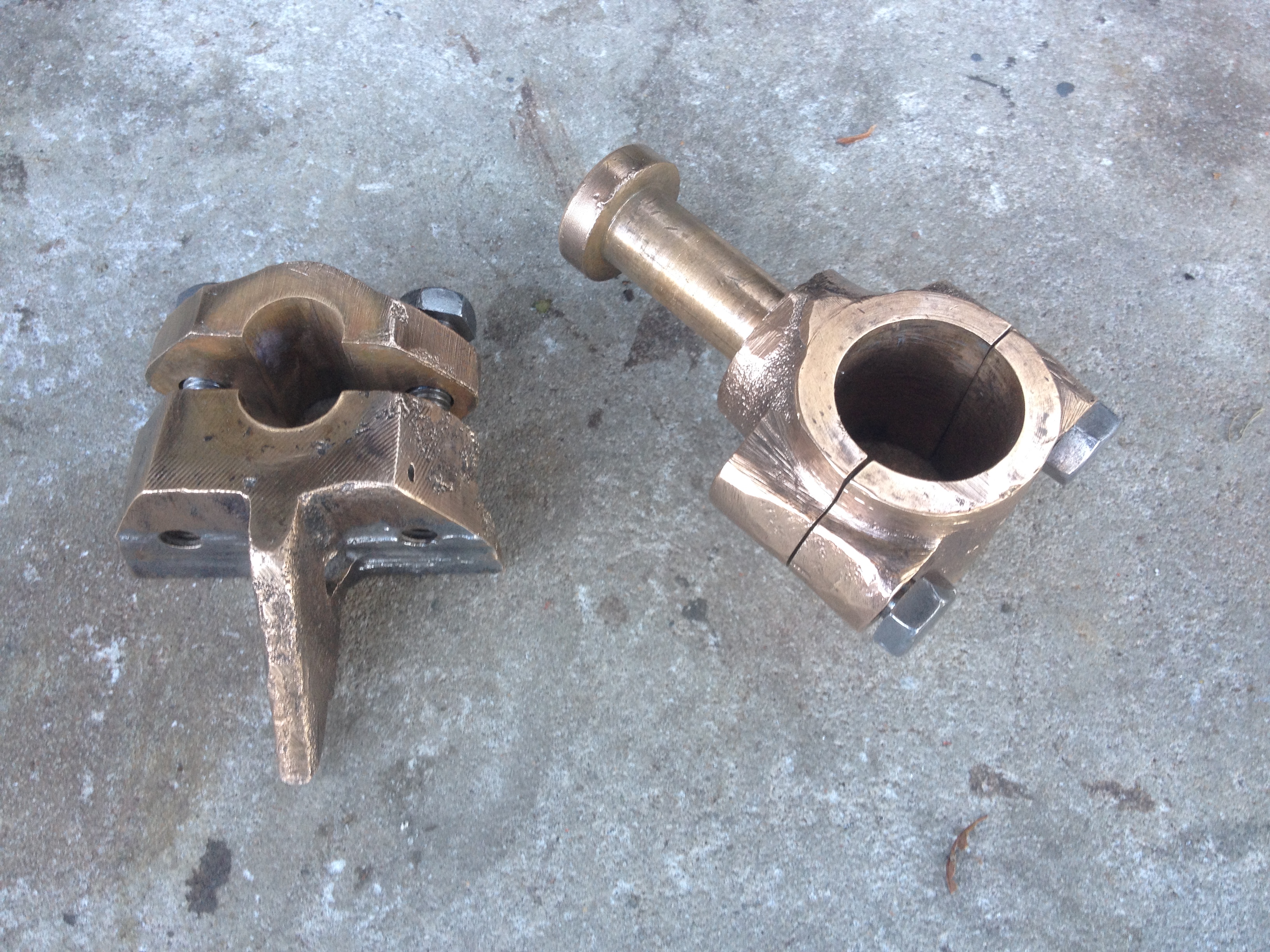

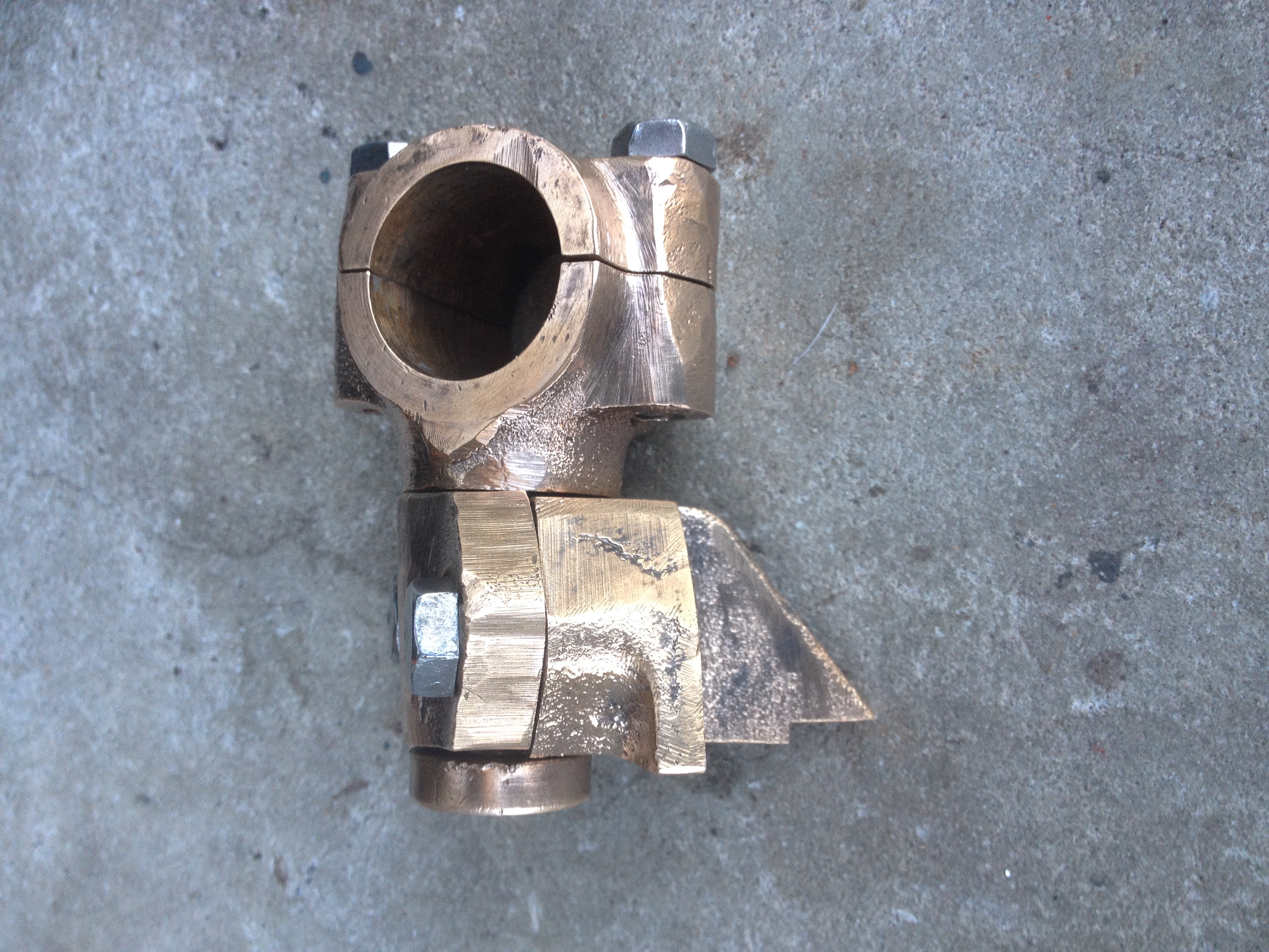

On to the side mount clamp. The rear section (that fits to the transom assembly) I've never seen before. It requires a metal tube either side which the pin passes through, yet there is still some slack and that allows irregular movement which does not feel right. Any ideas?
Look forward to your comments.
