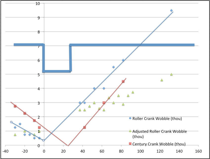

I've made some more careful measurements on my crude wobble rig. Plotted the wobble at several points along the crank. Then gently "adjusted" it using a spreader made of 2 nuts & a short piece of studding between the crank webs. Here are the before and after plots so far.
points to right of webs taken with driveshaft end in vee block, points to left with flywheel end in vee block, both as close to crank web as possible to simulate bearing position.
Above 80mm on the horizontal scale we are off the bearing surface and onto the taper and then at 130 onto the plain surface behind the threaded section. The gap is the woodruff slot.
The crank now runs much more freely in the bearings with no feel of a "pinch" which it had before. The con-rod also runs freely now the old fuel residue has been removed.
As the instability in the vee blocks on my workbench is about 1-2 thou, I'm getting close to the limit of what I can do without a proper metrology table, or even a lathe, but may have one more go at adjusting. I'll think about it over Xmas.

Vertical axis is wobble in thou, horizontal axis position along crank in mm. Blue = before, green = after.points to right of webs taken with driveshaft end in vee block, points to left with flywheel end in vee block, both as close to crank web as possible to simulate bearing position.

Keen to see a pic of your rig! I have a couple cranks that need sorting, have been putting them off for a few years. Don’t have a lathe so would need to build a small rig.

The "rig" is as simple as it could be. 2 vee blocks and a dial gauge. One vee block is mounted on a heavy vice with small neodynium magnets, the other supports the adjustable arm (I think it came with one either the gauge or the blocks) that the gauge is mounted on, again with magnets. The vee block is oiled and the crank clamped down with a piece of oil-soaked leather under the bolt end, tight enough to hold it securely but so you can still turn the crank. In the picture I have the flywheel end in the vee block and am measuring the runout on the driveshaft end. I then turn it end for end and measure the flywheel end.andrew wrote: Fri Dec 25, 2020 3:48 pm Keen to see a pic of your rig! I have a couple cranks that need sorting, have been putting them off for a few years. Don’t have a lathe so would need to build a small rig.

It is very much a lash-up - it should all really be on one solid base. But its a start. I try to compensate for the random error caused by the rig moving by a thou when I rotate the crank, by taking multiple measurements at different points along the shaft. Bend should show up as increasing runout the further you get from the bend. Rotational misalignment should give a constant reading along the shaft. (Assuming the shafts themselves are not bent).
If you are starting from scratch I'm sure the engineers on the forum could offer some better advice. See earlier in the thread.
I had a go at measuring a "new old stock" century crank I have drawn lines on the graph and you can see that the distortion in the roller crank starts where the crankpin enters the driveshaft end web, but for the century crank it is at the other end of the crankpin. I think there is also about half a thou of run-out on the roller crank due to rotational misalignment of the crank web pin holes as the point of intersection of the lines is not on the x-axis.
I gather from the seagull service sheet that the runout should be less than 0.1mm / 4 thou measured between the bearings.
And the century crank is surprising bent given it a supposedly "new" item.
I should emphasise that careful attention should be paid to Charles' advice about how fragile these roller cranks are, if you are tempted to start straightening them yourself!

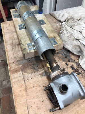

Have been busy in the garden most of this year but making some progress on KSR1100. I have for the time being given up on the roller crank and have sourced a plain bearing version to replace it. I'll come back to the roller later. Just a few comments and questions -
It was the devil's own job to get the exhaust tube off. Soaking in WD40, multiple hot air gun heat cycles, and lots of "wiggling" with the block in a vice all to no avail. In the end I use wide "builders band" to clamp the tube to a 9"x2" block of wood fixed to the workbench and drifted it off with a long drift up the tube against the inner exhaust flange. (I should have put some padding under the builders band as it has scratched the paintwork0
The aluminium verdigris was "drizabone" despite soaking in WD40 for weeks. But it's off. That enabled me to thoroughly check out the waterways, which are now nice and clear.
The block has some scorching to the paintwork over where the transfer ports run presumably indicating some past overheating - I can't see how there could be waterways around there so perhaps not surprising but is this something I should be worried about? And what is the core plug for? A casting mould feature? Or does it hide a tiny waterway? COUPLE OF QUESTIONS
What do people use to seal the inner exhaust flange to the block? The "gasket" such as it was disintegrated on dismantling. The replacement part no. TRN KF 010 does not seem to be available from Sheridans. Any idea what material they are made from?
The replacement plain bearing crank I have is from a Kingfisher and is identical to another one I have from a Curlew. (It is also wonderfully straight with no detectable runout!) The parts book shows them as the same part number for Curlew and Kingfisher. Also the flywheel balance weight is also the same for both in the parts book. This seems odd when the Century and 40 series cranks have different weights on the crank web. Oh well, it makes for better interchangeability but it is a bit of a puzzle.
To cap it all, it turns out that the Lerryn run this year is on the same day I have to drive to Scotland for New Year's celebrations. Oh well.

Put the top half of the crankcase back onto the cylinder , then you'll see why there's no paint in the transfer port area!
Re: KSR1100
Thank-you Charles, I see the problem. The scorched area is crowded by the flywheel housing. I can just detect similar scorching on my (still fully assembled) Osprey if I look carefully, although it is hard to see given how tight it is.

Cut a coloured paper gasket using a scalpel & the cylinder exhaust flange as a pattern, then take a photo of the paper lined up with the inner exhaust bolt holes to show your readers how disgracefully this inner exhaust fits.
The gasket doesn't need to be made from any material that's too sexy, it's only hot around the exhaust & must not be damaged by water as it's fully immersed.
