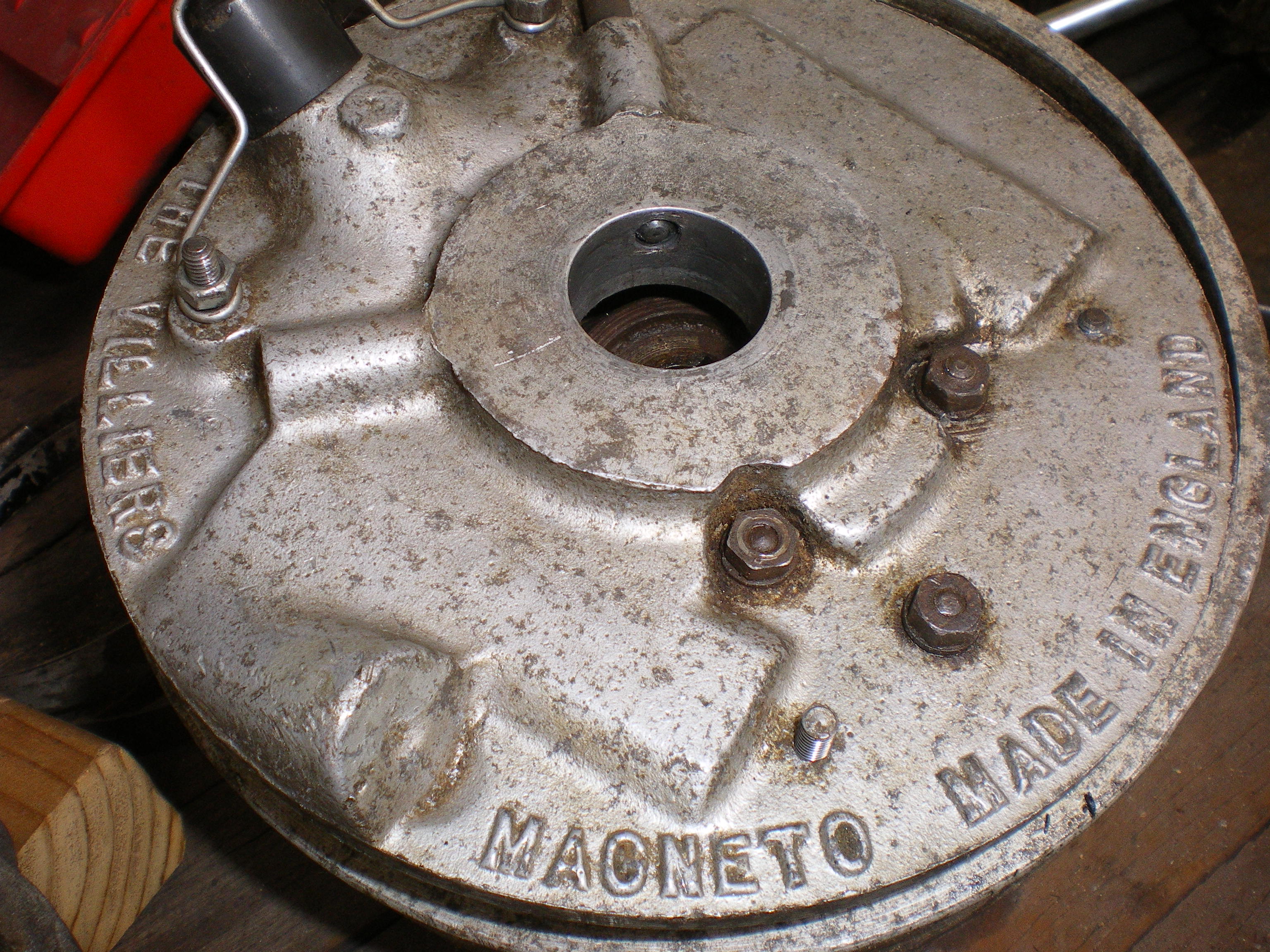

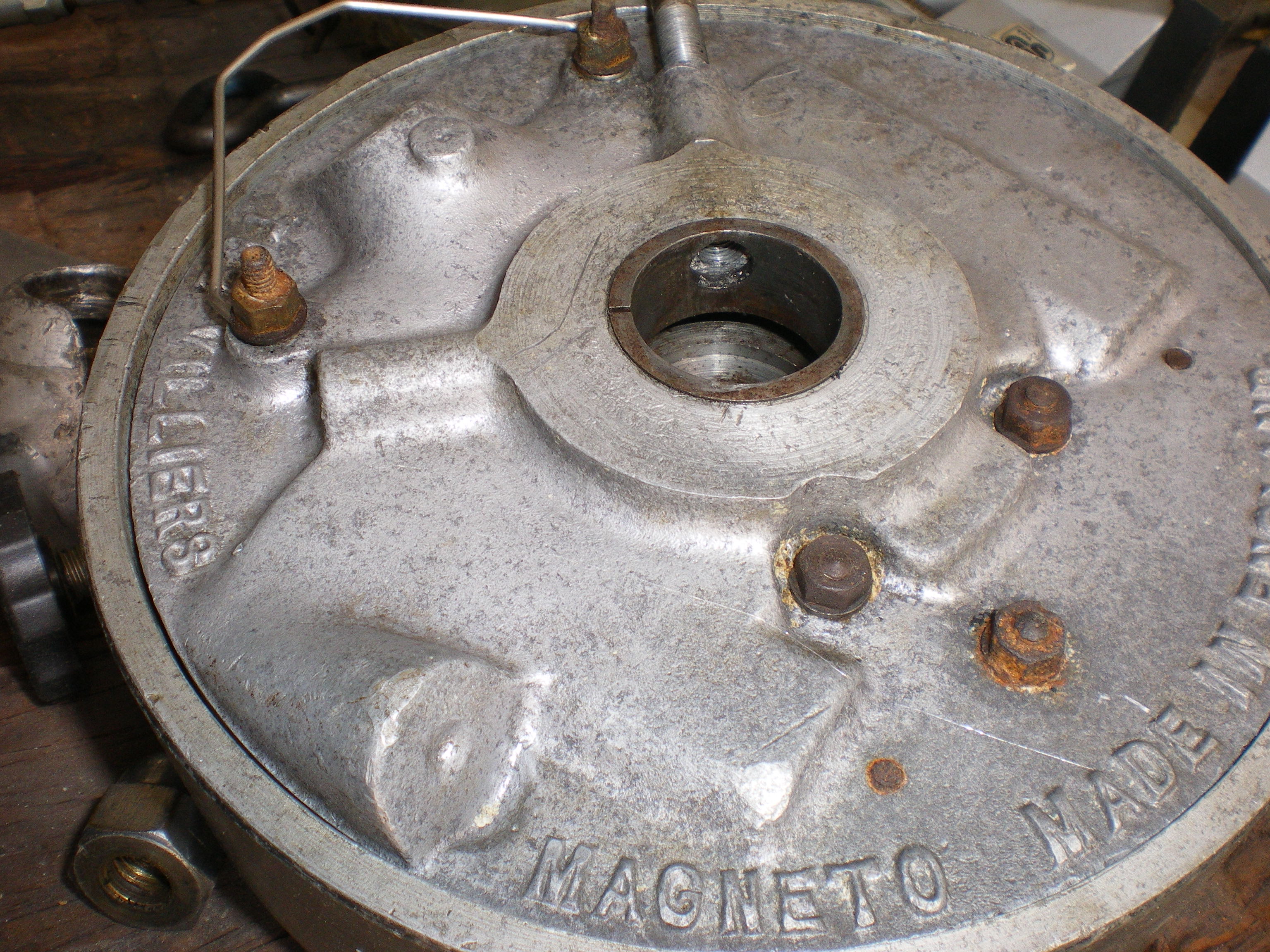

Oooh. I just remembered something. There were two different base plates. One with a sleeve where it fits the crankcase which the locating screw screws against (variable timing) and the other with a smaller aperture and no sleeve and a dimple in the crankcase. Has this got anything to do with renumbering?

I'm not convinced they're missing, the numbers seem to add up, If you can point out where my logic falls over let me know, I've just checked my pile of base plates waiting for restoration or robbing for bits, & there are at least 12 of them.
11 with sleeves & 1 without, never noticed this before (thanks Hugo), the strange thing is the sleeveless one has traces of green paint & no JM number.

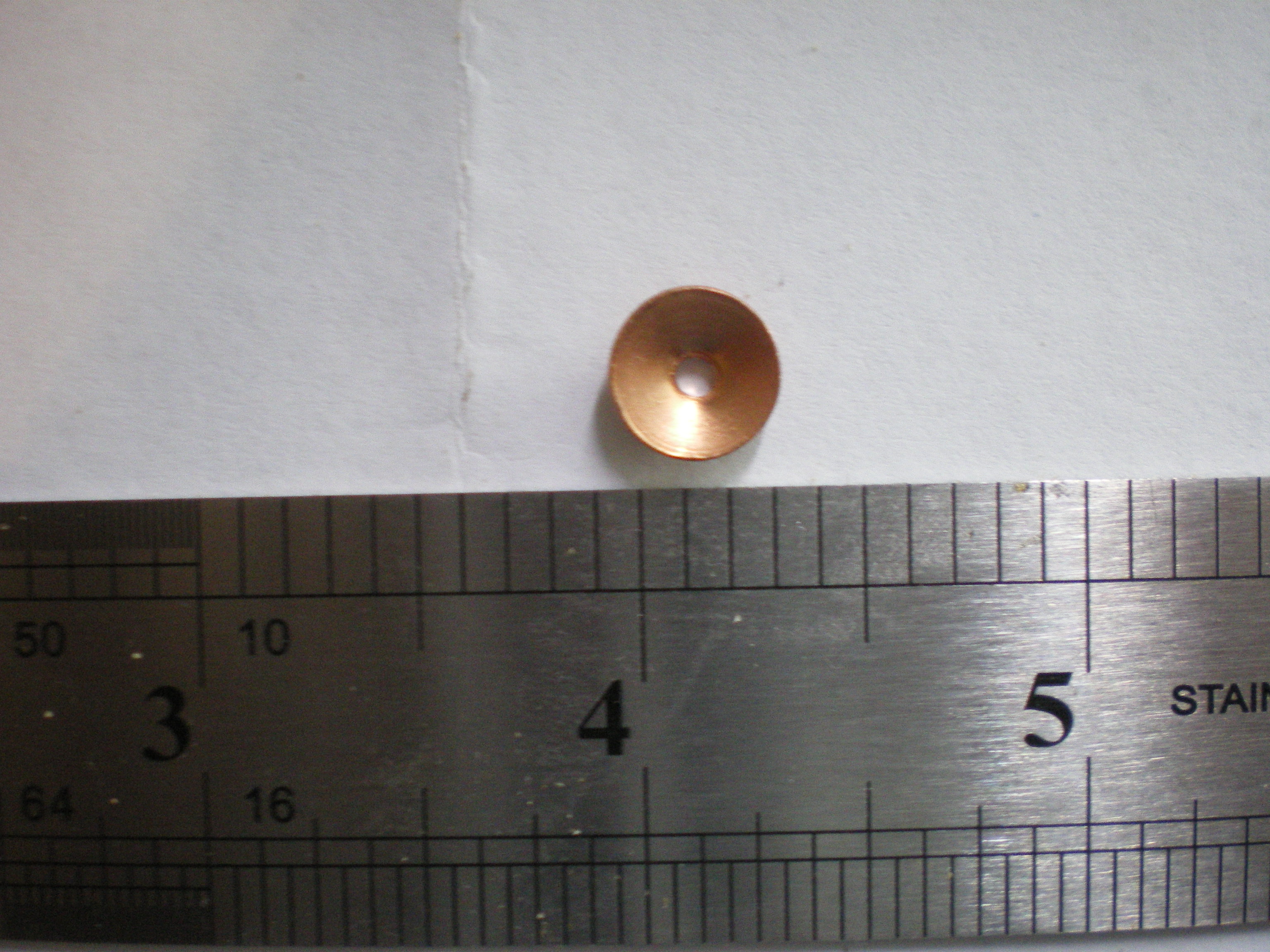

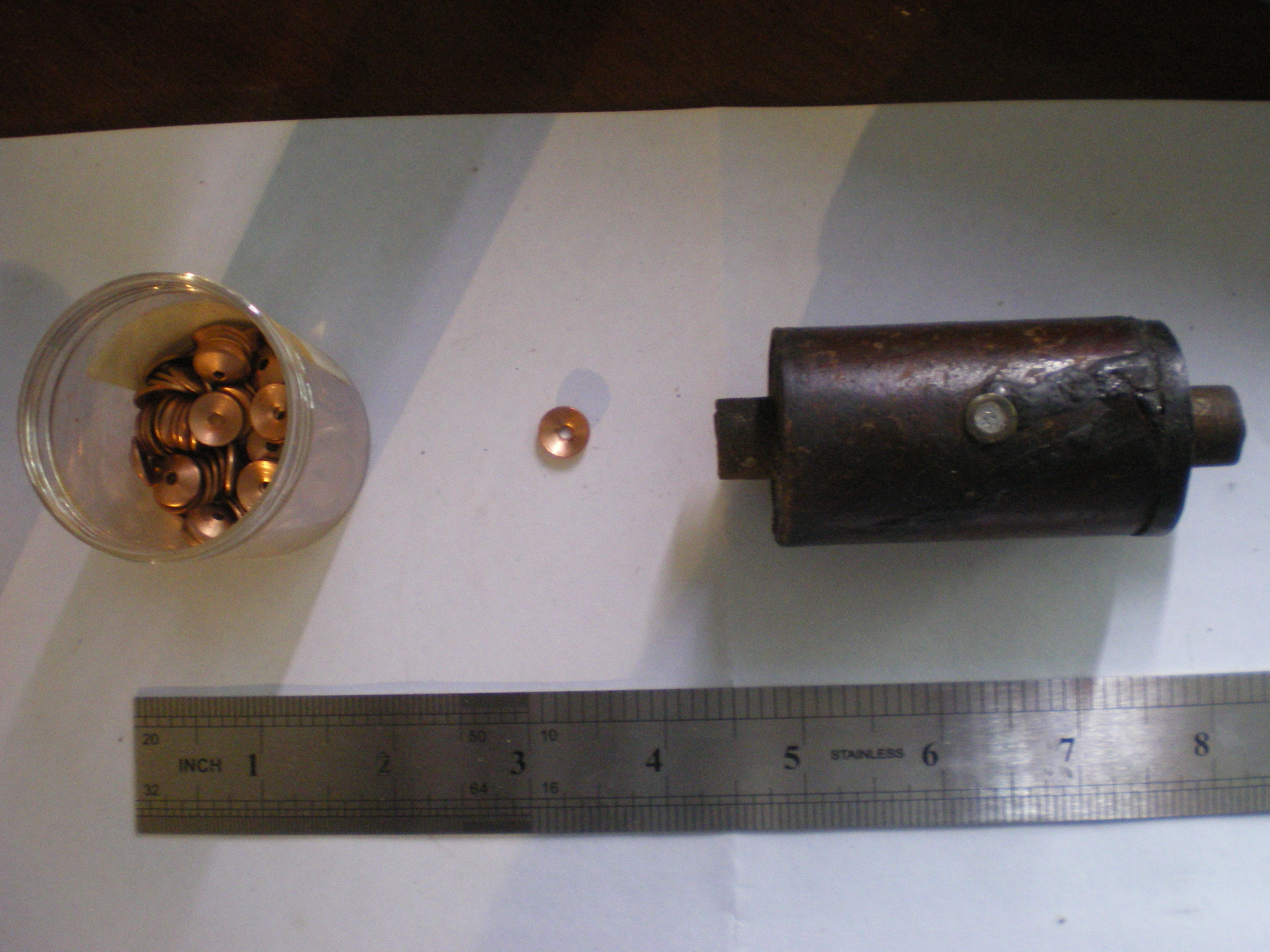

Just doing some riveting on my boat and realised the roves have a similarity to the HT pick up contact.
