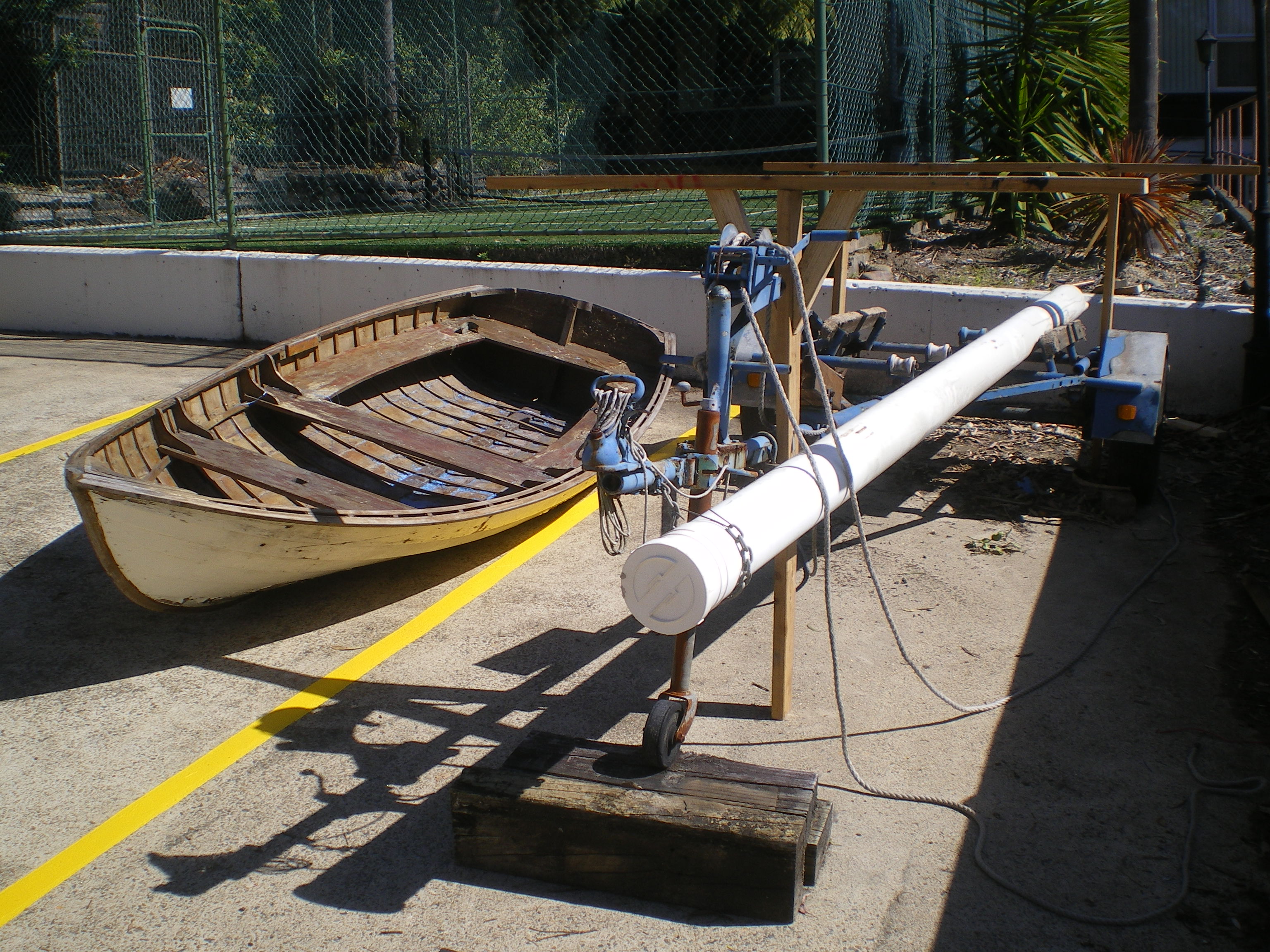

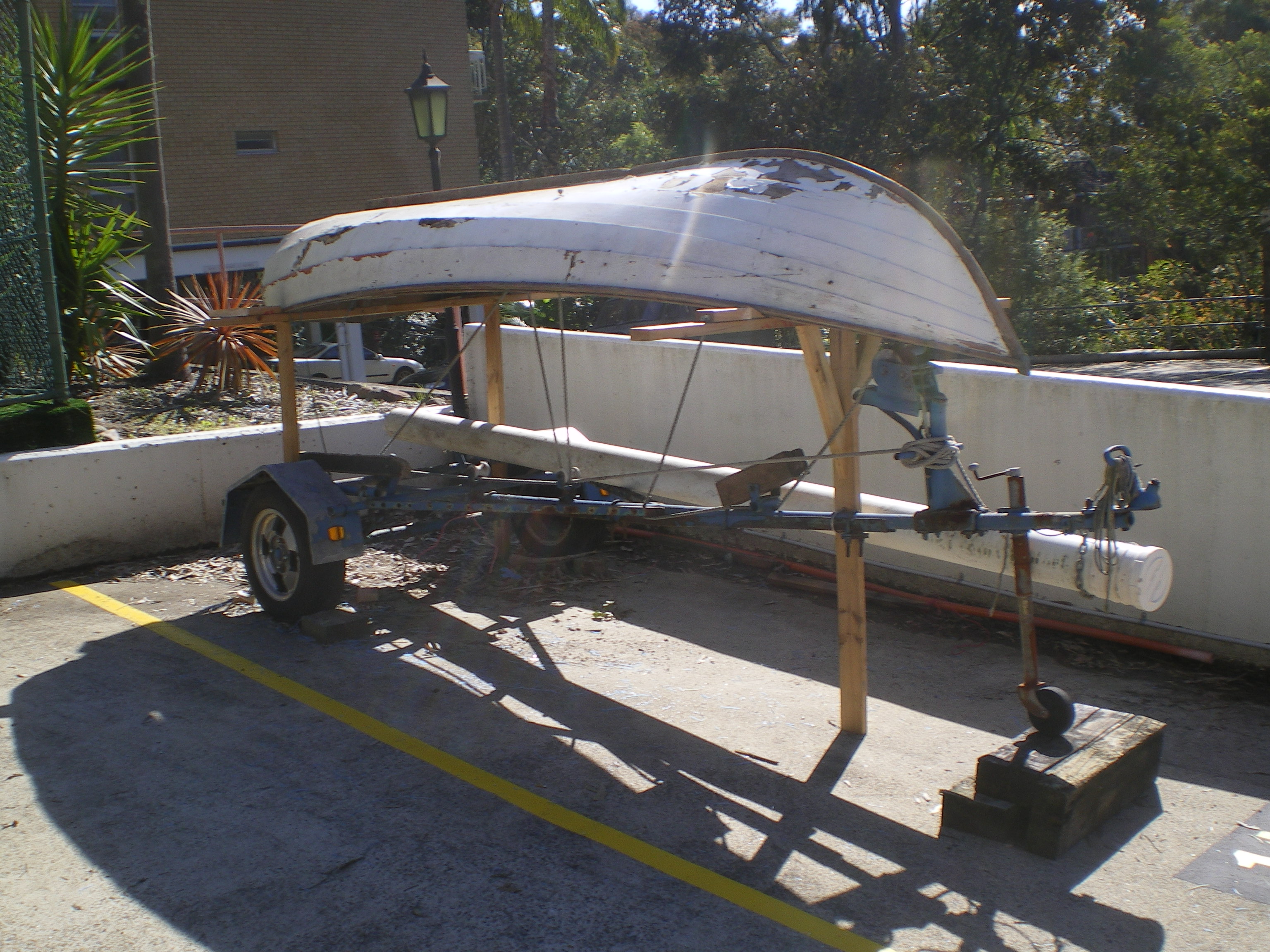

Ok, Finally I'm ready to start to repair. Marine Ply, (known as bondwood then) copper nails and roves circa 1947 - 51. ( I found that during my research stint at the library). Had to make frame as all work to be done in one car parking space including the trailer. The joys of inner city living

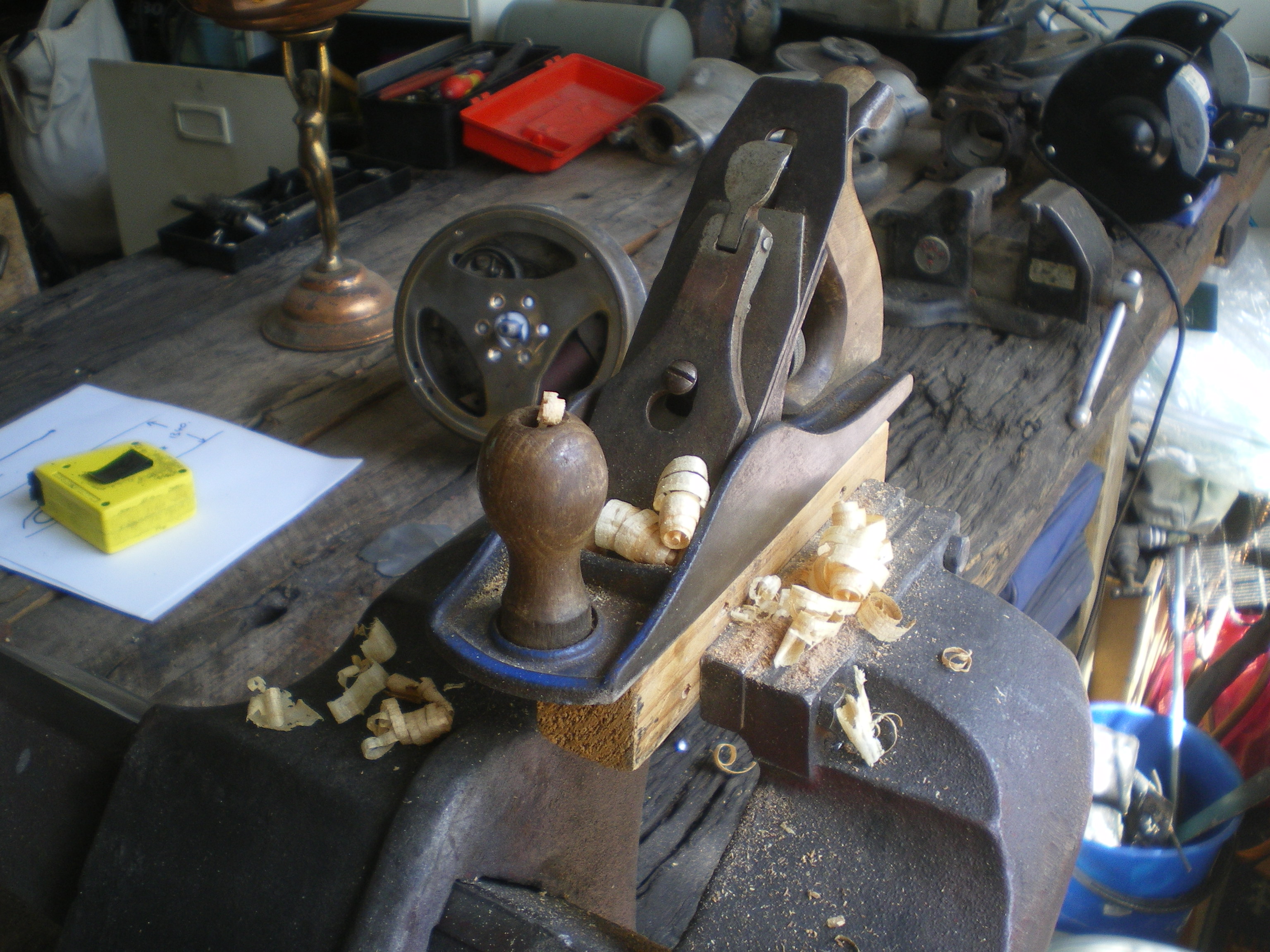

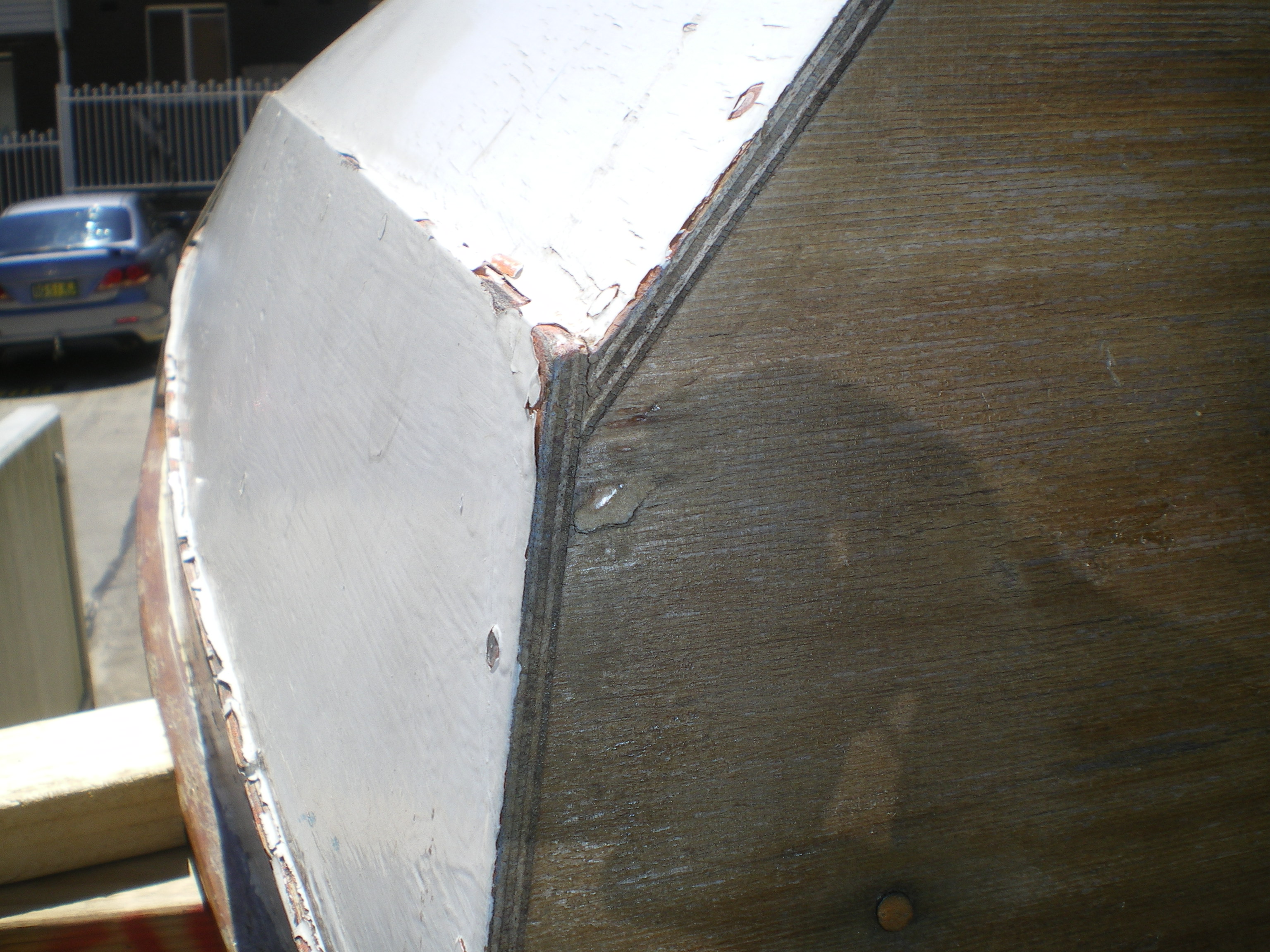

Bluudy 'ell! When I bought my first seagull I didn't think it would lead me to doing cabinetmaking. I've found that the planks are chamfered and glued to each other. Which will make the boat strong considering the light timber. I'm surprised how strong the glue is after 60 odd years. I need to acquire one of those reciprocating vibration saw thingos, that look a bit like a sheep shearing cutter to separate the planks. Dug up an old plane and have been practicing with that for the chamfers (is that what they are called?). Talking of wood planes is it ok to use WD40 on an oil stone to sharpen blade? That's a question for woodworkers, I guess.

Are you actually considering pulling the hull apart?
It will not go back together again Dude.
What are your plans Aye?
Re: Vessel befitting a Seagull at last.
Only part of some planks to replace rot

Yup 100% it ok.is it ok to use WD40 on an oil stone to sharpen blade? That's a question for woodworkers
