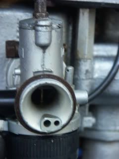

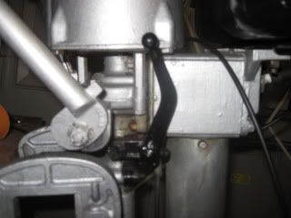

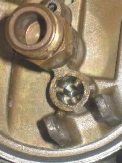

The carb:
The bowl is full after trying to start:

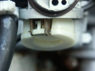

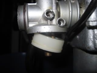

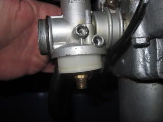

The float setup, note: the pin comes down properly:

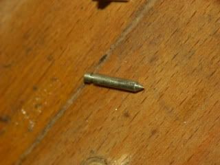

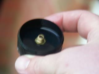

This is the pin:

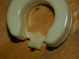

And finally the float:
Re: YASP - Series 90 failing to start
Float retaining pin does not look like the correct one.
It looks a little under size, but this should not stop it from running.
Running out of answers ?
P.S. Picture of float bowl, main jet should not come off with float bowl. Main jet should be screwed into carb first then float bowl screwed onto jet.

Erm yes it is a temporary replacement for the pin which is at the bottom of the testing tank. :oops:
I had to replace it yesterday and it has had no effecton the operation of the float

Float, side on:
Float up:

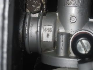

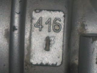

The carb stamp:
Is that a 1b?
I've just found a 416 1 & mine is a pumped carb with a brass rubber tipped needle.
Can you post a pic with the float & needle removed so we can see the hole where the needle fits.

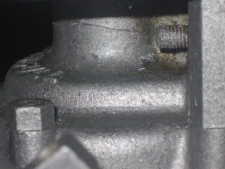

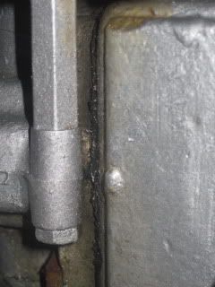

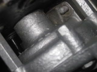

Ok I am feeling a little bit sheepish that I did not notice this earlier. SWMBO demanded her bin back as it's collection day tomorrow so as i lifted the gull out and propped it up against my worktable I noticed this:
cant see it? Try a close up:
Here is where there must have been a 'blow':
Not sure if it came like this or if it has fallen off:
So I am guessing that the block and crankcase need to come apart and be cleaned before reassembly?
gaffers wrote:Is the crankcase leak theory a valid one?
Could be :D
I was flushing my 102 this evening, and got the 1/4" bsf spanner to tighten the cylinder to crankshaft studs.
whilst washing it with a soapy brush around the crankcase cylinder joint, the engine speed picked up.
That could be why it was a little off colour yesterday Charles.
I have had a featherweigh, that whilst underway started making wheezing noises. That was the two bolts that bolt the cylinder on had come loose. It had got so bad that it stopped.
I always carry a couple of spanners in my pocket, I tightened up the two bolts and used the engine for the rest of the weeks holiday on the Norfolk broads with no problems.
In your case Gaffers I would try a 1/4 BSF nut on the stud, tighten them all up and you may find it is all OK.
