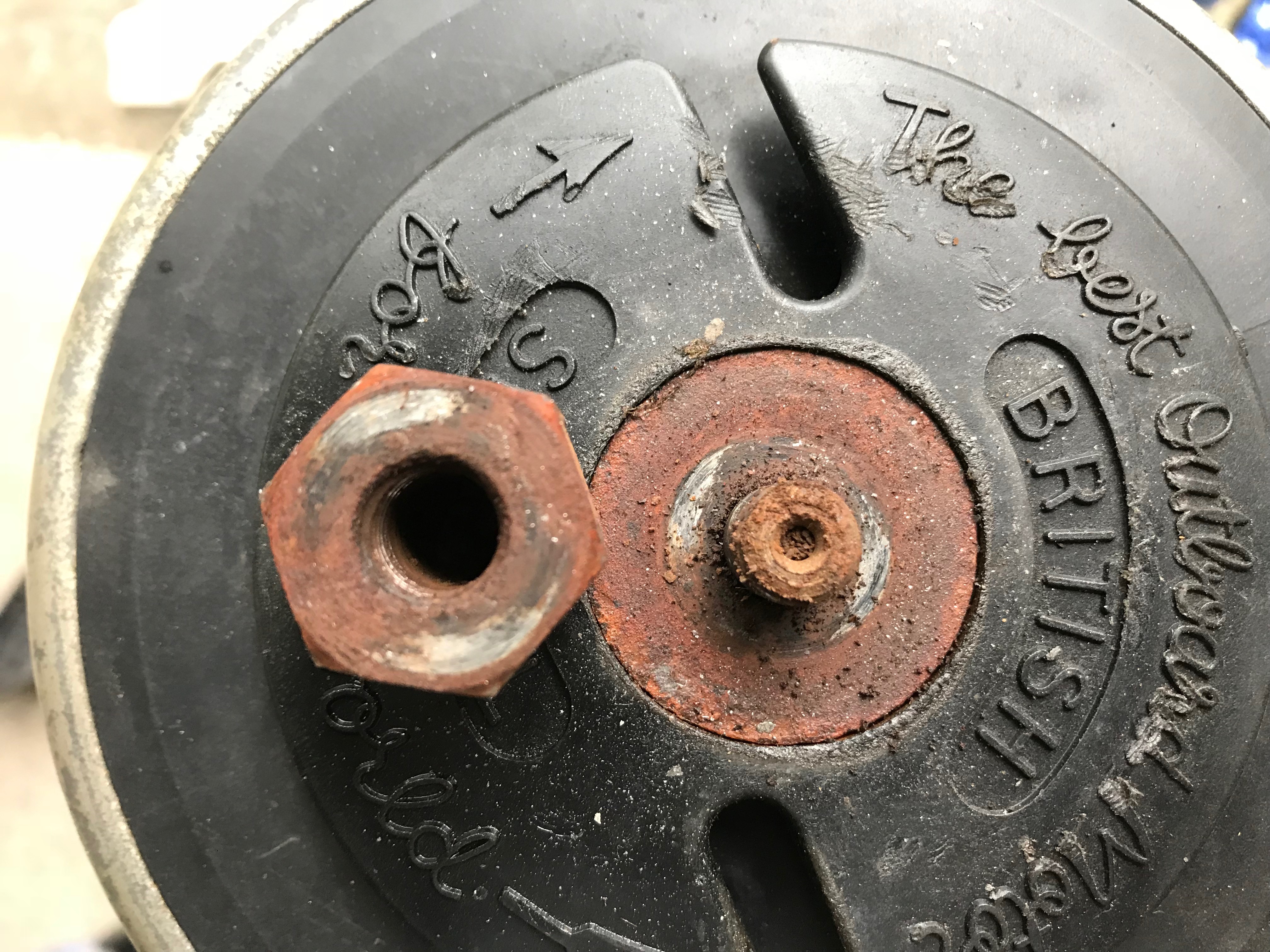

So I’ve got a dome nut, mark II ignition, that just doesn’t want to come off. Have tried most everything I can think of to keep the flywheel from turning while giving the spanner a good whack. Last try was getting flywheel in a tight bench vise (with wood blocks) and still no luck.
Tried a small amount of heat but didn’t want to melt anything so couldn’t give it much.
Any recommendations? I’m sure someone has crossed this bridge before!

Hi Andrew,
I have never had any difficulty with undoing the dome flywheel nut, so have no experience of what to do.
But what about drilling a hole in the top of the nut so that you could introduce some suitable freeing agent into the threads, as it is possible that corrosion could be the problem.
It is also possible that a thread locking compound has been unwisely used in the past. That of course will require heat to break down the compound...……….
Good luck!
Good luck!
Re: Removal of dome nut
I think you will have to accept that the wipac sheave is going to get heat damaged and put some serious heat on the nut. The sheave is readily available. A wet rag may suffice to keep it from too much damage. Another thought is that there is a tool called a nut cracker which does as the name implies. Whether it will work on a nut this size l do not know. Again spare nuts in our community are common place. Generally I've found that if the thread is damged it is usially the nut thread and the crank thread stays intact. Good luck. Removing the flywheel maybe just as exciting too. Getting lubrication on this thread is going to be hard. Drilling oil holes in nut? Personally l would be going with heat and wet rag or spray water bottle or non flamable can of 'cold spray'. The coil and condensor is sufficiently far enough away that they shouldn't be affected by heat to nut. Good luck.

Mk 2 flywheels are quite brittle so handle with care.
Did you try to start by using the electric drill silly idea? as that can over tighten the flywheel nut!
I've locked flywheels by putting the piston just after TDC, then filling the cylinder with fuel mix & replace the spark plug, a sharp tap with a medium weight hammer should do it.
Not too hard as you could damage the con rod!

Thanks all for the suggestions! I ended up getting it off with brute force; was originally worried about cracking the flywheel in the vise but decided to really crank it in there and give it as much heat as I could. Plastic started to melt slightly around the washer but I had a couple old spares. Had to reset it in the vise probably 10 times before it finally came loose. Loads of rust in there, looks like the nut was also a bit fused to the washer which didn't help!
That's certainly well corroded, I'd suggest wire brushing both threads and copper grease when putting it back together.
