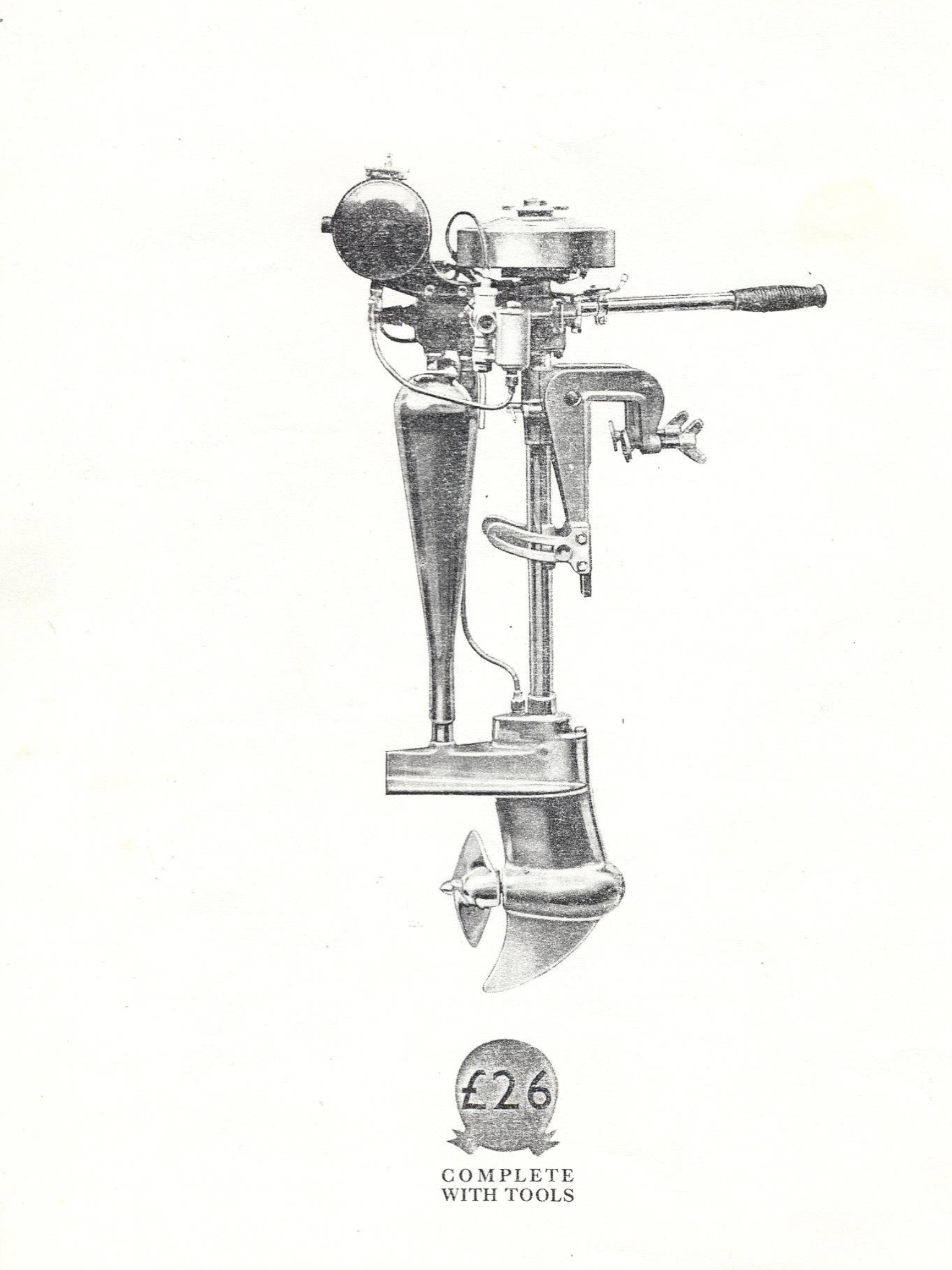

May as well post the Cover page of the parts list.
Never know as this may ring ships bell.................

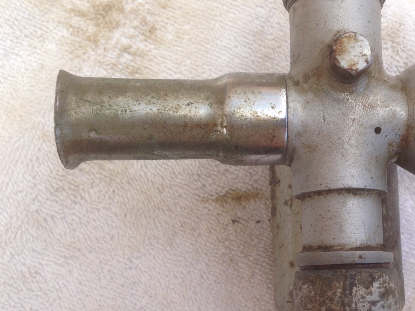

It's funny how the early OA's had a bottom feed straight out bowl, the later ones had the top feed swan neck bowl as did all other Marston's (sexy) and the with the introduction of the SN/SNP/SD returned to the bottom feed straight out bowl again, from the ones I have the early OA and SD seem to share the same bowl with the same logo placement but of course this could have been changed, also during the Marston period the carbs appear the same but have several different carb numbers and I'm still tring to work out which goes with what

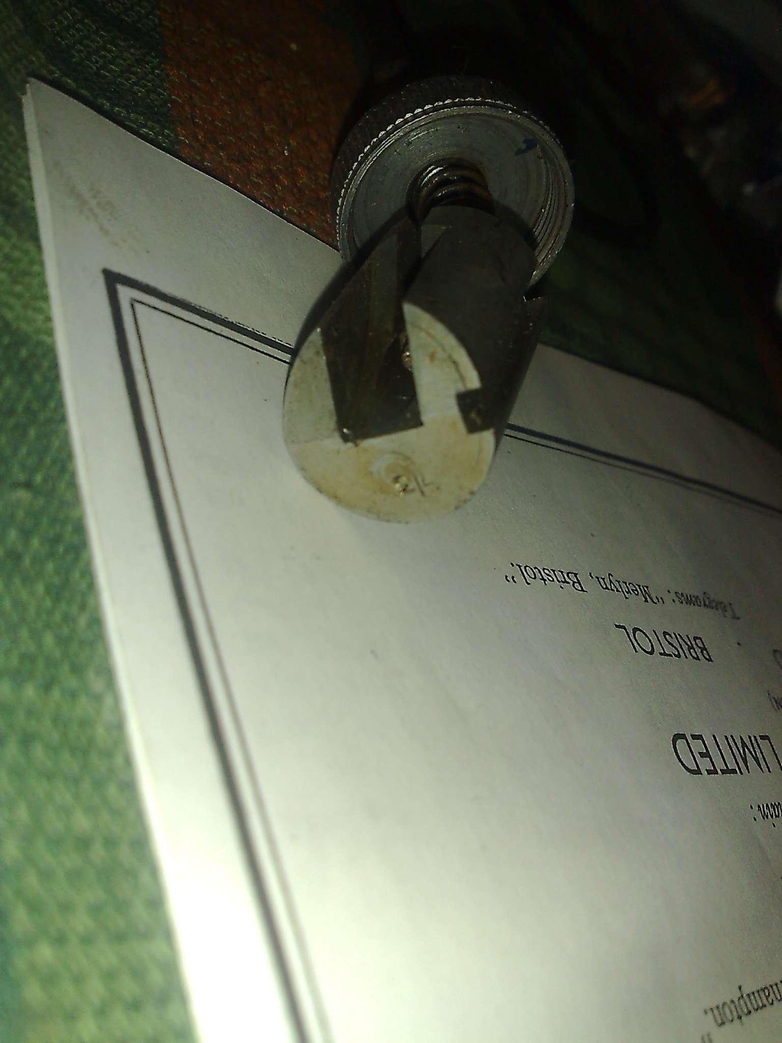

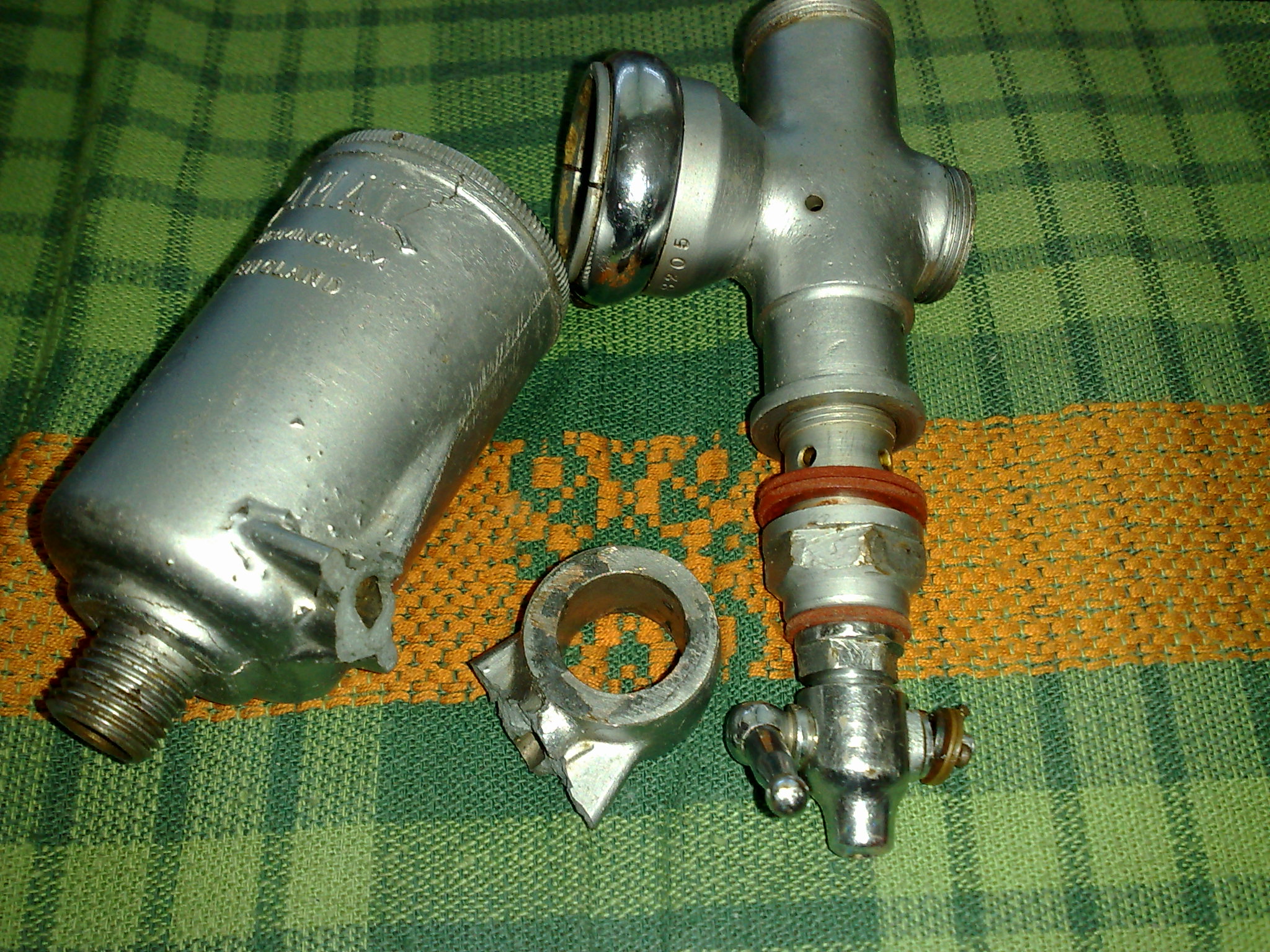

Numbers and correctness I have absolutely no idea but numbers on what is stuffed are below for you all.
I just need the bowl. The float may be as whatever a float is but I will use the needle and seat I have..........looks more as 46/..... but very different aye.
I will let you know what the jet numbers are just for info soon.
Thanks all
B[/color]
Sent PM Oyster.
Thanks all
B[/color]

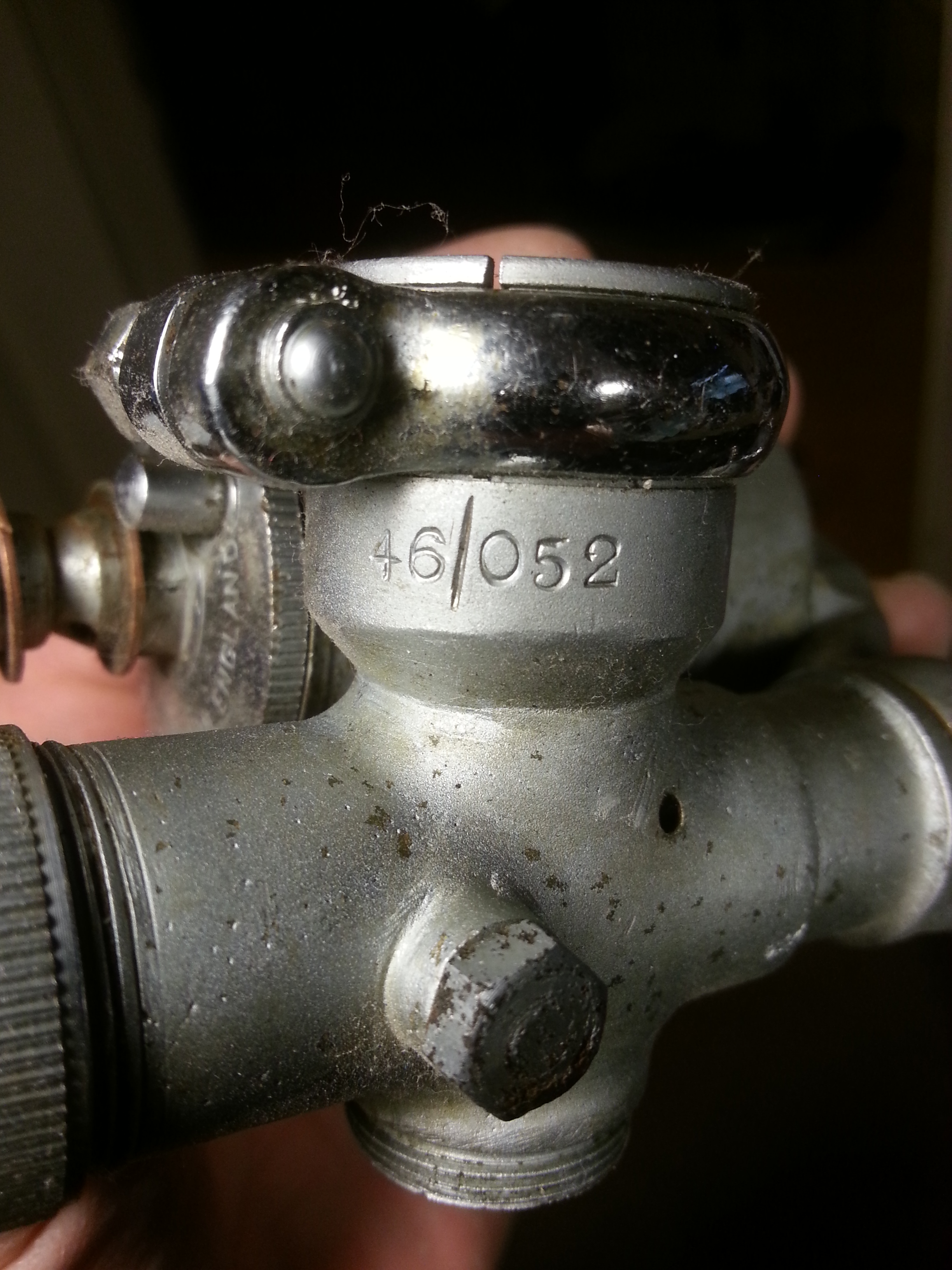

Re: OA 262 Gearbox
That carb is a 46/032 that was fitted to a series 1 OA & that I'm aware of, nothing else in the Marston range.

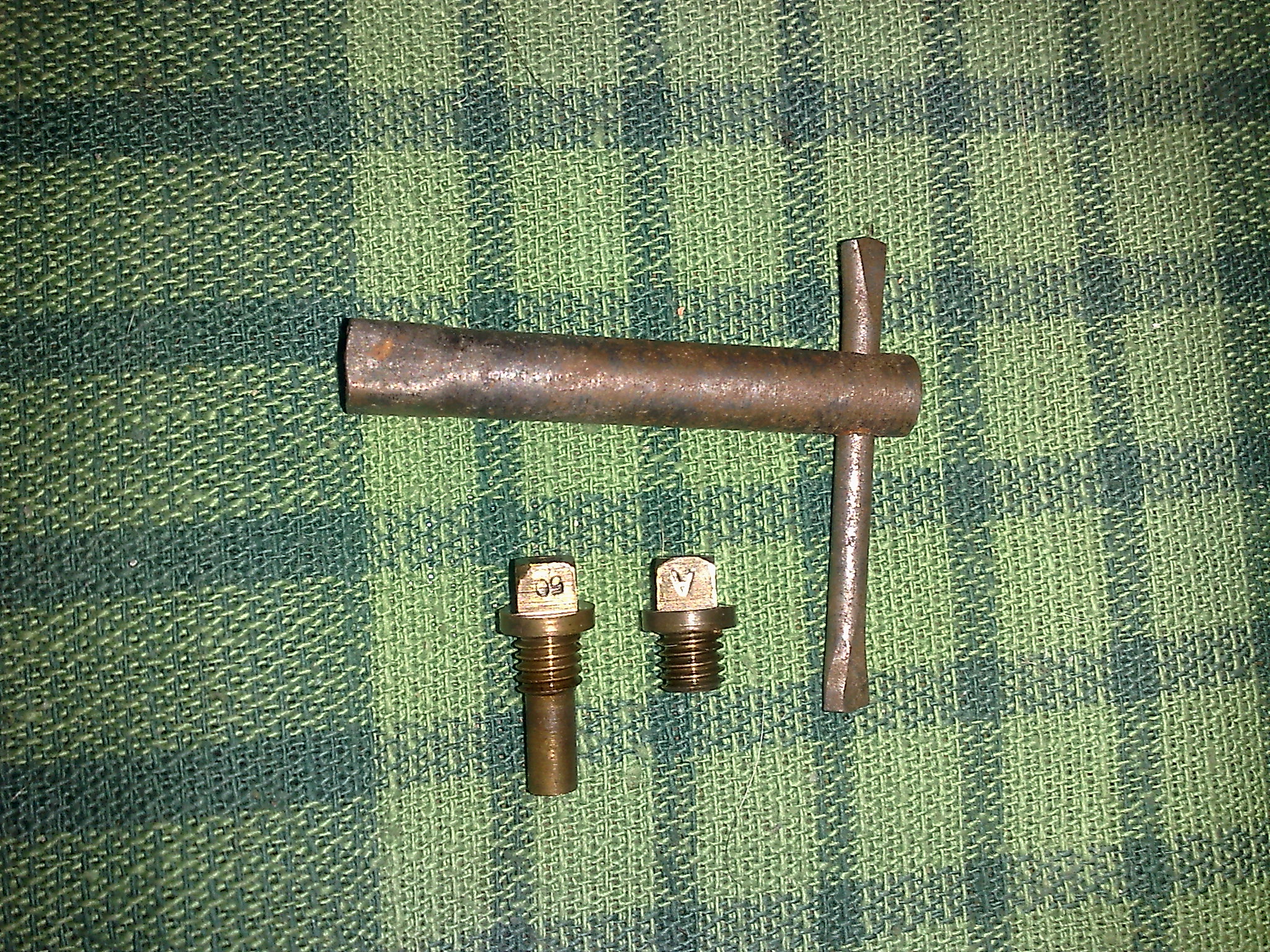

- Posts: 4204
Re: OA 262 Gearbox

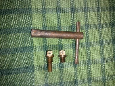

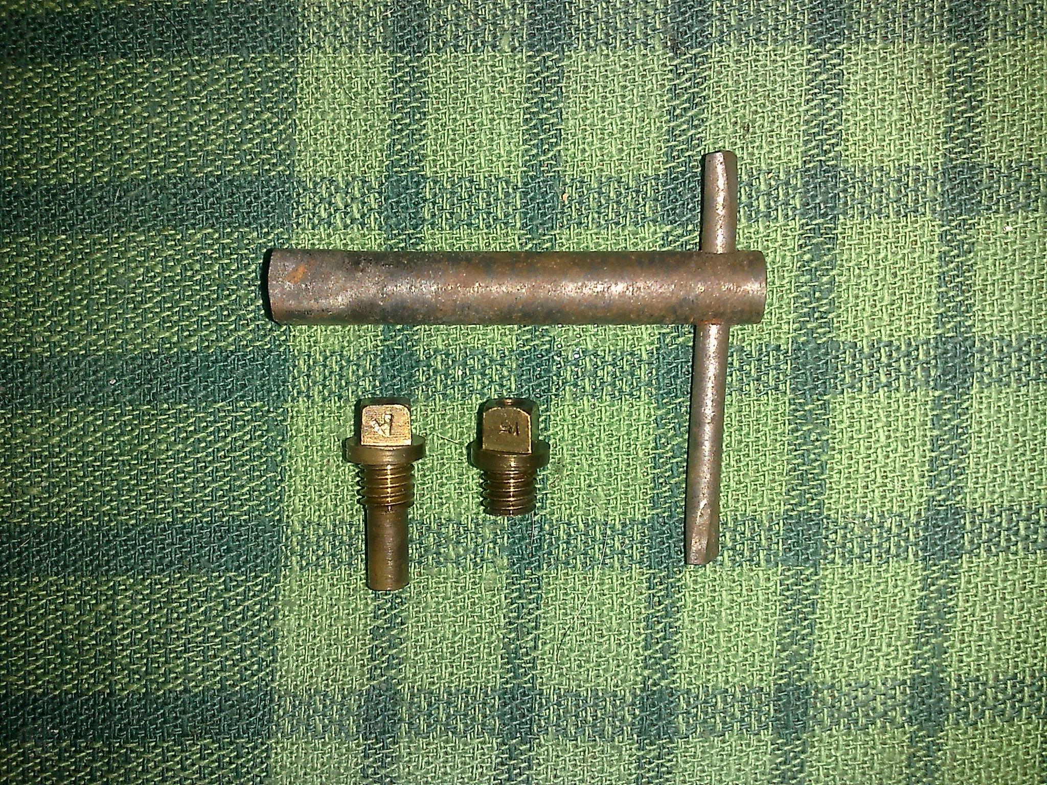

Jets are:
#50
#15
Slide # 7/3
[/color]
#50
#15
Slide # 7/3
[/color]

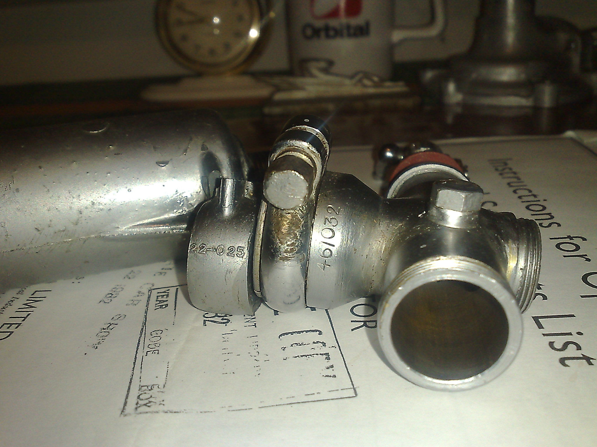

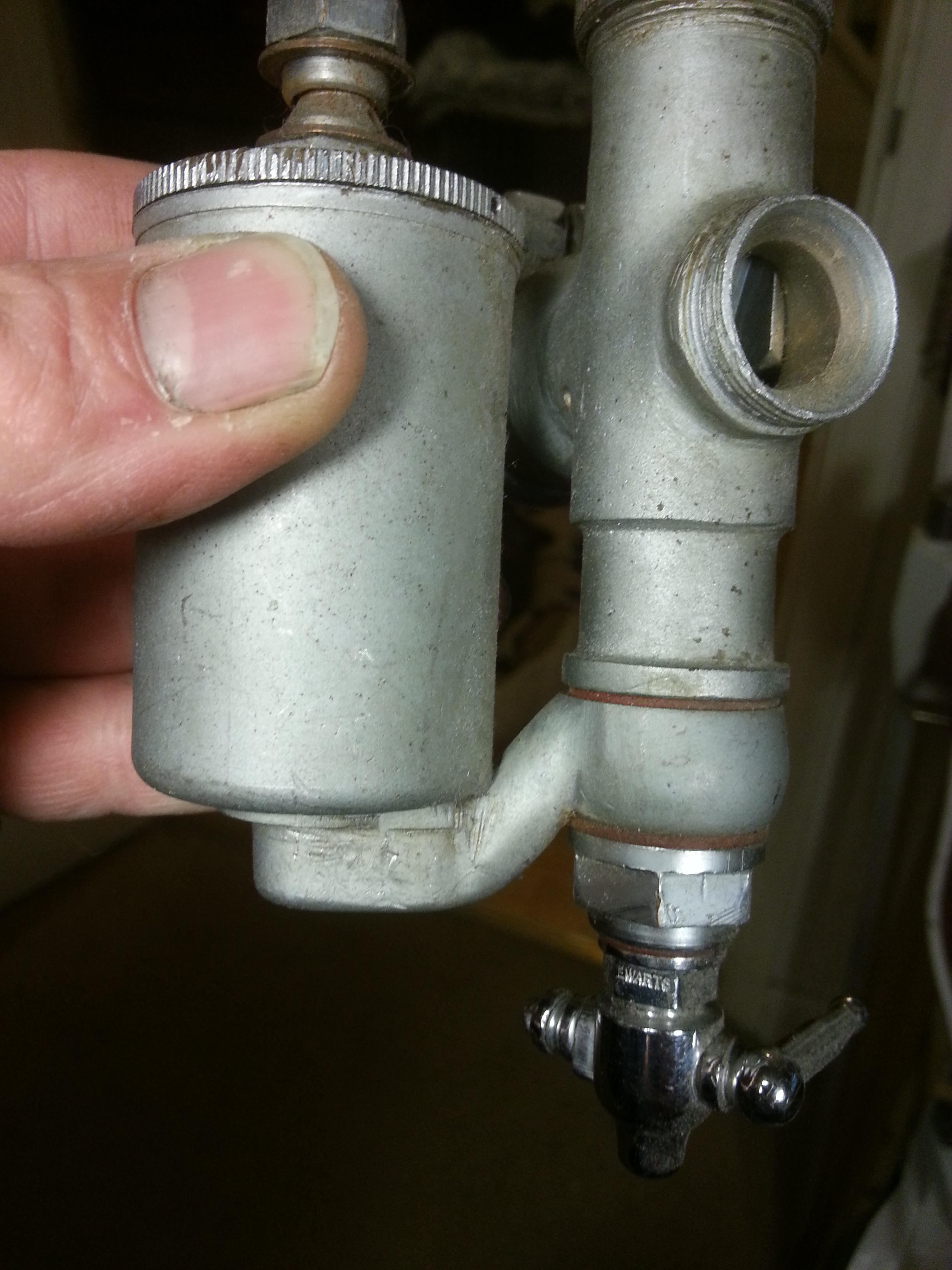

Re: OA 262 Gearbox
I would say that is the wrong float bowl, that is broken.
This is one on my desk
Re: OA 262 Gearbox
From what I gather the early series 1 OA's had a bottom feed straight out float chamber not the later swan neck type also the early intake trumpet had wasted/recessed centre section.

Re: OA 262 Gearbox
The one that is broken looks like painted aluminium.
I thought all the early ones were satin plated brass/bronze.
22-025 is a later 102 part, listed in the parts book.
- Posts: 4204
Re: OA 262 Gearbox
I was wondering why a plated brass 46/032 body would have an aluminium bowl. I thort just saving the bucks but maybe back then scrimping was not really that much of a concern. A boater could afford one or not..........Horsley-Anarak wrote:The one that is broken looks like painted aluminium.
So many years to get things out of whack.
