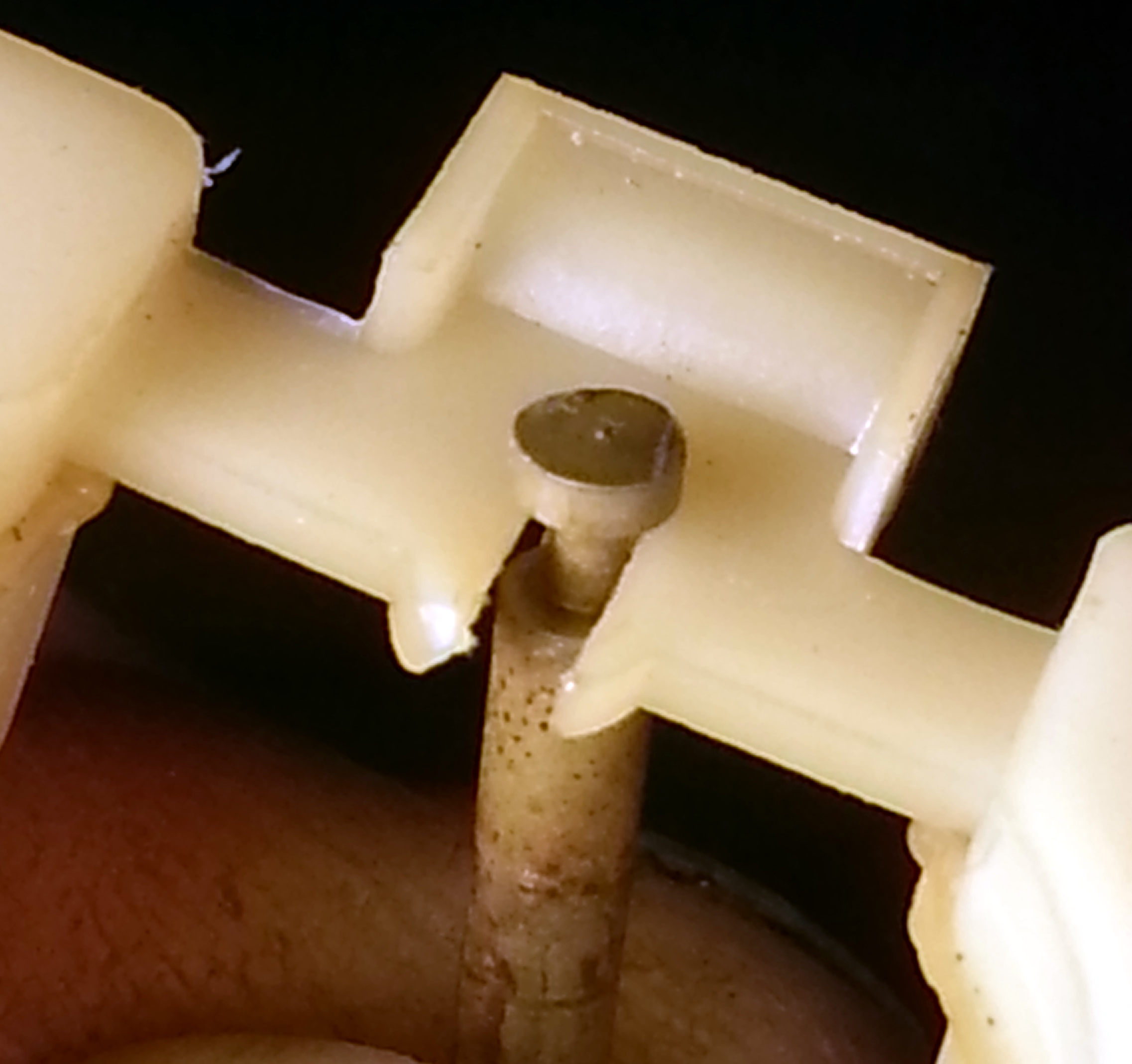

I've had it apart again looking to see if I can spot what is wrong
I wonder if the needle should clip into the float (marked with an arrow)
or if it just slips in the slot, mine slips in and doesn't clip if that makes sense

Re: instructions or Amal Carb
Sloppy fit.
Here is a picture, still amazed at quality of mobile phone photos.

Post by flyguy »
Thank you H-A so at least my float is ok
