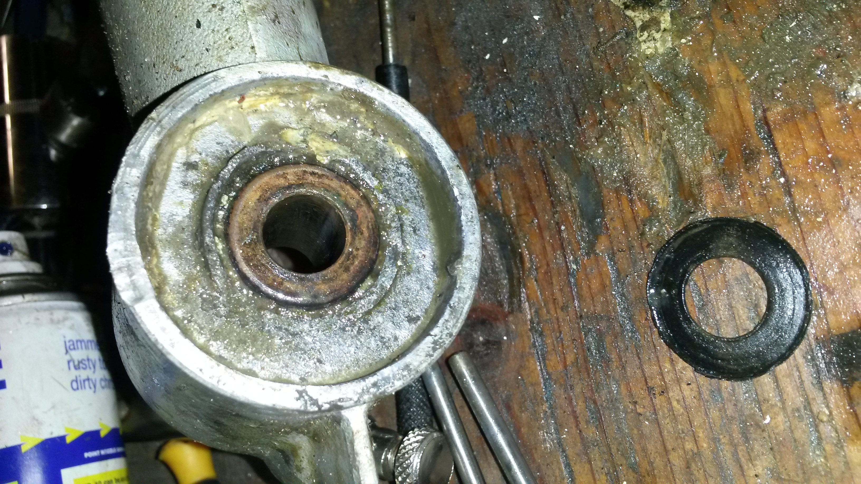

Ok I got the bush off, and that tiny slither of rubber is the grommet, also there is some serious roughness behind it, kind of looks to me like an edge has broken away, or is it bad casting?
Re: Draining the mayo out the gearbox
I don't think you are able to fit a seal any more, I would fix the end float as that seems to be what the problem was and see if its usable, thicken up the oil if need be.

The seal seat or where the seal mounts has worn away. You can no longer fit a seal.

The saltwater corrosion has really gotten into this gearbox hasn't it!
The front view shows this where the prop shaft comes out of the box where the prop sits.
There was (or should be, what's left of it) a "ring" for want of a better word cast into the casing to house the rubber washer. This has clearly rotten away. There is nothing stopping you replacing this rubber washer with another new one. Once the brass collar is back in place this should hold most of it in place. Every little bit will help to retain it's oil.
By the looks, the only other option is to look for another box.

Ok, well I'm now starting to build a picture in my head of how it should all be. I do have the thrust washers, but they came off before the brass collar did, I'm guessing they should be between the brass and rubber?
Is the rubber seal washer just a grommet? Is it specific in anyway at all? I'm now thinking about grinding off what's left of the worn "seat" and maybe remaking it.

The location of the thrust washers is well illustrated in both pictures, they are both inside the gearbox.
Most gearboxes have either never been fitted with the rubber "grommet" or lost it, so it not being there will make little difference.
