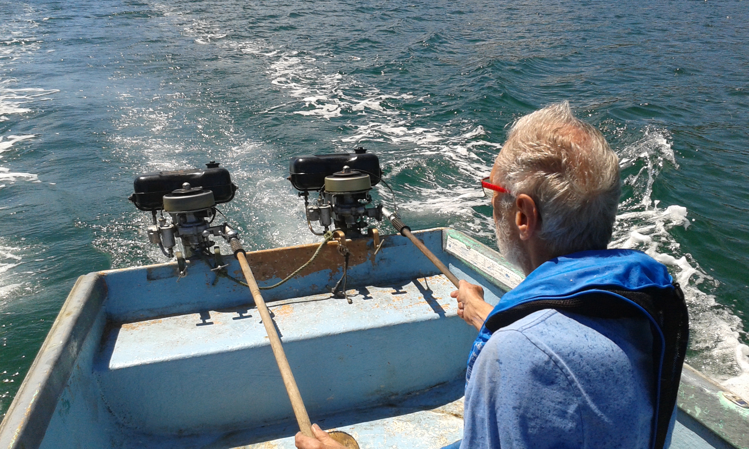

First test on the water. Boat as is with cracked paint and rough hull all untouched for 10 years or so.
Launched in Daniels Bay Monday 16 November in perfect weather and flat calm (at least to start)
Tried out both long and standard shaft WSPC'S mounted side by side. As per the photo attached
Both motors ran independently at full throttle both achieved 4.8 to 4.9 average speed by GPS.
Next ran both together again at full throttle and gained a further 0.5 knots to 5.4, not great for double the fuel consumption but sounded good.
The Displacement maximum for the boat, using the standard 1.4 rule in flat water gives 5.37 knots so was spot on the money.
Next motored her back to my boat landing a distance of 8.3nm. and to start, crossed the bay with the long shaft only, we reached the Ventenat north cardinal mark a distance of 2.14 nm at an average speed of 4.28 knots. Rounding Ventenat and out in the channel for the run South we were out of the lee and into stiff sea breezes which were kicking up steep short breaking waves. Under these conditions the speed dropped away
The total time for the 8.3nm was 2hours and 15 minutes at an average of 3.69 knots.
The exact fuel consumption was 4.5 litres at 2 litres per hour.
Based on these figures crossing the Bass Striate will take 44 hours with a fuel load of 88 litres. (plus reserve)

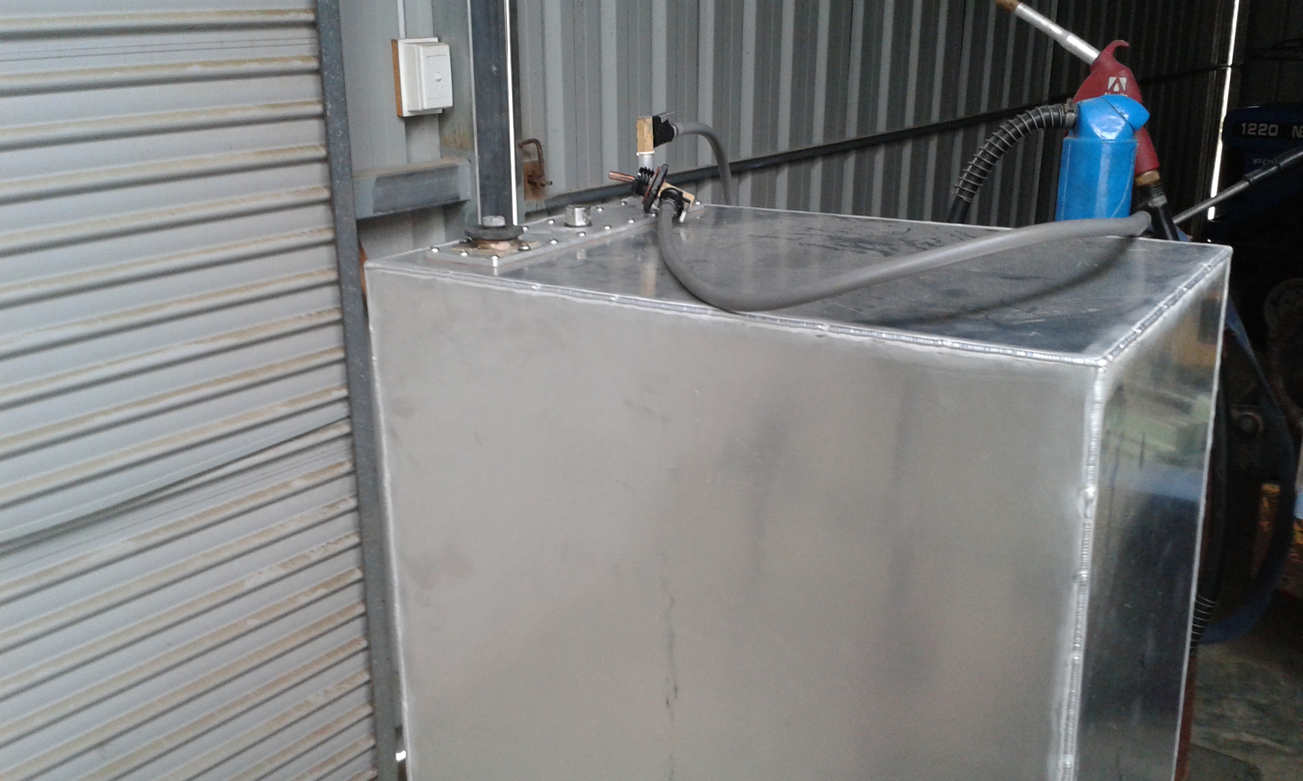

Fuel tank for the crossing now completed ready to install Note the Seagull filler cap.. couldn't resist. Tank holds to the brim 150 litres but will be loaded to 100 litres for the crossing at 2 litres an hour that provides 50 hours running time, with an estimated run time of 36 hours.

Baffles in that AJ?
- Posts: 758
Re: BASS STRAIT CROSSING - MARCH 2016
Yes.. two plus sump
