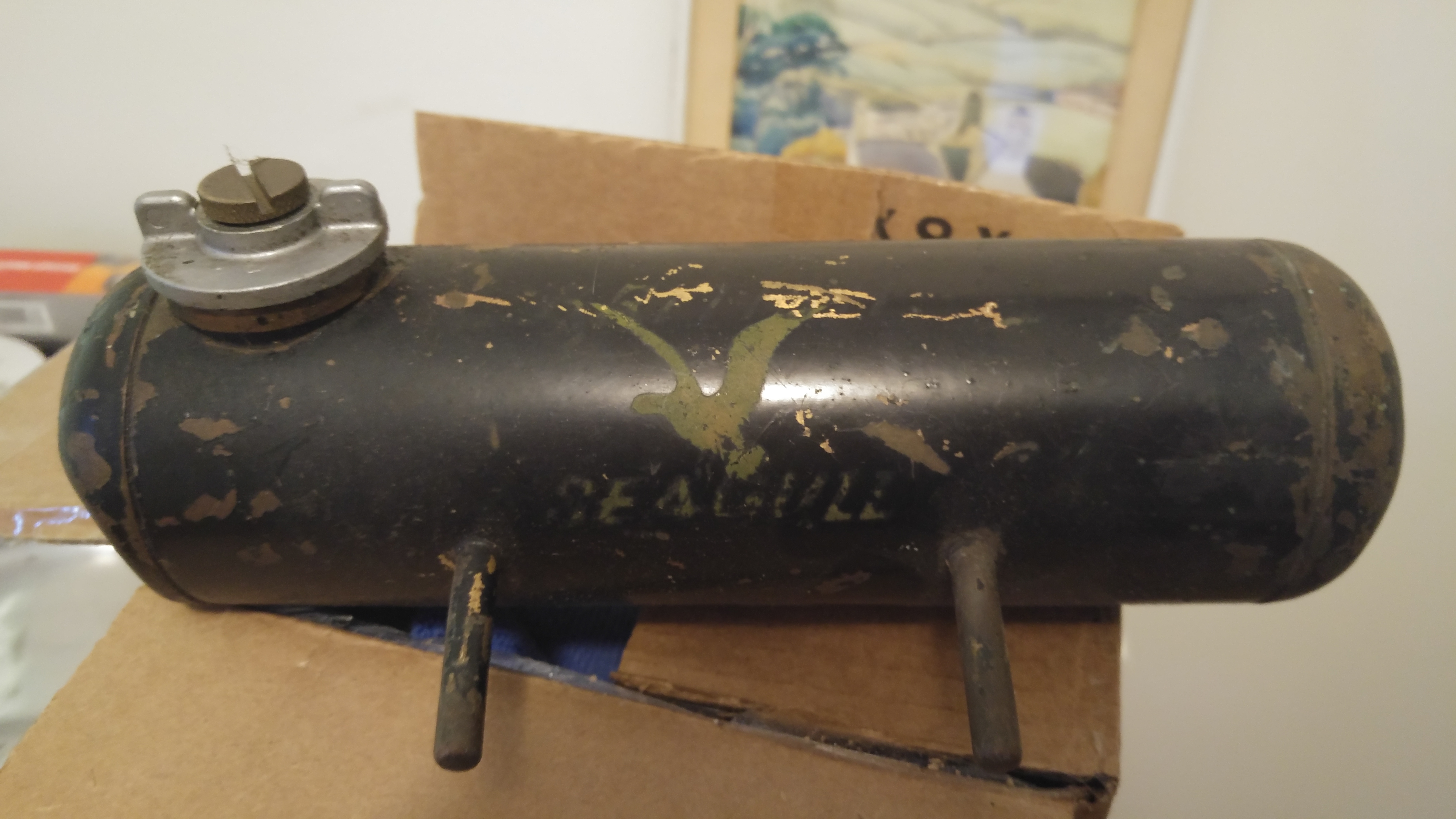

What is left of my decal. I have the repro which is of high quality for the Old Dear.Oyster 49 wrote:Great little engines the FVs. The 2 issues are the open water jacket and the screw in leg. The water jacket can cause really bad corrosion of the crankcase, particularly where the studs screw in. Getting the leg out of the water pump housing can be a real devil too.

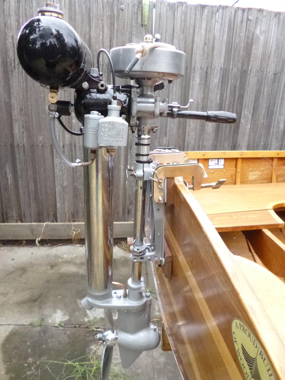

Here's mine, since the picture was taken I've trimmed the tiller to the correct length and added a correct Dover grip. I think it is now pretty correct v factory spec.
Incidentally the decals are now available, I had a few made, and John now stocks them.
Enjoy!

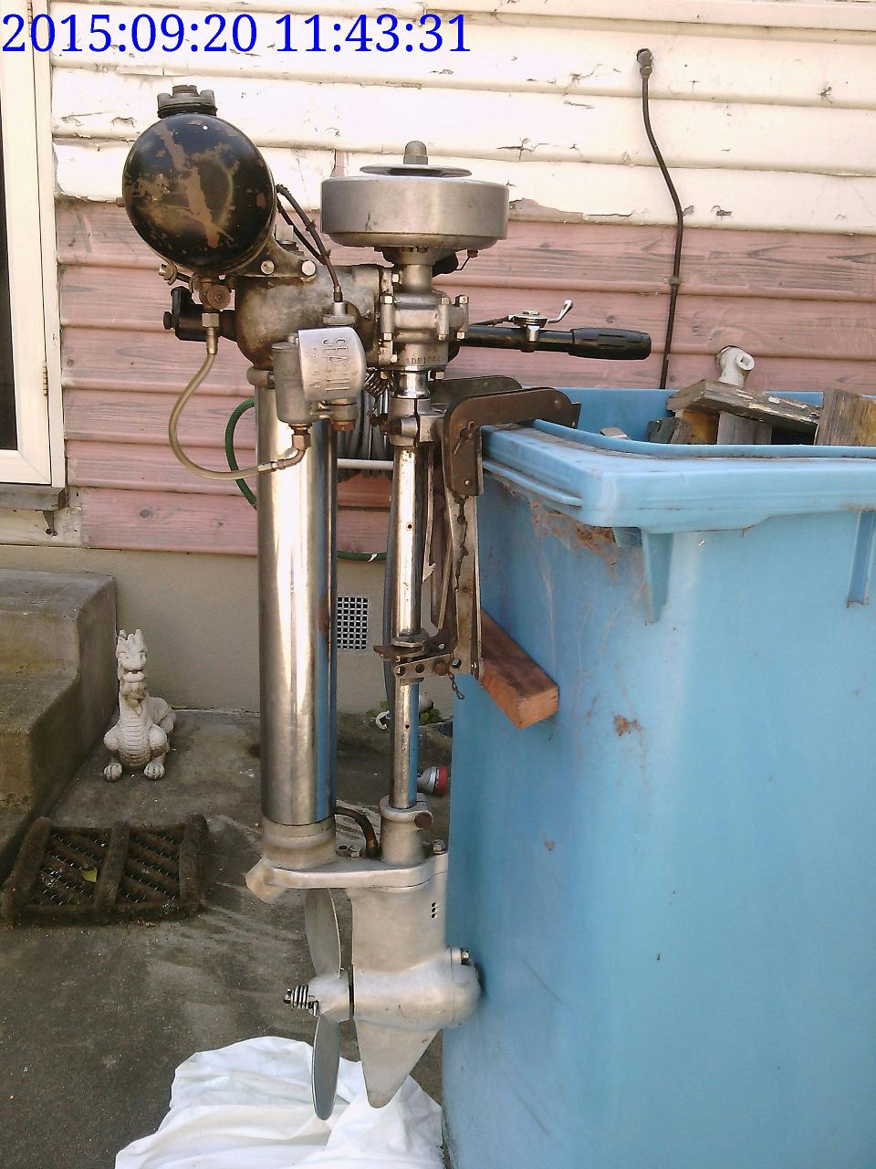

you were wondering about prices for Seagulls, I got this AD in Melbourne, on ebay, last September for $250. Original owner, second pull start. All I have done is new spark plug (on John W's advice) and the rest is spit and polish and paint.
