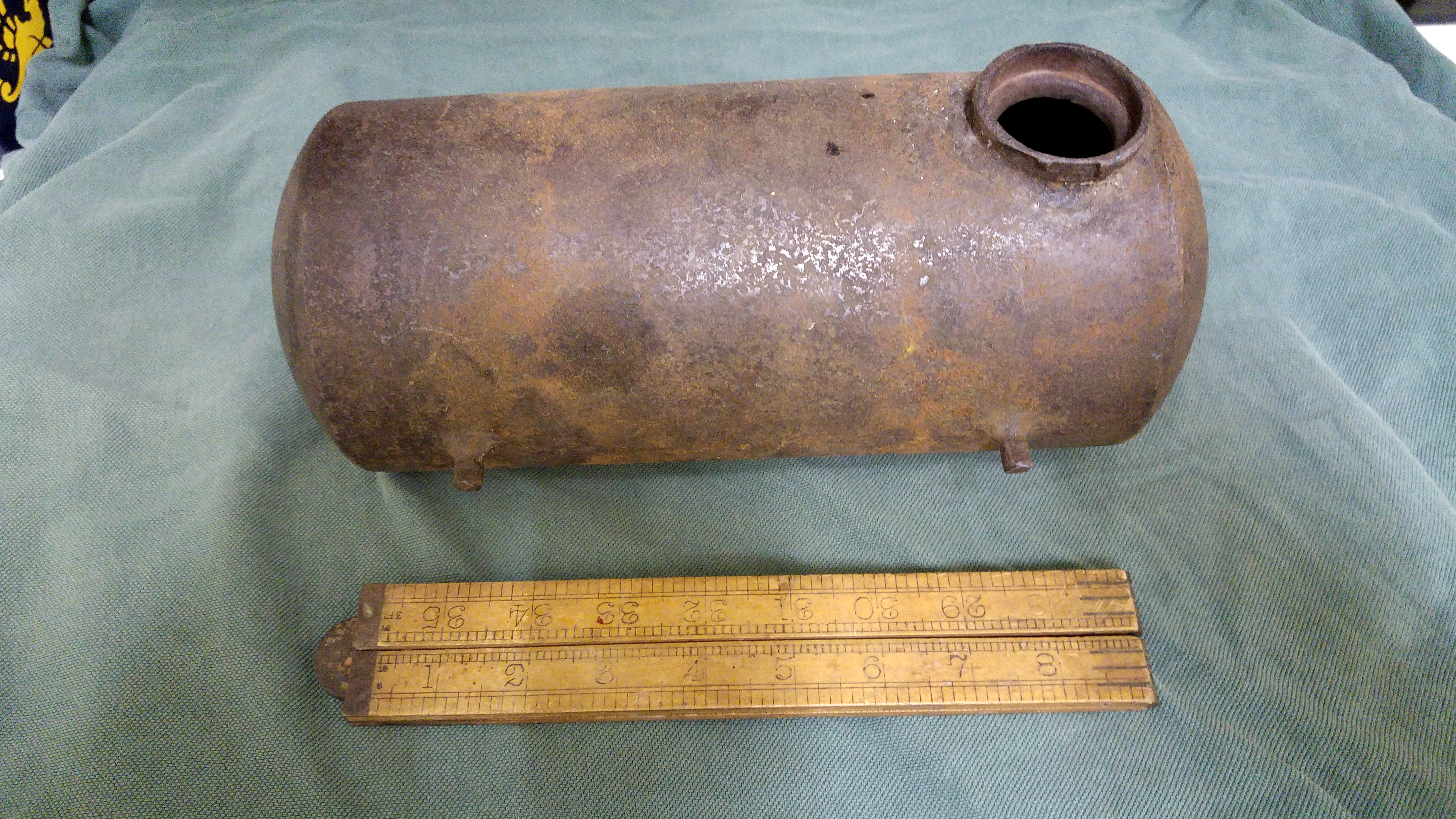

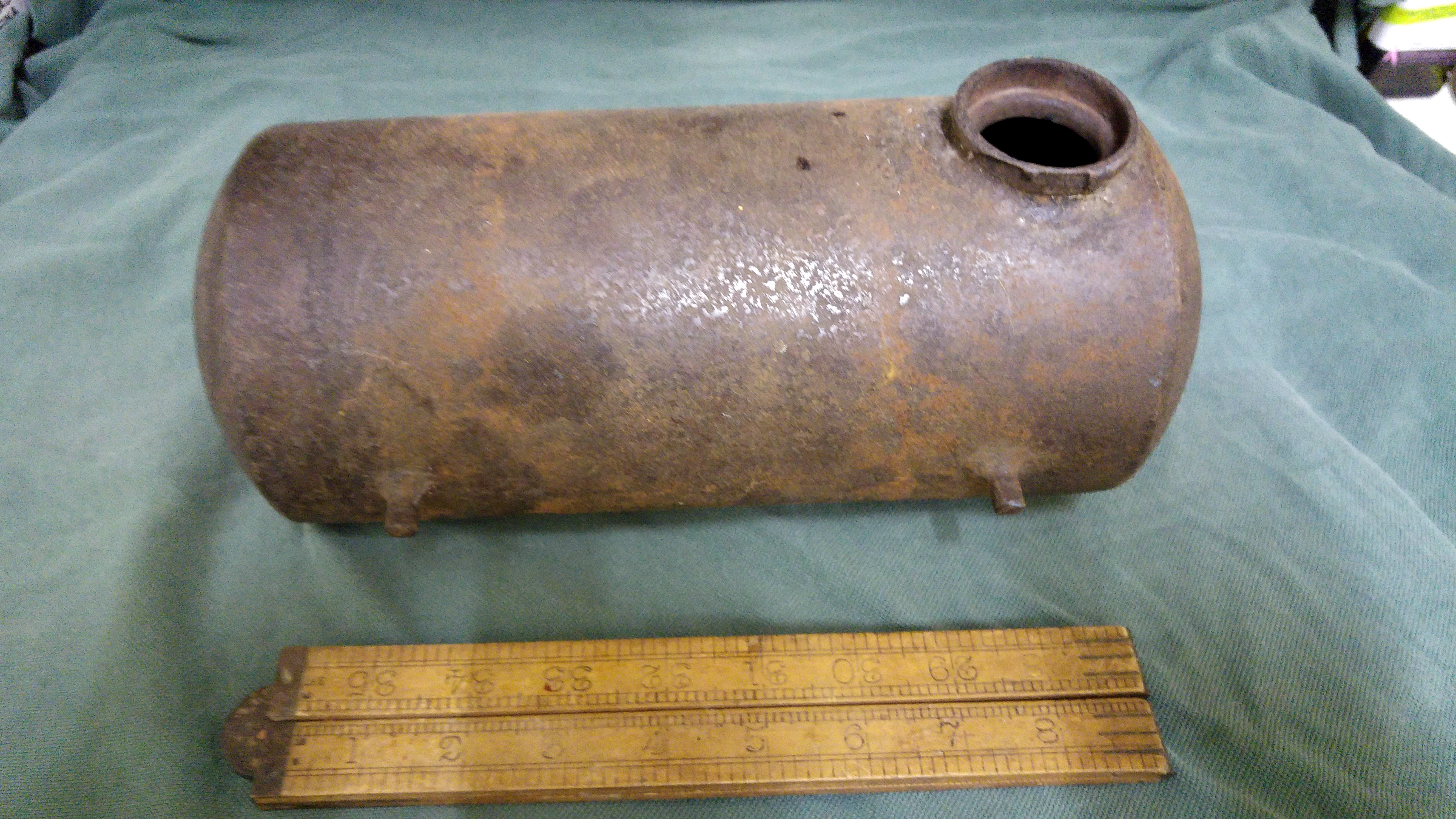

A question bugging me for a while with this that was in a bunch of Gull parts many years ago?
Steel Tank. Had a copper unplated bayonet with silver colour plated breather. It is still around somewhere.....the cap.
It is a clamped tank. Fuel tap on the port side under the cap.
Sorry if same kind of pic. Need to upload maybe 4 pics to get one.......HTTP Error?

Re: Opinions...
That looks like an SD tank to me.
Re: Opinions...
A later fuel line tho.
