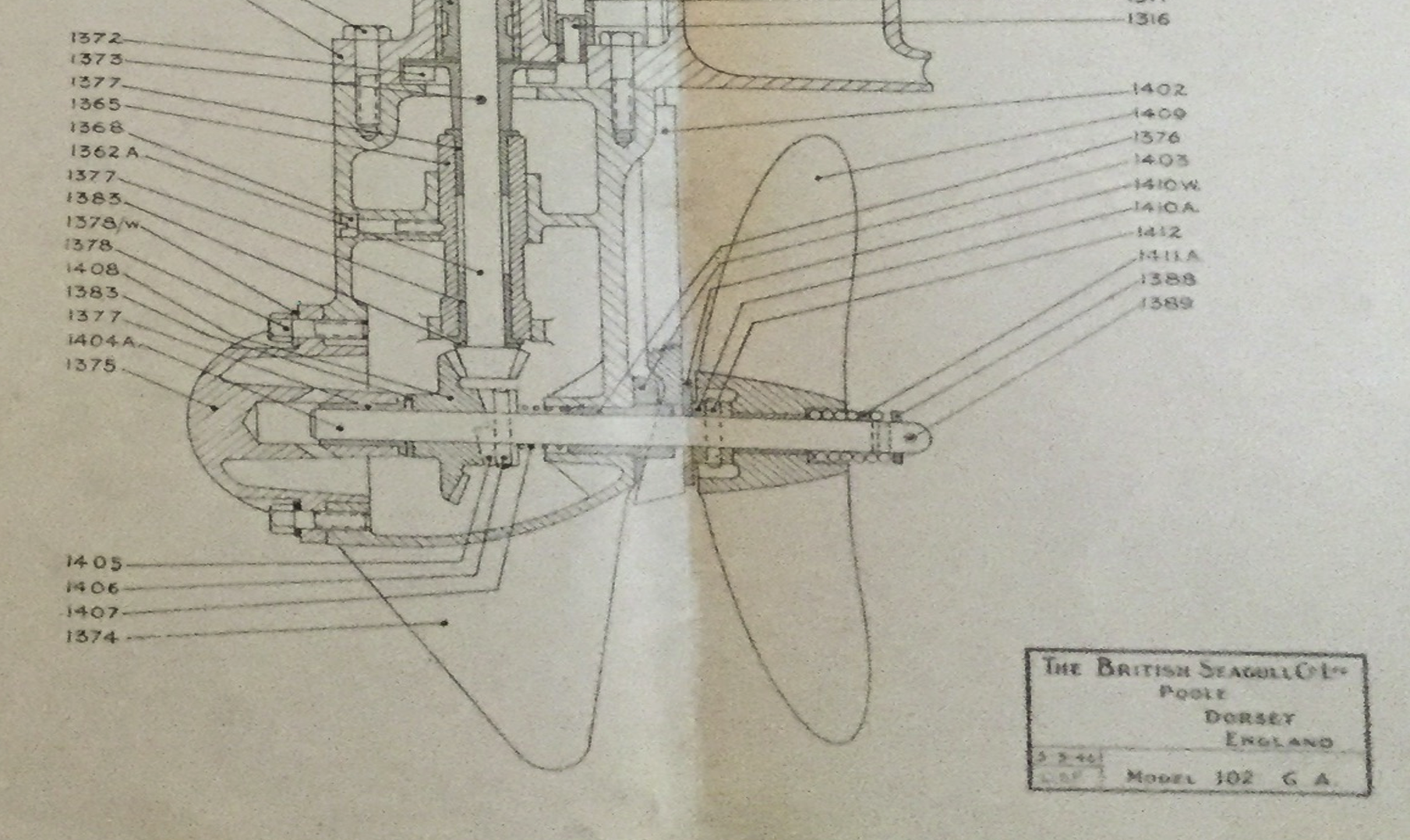

The clutch mechanism is shown on the drawing, including the rod. However there is no clutch lever shown. Take a closer look..

Here blown up a bit. I'd suggest that is the line drawing of an early model AC, or perhaps a C.

This is obviously a sliced drawing of a 102, so most, if not all the peripherals, like water pipes, fuel lines, tiller and so on are not included, if all that was added you wouldn't see much.

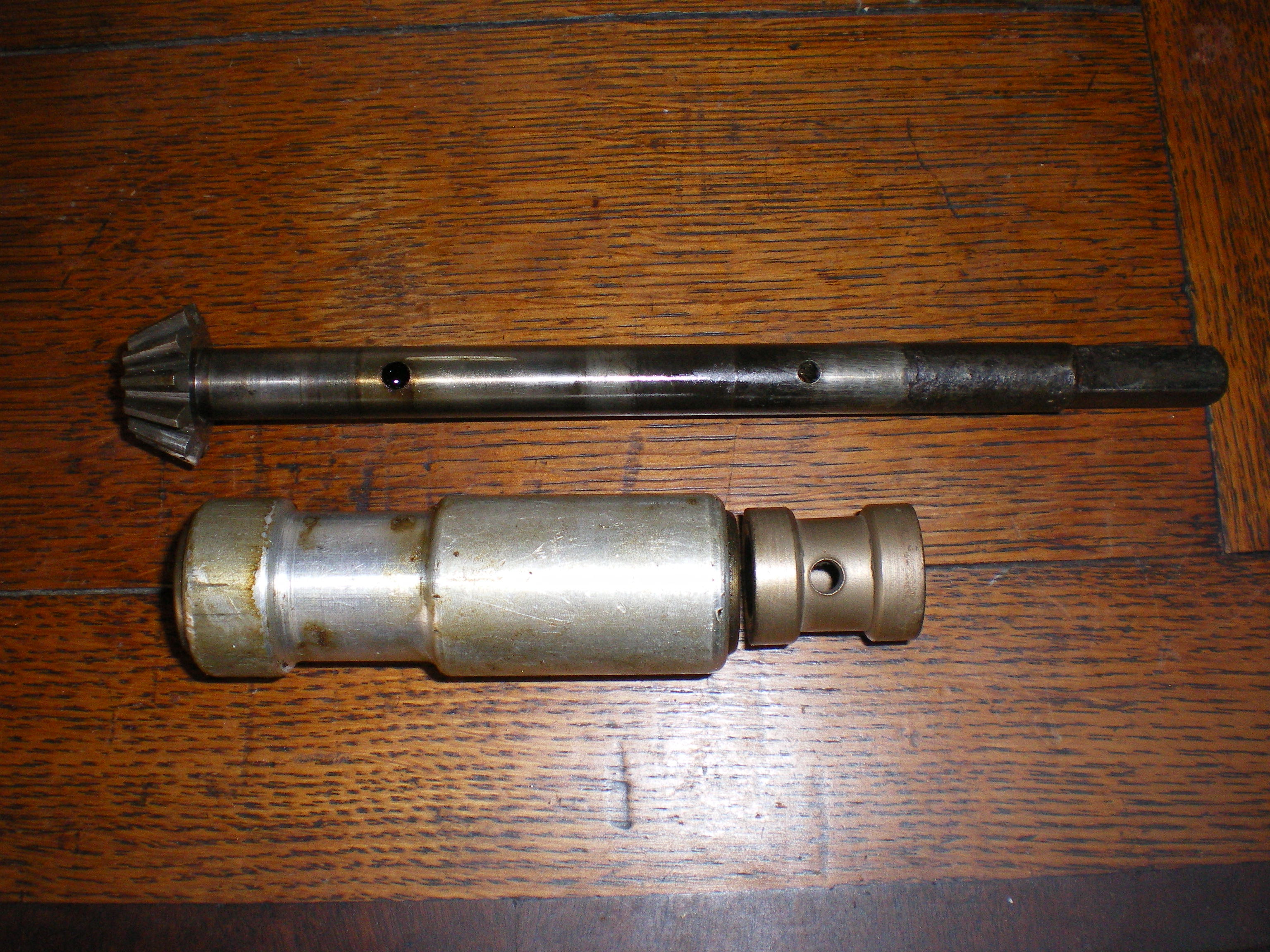

I believe the early AC and C box is the same as the later SD ones. You will also note the cotton wheel bush, if I'm nor mistaken, pt # 1370. Would we be wise to think all straight out exhaust models had the bush?

yes, form dated 5 / 3 / 46.

The diagram seem to be a part of the 102 paperwork, so I suspect that it is pretty common.

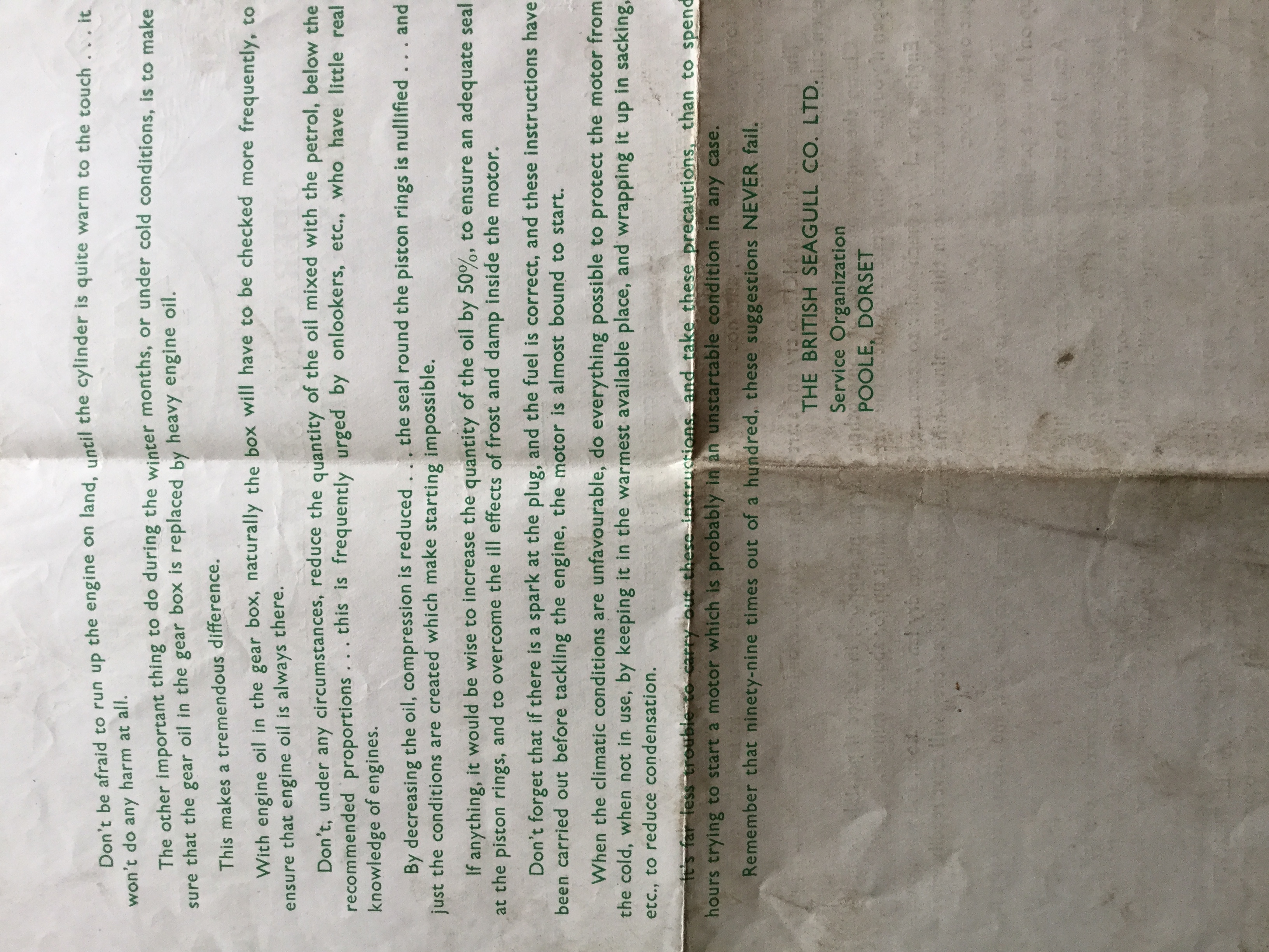

Nice to see that advice from the factory about starting your motor in freezing conditions. Interesting that it applies to all the models from the OJ right through to the LS etc., That's not a document I've seen before.
I have seen that sectional drawing before, I'm sure it's either a C or an AC, to be honest I'm not sure what the difference is. It's a shame it doesn't include a transom bracket. For me the single most interesting thing about it is the initials of the man who drew it - W S P, for William Styles Pinniger, who was in it from the very start in Bristol.

I've also spent some time looking to see if there is any difference between an SD box and one from a C or an AC but can't find anything yet. I have a few of these older 102's now and dismantled every one of them for a closer inspection. As Hugz has mentioned i think it wise to consider any motor with a straight out back pump housing will more than likely have a cotton reel bush as per his pictures. I can mostly confirm this with what i have in my own personal collection.

It is ironic that the cold start instructions were found in Queensland, northern Australia, not known for freezing conditions

I don't understand the problem with this 102 drawing, is it because it should have a clutch or it shouldn't have a clutch.
The drawing shows a clutched gearbox, with the internal spring needed for a clutched gearbox, but not needed for a non-clutched box, not showing a clutch lever is not important, what is important is what it is showing.

I don’t think there is a problem with this drawing...

Here is the backside, of the freezing conditions leaflet.
I’m glad you find it interesting, as I thought it was probably a common piece.
