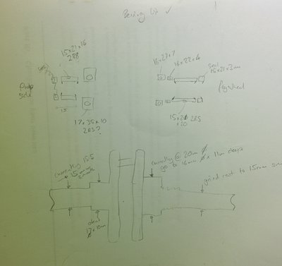

Following a nice chat with a forum member this morning, I riffled through some of the drawings I did and found the bearing details.
- Bearings
You can hopefully make out the layout. Two questionably dainty ball bearings on the upper end and a single medium sized one at the bottom. Flanked either end with a needle roller. For good measure there is an oil seal up top too. No room at the bottom

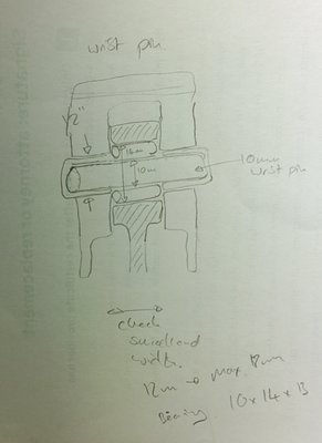

And the wrist pin
- "do not scale from drawing"
You can see I was going to use a caged roller an indeed tried this but it was all a bit flimsy so upgraded to longer crowded needles. Clearly the ends of the spacers there don't poke into the cylinder wall, in fact, they ended up quite a bit different so that I could ream the internal bore diameter to size easily but it gives the general idea.
