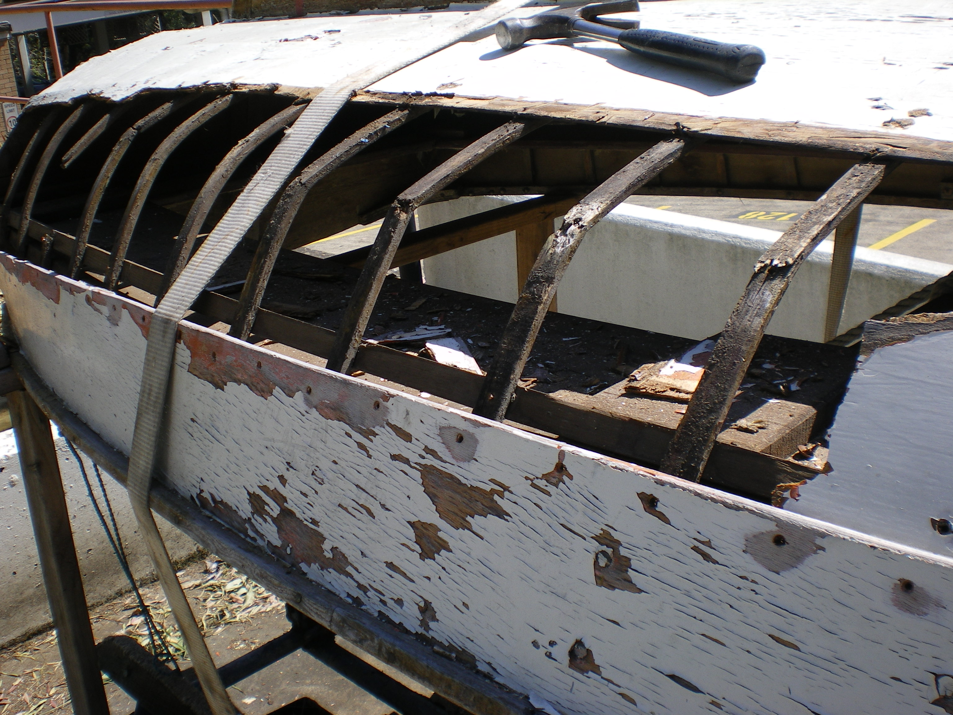

Thought I would get motivated and do a bit. First I cleared the area of rabid dogs and then removed most of the rotted planks on the worse side and found 5 broken ribs. I've decided to cut out worse bits and glue in a replacement section with some ply to strengthen both sides of rib. Not original I know but in keeping with material on boat. I've decided to put a thin film of glass over the hull. More of a safety issue than anything else. I used some baking paper and blue tack to make a template for the planks. I'm hoping ply planks of 6mm ply by 160mm will bend and twist without too much coercion. Will it?

Re: Vessel befitting a Seagull at last.
I think glassing over the hull is a good idea! :)
Post by rstumpy »
Doing a light glass overlay sounds like a good idea, and may even be one, however a few considerations are in order for a proper and lasting job using a quality epoxy like West System.
--All the old paint will need be removed and the hull must be dry...otherwise minimal saturation will be the result and it'll likely de-lam sooner than later.
--The inside of the hull will need to be well-sealed with something or stripped and coated with epoxy. Otherwise inevitable moisture will quickly migrate through the thin hull and eventually de-lam your epoxy skin. Lots of debate over the years concerning letting things breath or permanently sealing it up internally like one would with new construction cold molding or strip builds.
--Regardless of the above, some folks have had additional problems involving the different material expansion coefficient between the wood and the glass/epoxy, particularly on light hull material. Not an issue with new builds with high saturation levels, but can be an issue with old boats. Worse in locales with large temp fluctuations. The glass skin expands and contracts differently than the wood, de-lams result. Some folks add mechanical attachment to help...after curing...keel caps, gunnels, etc. Not sure I'm sold on this.
That being said, lot's of refits Ive seen going this route have had absolutely no problems...worth thinking about though, since your mileage may vary.
That's certainly a sweet little hull!
Good info there for me to digest. Thanks. I hadn't thought of temperature expansion considerations. Preparation is the key. I'll probably have the glass done by professionals. I've seen too many bodgy jobs and would like a clean professional finish. I'll probably re varnish the interior. It will never be a show boat but will be in keeping with its 70 year old age. Can glass be absolutely clear if I wish to keep the timber finish of the transom? The rest of the hull I wish to keep white so I guess that will have to be a white gel coat. Hopefully it will still look like a wooden and not a plastic boat.
I'll keep her upside down on a hardstand during off season and a ventilated cover other times. I been advised to sprinkle salt inside as it is only fresh water that rots wood....true??
Don't bother with the salt, it will only Keep the moisture there! If you keep the boat upside down when not in use, it will be fine.
Yes you can epoxy the inside and keep it looking like wood. I would still varnish over the epoxy as most epoxy's don't have any UV stability.
If you are going to do this, you may have to get them to use epoxy flow coat so it will stick. Or just paint it with 2 pack paint.... It will save you some $$$ and still look good! 8)
Post by rstumpy »
Agree with Nudge on all points.
Good one chaps! I'll go with a clear glass and then paint. Presumable I'll need to give the glass a sand down so the paint will stick.

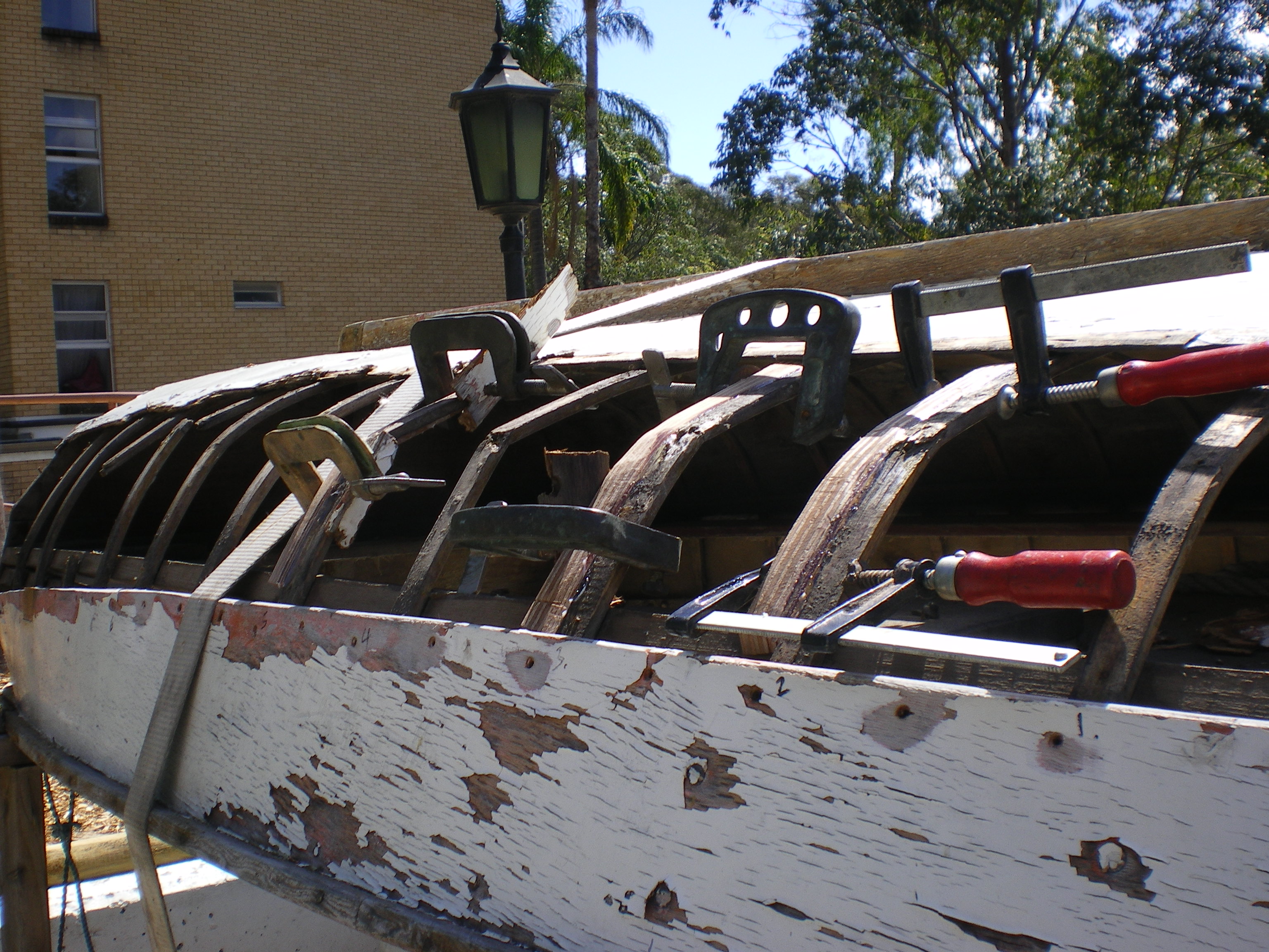

Going to have to form up a few layers of thin ply around a curved timber mold and clamp and glue to get the correct shape for each rib. Lucky I'm semi retired now! Fun.
100% no sand, no stick!
Look up peel Ply, it will help with the finish on the outside.
Sand it is then.
Boat and Seagull parts working together....
Just a bit of work ahead of you then! I like the vintage c clamps! :lol: I have seen them being sold as that too!!
Perfect boat repair weather here. Hope the clamps don't get nicked! Communal car park. I reckon I might float-my-boat by chrissie 2018 :lol:
Coming along well. Ribs repaired ready to re plank.
