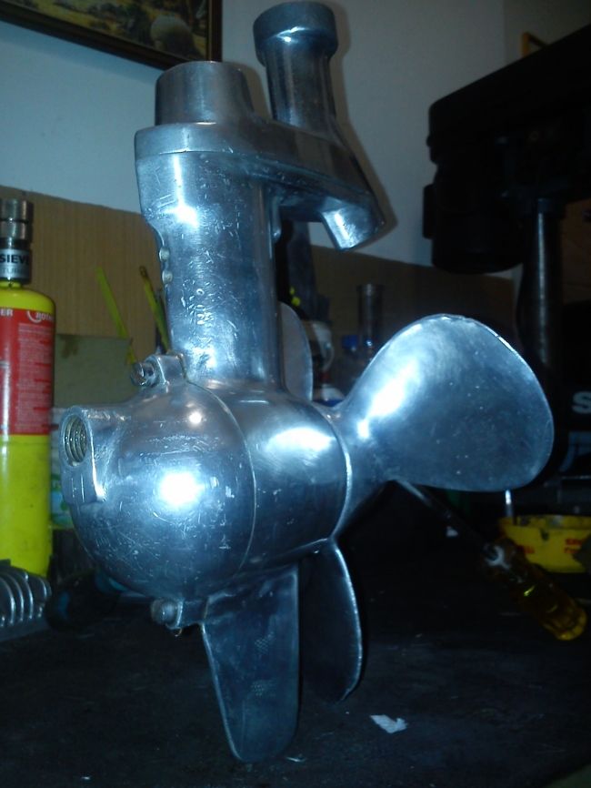

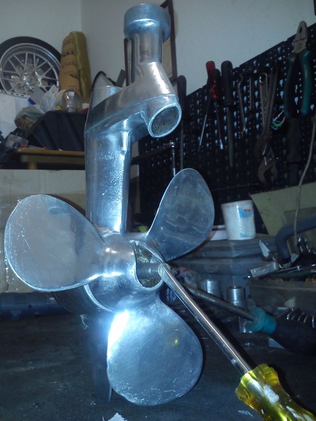

I 've got something for Rob who seems to appreciate polishing :mrgreen:
I love the 10600/145 turns!!!

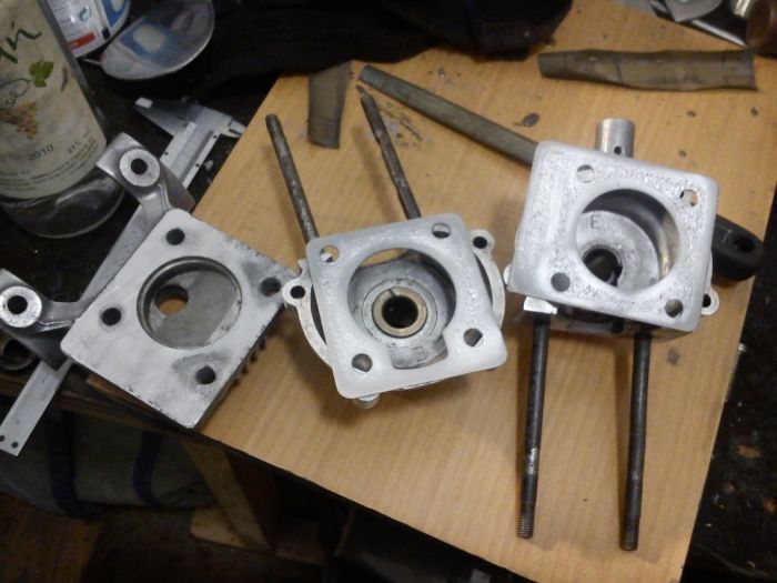

Soon we will see! Today I assemble the powerhead, did they had 8 hands back in the 50s when they were assembling these motors? Too many surface to apply gasket material and it was drying. It was a challenge but I think everything is OK.
I would like to ask about the torque setting. Should I tighten the head nuts to 18ft/lbs as in all the other models or do I have to tight them in a lower setting?
Picture shows the gaskets after being chrome platted. The platter said it's the most protective coating and there is practically no effect in the thickness.
The also repaired from the corrosion with a heat resistant epoxy compound. I hope I managed a proper sealing.
Oh, I almost forgot. The plated gaskets are 1.32mm thick.

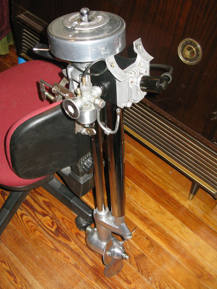

Almost!!

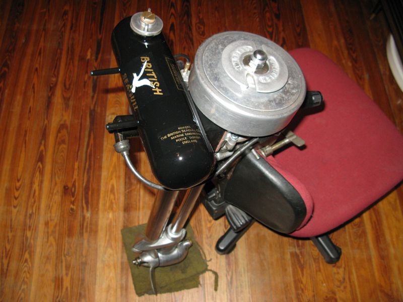

At last, RTV (sorry Bruce :D ) cured and I tested the engine. Success achieved! No crankcase leaks, no any other leak and the girl fired hard first pull in the test bin with the prop on!
I fed her in the beginning with a mixture richer in oil than 1:10 as I honed the bore and the piston rings are new. I then heard a "squick squick" metal noise so I though that some more oil would do good in the beginning. Compression feels a lot better but the gauge showed 62psi. I was waiting to see something better but this measurement may be a result of running her to stop due to luck of fuel, so the bore may be a little bit dry.
Now waiting for the decals :D

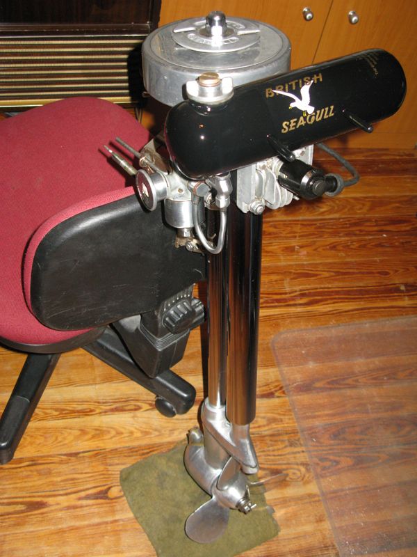

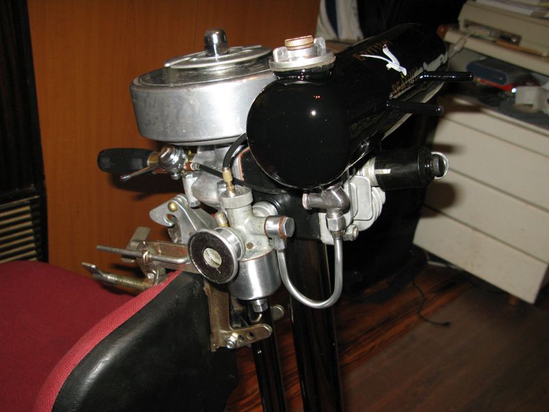

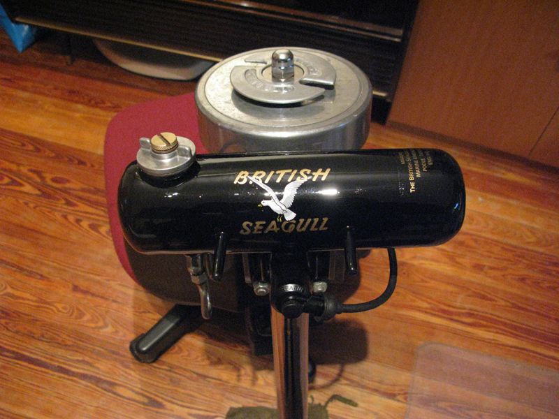

Good morning gentlemen :)
Gannet
Posts: 816
Location: Cirencester
Re: FVP10021
Post by Gannet »
Stelios,
Well done. It looks really good, you must have spent a lot of time polishing it etc.
Out of interest, did you replate the float chamber bowl?
These later FV/FVPs are interesting. Do you know at what stage BS changed the mounting bracket from the earlier 'fixed position' early type to the type like yours (as per the LSs) that can slide up and down the drive shaft tube?
Well done again.
Stelios_Rjk
Posts: 1458
Location: Athens - Greece
Re: FVP10021
Post by Stelios_Rjk »
Thanks for your comments Jeremy, the float bowl is the original chrome plated. The original plating had come off to a point. The platter said that it was platted with cadmium, a technique that is abandon these days. About the transom I don't know when BS change it. All parts are as it came apart from the tiller arm, the throttle lever (thanks Adrian :) ) and the top nut. It had a regular brass nut.
About the polishing I learned the way so now it's just matter of time and some hands rubbed off..!

Gannet
Posts: 816
Re: FVP10021
Post by Gannet »
Stelios,
That is very interesting to hear that the bowl was cadmium plated. I have suspected that might have been the process, but never had it confirmed.
The bracket that I was referring to was the aluminium one which has the trunnions cast in with it, and the latch hook is fixed to it at one end; the other end is clamped around the drive shaft tube. With earlier versions the clamping is around the lower crankcase itself.
I was not referring to the bronze transom bracket.
I am interested in when the design was changed. I have no reason to think that yours is anything but correct. Recently I came across (reputably) FV12508 which had the same arrangement as yours.
If you are short of items to polish and having withdrawl symptoms, just let me know!!
