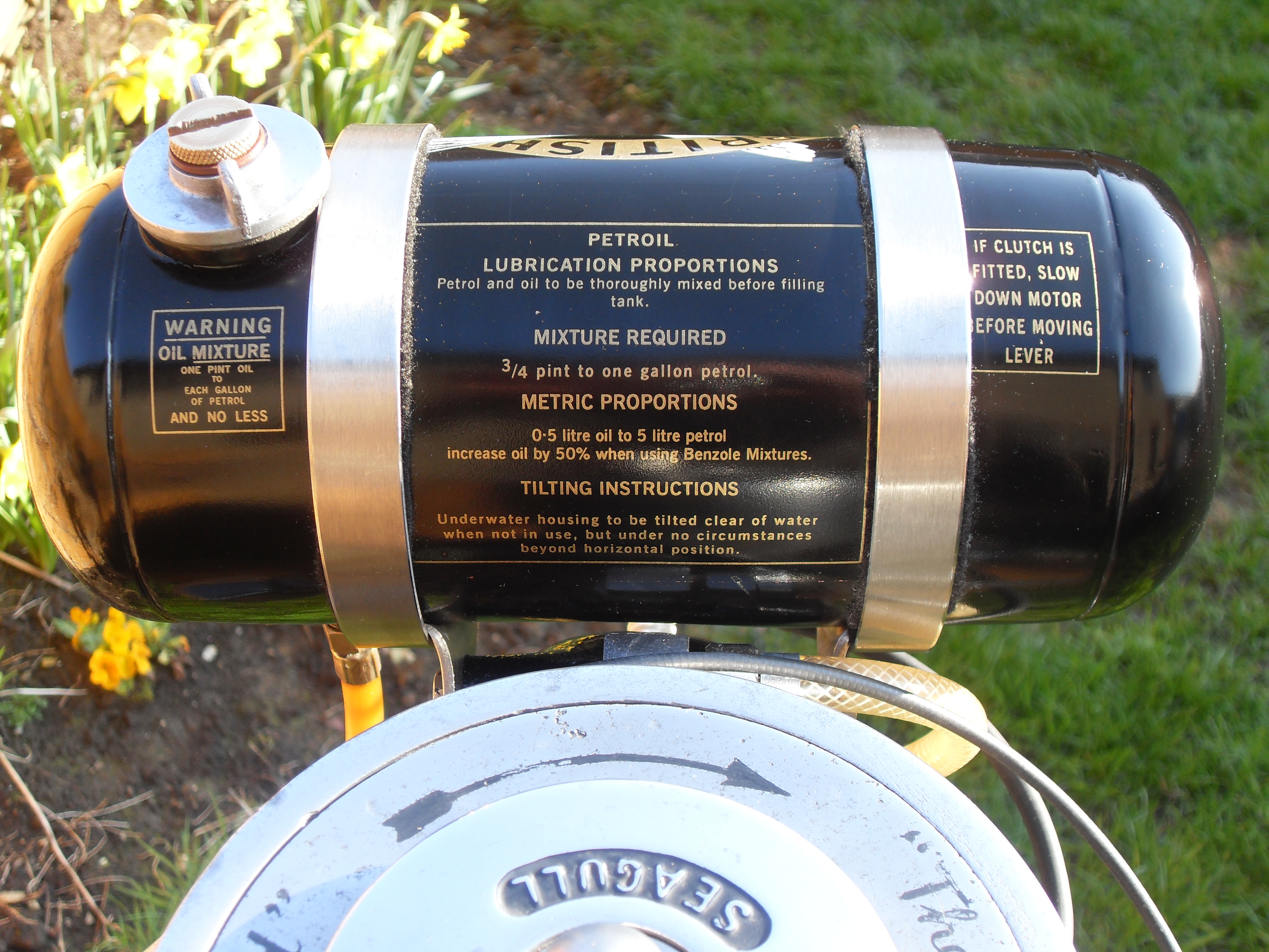

Very smart Stelios! Well done.
I guess it is FV19309, unless you have another one?
Jon has been encouraging me and showing me how to paint tanks. He has also suggested that I get a gold pen to repair the decal. Did you use a pen or did you use a brush?
By the way, has FV19309 got a Dover grip?

Hi Jeremy, I used thin brush. Serial is FV 19309 and I am missing the Dover grip.

I've had some pretty good results in the past with a fine tipped paint pen, the sort you can get from an art/hobby shop.
I use them on the ignition covers to re-apply the paint into the writing "The best outboard motor in/for the world" and the direction arrow.
As for tanks, a lot depends on how good or bad the condition is to start with. If the tank is dented i'll completely strip all the paint off and start again. When it's all done, a new decal (closest match possible) finishes things off with plenty AND I DO MEAN PLENTY of lacquer. (take note Jeremy)
I'm a little concerned that the black paint is not a very good match, although it may look completely diferent when its been lacquered.
I wonder if H-A would like to upload some pics of a Marston tank with some before and after shots!
I'd certainly like to see how it's done.

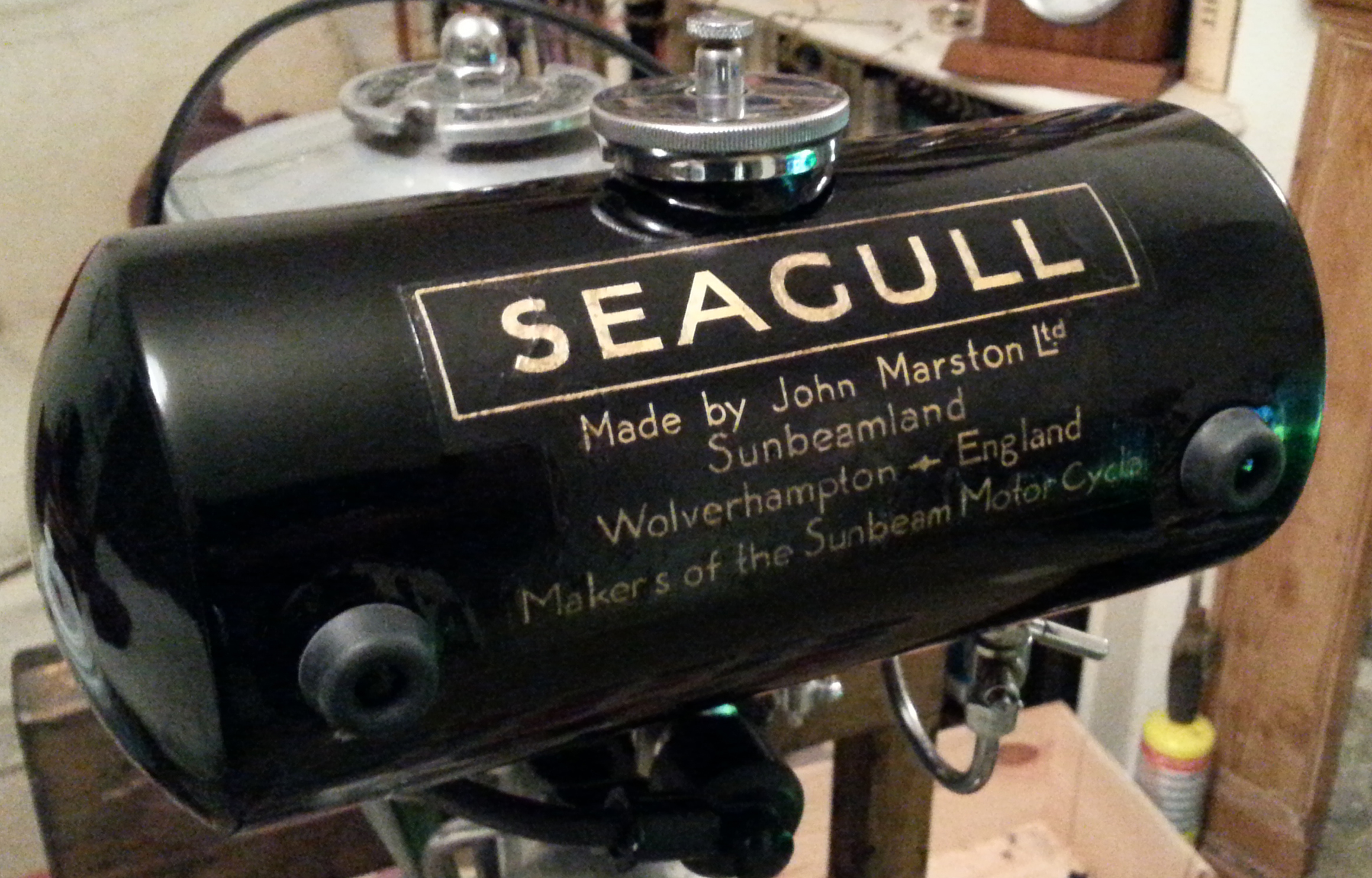

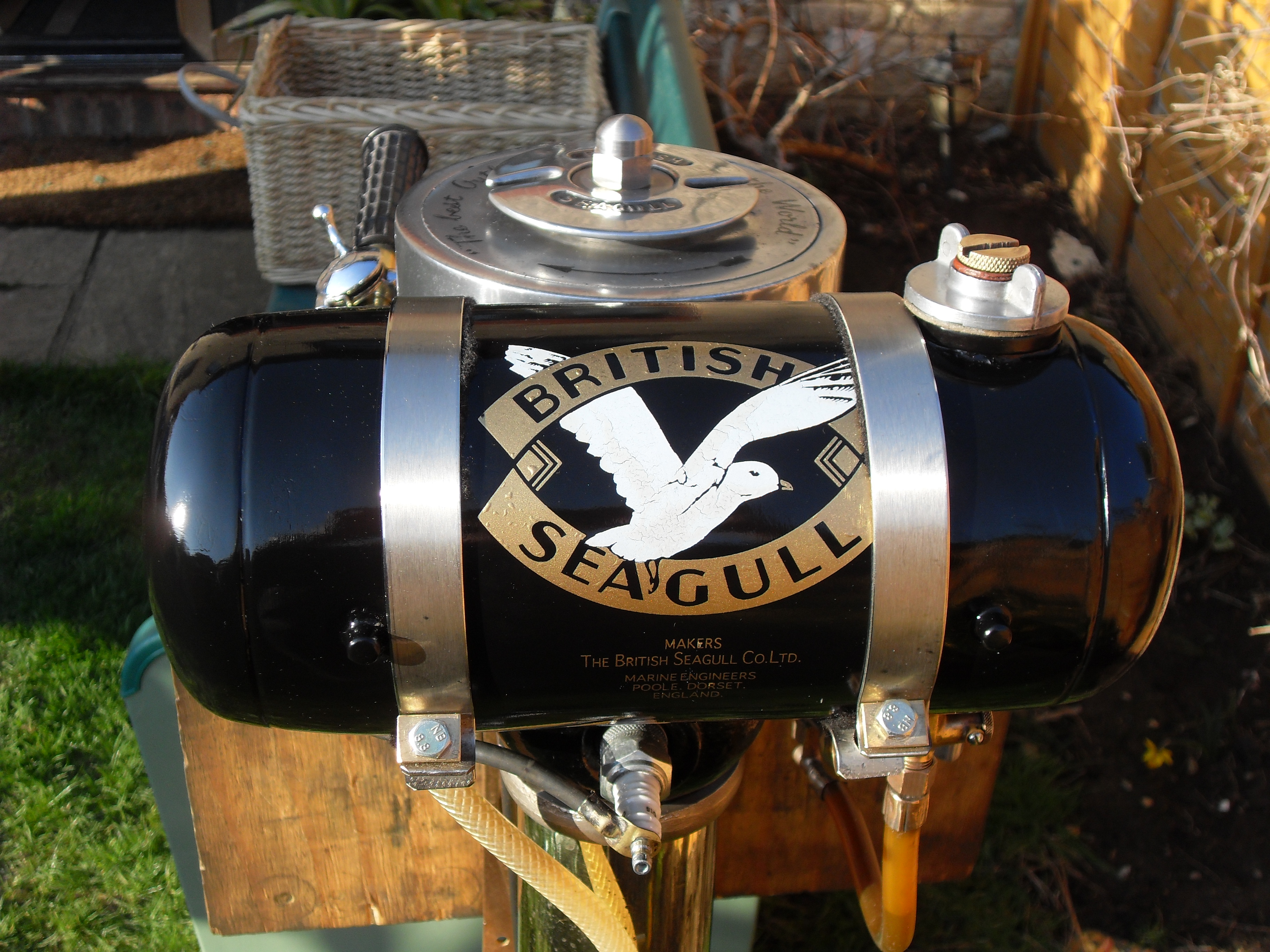

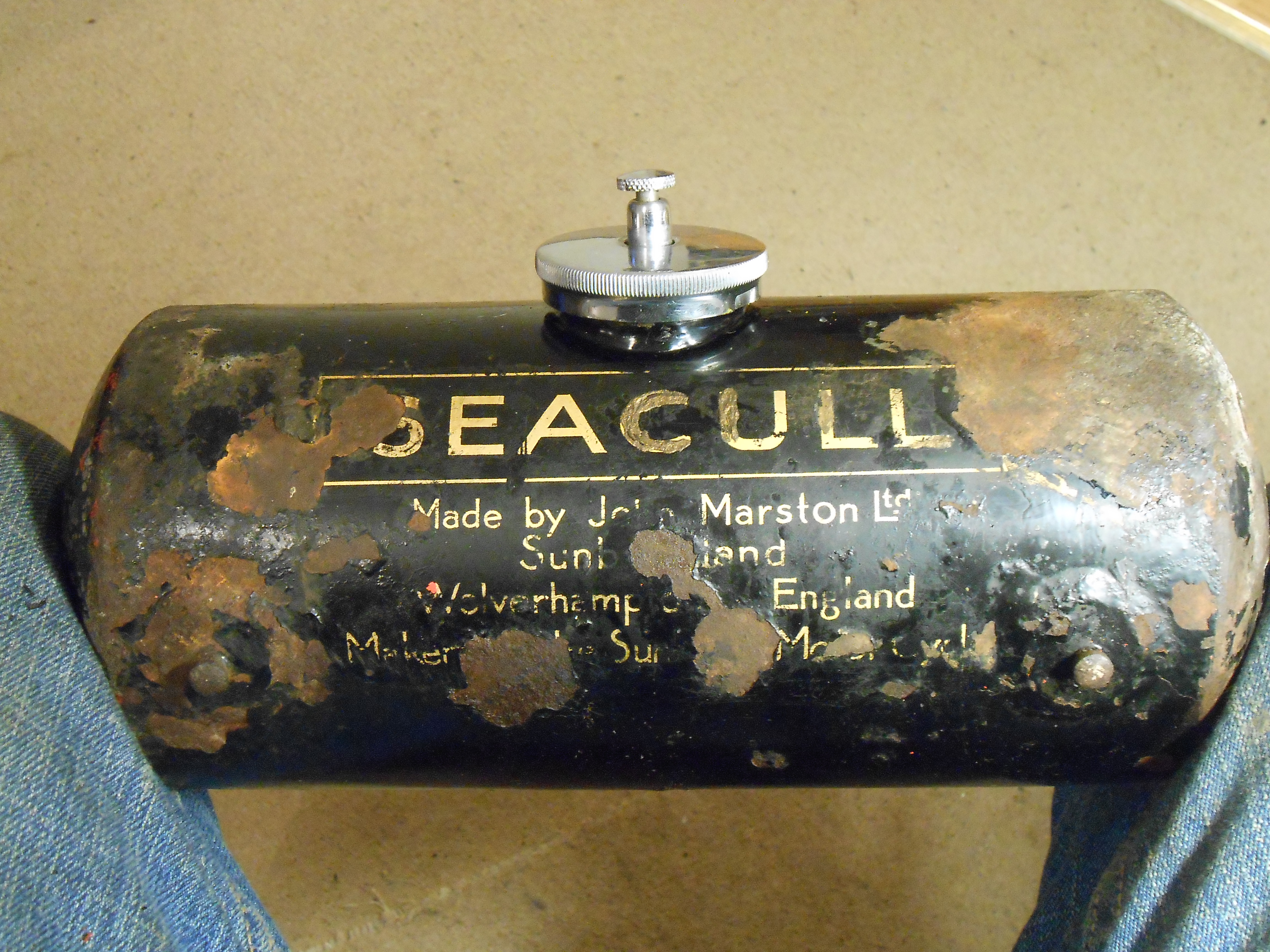

Re: The best way to get back home
Nice pics H-A thanks
Not to be too critical here (and i know first hand how difficult it is at getting this looking right) pics 1&2 look to be the same tank with various parts of the black touched up along with the gold (nice job) has it been covered with lacquer yet?
Pic 3 looks to be a different tank with a new decal fitted (you can clearly see the outline of the waterslide transfer) but if you're brave enough more lacquer will eventually cover everything so you barely notice any "step" around the edges. (is this a reproduction transfer?)
Pics 4&5 look to be the same tank (a work in progress possibly) again nicely done.
headdownarseup wrote:Nice pics H-A thanks
Question for those that might know.
The lacquer/varnish that was on these older tanks, is it a satin finish or gloss finish?
That tank pic 3 is the finished tank pic 1 as bought, the outline is the edge of the original paint, I sandblasted round the restored transfer.
There are no reproduction transfers for these engines as far as I am aware, the original artwork would have been hand painted in the early thirties, then reduced photographically to make the screen for printing. Some of the letters if studied closely are slightly different, there were computer graphics in those days.
The original transfers were not covered with lacquer, that is why so few survive.
The tanks were high gloss black, ICI bought Sunbeam for their paint technology I believe.
