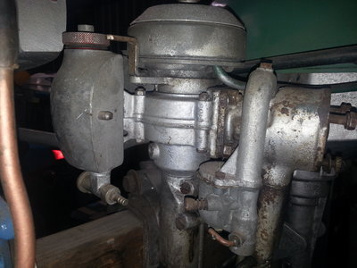

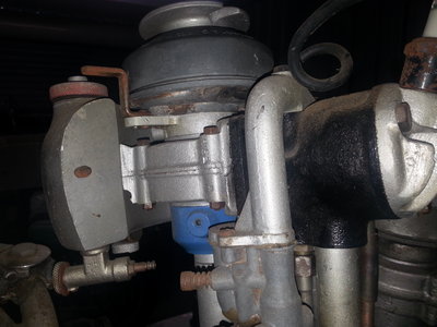

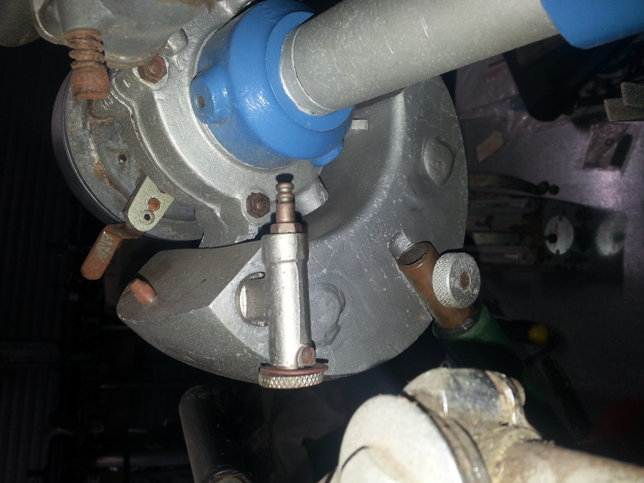

I have lifted from my RRRRRS and boxed up the Mk1 tank, air valve and manifold plumbing and posted to Chris today.
There are some sneaky up till now hidden things within.
I am sure that His skills will have all duplicated and documented in no time flat. Useful for everyone I am sure.

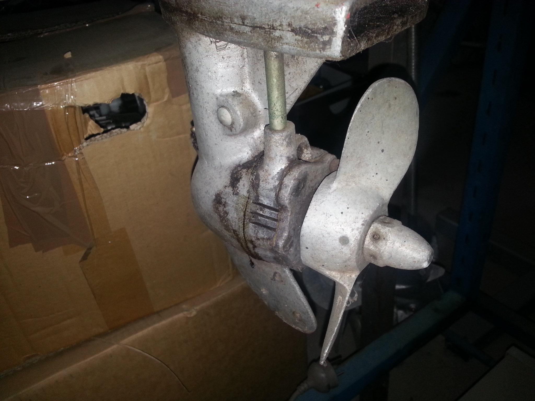

Earlier post shows a very shiny gearbox. Very shiny prop nut.
That is a later nut. I would say by the look of the castings...a "Sea Maid"

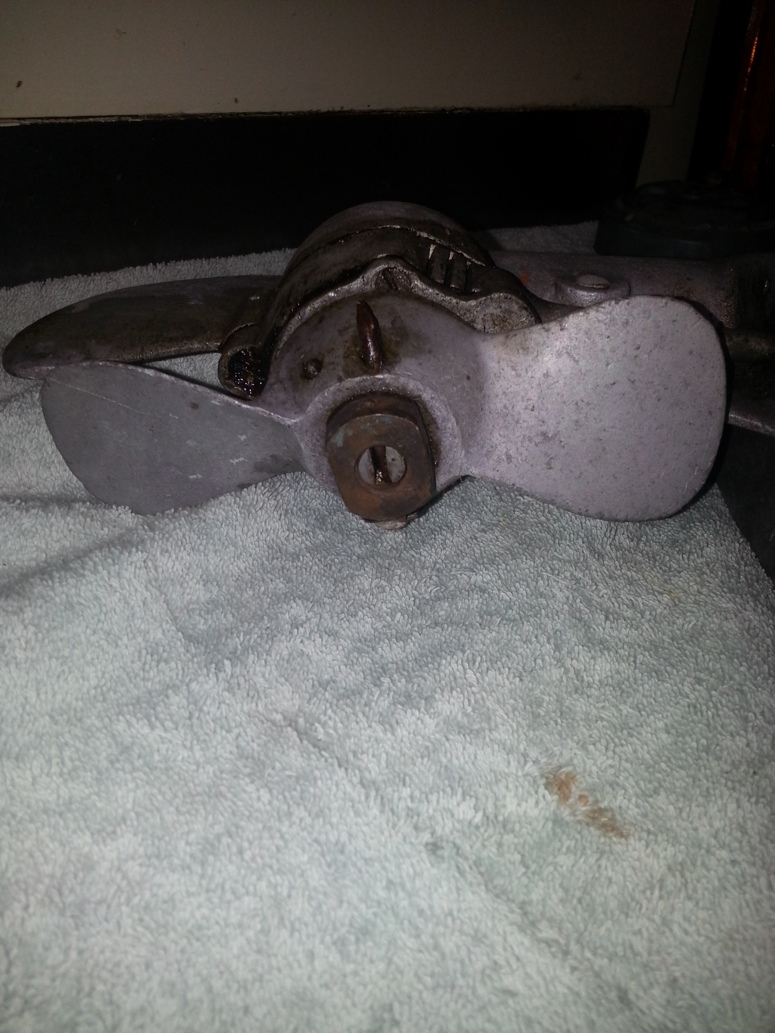

Below is a pic of an early nut (On the parts donor Mk1).
Chris, is this what you have on yours?
The nut is brass round with two flats. It has a lock pin.
The nail so obvious should be a length of brass rod bent at both ends. That is the shear device.
If you have the same nut Chris.....that is 2 out of 2 known examples aye. :shock:

your lower leg looks the same as mine only mine has a standard looking brass nut with a brass shear pin bent at the ends like you say.
I will post a pic later.

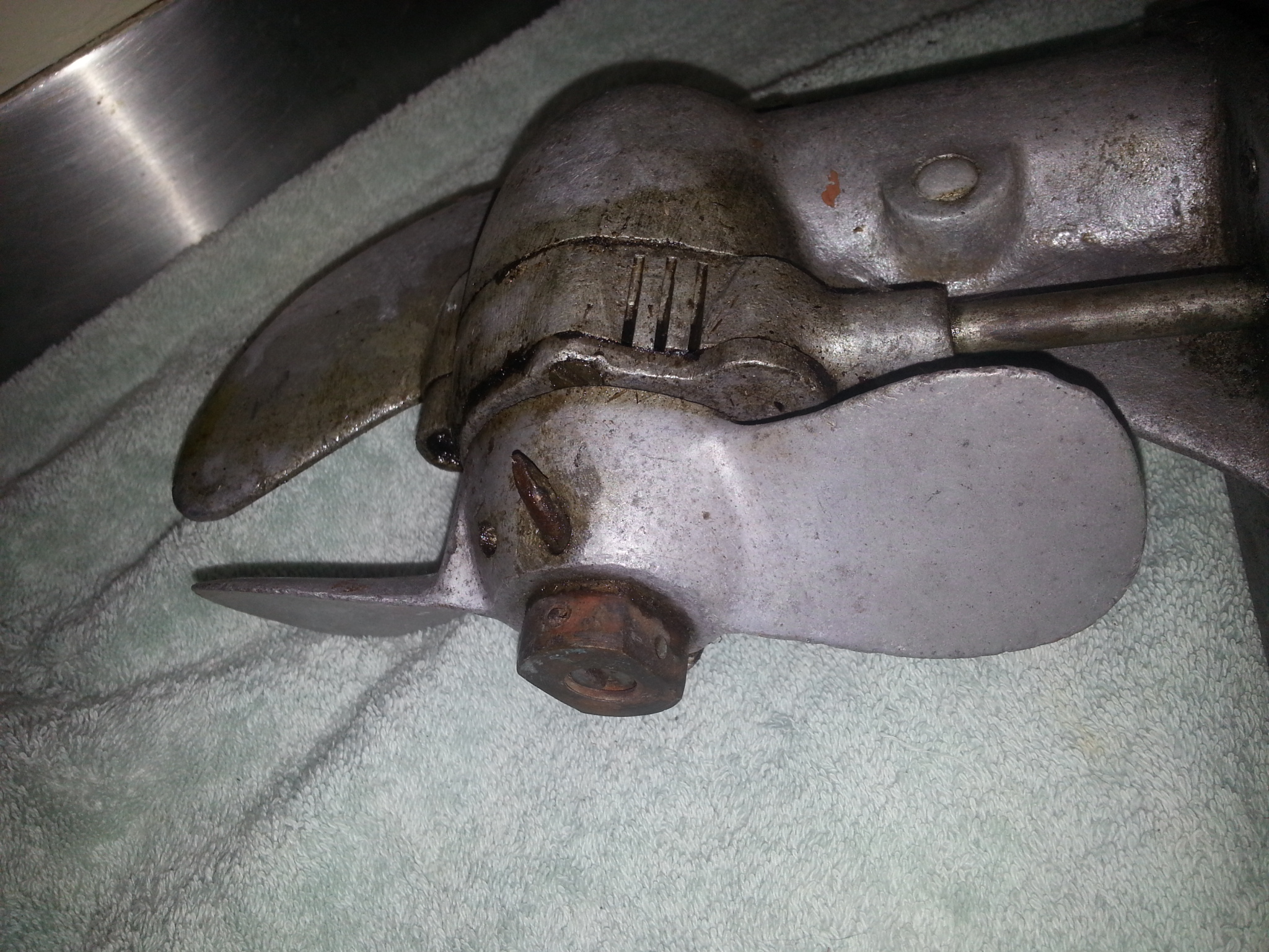

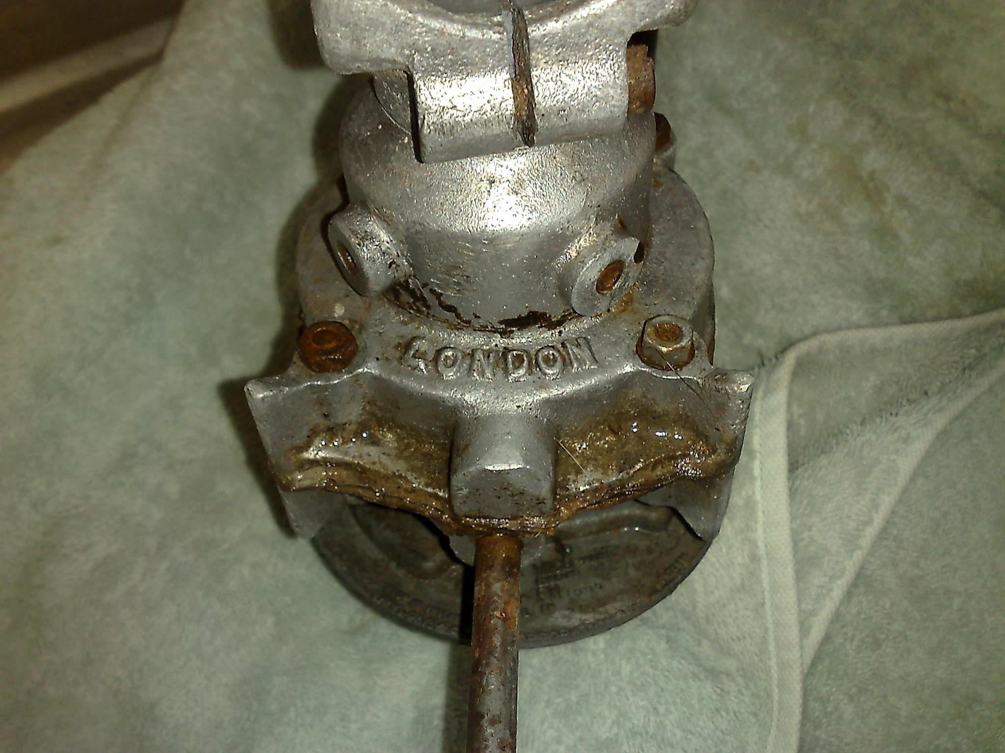

RRRR I be seeing a hex nut for shore.
That there Hex nut be as on others I have aye.
Old shipmate nuts to be shorrrrrrr.
Me thinking there be some casting marks not spied before by my eye....aye.
She Blows as below Davey Jones.
They Be both the castings aye top and the under RRR.
[/color]

RRR yes my is the same as yours!
there is little grub screws in the two casting lumps either side of LONDON. My guess is holding a bush for the drive shaft (I have not had that apart)
"THE KING OF BLING"!

I have explored in one of the sheds and took pics of some of my Mk2 Minors aye.
Advance retard casting is visible.
No "London" at all.
And low and be hold shipmates............a fancy prop nut ARrrr.
MK2 being red plate with mixer.
B[/color]

Interesting!
On my engine the casting has some grinder marks (probably where the casting was fed from) I wondering if the casting may have been broken at this point and that is where the leaver was attached?
That is also the same side the mixer is on!
Only thing is it is on the opposite side to the pics you show. Is there any grinder marks on your mark 1 casting?
