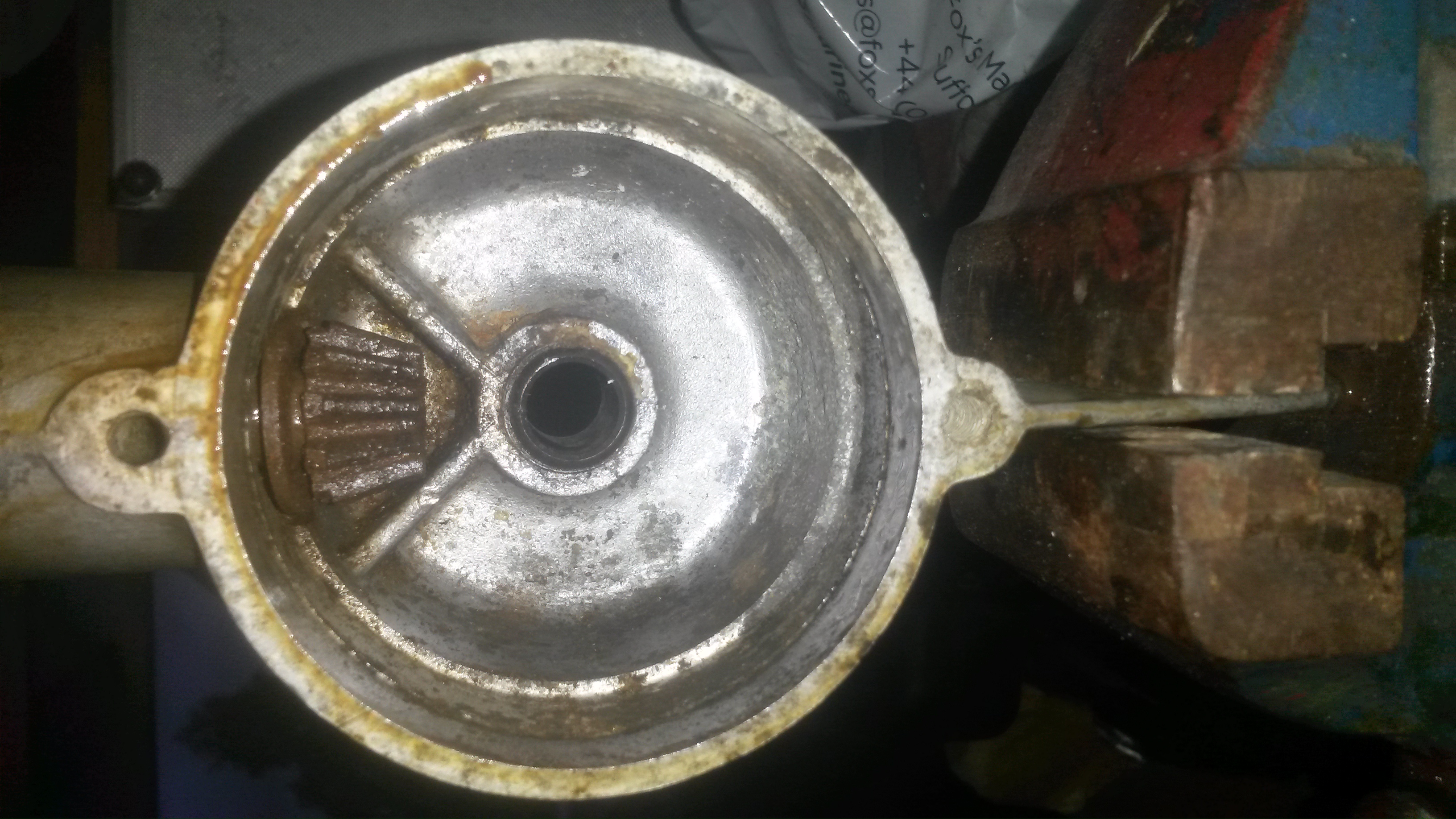

Well the 40+ looked less chewed up then the one from my featherweight, plus I like the sound of the better gearing!
However the pinion shaft is very stiff in the 40+ box, and I think the shaft may be bent hence why it's so stiff.
Now looking down the shaft from the top, there was a split pin through the shaft, and a washer under that, I managed to remove the pin and washer so now I can move the shaft up and down, but I can't see any way of removing the pinion gear from the shaft itself to get the whole lot out?
Any tips?
Any tips?
P. S you happy I posted pics now?
Re: Draining the mayo out the gearbox
Before you end up potentially screwing something up. STOP. (it might save you a shed load of work from here on in)
First things first.
The pinion is stiff to turn correct? (partially seized)
Use your blowtorch and apply some heat to the casing in the area of the pinion. (the outside of the casing)
WD40 on standby, squirt some lube down into the bush and with an adjustable spanner on the square section of the pinion start to turn the pinion. Re-attach the square drive tube to help make things a bit easier to turn.
Keep working things back and forth and it will free off. Might take a few minutes but works well enough for what you need.
If you have a power drill that will accept the size of square tube, use it and keep spraying the lube whilst spinning the pinion.
I tend to clamp the drive tube in a vice and turn the gearbox by hand, but whichever way works best for you.
Heat, soak with lube and turn then repeat till free. (make sense?)
The pinion has probably seized from very long periods of inactivity and lack of lube.
If you don't need to remove the complete pinion then leave it well alone. Only tackle this job if you are completely confident you can put it right again.
Trust me when i say it aint easy to remove it in the first place without a good drifting tool and a mahoosive hammer.... (done a few and wished i hadn't)
Clean all the innards and rebuild with the correct parts (same procedure as featherweight box, basically the same design just a bit bigger).
And as uncle Charlie has pointed out, silicone on one side of the gasket when you put it back together.
And yes, we like pics... thanks for that
First things first.
Ok, I've stopped, I've been using wd40 but not tried heat yet. Will give that a go tomorrow!

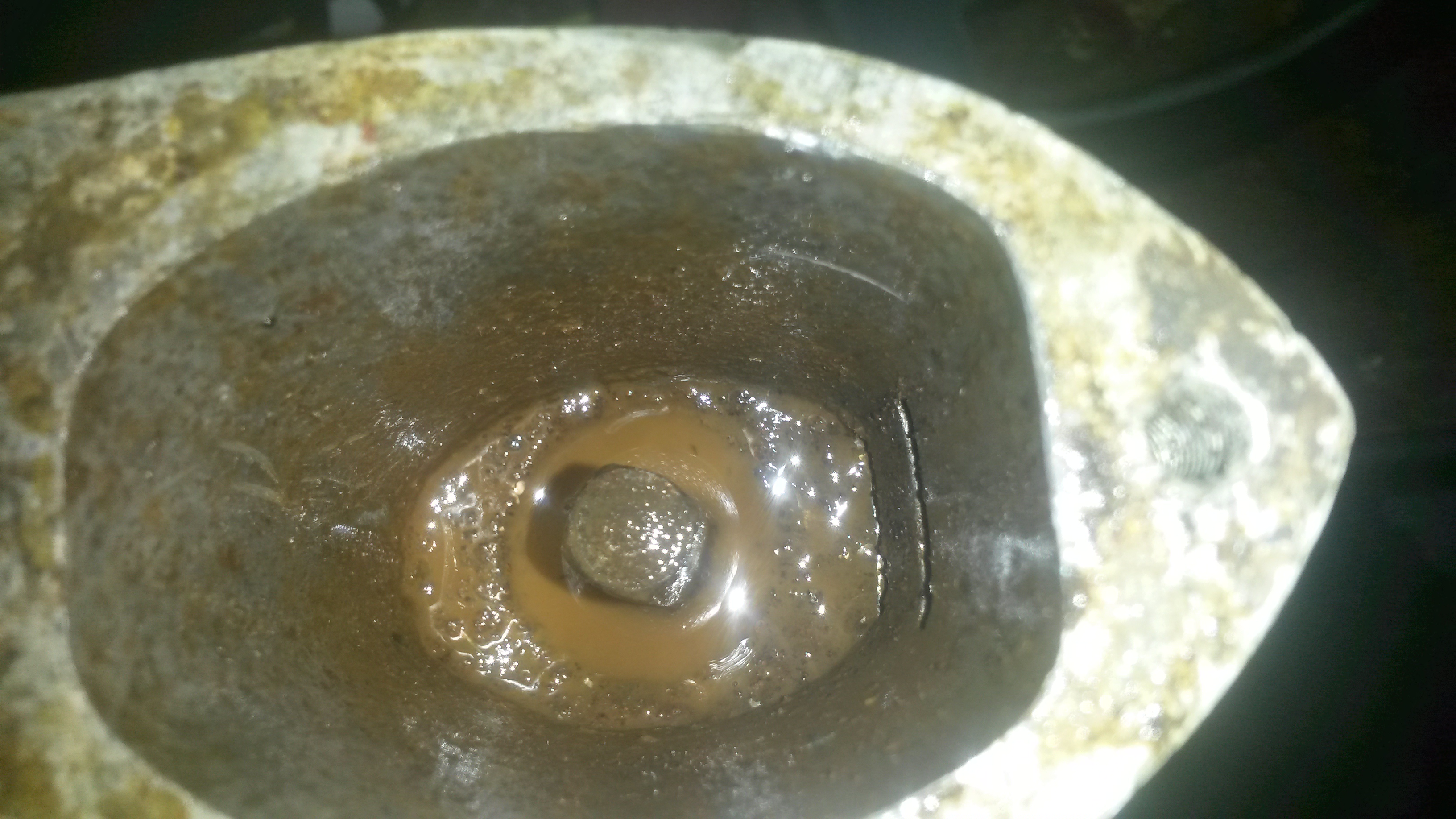

Just got a 1966 seagull that hadn't run in 25 years. Thick Mayo!
As I heard the gears ran with a little water mixed in, I tackled the problem by squirting in some fairy liquid and boiling water. Then turned the motor over with a socket attached to a power drill. Rinse and repeat a couple of times until clean water. Then refilled with SAE 140.
As I am new to this, have I committed a cardinal sin? This seemed an awful lot easier than other processes for dealing with mayo.
Yep, you sure have! Did you lubricate the bore and crank before spinning the motor? The decription I like for gearbox oil is that it should look like Baileys Irish Cream...yum.
I had thrown a spot of oil into the cylinder earlier in my attempts to start. Tried everything to get a spark and then noticed the connector in the ignition lead had slipped back up its sleeve. Put that right and it was off after 25 years long before the first pull was halfway. Quickly stopped and then tackled Mayo.
So gears should not be a prob after my quick wash up?
