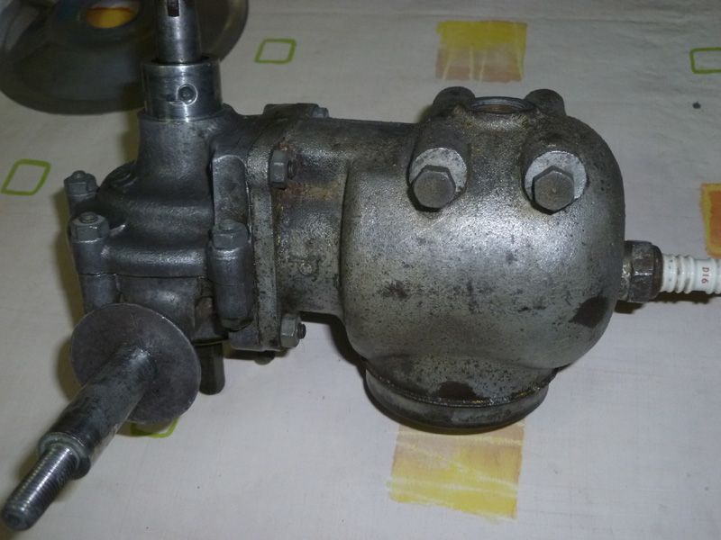

Hello guys,
I have just fit the magneto to the crankcase. The coil must be dead. I didn't get a spark. At least the powerhead turns free. Adrian :wink:
I had great difficulties in fitting the magneto as it has a steel ring in the center of the backplate and things get complicated. Finally I made it.
Now about the coil, what should I do to be sure that this is the problem?
It has crossed my mind to check if I can get made copper cover here. I will check it when I find some time.
I love the 10600/145 turns!!!

The mark 1 villiers magneto is particularly prone to the coils being dead. Its probably worth expecting any of these magnetos to be dead, and its a bonus if it works!
You can buy replacement coils from villiers parts with small sleeves to make the diameter of the centre shaft correct. Not cheap though. The same supplier can also supply the original condenser and points if needed.
That's the problem with SDs not cheap to restore!
Check the resistance from the plug lead connector on the coil to earth or the centre spindle of the coil, it should be around 4k ohms I think. Yours may well be open circuit. My SD was exactly the same. The inside of the coil will most likely be a green mush of corroded copper wire...
These engines are a marathon and not a sprint :D

I checked with the multimeter, I was getting around 4kohms. So I though that something else was going on. Take of the cover and checked the point. All the time open and when the flywheel moves the one point, they are just getting closer. I adjust them to be in touch when the flywheel moves the one of them. And that was it!!! :D :D :D :D
As a conclusion I understand that it works the opposite way than MK2 works. The plug sparks when the points are in contact. In MK2 the plug sparks when the points are open.

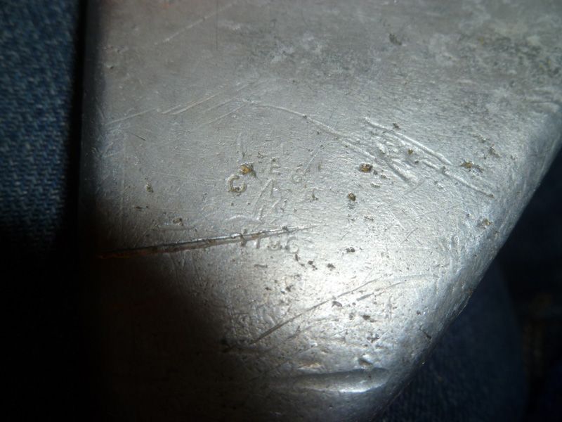

By the way, I locate a skeg stamp but it is quite fainted and I don't know how to preserve it from polishing.

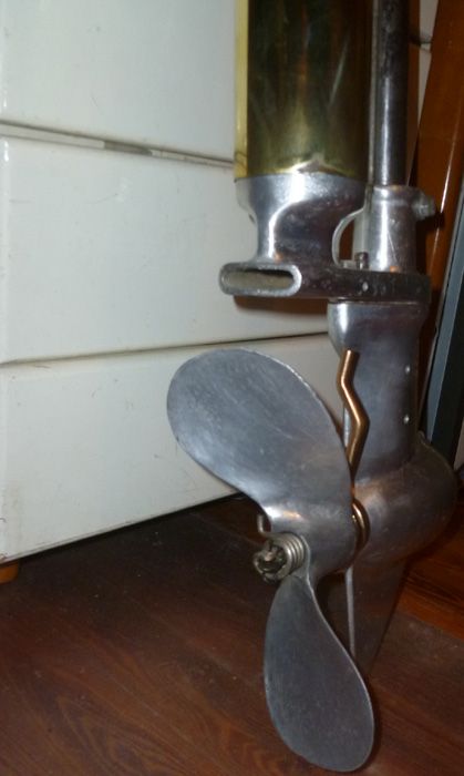

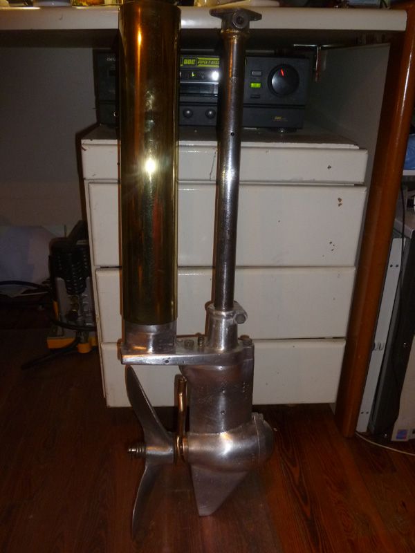

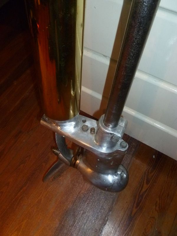

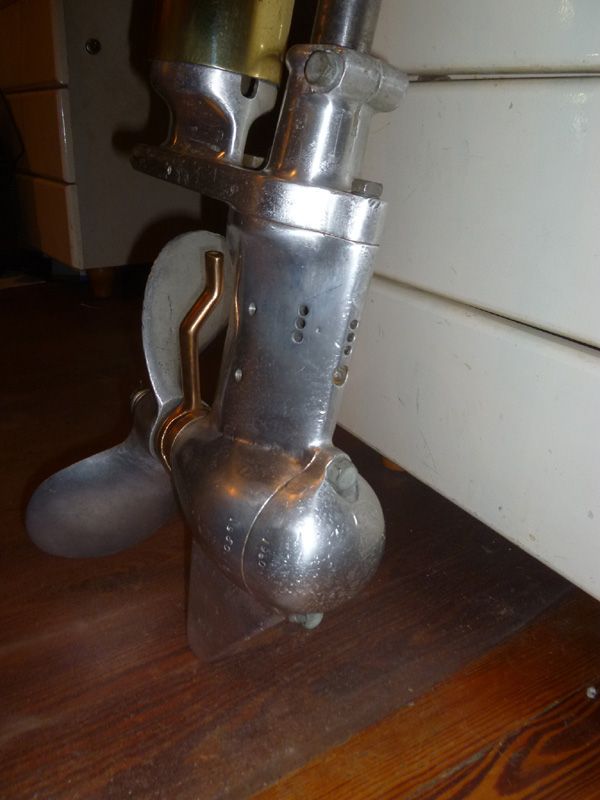

Some progress!
On brass exhaust 500-1000 wet&dry, then polishing cream.
On aluminum parts 320-1000 wet&dry as they had hard marks.
On steel drive shaft housing 280-1000 wet&dry because corrosion have made porous that finally couldn't get rid of them.
Now the next question are about the drive shaft housing. What do you suggest? Chrome or galvanizing?
About the block and crankcase. The crankcase could remain as it is. It's not fancy but I was polishing from the morning and only in the idea that I have something left I can't stand it :P
The question is whether to polish it or leave it as is or?
Now about the block. It is in good condition and I would like to to something close to the original. Galvanizing was one thought but the heat (420C) may distort it (I wouldn't like to risk it). So? Should I paint it black? Any suggestion welcomed!

Re: Santa Claus passed by my neighborhood (SD!!)
Nice job stelios! Polished up SDs look very good.
I've always painted my blocks black, but I do have a SD block in perfect original condition, so that one won't be painted.
I think the black painted block sets of the copper water pipe etc. nicely.
The original SD had a drive shaft tube with a dipped zinc finish like that seen on a galvanised sheet, like a matt grey. However I personally like to see the chrome finish if the original zinc is no longer present.
The crankcases can be cleaned with a rotary wire brush, followed by hand polishing with wire wool dipped in metal polish.
