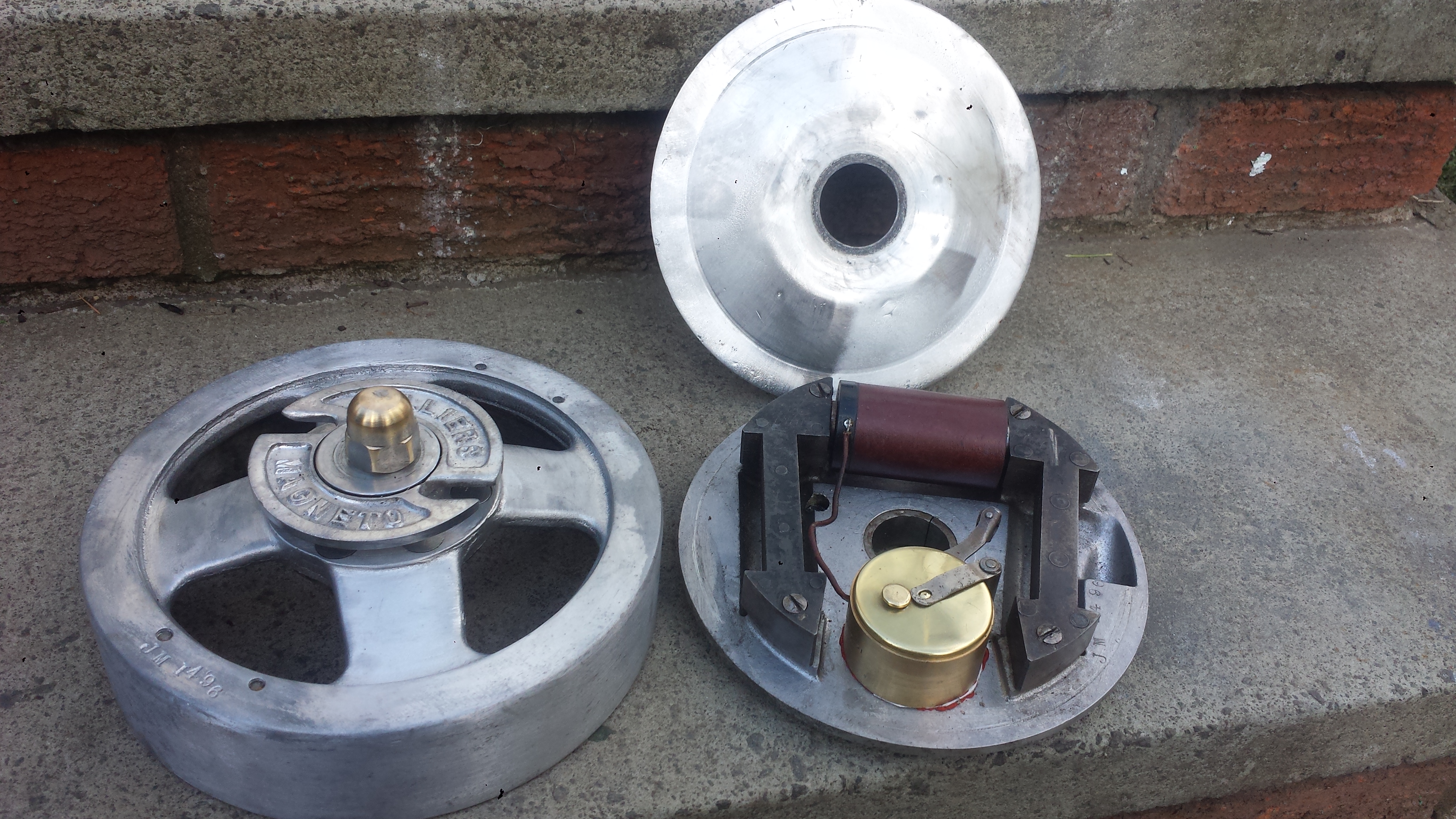

Attached is the ignition of my SD.
Then the spare ignition I have, My question is would the COIL ONLY fit and work on my SD.

Your first 2 pics show a slightly later (what i've termed as) MK1 FLAT TOP baseplate. Quite different to what SHOULD BE on your SD. These ignition systems are generally more common on post war 102's up to about the early 1950's and they also have a Flat topped flywheel, hence the term "flat top". Just because it has some green paint here and there doesn't necessarily mean it's a genuine wartime item. I can't begin to remember how many so called "un-touched barn found condition" seagulls i've come across over the last few years that once belonged to somebody's great uncle that served in the second world war. It's only when you start asking questions that you find out the truth about some things. Things aren't always as they seem.
Your 3rd pic is of a proper original "coolie" baseplate. This is what your SD should have, accompanied with a "peaked" flywheel that has 4 spokes.It will also have a JM number stamped into the top somewhere. All of the later villiers flywheels have 3 spokes so it's very easy to identify between early and mid-late flywheels.
The "coolie" coil is longer and slightly fatter than the later and more common coils you can find all over the place on ebay etc.
HOWEVER, with some nifty modifications it is possible to retro-fit a "common" coil into the coolie baseplate. Have a word with Hugo and he'll talk you through it, better still watch his short video on you-tube. These "common" coils are shorter and slimmer than the 70+ year old originals, hence the need to modify them slightly with spacers either side of the coil cheeks so they can fit.
The only other alternative is to buy the correct reconditioned coil from Villiers parts, a bit pricey but worth it. I'm going to have to do the same with my SD at some point as it too has a duff coil.

Jon his green flywheel & coil is a coolie hat, that's the Mk1 he's trying to repair it with.
His parts pictures are from a 62 manual not a 44, so have the flat top pics.

Hi Jon,
The 3rd pic is whats currently on my SD.
I will see if I can get the coil to fit tomorrow.

I have to agree that I think the green was added after. Tank straps were also painted on yours. The JM number may or may not lets us know if it was the original mag.
Now as for the coil. A lot of mucking around to get one to fit. I have done but only bench tested and not tested on the water. The Mk1 core is 7/16" ie 1/8" diameter less and also the core shaft is shorter so two adapters need to be made up. There is some question about the layers of insulation in the coils being different which changes the value of induction which may necessitate a different condensor. Having four pick up points may too cause some varients on the induced EMF. I compiled a quick vid of what I did. Apologies for the fuddy duddy music, I'm a bit behind the times.
https://www.youtube.com/watch?v=a0k5tFWHEtc
Personally, I would at this stage replace the coolie hat magneto with the MK1 mag until the coil can be replaced. You will note on page 7 of your line drawings it shows a mk1 magneto replacement (which dates the drawings later than '44)
When you say the coil is bad have you an open circuit reading (multi meter) from the pick up point (where the HT lead connects) and earth?

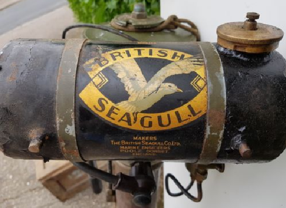

By the way that is one of the nicest looking original tank decals I've seen on an SD!! Glad it wasn't painted over.
