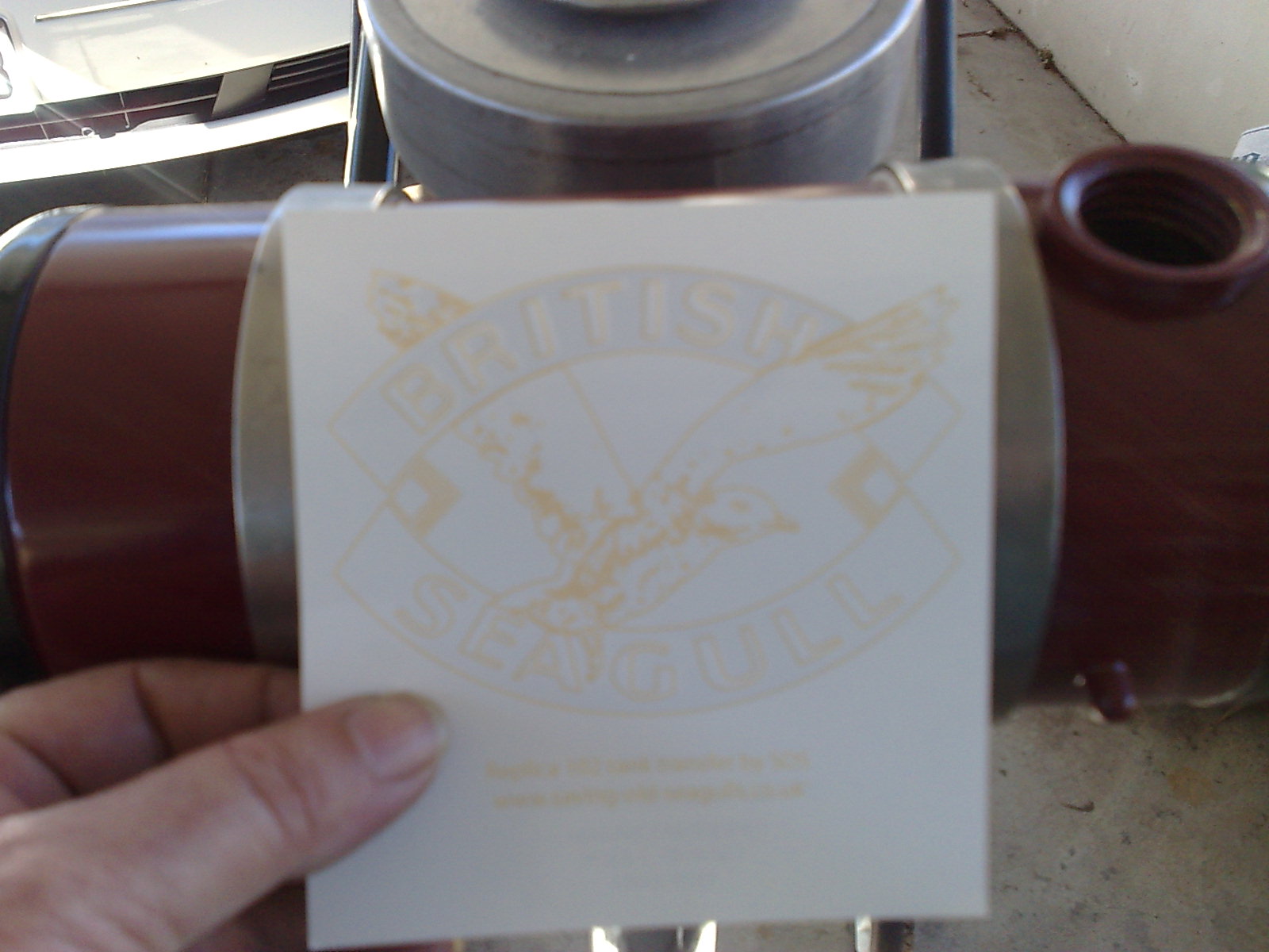

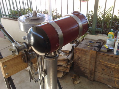

Hi All
Back into it.
Time to mount the tank and work out position of decal........I applied some "artificial" felt to everything so it all slides around until clamped down without scratching anything. It is recycled American Soda bottles going by the label... 8)
All good but when everything about right the offering up of the replacement decal?
It is either the decal is too wide or the clamps are too big......................they are the original clamps by the way.
The earlier version fits but I need that for other......
SIGH!
B[/color]

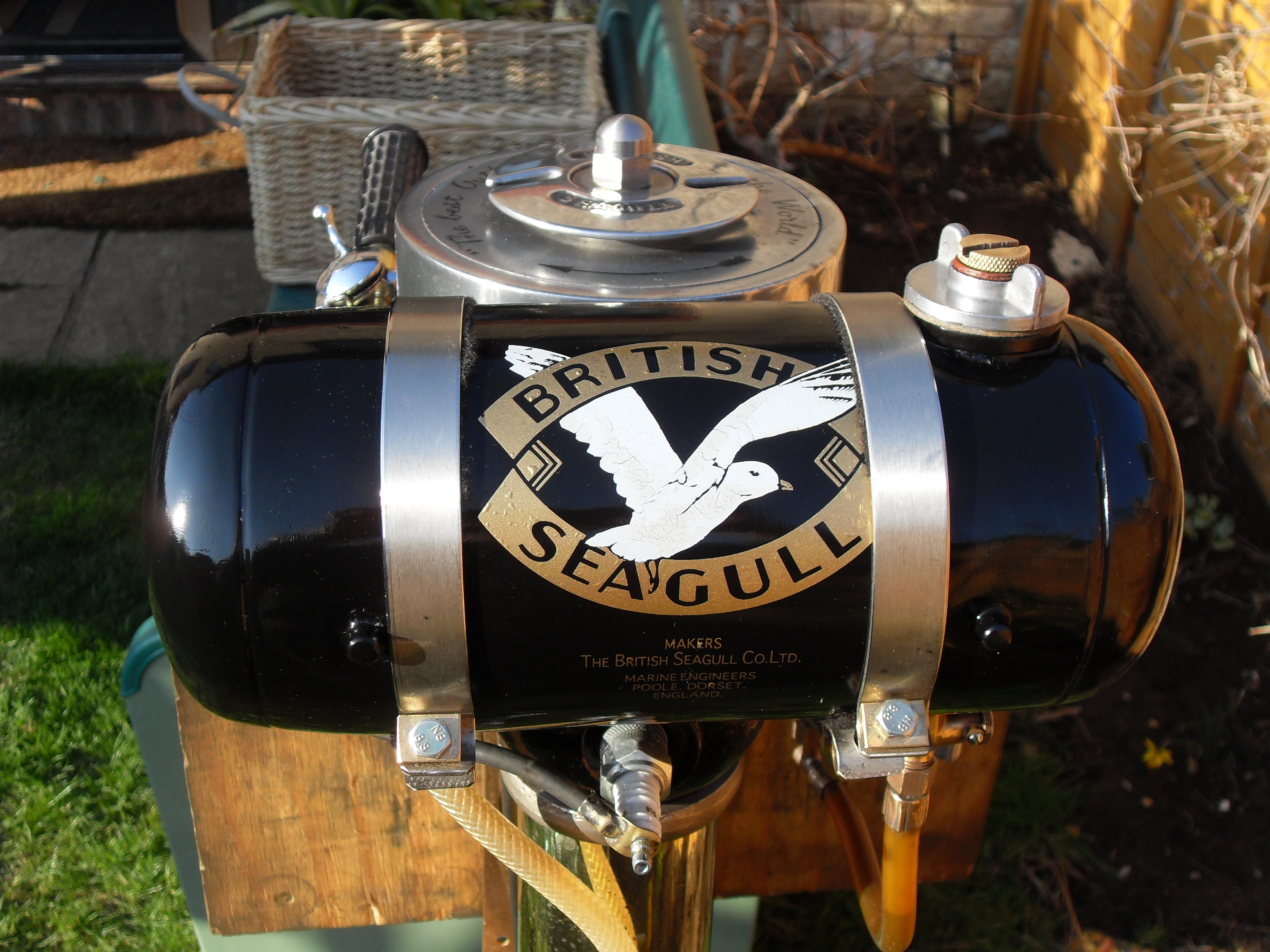

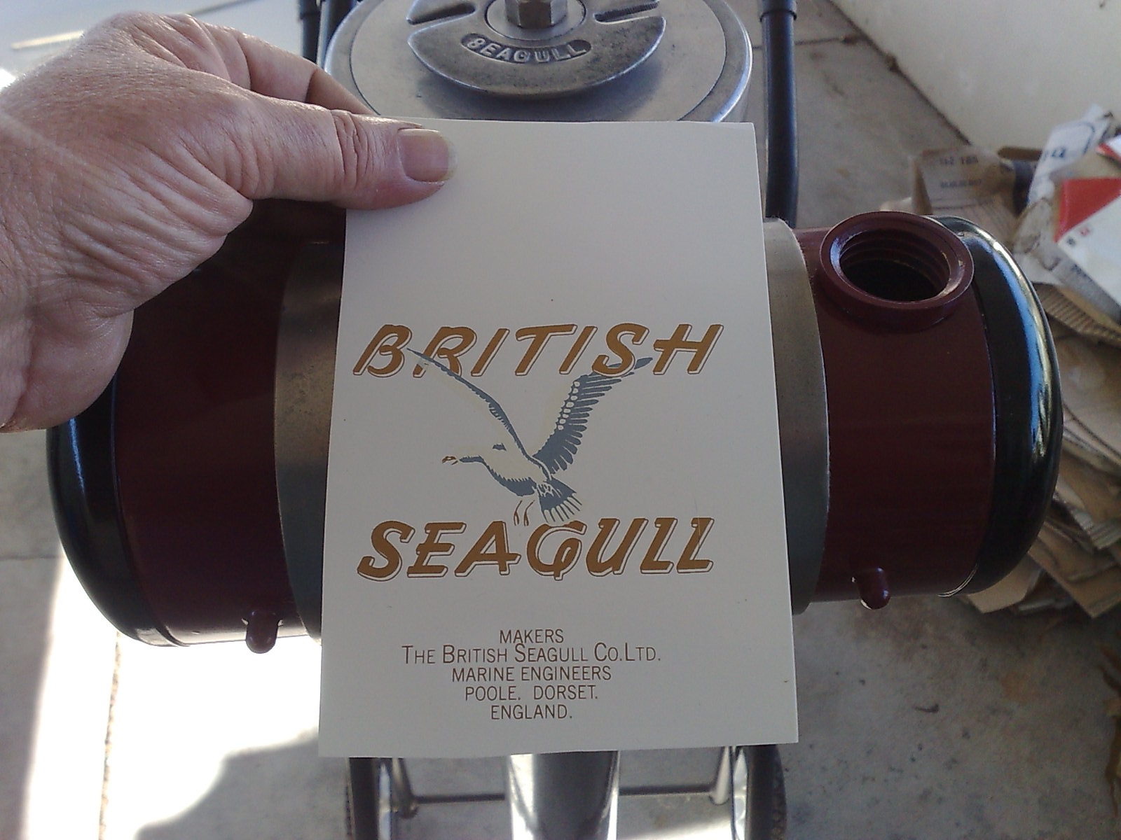

This is my original decal and clamps it never did fit why does any one know. By the way that is a beautifull job!

Re: Australian Delivery AC17964
I know exactly what you mean B
I had the same problem when i did this one!
A bit too far one way and you can't get the whole decal in between the straps. The decal was placed bang on centre with the stubs but still didn't work out quite right!!
Jubilee clips might be good alternative (just like the SD's) as they're not as wide.
I use some old bicycle inner tube cut into lengths, the same width as the clips for protection.
Looking the gods now B
Noted positioning of decal ........I will off set mine a bit.
So nearly ready to get the Old Dear wet.
I will be finding another carb body and storm cowl as when complete what you see will not be useable...........all threads slightly "Stuffed"......well "Stuffed any way you may wish to appreciate actually". Inlet and cowl threads............rest of body is OK so will use on an Anzani if required as they have a clamp on the thread for their choke arrangement.
The exhaust tube will be chromed again.
Fun in diminishing sun aye.
Decals still waiting........
B[/color]
looking pretty good now B.
It's always going to be a tricky thing to work out with decals and their position.
Once it's on, IT'S ON FOR GOOD. No re-adjusting with it as they're incredibly delicate. (kind of annoying really)
The trick is to measure 100 times (just to be sure) the position including the width of the strap/jubilee clip (whichever you're using to hold the tank on). The bit in the middle is what you've got to play with.
The tank in the earlier pics i did, i measured at least 10 times to work out the centre position BETWEEN the straps. What you see is the decal a bit too much to the right.
Even so, with everything absolutely spot on, there's still some of the decal hidden underneath each strap!
Question:
Is the earlier "flying seagull" decal narrower or wider than the later decal? (another reason why i said use jubilee clips instead of straps to hold the tank on,coz their narrower)
