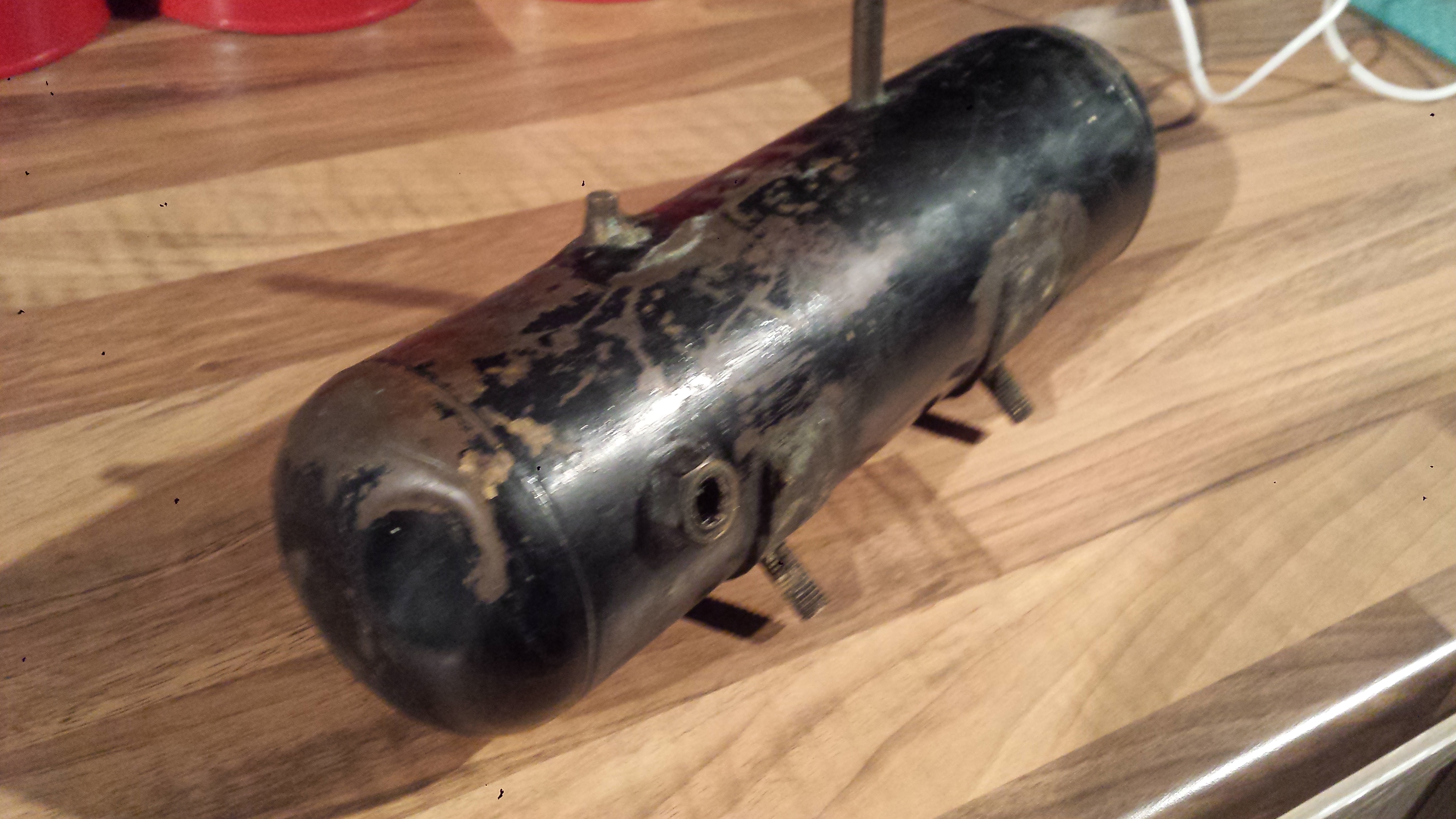

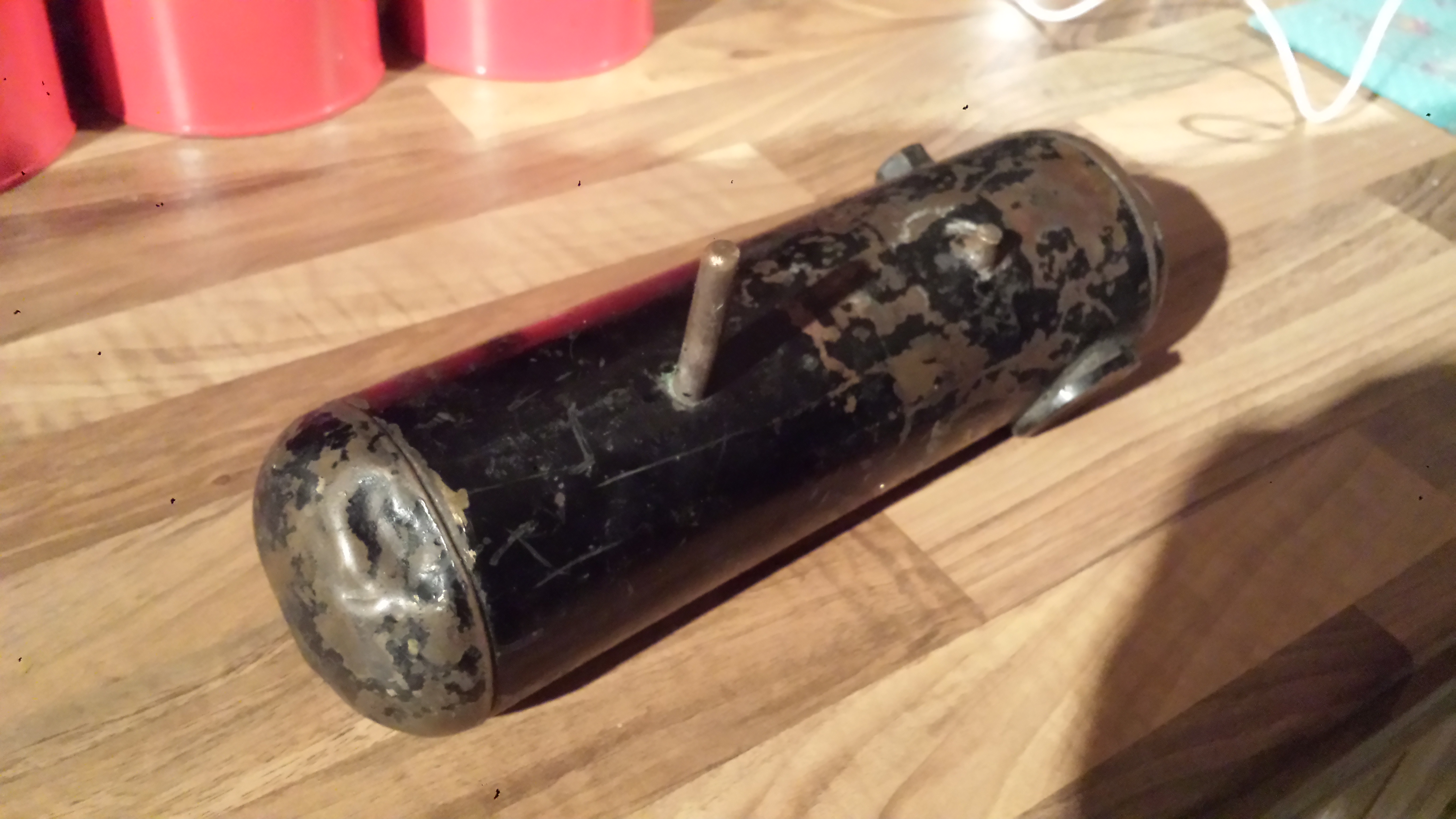

Lookin forward to getting in about this tank tomorrow any suggestions welcome was thinking end cap removal and replacing tank protector might be tricky all one part :lol:

If it is soft soldered on it should be easy.... heat it up and it should fall off.
If it is hard solder then you may have to cut the end off.
Good luck with it, keep the pics comming.

Initially thought of removing end cap and replacing the complete tank protector looks to be to big of a mission now thinking of just adding a small copper tube over the top of the stump any thoughts welcome. .. :lol:

Could you weld the broken part back on?
It is stainless steel right?? Or are they monel?
If you where closer (or want to ship it to New Zealand) I would weld it up for you.

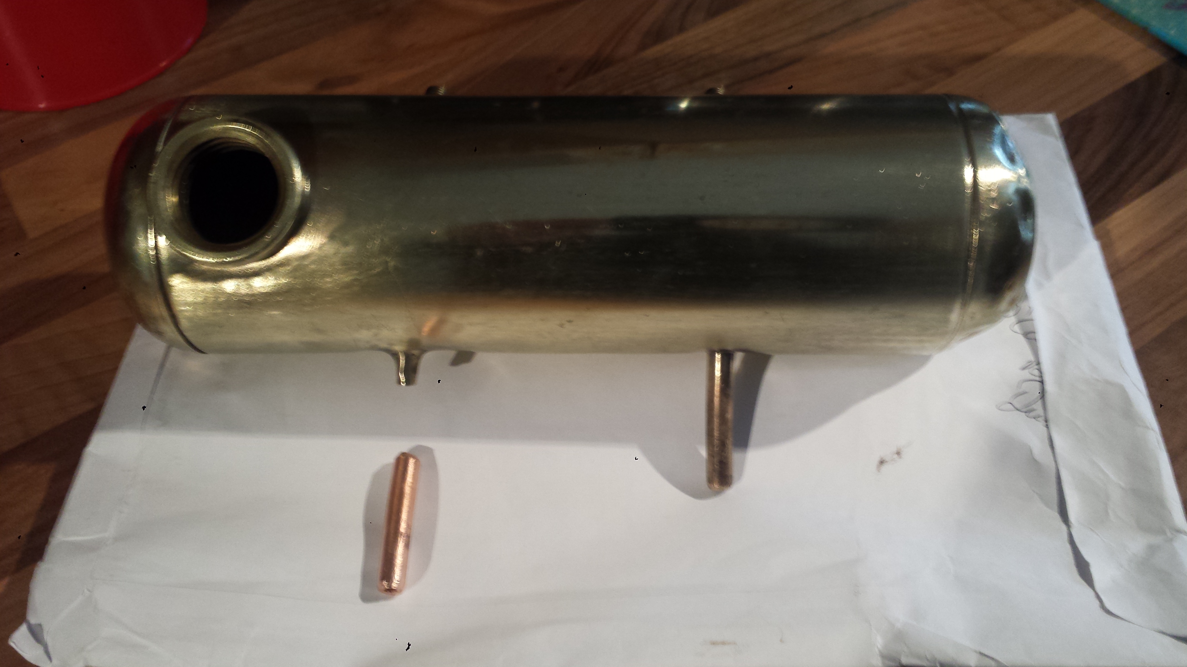

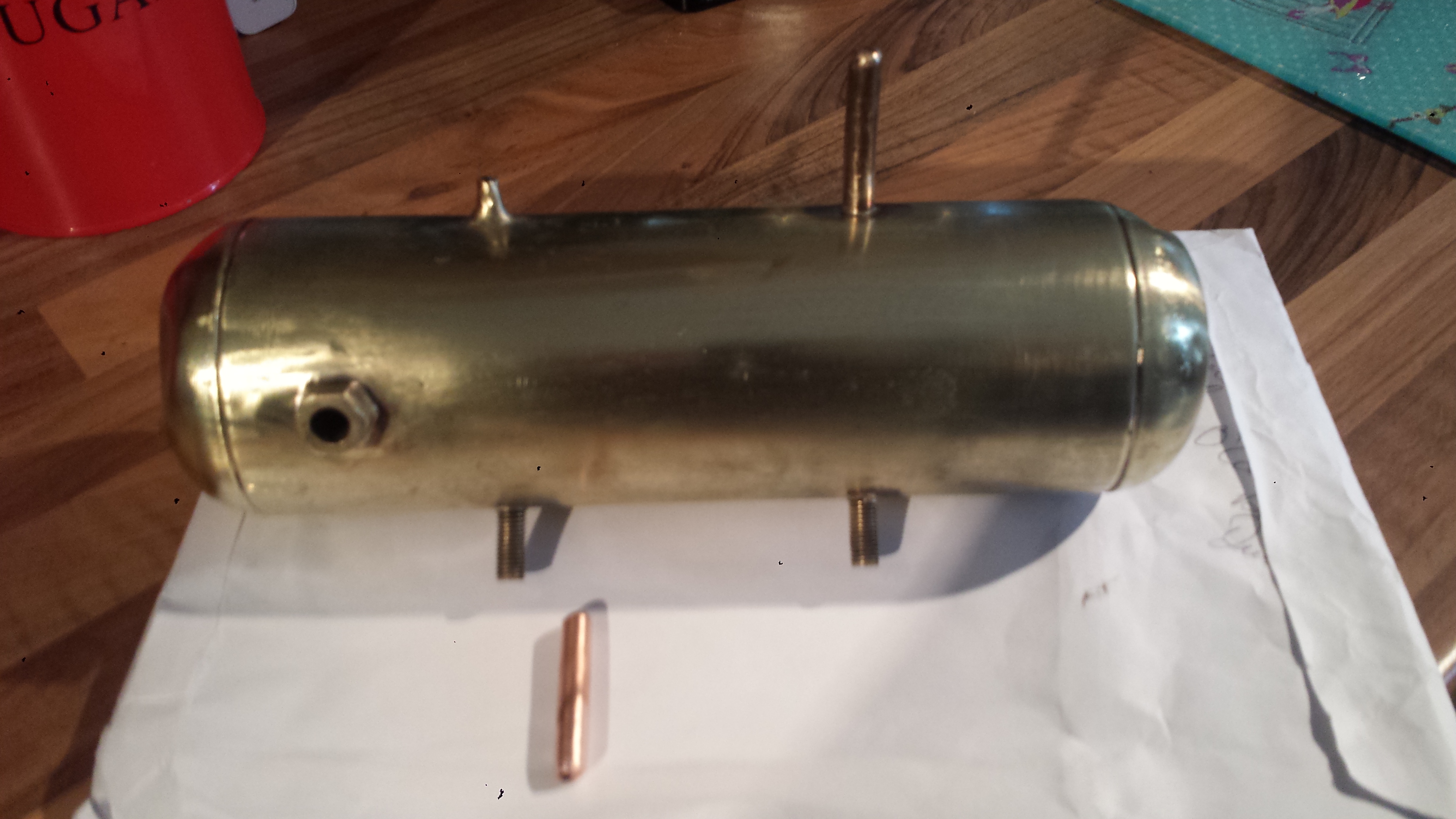

Thanks for the offer china but the tank is brass the headmaster has put me in the right direction ie soldering shall give it a go tomorrow cheers

Are you going to drill and pin a part on it, Or take the tank apart and replace the part?
Re: fvp7089
I'm hoping to fill copper pipe with solder then solder the copper pipe to the stub hopefully. .. :lol:
