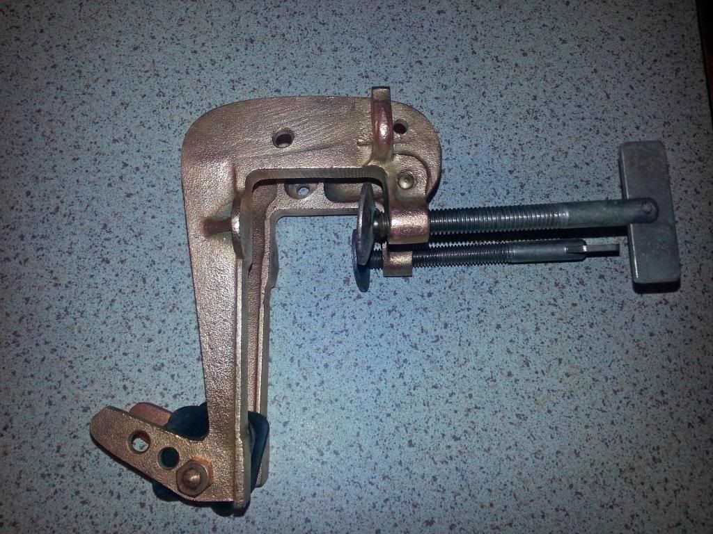

david doyle wrote:When are you going to make that Bronze transom mount nice and shiney!
http://i1177.photobucket.com/albums/x35 ... 193201.jpg
There you go David. I made a start on it. Not sure if I should apply anything after polishing to keep the colour?
The collar and tilt mechanism was in a messy state. I peeled the plastic off and there was lots of alloy oxidation powder and very dirty. Awkward shape to clean too! So I will either try to polish that bit up a bit or paint it black again.
