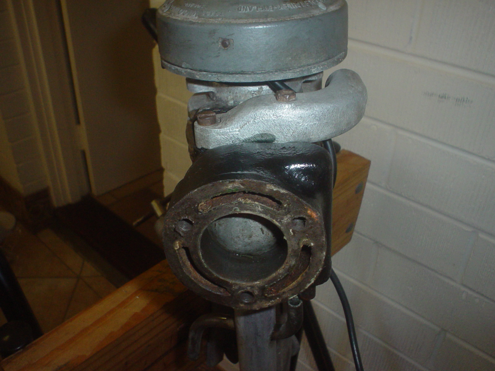

This is what I saw as I took the head off
I didn't need to clean up a thing!! I am guessing that the old guy that gave me the engine (or someone before him) took the engine apart to fix it up and never quite got there.
The hole on the right hand side in the pic will need to be fixed up a bit the other two have been tapped with 1/4" - 20 UNC (I would thought the thread should have been BSW)
You don't have a spare carb in the back corner do you? No! ok I will have to make that too!!!
Pictures tell 1000 words, the more pic's the better!!!!

Just a few things from me - see if the y make sense! On my Minors, which are Mk ll's, the carb. inlet is on the port side of the motor, and is a 'U' shaped casting bolted to the to of the cylinder, and terminating in a vertical position with a flange. A proprietary little Amal carb. is bolted to this flange - this carb was fitted to lawn mowers of the day, but having a bottom entry fuel feed.
Your aluminium part of the carb intake looks original, but just fitted to the wrong side of the cylinder!
The carb has no speed control , - speed being regulated by an advance and retard lever mounted on the magneto stator plate.
The little aluminium saddle bracket on your petrol tank is where a choke lever and cable were fitted, which was routed around the flywheel in a rigid aluminium tube.
