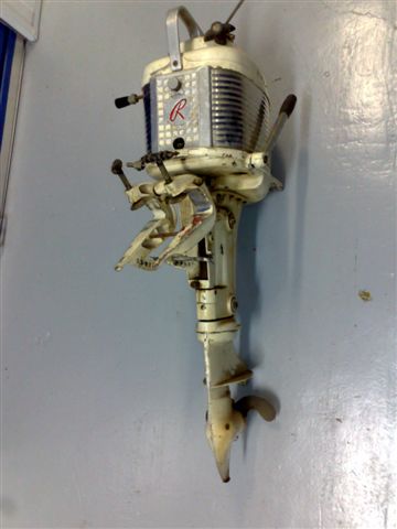

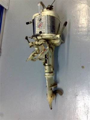

I picked this one up over the weekend after locating it by chance week prior ie during a trip to regional Victoria to pick up a few other outboards.
History behind it is not very clear. All I know at this stage is that it was (possibly) a one owner outboard until it was shipped down from Queensland and stored in a shed on a large rural property ever since.
All original from what I can tell, including the Salmon/Gold paint. External finish is faded, engine and edges of the upper and lower cowl sections reveal the actual color. Lots of rust and corrosion under the paint, and flaking paint in a number of areas indicating salt water use and perhaps a lack of general maintenance. All will need to be redone.
Turns over very nicely and has good compression. Not quite sure about the ignition system and coil/s I have not had a chance to remove the flywheel to inspect and test them as yet.
Gear and throttle levers operate as they should albeit a little on the tight side due to the build up of grease and dirt over the years. Throttle knob is broken. Would have preferred this was not the case but will have two new ones spun up on a friends lathe.
A few holes in the upper and lower cowls (visible in the above pic) drilled by the previous owner, one being for a key operated kill switch, the others unknown. These will need to be welded/filled.
Overall not in too bad shape.
I am real excited about this find and am looking forward to getting stuck in once I clear a few other unfinished projects.

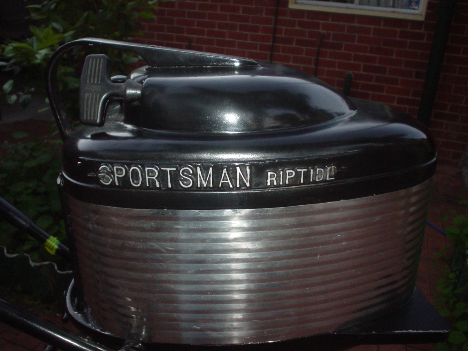

Re: Australian Riptide Sportsman
Thank you Bruce, serial number (somewhat different to what I expected) is 60 8020 and appears exactly as it is written here. What do you make of that?

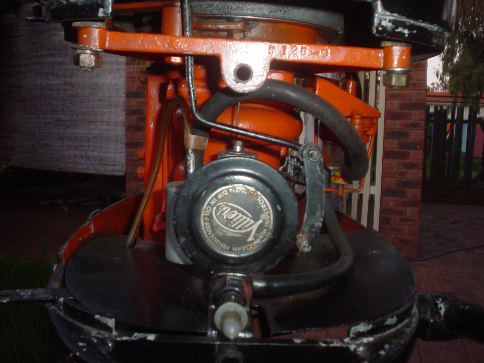

I am putting it back together.
If you post pics as you go........................we can compare. Pics of everything aye. Mine is,as I said, seriously messed with especially the leg internals. Functional but kind of not what a production kit would be like if you know what I mean.
Stroke is the same at 1and 3/4"
Bore I have no idea because head is not coming off. See this pic and compare yours. If bore is different then logically studs are different?

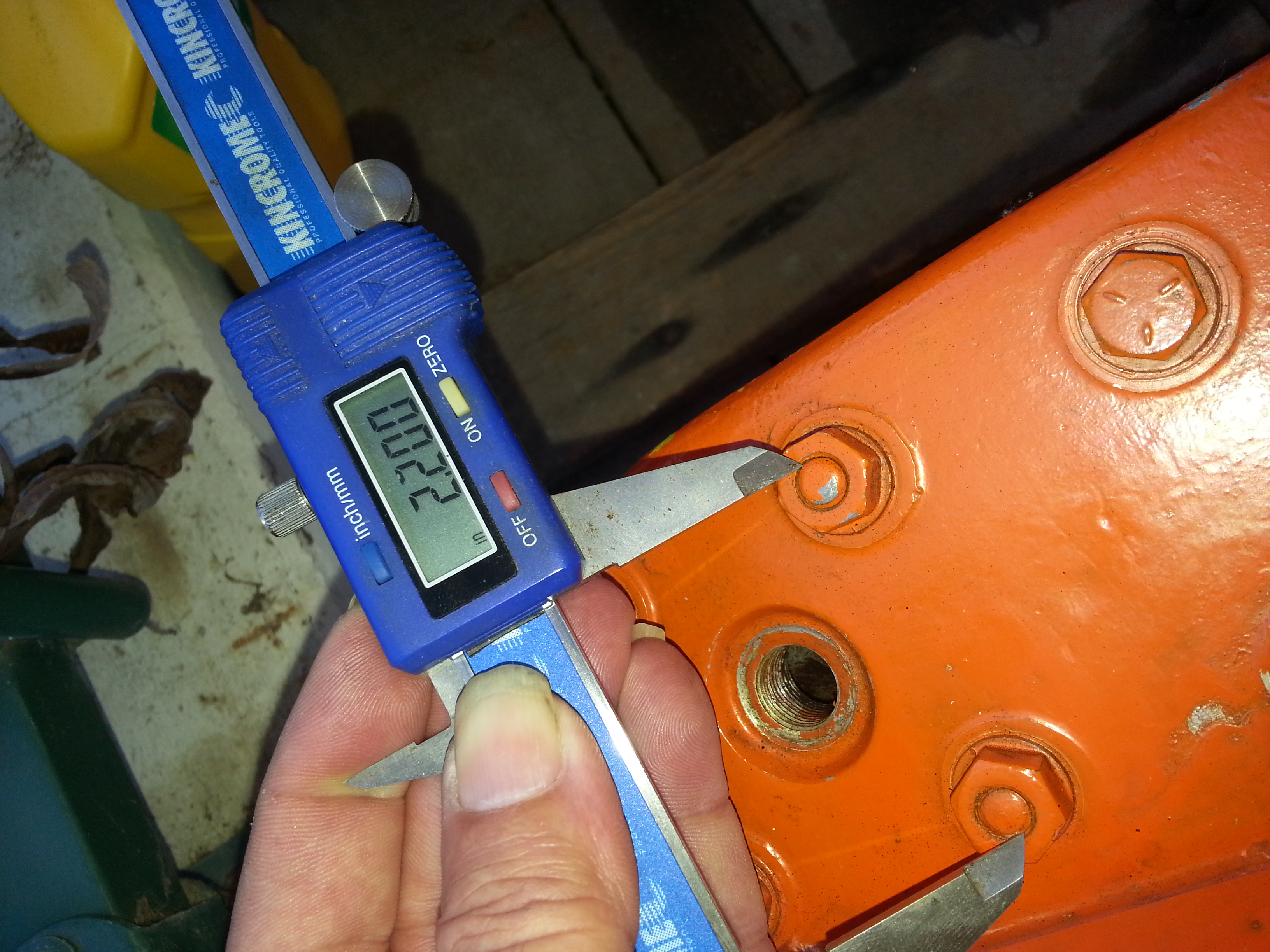

Bore measurement (well not quite but you know what I mean) for comparison against Bruce's 12.5hp riptide.
