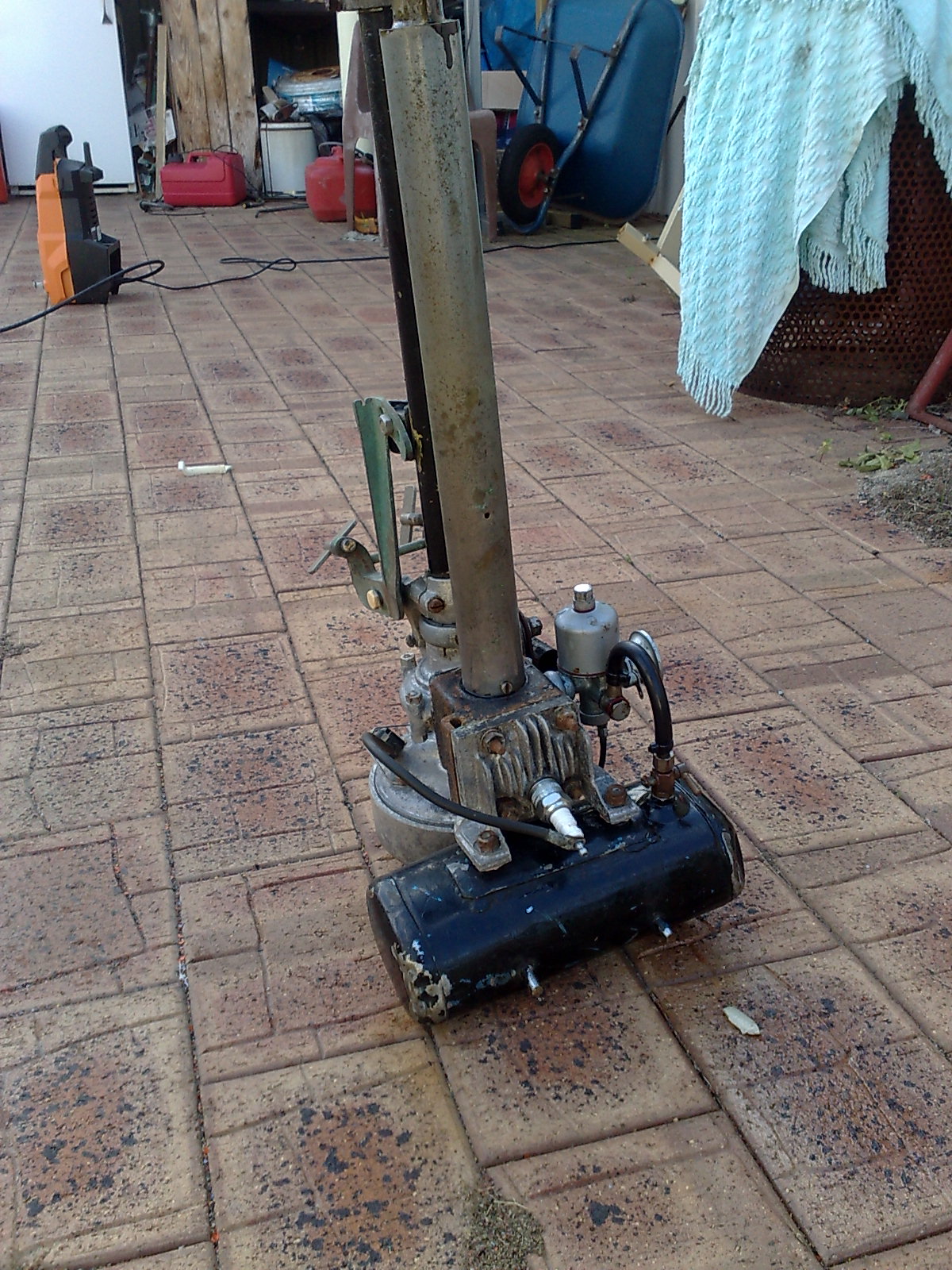

Did a road trip to Katanning in my local 600km round trip kind of place Friday.
http://www.katanning.wa.gov.au/
My Mate and I decided to ignore phones , shut the doors and pissed off to make an extra long weekend. All went well. Long day as we did the tours of small towns etc as well.
Purpose was to pick up both a Johnson JW18R and the LS.
$AU300 the both.......A quick check over and a done deal.
Forget the JW as it is basically a user with a new impellor.

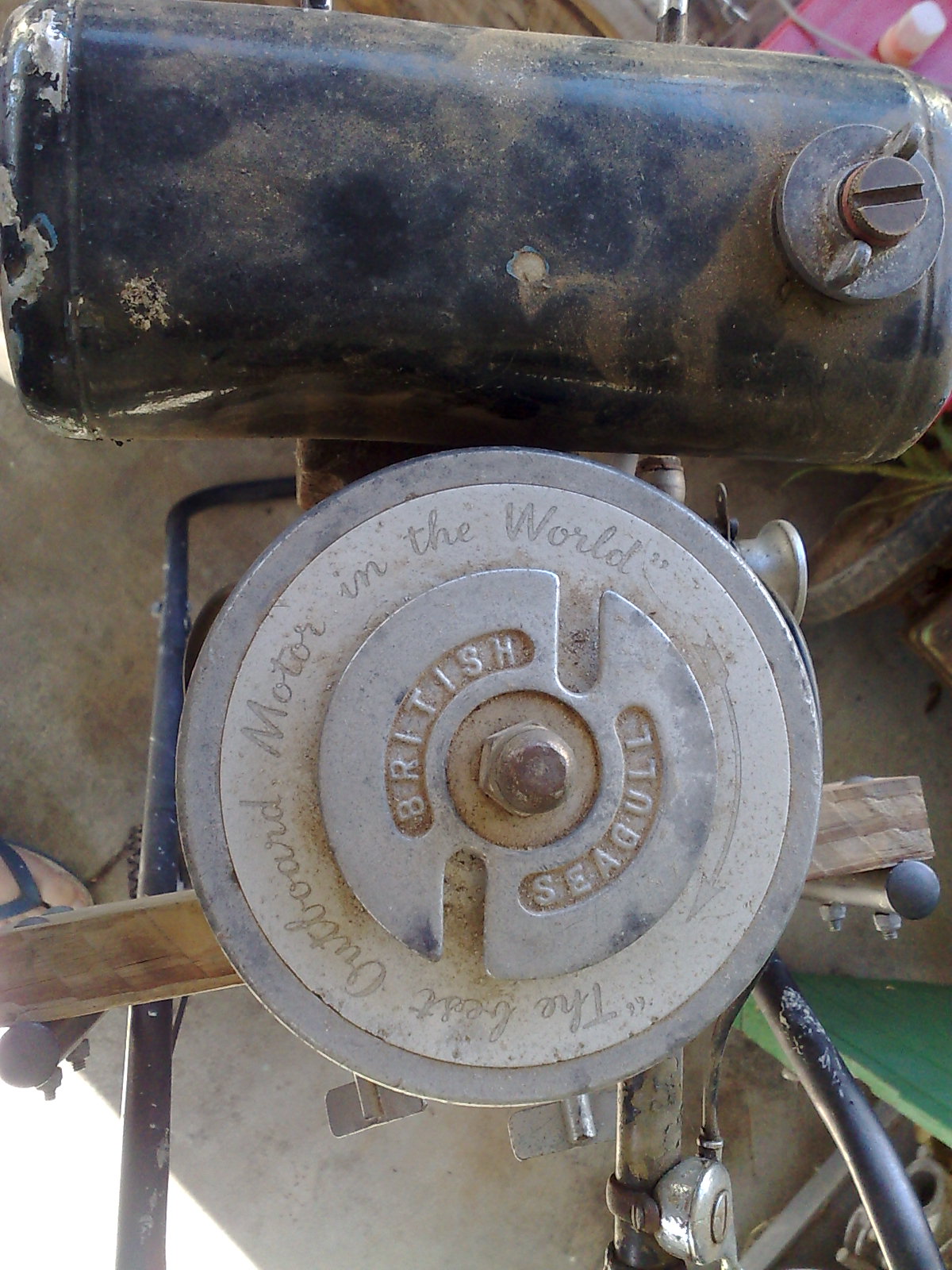

The LS
- Copper Head Gasket
- Steel Base Gasket
- In The World
- 7/16
- 3 holes
- Spark
- Compression
- See Pics for the rest.
Fired up out of tank..................not in tank................turned it upside down for top bearing lube.............OK now.
Running in tank this weekend after a service etc.
Big Smile on the Dial aye!

Bruce,
Thanks for the news on your new acquisition. Looks a good complete usable engine.
I have added the details to the Early Series Forty data sheet.
It appears to have a (damaged) Dover Grip which is in keeping with others of approx this age. It would be interesting to know whether this grip was used on all these early series engines. I suspect it was.
I presume the 7/16 you have stated refers to the carb size and not the tank radius ends? Any further info on the carb - is it like the others around this serial number - ie without a throttle stop, and with a central air hole in the choke shutter and with a drainage hole in the carb bowl?
Is the tiller length 10"?
It is interesting that it has the clamp bolt pump housing (as opposed to the threaded version). This reinforces its probable introduction just before Adrian Dale's LS24747 which also has the CBPH. LS24100 is the last on the data sheet with the threaded pump housing.
Sensible (and original?) idea to invert the engine to get oil into the top bearing. A useful idea.

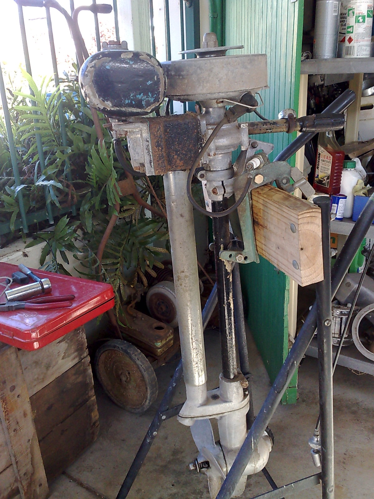

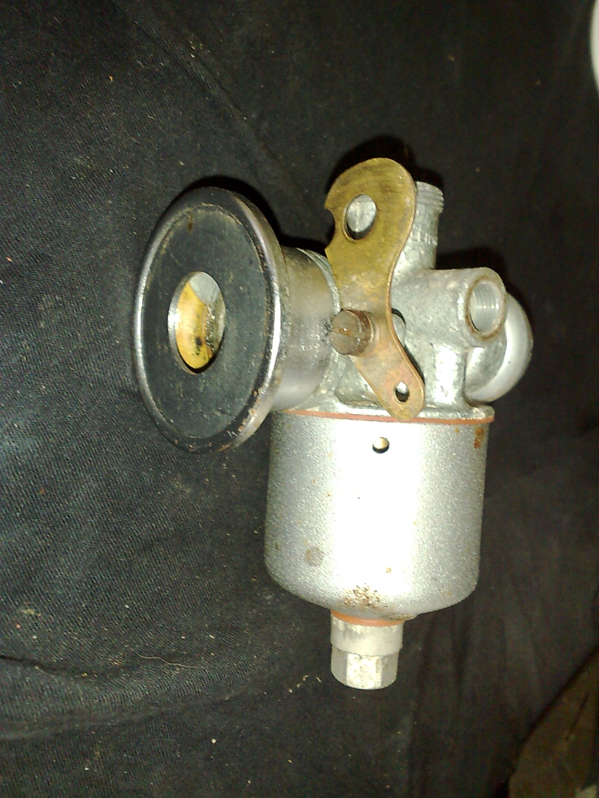

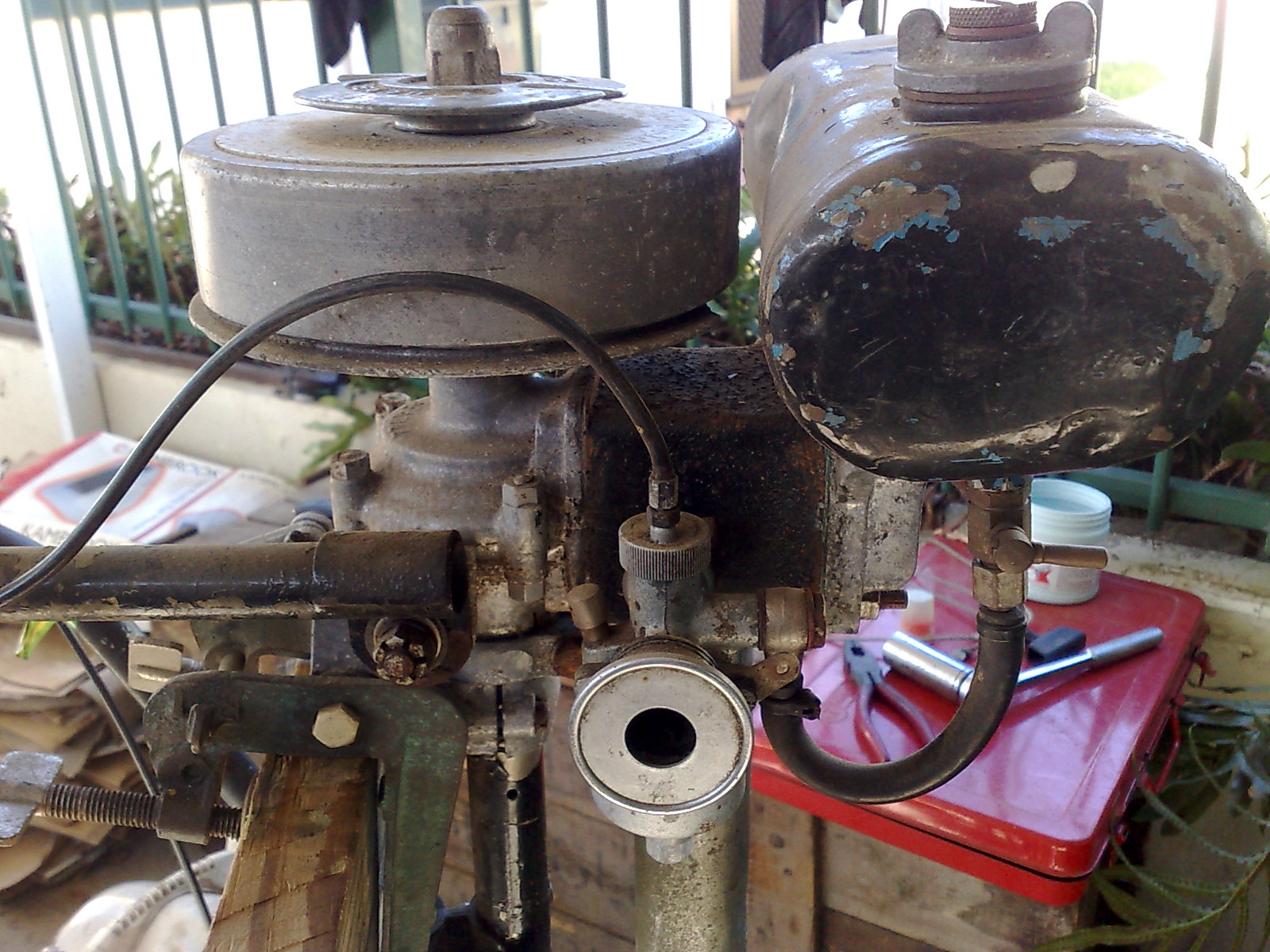

Having a play.....just the basics.

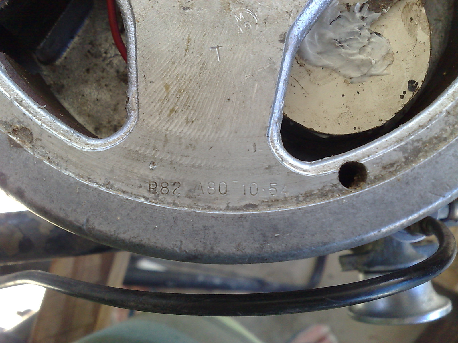

. 10" tiller

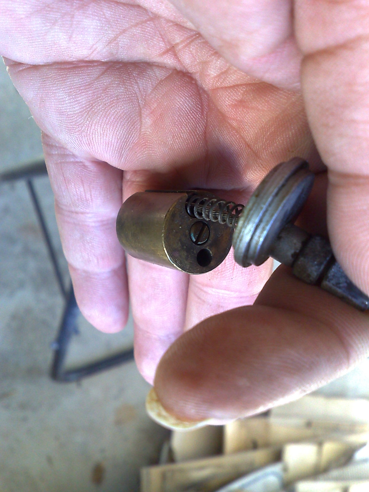

. Carb slide has hole for pin but no pin carb top. (I always thort the pin was a guide........like my FVP......the pin just slips into the hole effectively keeping it square on at over 1/2 throttle) :?:
. Interesting country fix for points. It worked.
. Date flywheel 10th 1954.

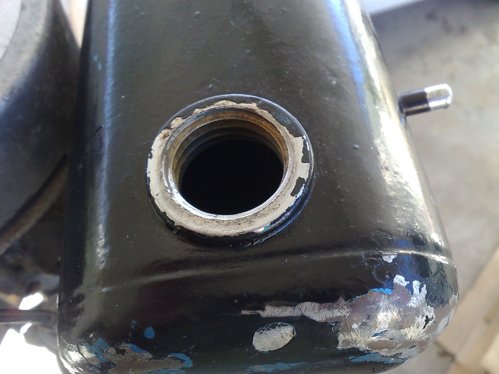

. Tank is smaller by 1/2" or so. (I have forgotten where I read the reason) :?:
. There is a chrome job under the tank paint. 8)
. Hole in fuel bowl and hole in choke.
I will have it running shortly. I will flush the old oil out of gearbox and replace later.
B[/color]

Nice clear photos B and the right way up!!

The carb main jet holder had been played with and was very easy to insert.........with a wobble when seated. That is It then.................find another. It was bin fodder.
Another found and installed (Jet body in Ice Water and carb body in hot water. New Fiber washer and jiggle juggle tap tap OUCH (Yes carb body was HOT) :x .
Nice tight fit when tapped down and locating screw firm.

The carb looks to be a later one, judging by the choke shutter mounted on the Right of the inlet. Also the hole in the shutter is much larger than normal for an LS. These later carbs normally have a 1/2" venturi, whereas the usual size for an LS carb is 7/16". Is it possible that this might be the cause of excessive blowback?
The throttle stop is a small (about 1/8" long) peg positioned about 90 deg around from the much longer anti rotation peg. I think these later 1/2" carbs were not fitted with one. From the data it would appear that the latter/most(?) LS did not have a throttle stop.
10" tiller sound right. Did I see an Amal throttle lever on the tiller?
Flywheel date of October 1954 fits in nicely as LS27084 was the last produced in 1954 and so I expect 26125 was produced at BS in Nov/Dec 1954.

The carb is a MKII stamped on bowl. Maybe I have mis-represented it..................I have not seen the FVP one for years and the box of bits is buried still.

I think all the carb bowls that I have are stamped Mk11. I have no idea what a Mk1 or Mk111 is, or indeed whether there were any.
