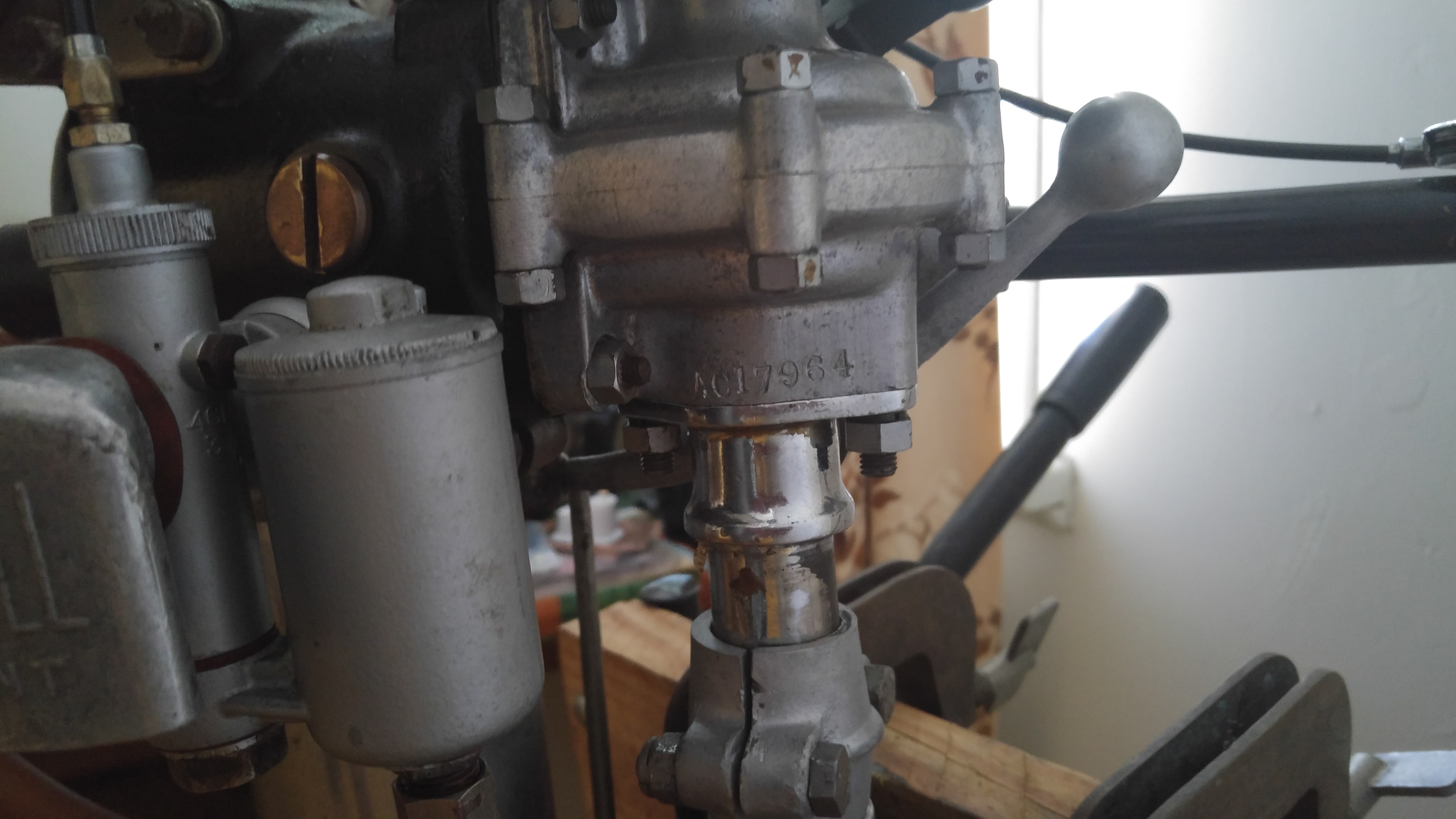

1 nipple in the gearbox seems to tie in with others on record so far.
Tiller grip is wrong, probably the "dover" type is what you need (although data is a bit sketchy at the moment on this)
As for a nipple in the sub ejector pump housing, i've yet to see one? More common in straight out back types as for SD's/P's and most of the very early pre A series motors (D,C,HC) as well as all the A series motors up to approx. a 9000 (ish) number.Then we see the arrival of the "sub ejector". After this period things change a bit. Some boxes with just 2 nipples (none in the pump housing) and later just 1 nipple (as is yours) after that NO nipples at all. Data is still quite scarce for this time period but slowly getting there.

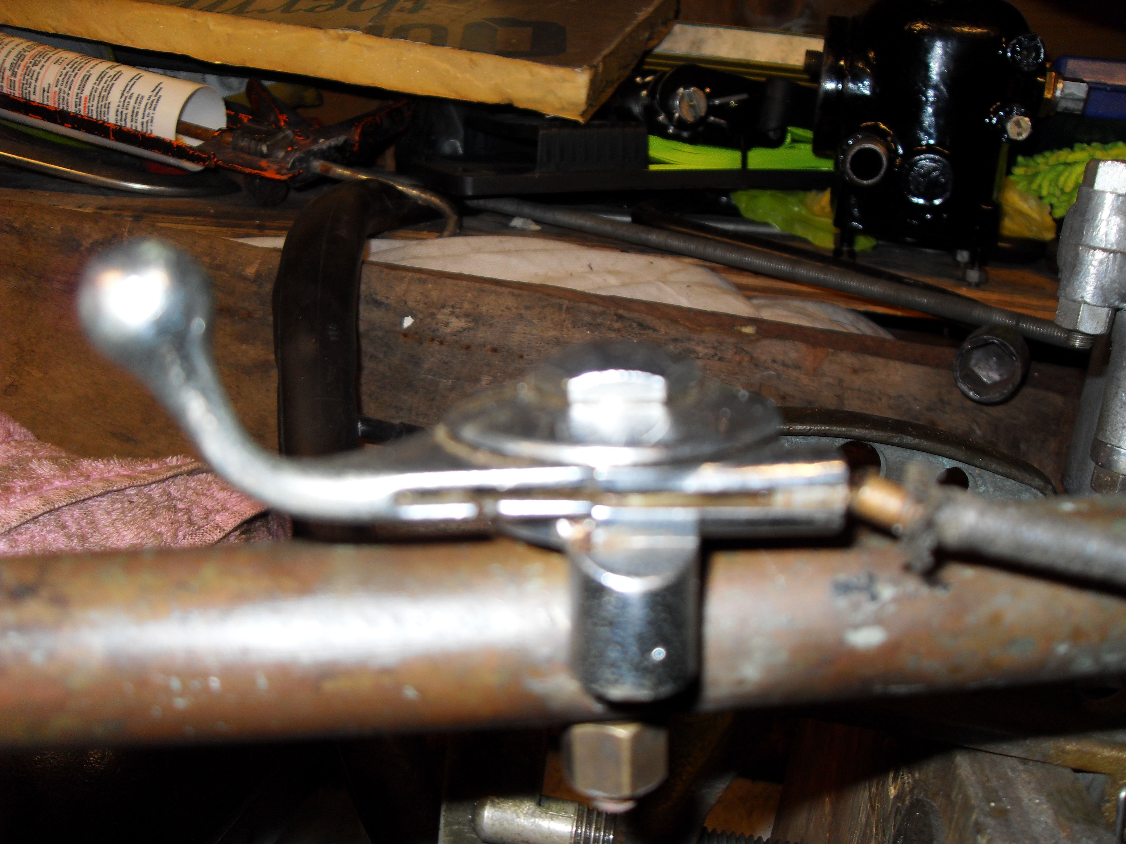

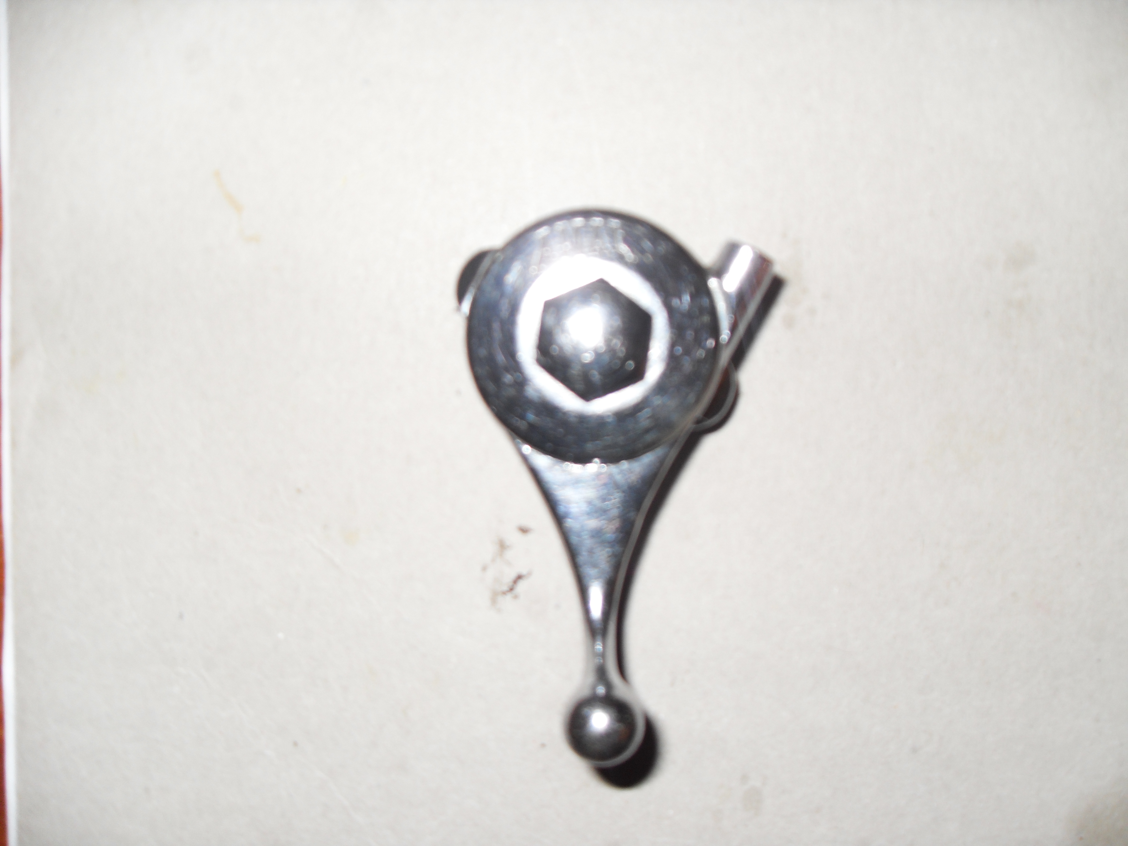

Throttle lever is wrong (should really be a turned up lever with "AMAL" stamped into the top cover) and not the later more common type currently fitted.
Some better pics of the thrust block and transom mounting and tilt hook with stay rod would be good too if you can manage it. :P

Take a quick peek at the pics below for a throttle lever :P
sorry about the glare!
quite distinctive these earlier levers.

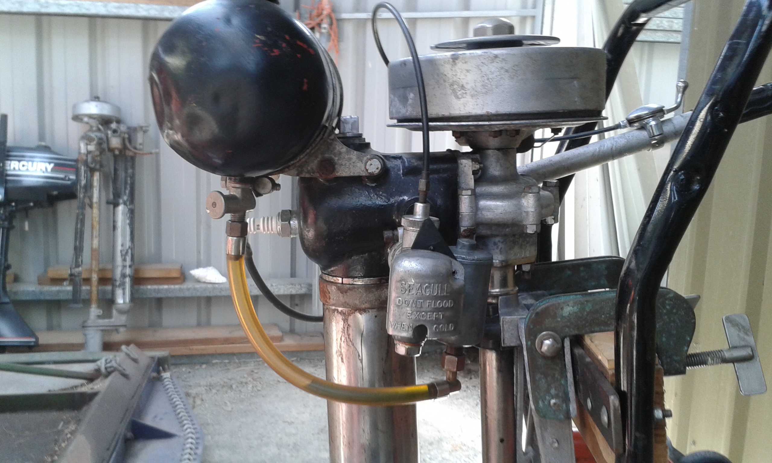

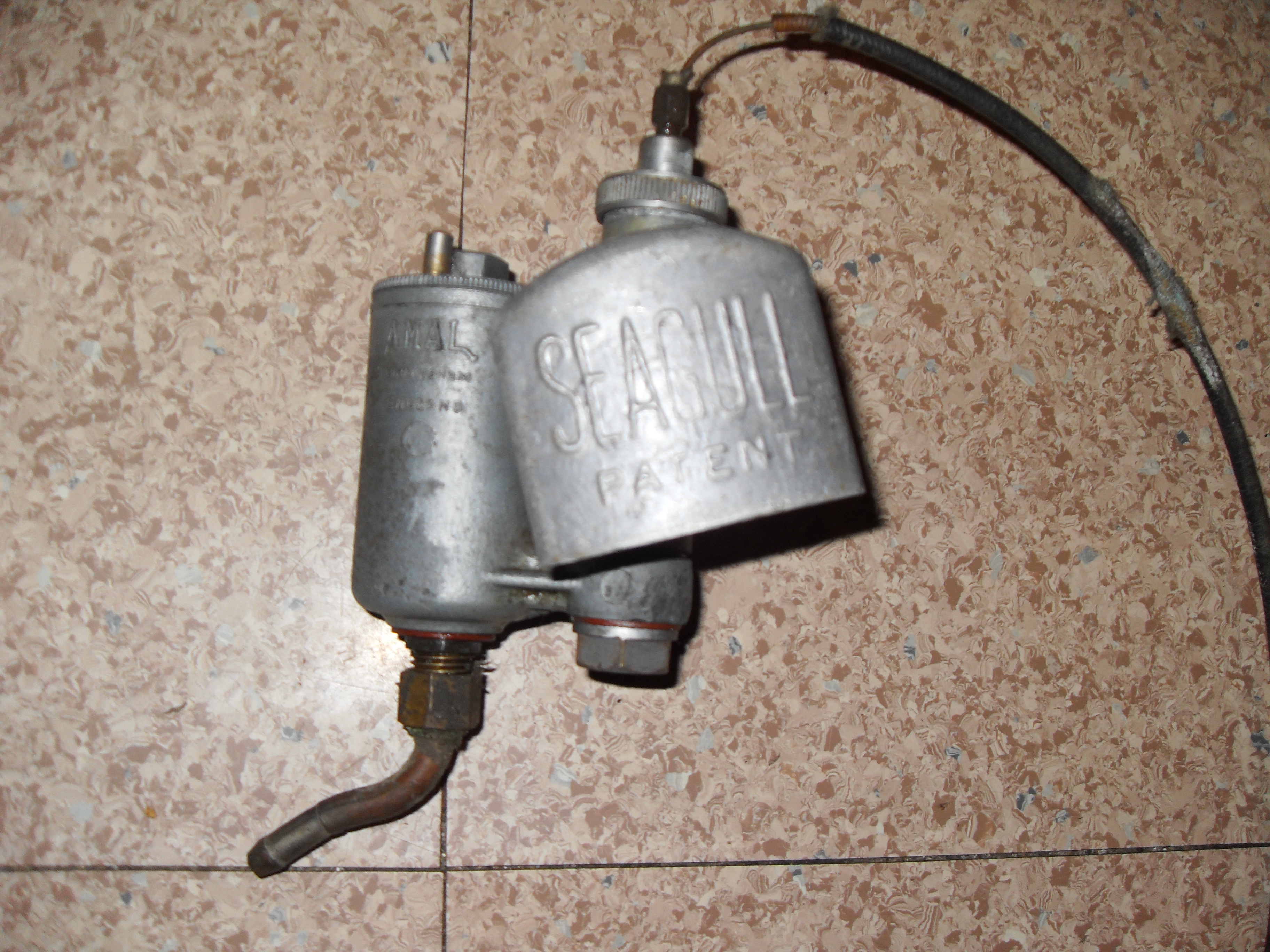

I would love a better close up pic of the fuel pipe though. It might actually be correct although difficult to tell yet. I know of 2 types in this style so far. Black pipe with metal fittings (as is yours) and a clear pipe (occasionally reinforced clear pipe similar to garden hose) with metal fittings, not to be confused with the slightly later clear pipe with crimped fittings at either end. Data very scarce in this area so anything you can add here will help.
Jon, I say that the fuel pipe/ possibly float bowl is incorrect as the fuel pipe on this is just a push fit onto the connector on the bottom of the float bowl. I am under the impression those push fit connections came later than the 50's. Look very closely at the last pic and you can clearly see that there is a push-fit connection on the float bowl.
Looking at every pic of 102's on the main SOS website, all the float chambers are to the right of the carbie, and I can quite easily see that in a 1939 102 ad so I don't think they changed the positioning and then changed it back.
Bruce's 102 (AC) is very close agewise to Spiro's, and it does not have the push fit connection for the fuel pipe. Also, I think a clear fuel pipe with metal fittings would be correct for this?

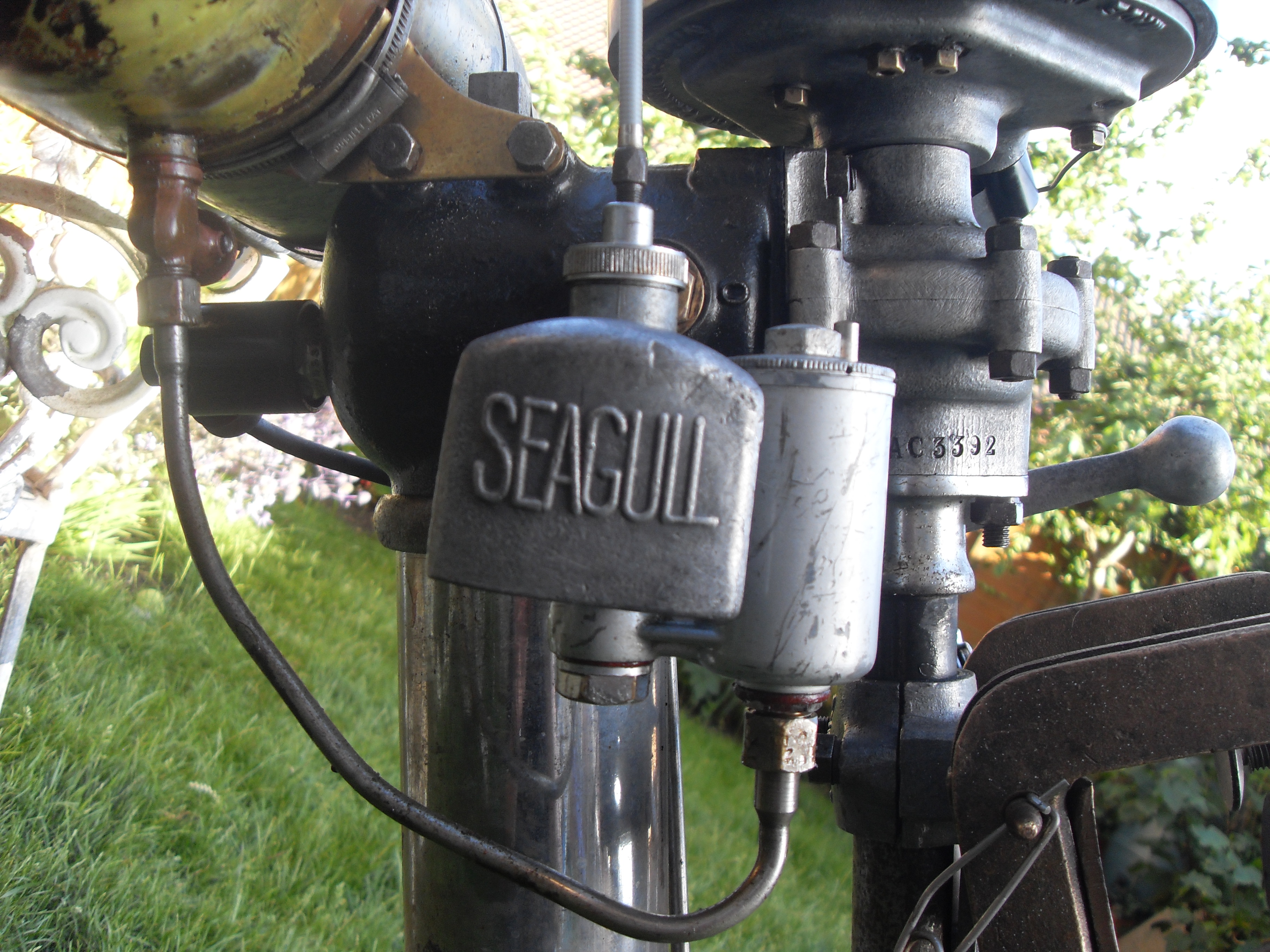

Regarding the fuel bowl...
I found that the bowl clashed with the transom clamp limiting turning to starboard. I placed it to the rear but the fuel pipe when softened under the hot tap was deformed. I found a height collar and raised the motor enough so that the bowl cleared the bracket turning as above. The fuel line resumed the proper shape.
All others I have seen with the bowl forward without a collar will hit the clamp. I rotate the bowl if in use......with no height adjuster.....
This could indicate that a rear set bowl requires a different length fuel line?
Or the bowl end fitting on this line is incorrect?
Interesting.

Re: AD16381
How do we explain these then?
In my collection so i can look and check at any time.
The remains of possibly zinc plating is still on the pipe (AC3392) which makes me think it could be age correct for what it is.
Then there's the carb in the pics, untouched (seized solid) and as it was removed from AC1106L at the weekend with the remains of what appears to be a half metal-half nylon pipe? (complete with spiders nest in the float bowl) YUK. And what about the bowl position too. Coincidence or original? I'm left scratching my head on this.
Puzzling?
From a data collection point of view, this particular time period is a minefield for me? I never know what's coming up next :roll:
Once the numbers get past a certain point, things seem to calm down. These early(ish) motors appear to have more than 1 build spec. Or at least this is what i'm starting to see.
These are certainly old motors we're dealing with here with an interesting story to tell. As for what goes on in private ownership many years ago is all quite interesting to me and perhaps others too. Detective work all the way with this, and with a little help from you guys we'll get there in the end.
All good, keep 'em coming eh :P

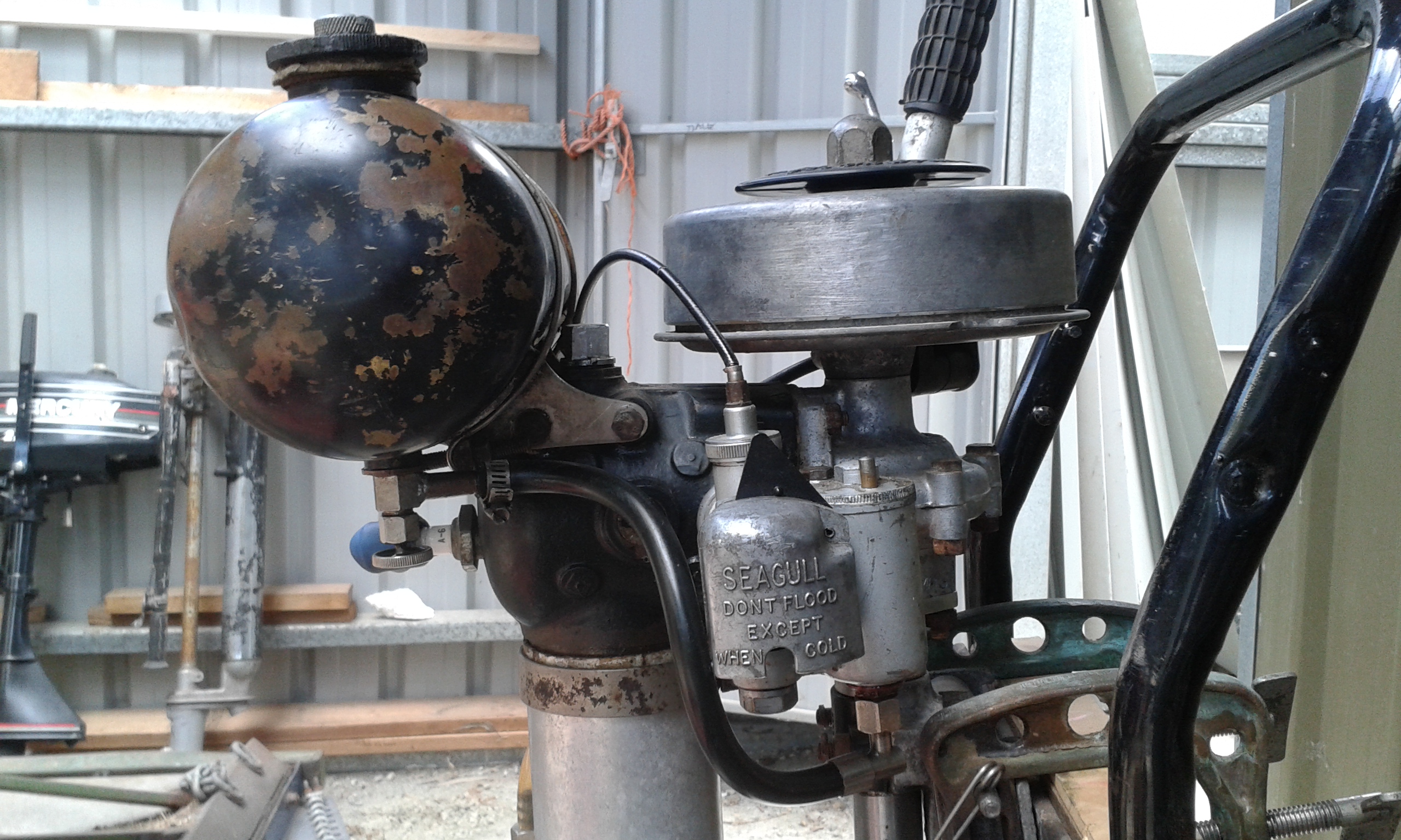

i suspect the cowl has been changed at some point, but what about the bowl position?
bowl on the "normal" side due to the pipe constraints. definitely old that's for sure?

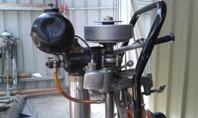

Re: AD16381
The rigid played fuel tube is quite correct on early post war engines, also with the float bowl in the forward position. SD engines had the float bowl in the rear position. No idea when the flexi fuel tube came in, late 40s or there abouts.

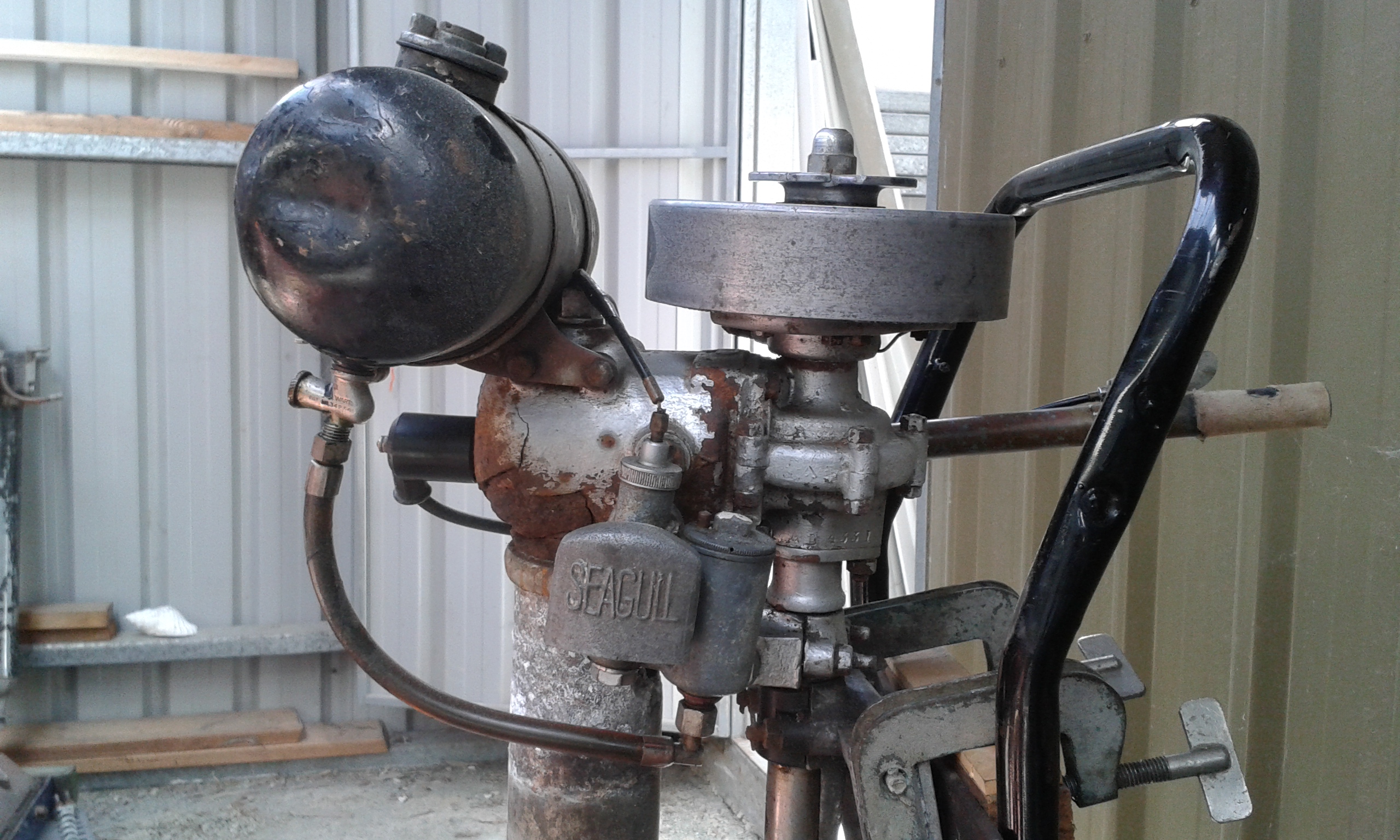

Re: AD16381
Post by Adrian Dale »

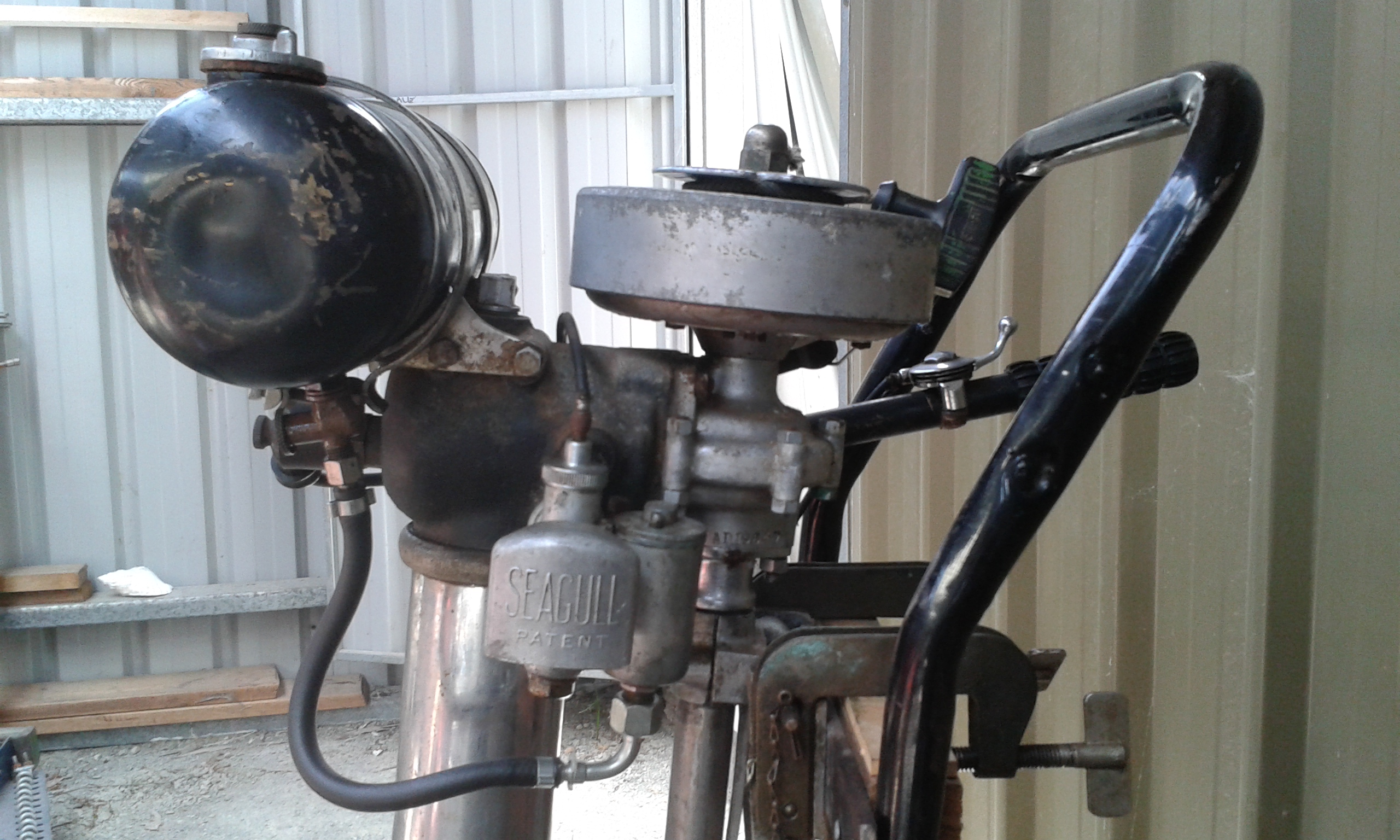

This is AD 4331 cira 1948. This engine has a known history being purchased from Motors of Hobart in 1949 by Julian Christian. Julian Had used the engine regally through to the mid 90's and then intermittently to 1998 when the cylinder failed. Interesting the engine still turns and fires. I have sourced a new cylinder with correct core plugs from the UK, be bringing it back later in the year.
The point of this is that this engine has a flexible fuel pipe and the float is to the crankcase. see pic.
As noted above the two SD's that I have both have the solid fuel pipes (one courtesy of Jon so not original) but the other, which is identical probably is original. Both engines have the float to the cylinder.
Edit: WD837: Incorrect fuel line and fuel tap
AD 19647: Incorrect fuel line. Carb body is from a newer model but correct spec.
There are numerous other details that are inaccurate but one day. All are running although TC139G3 is having a service and Ad 4331 needs a rebuild
