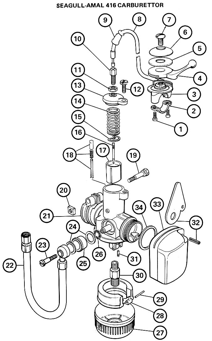

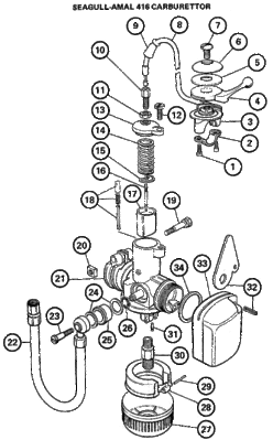

Hello and welcome to the forum!
Could you post a pic of the carburettor your motor currently has fitted?
The WSPC's had either an AMAL 416 carb or an AMAL twin-jet carb I believe.
I have attached pics of both types of carbies below.
Thanks to SOS for the exploded diagram
BP
Amal 2-jet.jpg (9.29 KiB) Viewed 5144 times

Hallo BP
It's the one below. Defiantly
Many thanks for the help
Best regards
Anders, Denmark
British Seagull engine Serial Number: WSPCL1284D1 - Silver Century, Plus Clutch Drive, Ignition: Wipac Mk 2, Carburetor: Amal
Re: Airfilter Seagull Type WSPCL1284D1
No filter

there are no air filters on seagull carbies

No Seagulls ever had an air filter, just covers to prevent them sucking in spray, though some of the later inboards (SD110 & SD160) had the carb inside a cast aluminium "box" to prevent fuel dripping from the carb onto the very hot exhaust header & starting a fire inside the motor cover.
Apparently this was caused, by it happening when a staff member was taking a party of school kids for a joy ride around Holes bay in the inboard demonstrator, don't know what all the fuss was about, as there doesn't seem to be a shortage of kids around here!
An air filter would have made a lot of sense as the UK is famous for it's dust storms over bodies of water!
