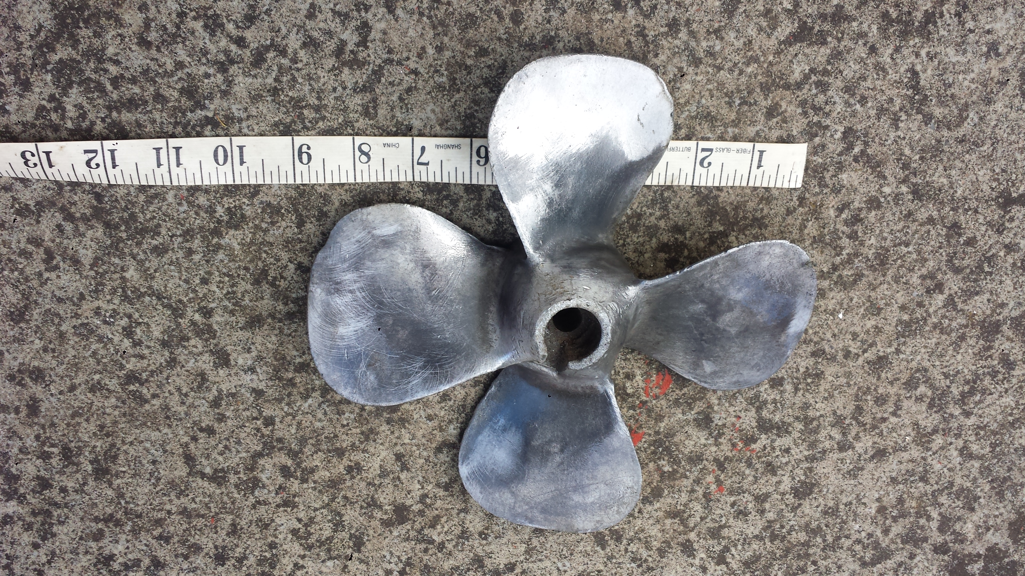

I collected it today and like what I see so far, fuel tank is in great shape with only a couple of small dents, paintwork is well worn, inside the tank loos good but will need cleaning, it still has the fuel filter attached
It's not seized and to me looks complete, only thing I have spotted so far is that it looks like it has the wrong prop. this is from a 40+

Nice honest looking wee motor. ....looks good to me Jeremy will keep you right clover prop and thrust block I'd say ditch the jubilee clamp is it nearly finished yet :lol: :lol: that's 24hrs. .....

Ditch the jubilee clip at the top of the tube (ugly and wrong)
Tam's right, a 4 blade cloverleaf prop is what you need.

:lol: Prop ready for posting Steve you'll be needing a thrust block too. .... get tying

Tam's a nice chappy isn't he sending you a 4 blade cloverleaf prop. That sorts out the lower end for now.
