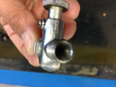

Here is the original fuel tap which does'nt match the fuel line connector.

Out of curiosity, where did you get the fuel tap from? Anyway, you now need to get a correct fuel line also. Then you will
know you have no fuel restrictions. Have you cleaned the tank out also?

Re: 102 doesn't accelerate over half throttle.
I got the fuel tap from Jon of saving old seagull.Oyster 49 wrote:Out of curiosity, where did you get the fuel tap from? Anyway, you now need to get a correct fuel line also. Then you will n
Know you have no fuel restrictions. Have you cleaned the tank out also?
I cleaned also the fuel tank,

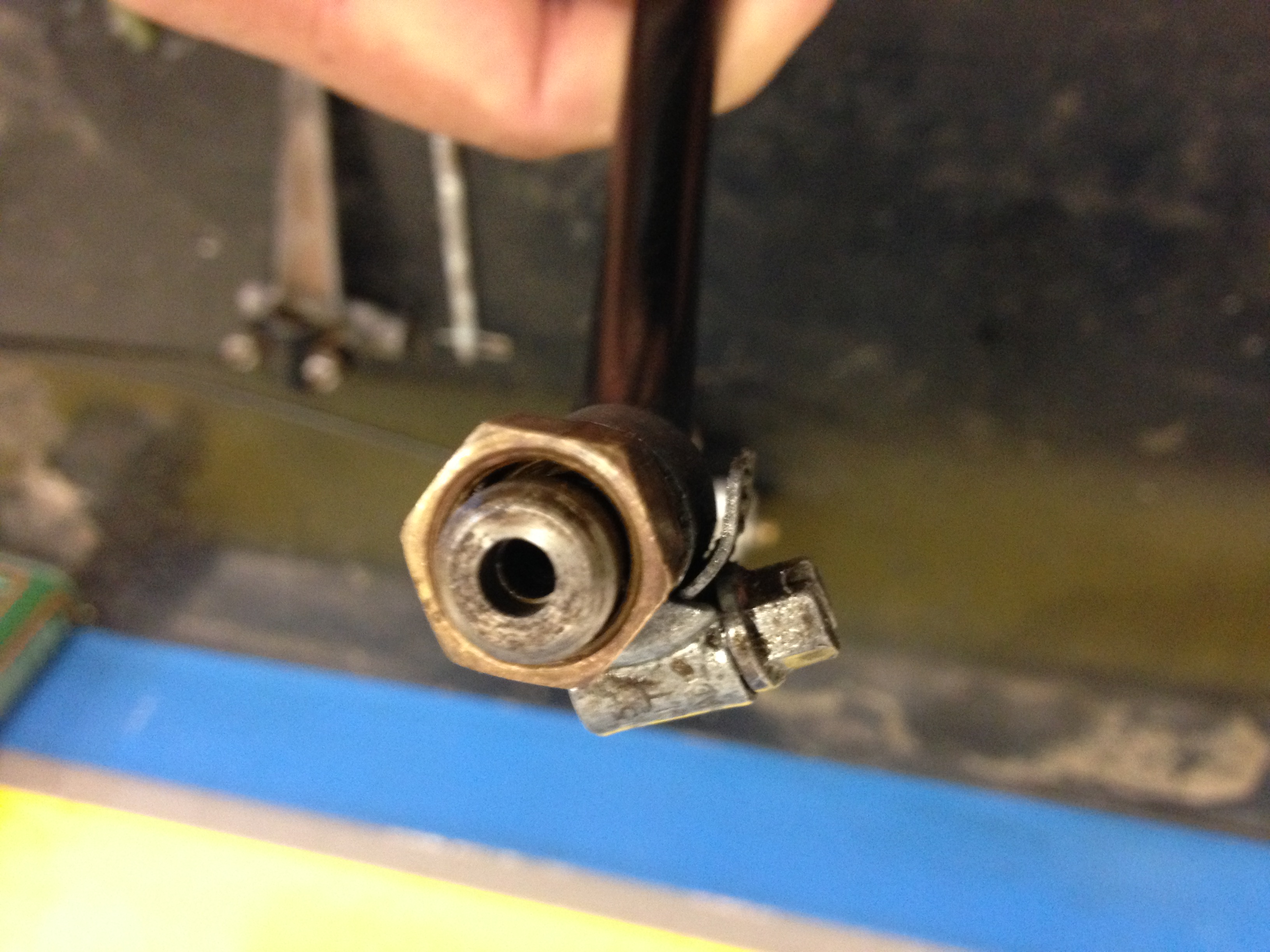

I bought another fuel line which is genuine and new, When I will receive it I hope it will match the fuel tap.

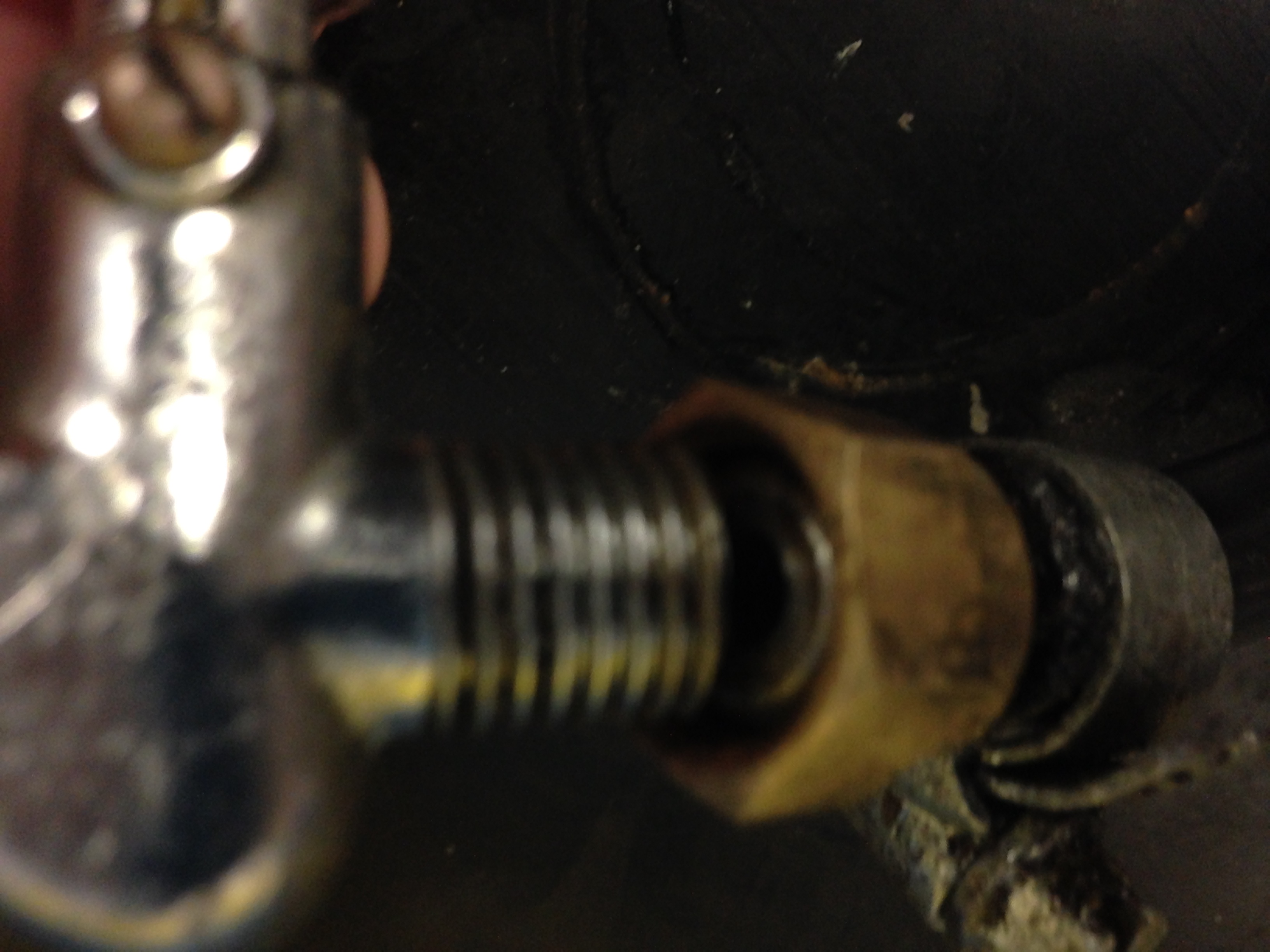

I received a new genuine fuel line, now it matches the fuel tap. The two connector are of different sizes.

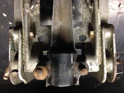

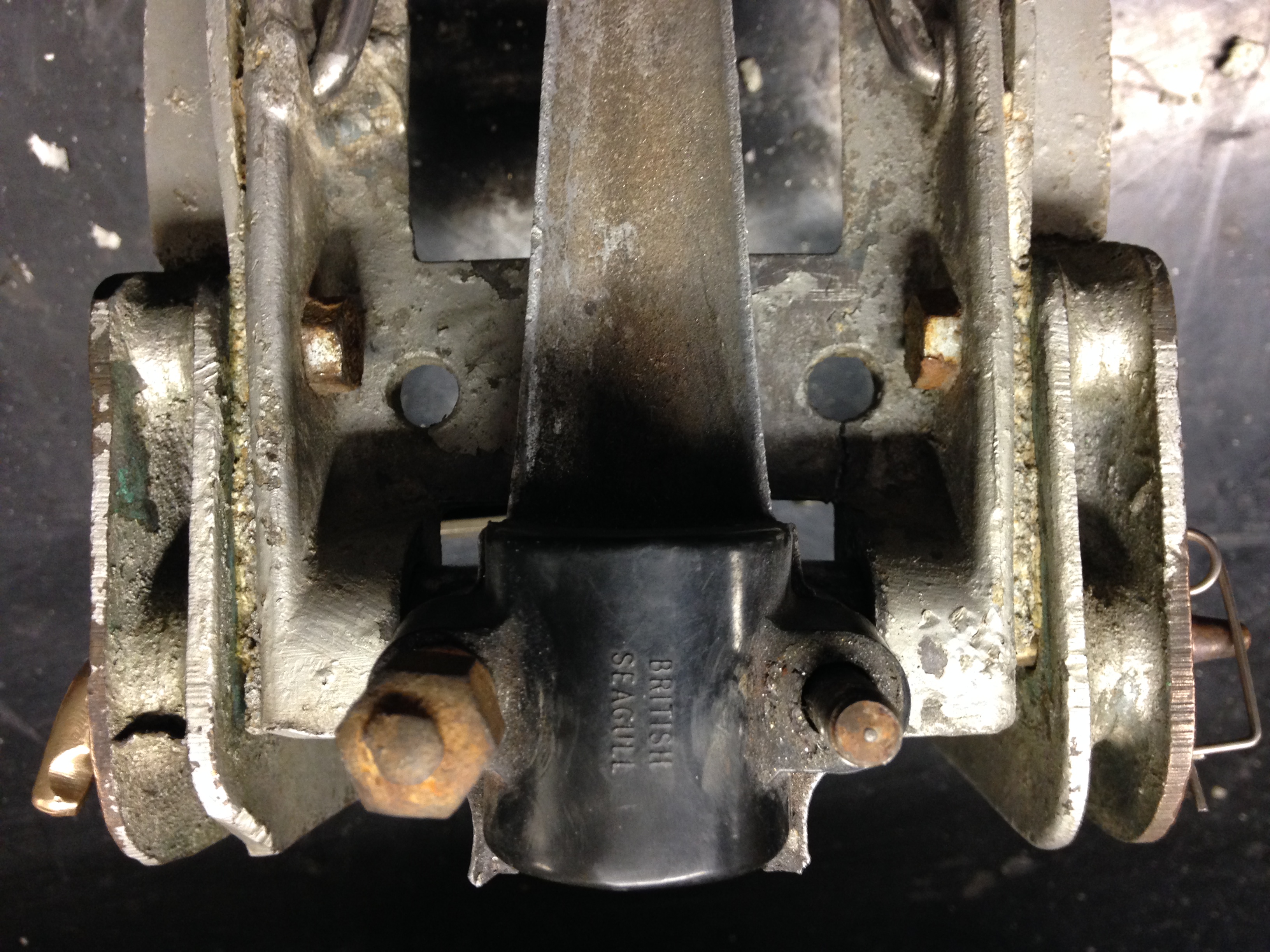

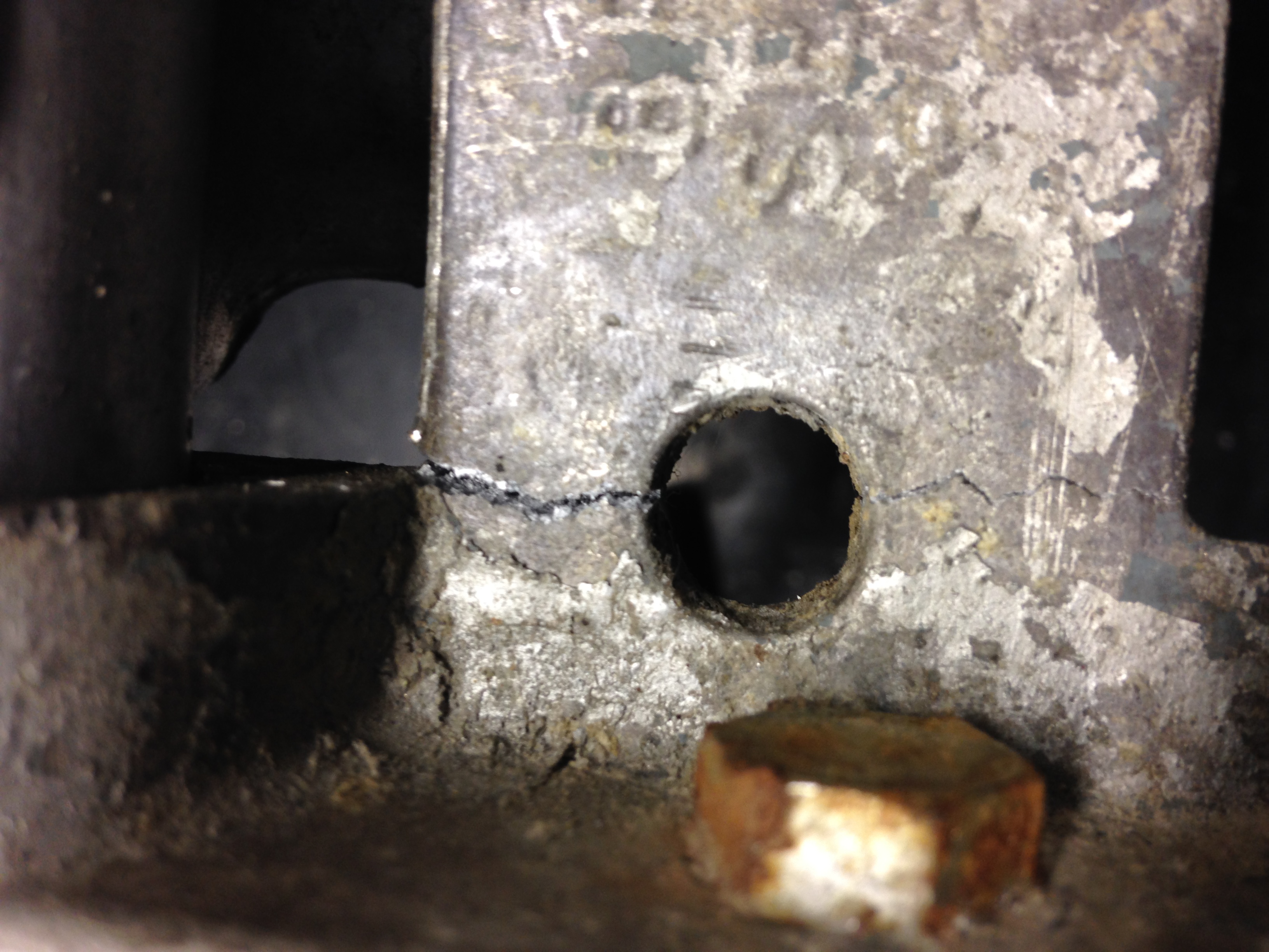

I've also cracked the mounting bracket, should I replace it or I can keep it like it is? In the pics crack seems to stop at the hole, but in reality the crack doesn't stop, it is complete for all bracket.
How the hang did you do that?
If it where me I would find another... or at least get it welded up.
It looks like its been welded before on the support.
If I tell you how I cracked it, you will think I'm stupid, the same I felt when I did it.Nudge wrote:How the hang did you do that?
thank'you for your comprehension, I 'm buying a new bracket.Nudge wrote:OK I wont ask then. we have all had days like that.
