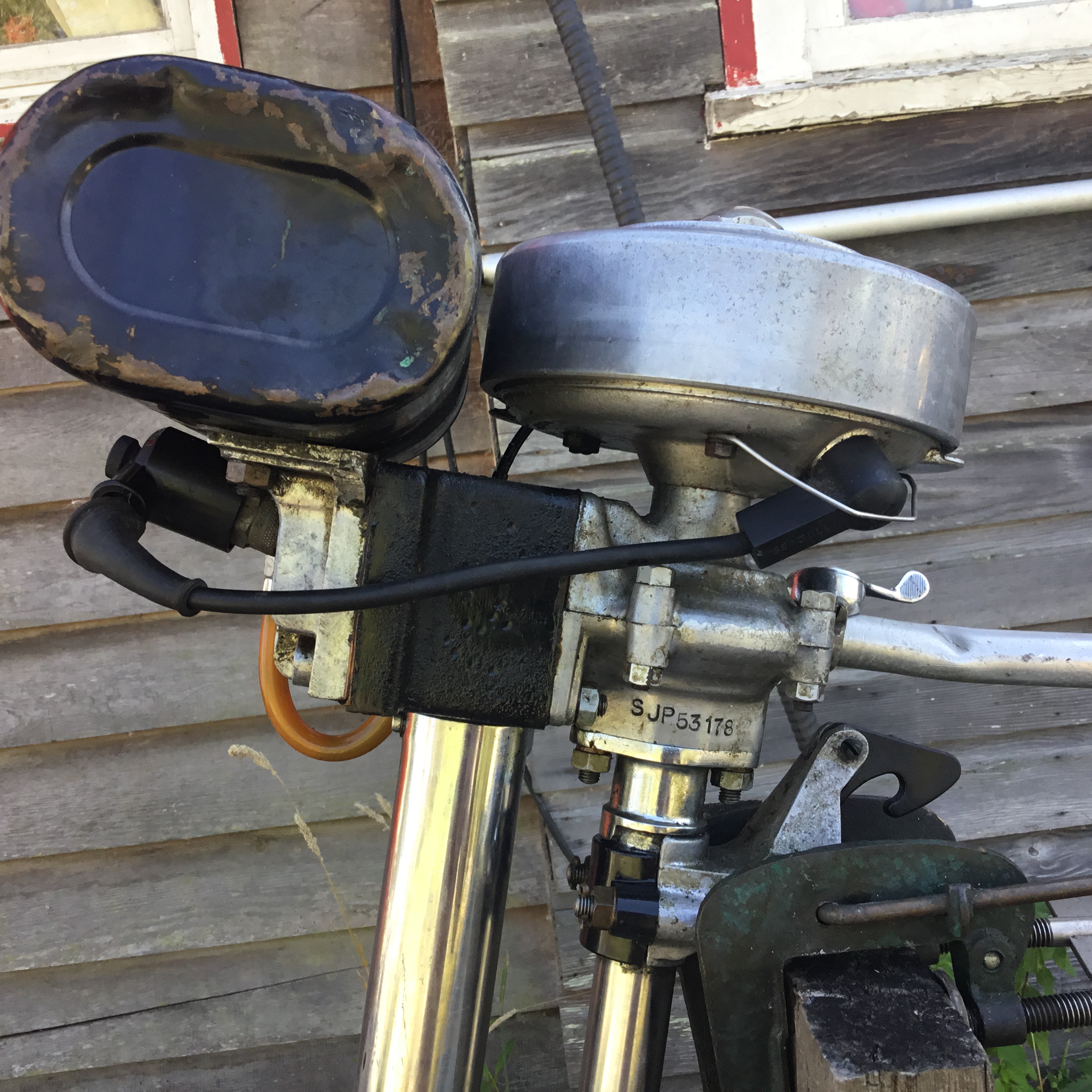

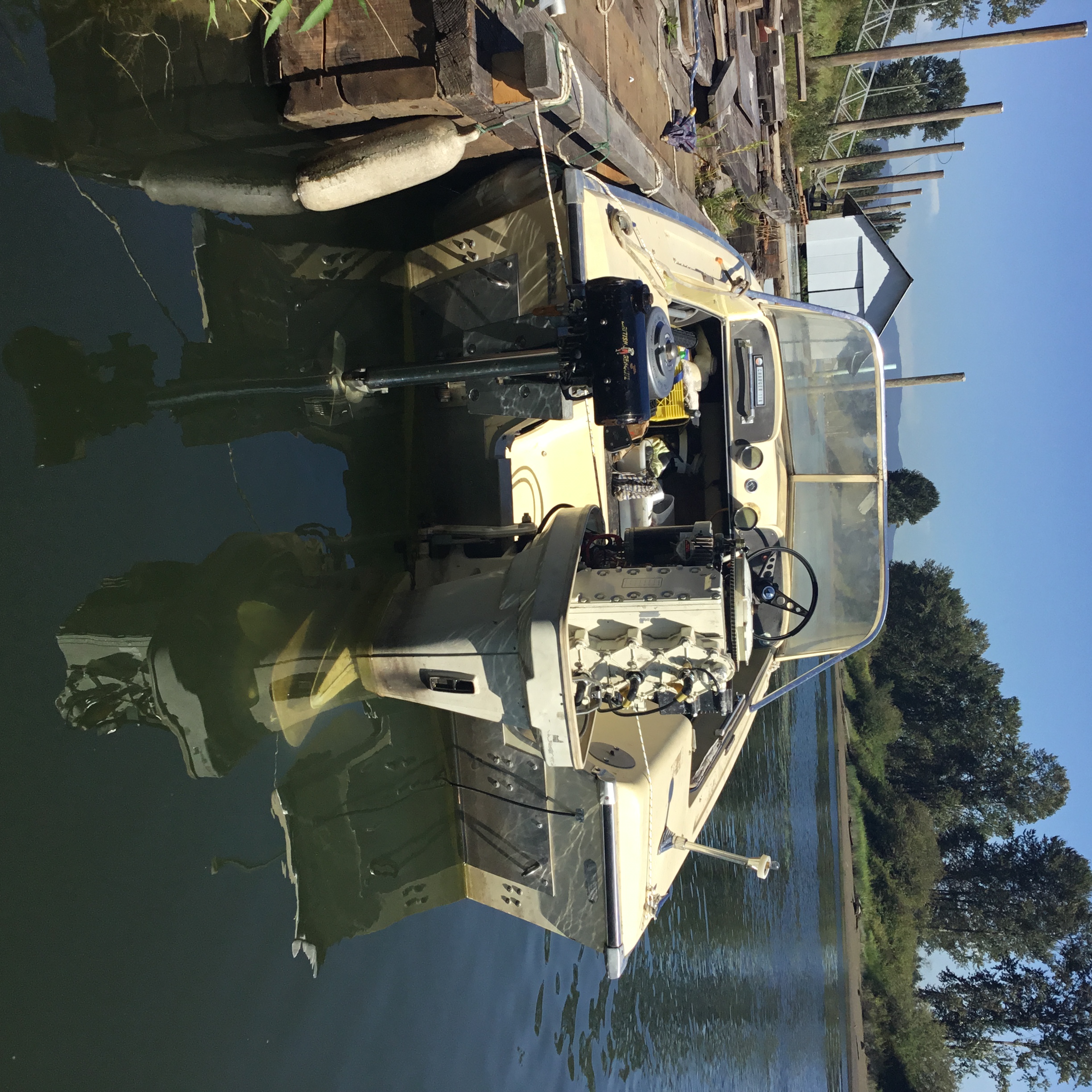

Thanks for further comments. Did not have a chance to look at 40 plus as am trying to get my vintage Chrysler ob going.GGGrrrrr.attached are fotos of 40plus and both motors mounted on 1972 Chrysler Charger.
Determined to leave the dock with one sound motor before summer ends
seagull101
Posts: 405
Location: Scottish islands
Re: 40 plus stops running
Post by seagull101 »
Nice motor!
Interesting tank, normally you see the very early ones with no indentations at all or you see the overly common one with SEAGULL indented in the side!
Or maybe i have just not seen one before.
I'm sure somebody will put me righ!
