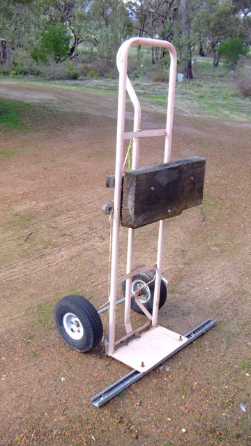

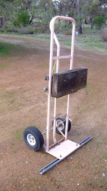

If you go down the purchasing a hand/sack truck route, here is a simple way to adapt it for mounting the outboard without damaging the hand/sack truck. A few scraps of wood and a few bolts and you're good to go.

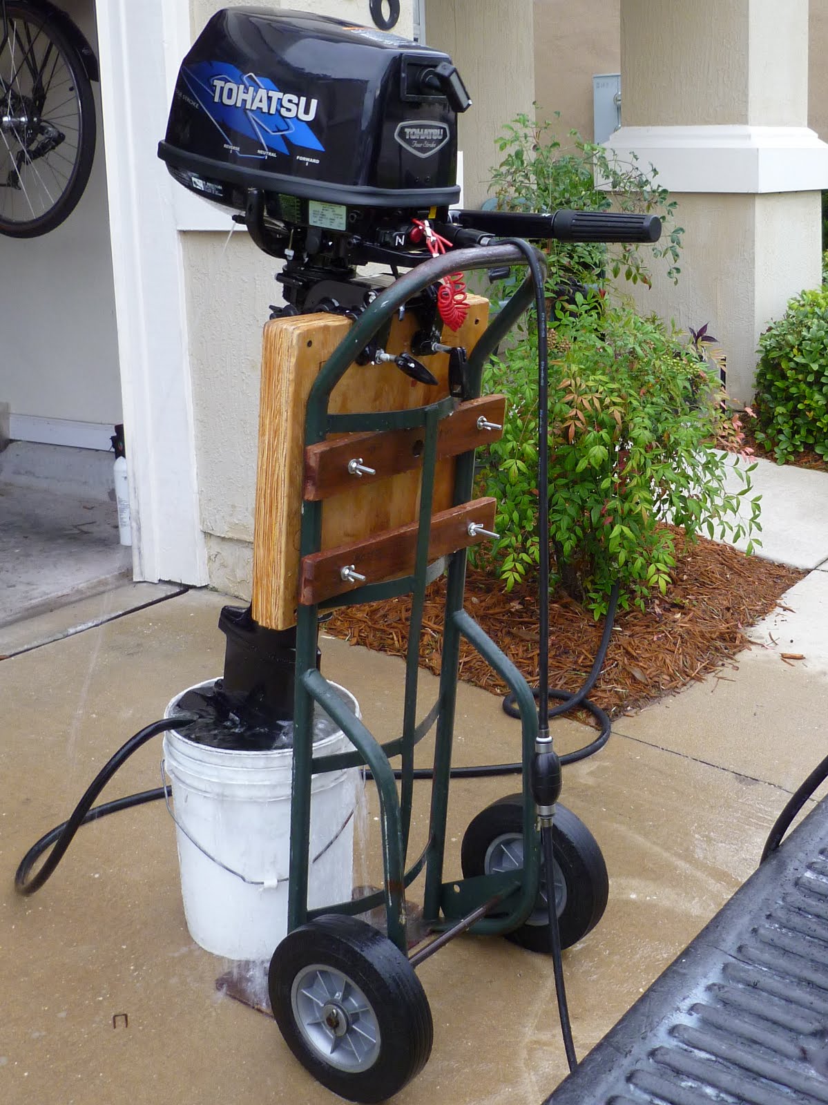

...Or if you want to make it from scratch and you're handy with a welder, this will give you an idea of the basic shape of construction, the mercury in the picture is a lot heavier than any seagull that you'll be putting on it, so it shows you how simple you can keep it.

thanks for your input everyone, i think i'll go with homemade one supplied by Pat, i have some 1" rhs here and i can weld so that's it. thanks again

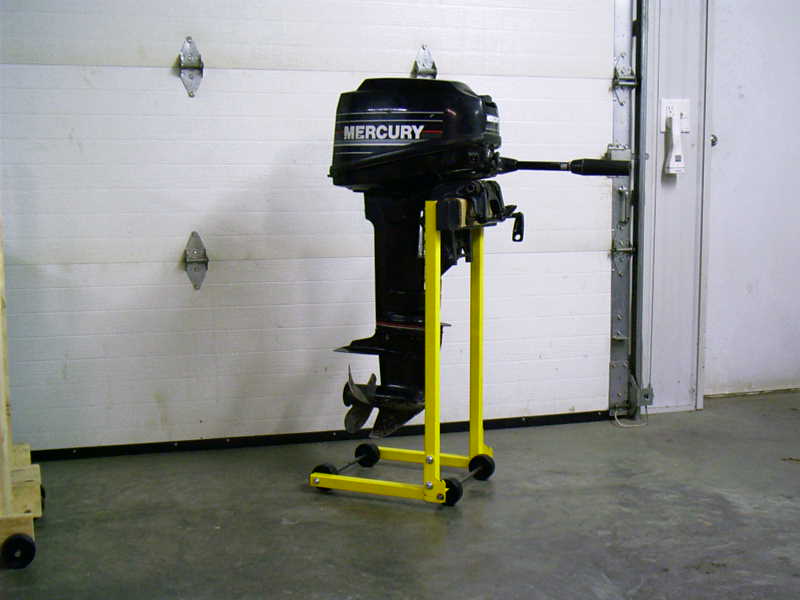

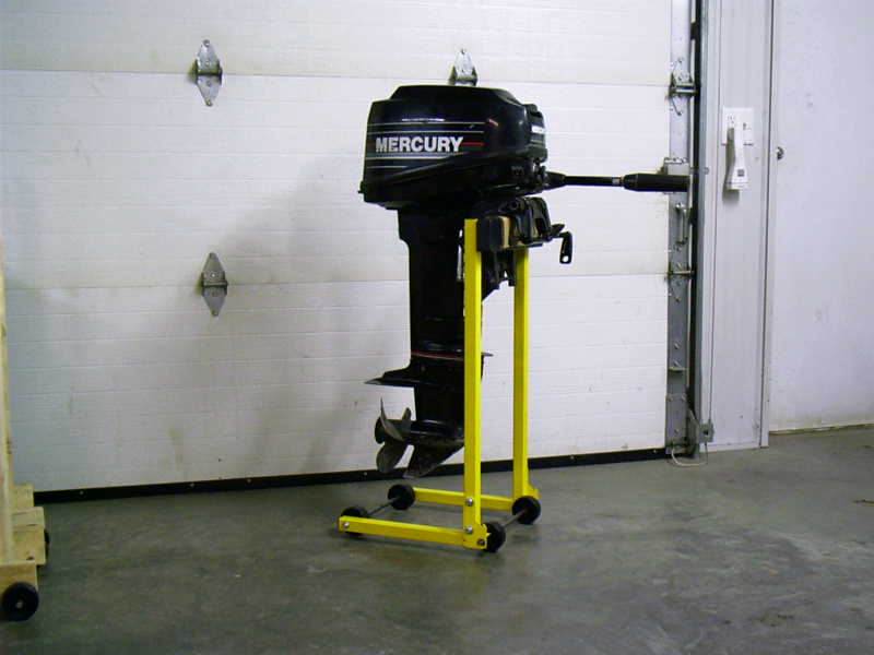

Problem with the yellow one is that it is prone to tipping forward.
If you're making your own, the legs should extend both sides of the uprights ie to centralise the weight of the outboard.

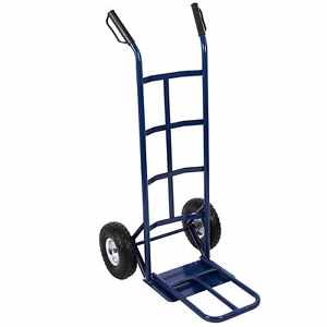

I have one like the yellow stand, its ok, but it has only one set of wheels, tilt and move much better then a full set of wheels.

yep spiro that's what i was thinking, the blue one from keith looks like the go, thanks guys
