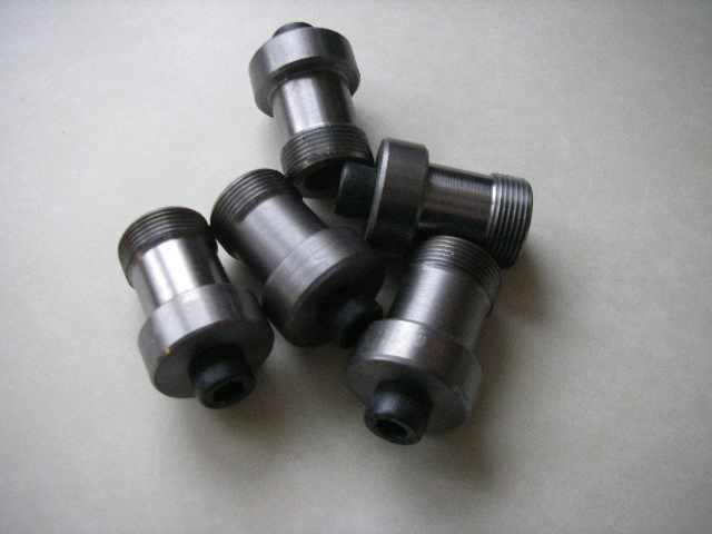

A coolie flywheel puller, is used to remove early flywheels, also seen on early motorcycle ignition flywheels.
A coolie flywheel, the inner ring is threaded.

If you go onto the main site & look on the spare parts for sale pages, a picture of the Marston (coolie hat/JM) flywheel pullers will be found!

Is there any likelihood of those pullers becoming available again?
- Posts: 4955
Re: stuck flywheel
I spoke to him yesterday about this situation.
Provided there is sufficient interest is the answer, John has to buy these in quantity to lower the price, waiting years to break even, doesn't make a lot of economic sense!
Pre-ordering might well speed things up!

Make a flywheel puller by welding different bits and bobs together so that it resembles a typical coolie flywheel puller.

Measure the flywheel thread & let me know where to find some, that would make life a lot easier.

Im sure the thread is on here somewhere. I don't have thread gauges otherwise id measure mine.

It’s a non standard thread, so new ones have be specially made on a lathe. That said of course you can see that these have been knocked up by welding a few bits and bobs together...

Not quite what i was thinking of with pullers, but i know of a few folks out there that have made their own by welding together the correct threaded bolt onto a length of larger od hexagonal tube (ideal for use with adjustable spanners ) into which a conventional right handed thread has been cut and a conventional bolt inserted. Takes about 10 mins to make with minimal hand tools as long as you can get the right bits together. So simple to use with a more "agricultural" look about them. That sort of thing would probably appeal to a lot more folks rather than a fancy and expensive looking bit of kit turned on a lathe.
