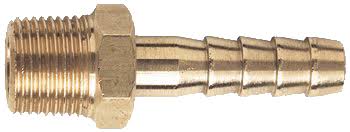

This is a common conversion, makes using an external tank a doddle. H-A uses one of these on his hot century engine. A simple drill and tap to suit the thread on the adaptor, plus you will need to drill a small hole to allow the tank to breathe and vent. Around 030" or something like that.
The other option would be to drill the cap out and epoxy a hose fitting in and push the fuel hose on and secure it with a hose clip.
hose fitting.jpg (7 KiB) Viewed 1620 times

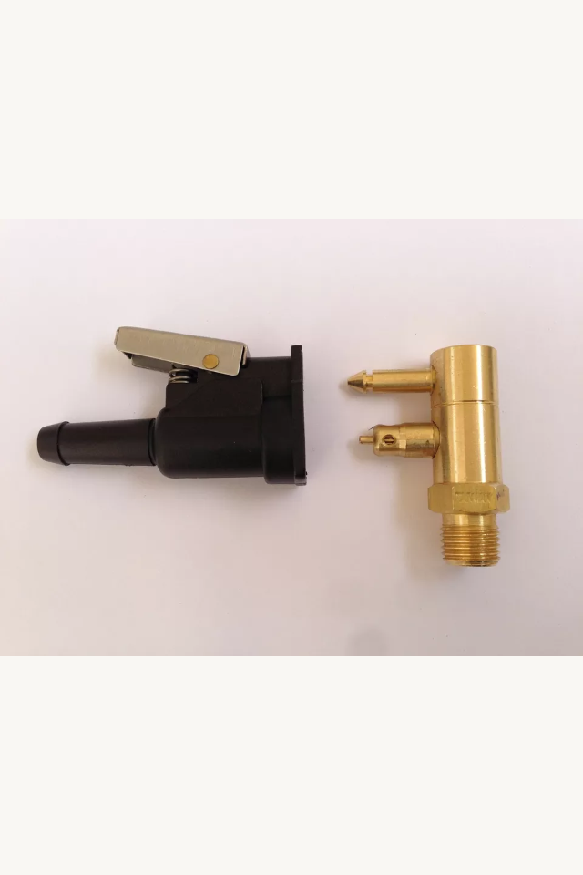

On ebay £10.99
https://rover.ebay.com/rover/0/0/0?mpre ... 1084420215
But not fitted in the breather hole because you need that. And posibly need some sort of gauge unless you just pump till it squirts out the breather. Good thing is they dont leak when disconected.
Thats the plan im going for anyway

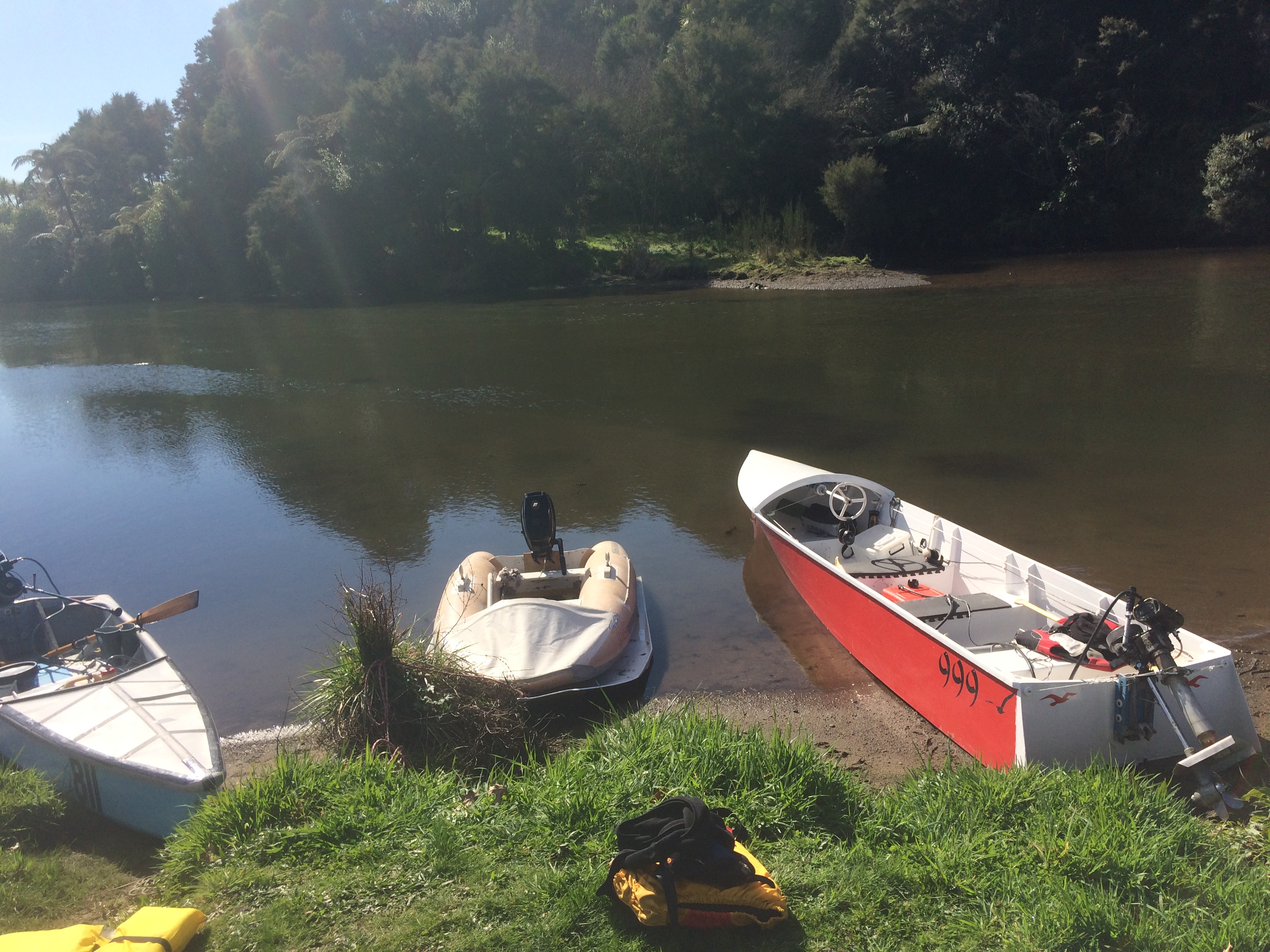

The Idea works like a charm!
Ive got the same setup and use it every time I go out (if you look close you can see it on my 20 footer.
