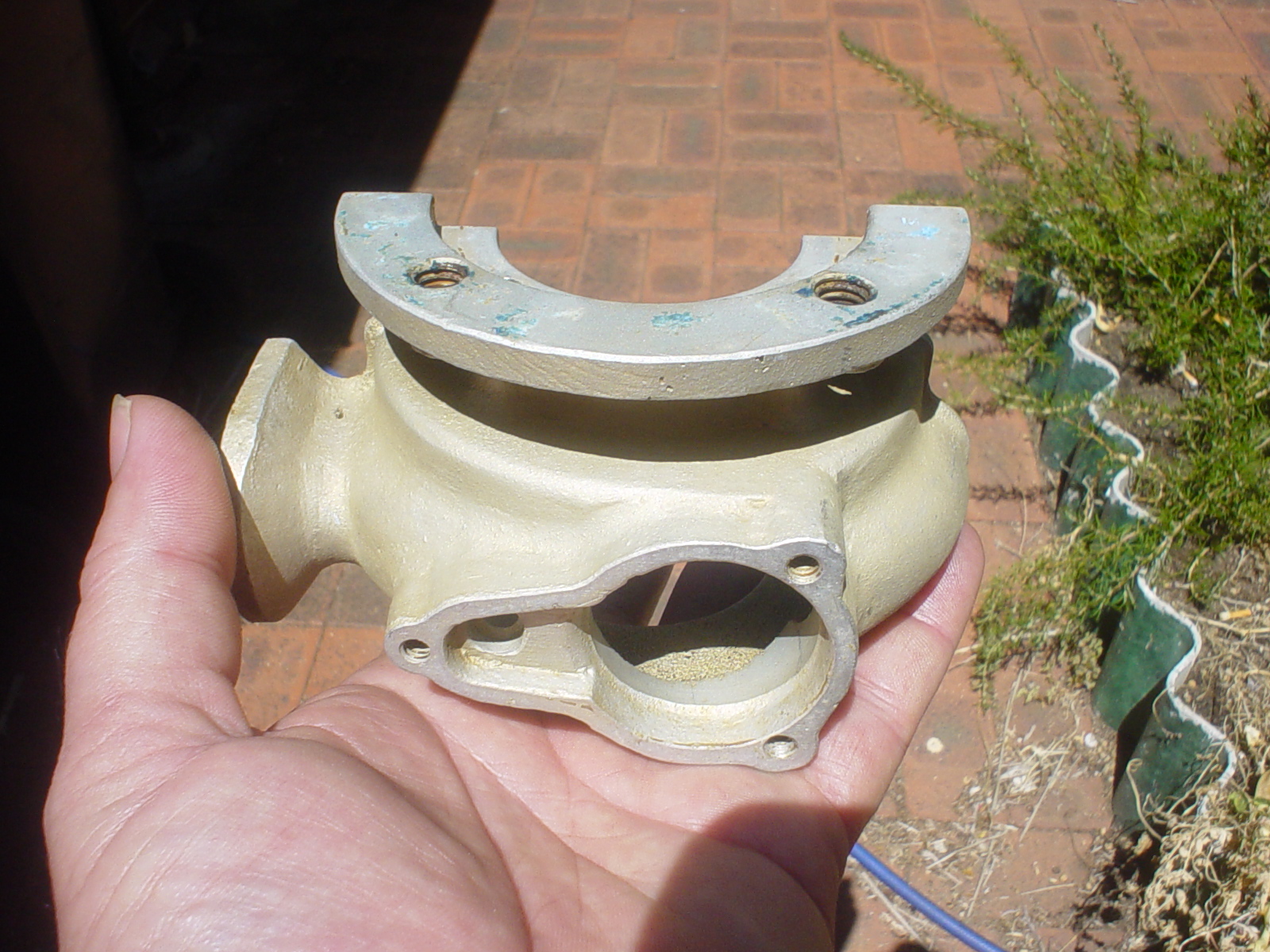

Not reed "Valves" just one is all that is required.
I had this idea a while ago in one of my posts regarding a silver century power head toy..........
An idea from a C-Powa.
You will see in both of these pics how the read block looks and where it fits.
On BS the only place to cut something like this in is top case/under ignition plate/to the side. In other words the reed is horizontal with 90deg to carb.
Obviously one does not need a full standard ignition base.......just the bit on which that points live. Throw the rest away as you will end up using a small remote battery and a modern coil.........really. Chop up a Wipac plate!
The carb size should be kept the same bore as BS.
I have lost my measurement notes/jottings but you might get the idea.
ONE round petal. Because of the size constraints round will seal better than any other shape.
A trendy wedge shape block will defeat the ability of the crankcase suck and blow.
The idea is to NOT INCREASE the crankcase volume.........keep it small and simple. Hmmmm, do some googling for chainsaw or small engine reed asys. I did that but nothing really jumped out at the time.
I will try and find my paper pattern for chopping a top case hole...............
I may revisit as I now have a modeller mate with some outstanding 3D printing hardware.
Comments as to cranks, rods and main bearings should be taken as gospel.
You will adjust your vision slightly to further your goals in a timely fashion.
BnC[/color][/b]

Hmm. nearly the same idea i was thinking, but not quite what i had in mind. Interesting though
I was thinking of fabricating a small "thing" (that's what i'm calling it for now) that's actually fixed into the inlet tract of the 102, similar to your pics with just 1 petal for simplicity's sake. The trouble with my proposed version is that all of the work is going to be done from inside the cylinder as opposed to anything exterior. The cylinders i can lay my hands on at the moment all seem to have varying amounts of space to achieve this proposed idea. The inlet port/stub for these cylinders starts off being round at the carb side, but towards the end of the port (close to the cylinder bore) it transitions into an oblong or oval shape depending on specific cylinder variations and designs, and to me this could make an ideal position for a rudimentary "reed valve" of sorts. The actual physical size of the reed will be quite small however so i'm not too sure how this will affect air/fuel flow or volume that can be drawn into the crankcase before the reed closes.Provided the back side of this proposed reed doesn't encroach into the path of the piston skirt we might have something to work with. It's also possible that for this reed to work there might be some grinding with a dremel tool involved to reach the desired shape so that this reed valve could fit with adequate clearance, but at the same time keeping an eye on port timing as well. Looking at a very knackered block i have that's in bits (literally) i can see there's enough material around the base of the carb inlet to hopefully allow a good enough fixing to hold everything in place.Fixing it securely so it doesn't move will be another big problem as there's not much space to work and any drilling for a screw or small bolt to hold the reed in place will have to be done with a small right angled drill or similar. Provided there's a good flat surface for the reed cage to be fixed onto, any sealing issues could be attended to afterwards. Quite tricky but doable i think. Everything on the exterior of the cylinder being as BS intended, so no issues with fitting carbs etc. (stealthy)
The other idea i have, and keeping the same diameter carb/inlet size etc. is to have a length of pipe approx 1.5 inches long, thick enough in the wall thickness to allow a rebate to be machined to fit onto the stock inlet and accept the carb at the other end. Inside the pipe would be a fabricated reed block (not necessarily as a wedge as in more common types) but similar again to your pics. The trouble here is that the length of the inlet path or tract will have been lengthened a bit which might upset the total volume inside the crankcase before the reed is closed. Stuff the cases a bit to compensate perhaps?
Difficult to show you unless a paper drawing would help explain it better.
