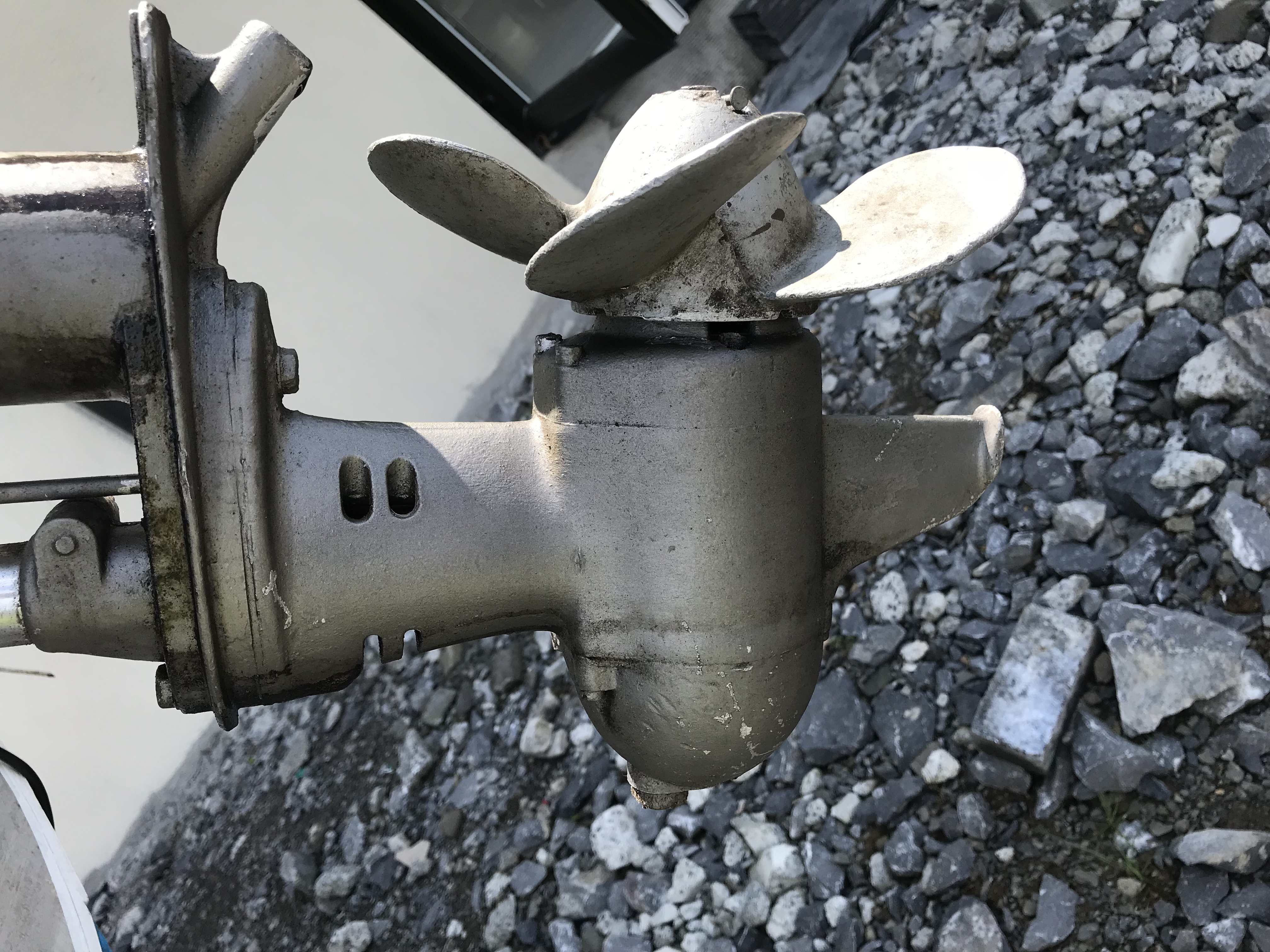

Well a house move, a broken leg and a year later I unwrapped it, checked it over and started it. All good. The cap on the tank says 10:1, so I dont think that is original. The prop is a 4 leaf clover type and the gearbox has three screws holding the cover on.

Lastly, is this the right prop?

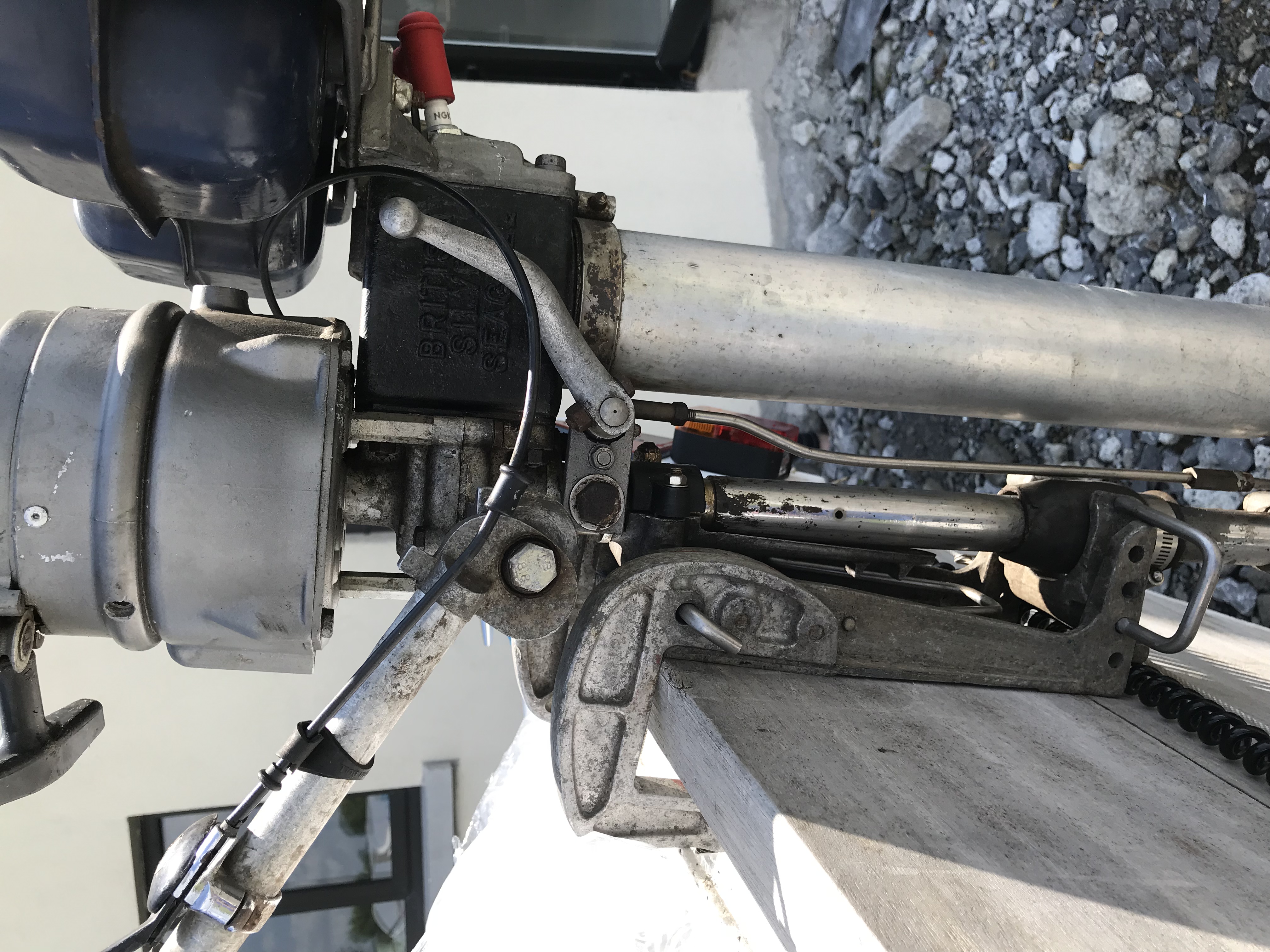

Re: Modifications - a good idea or not?

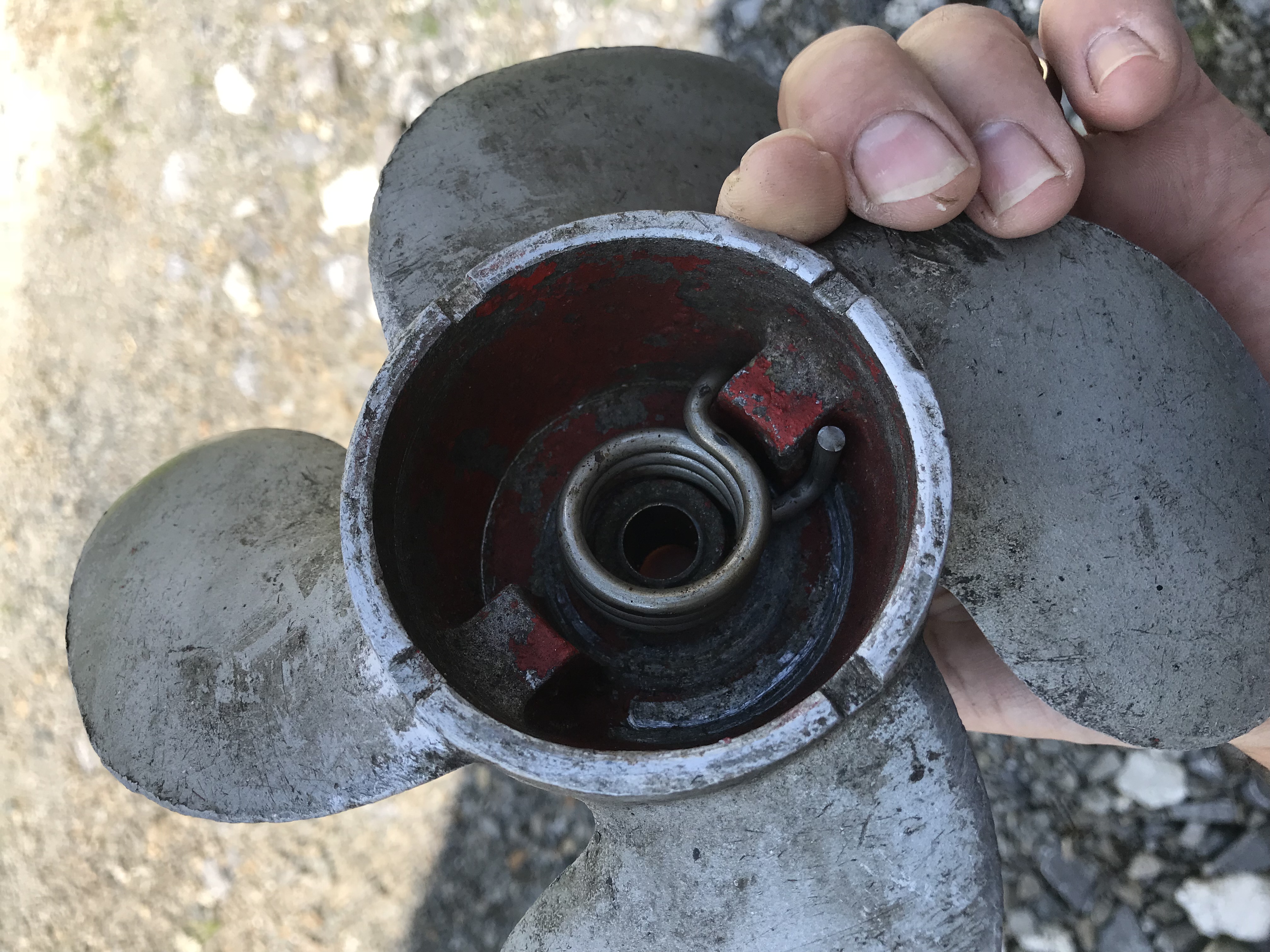

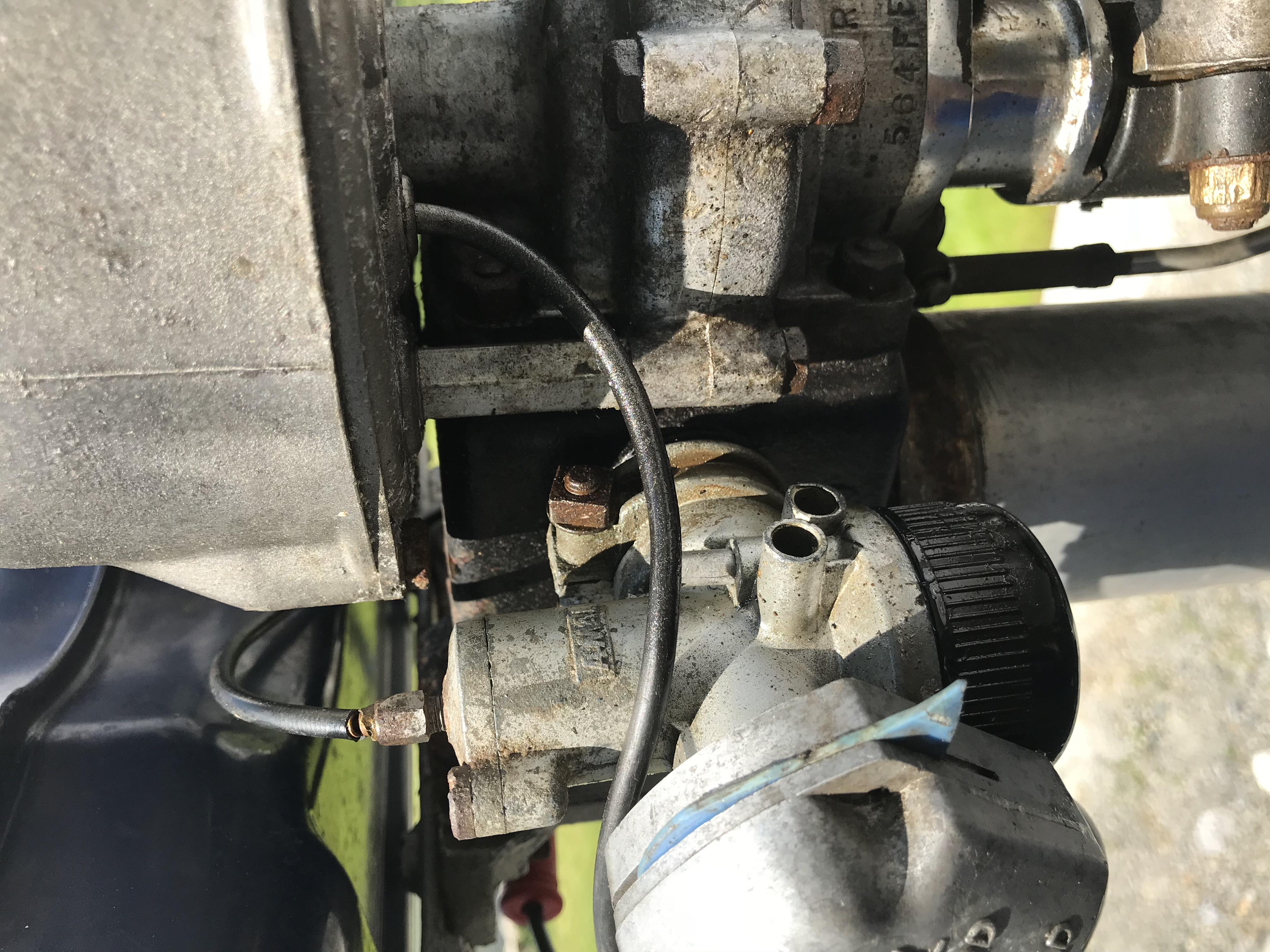

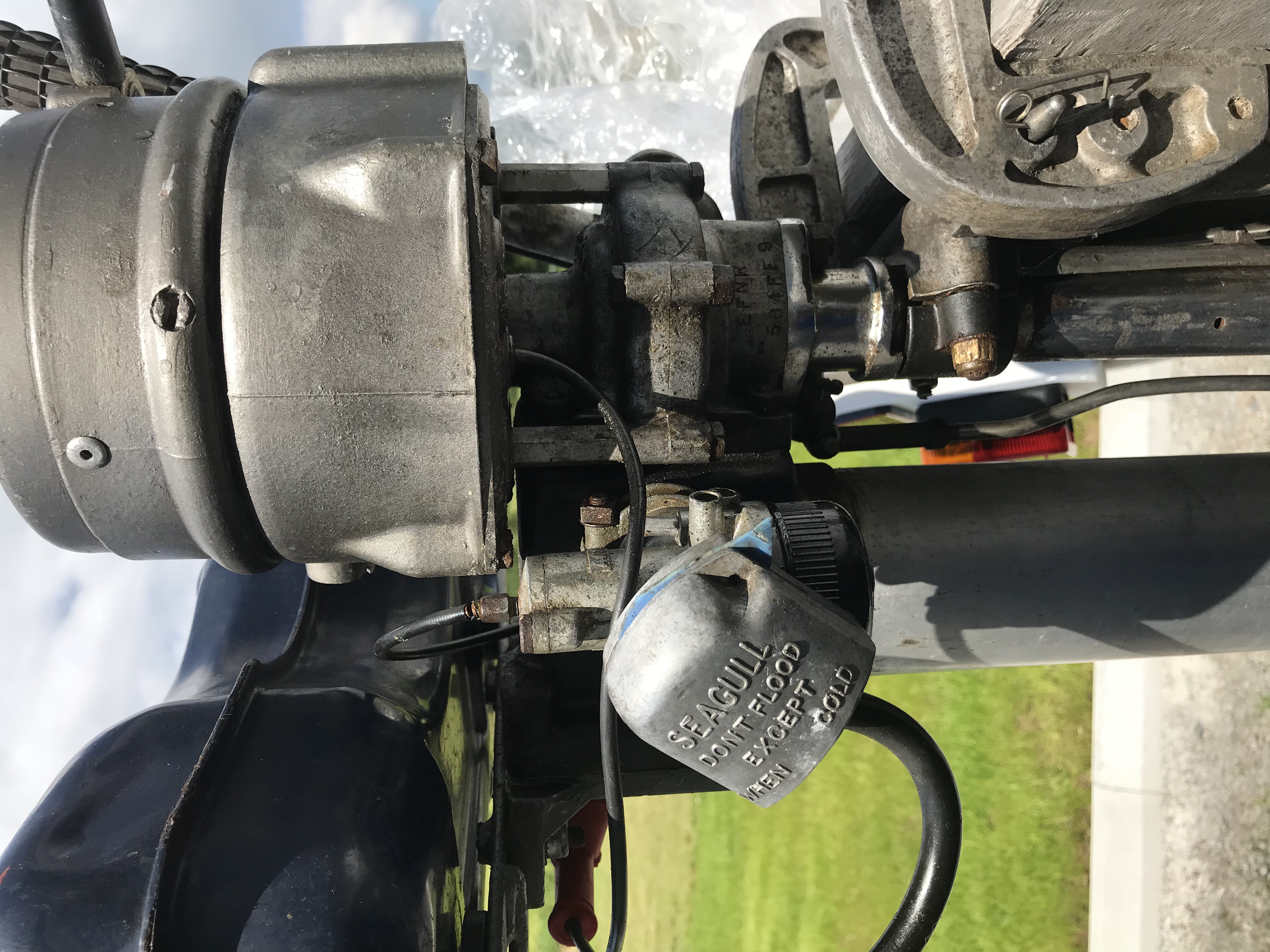

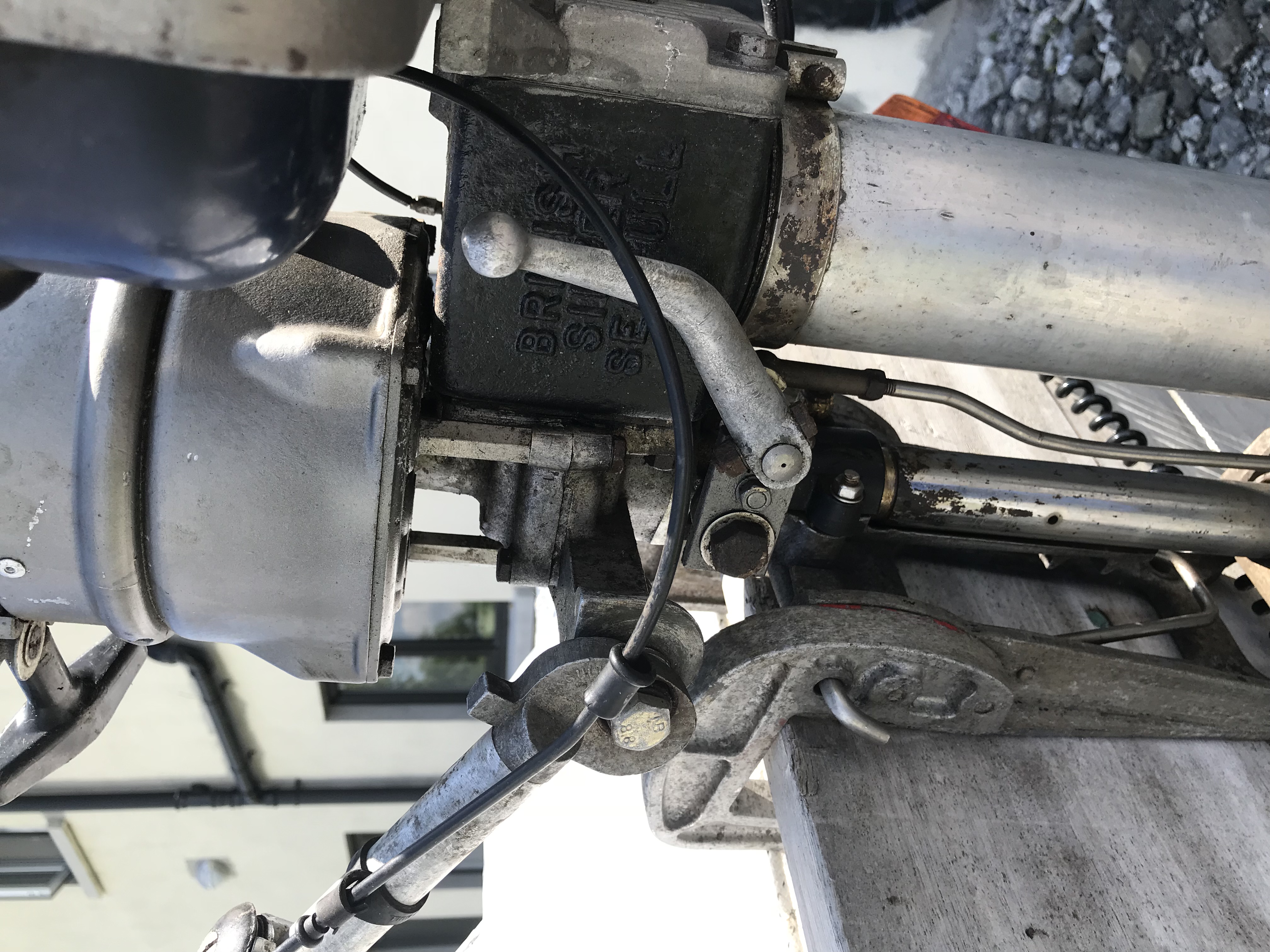

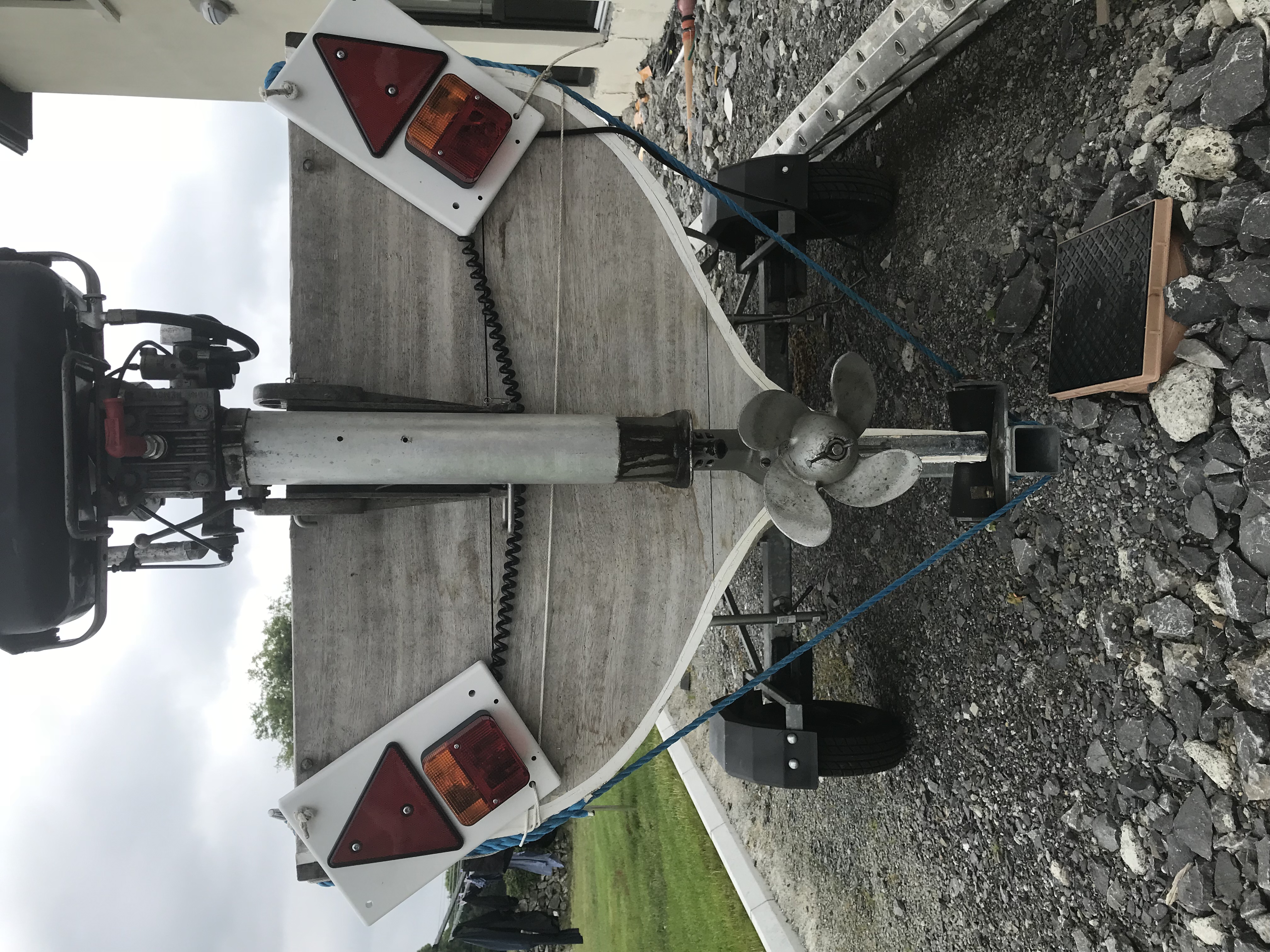

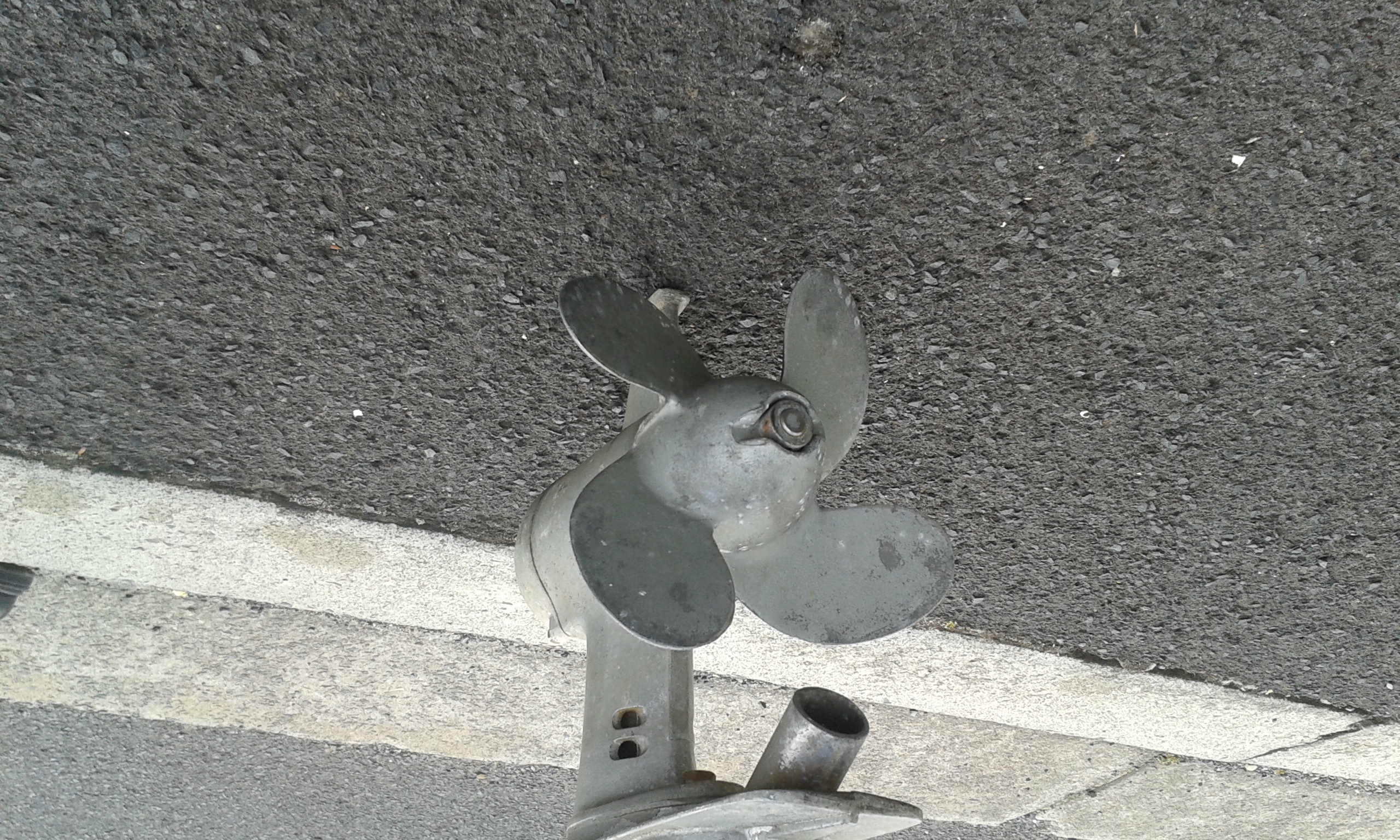

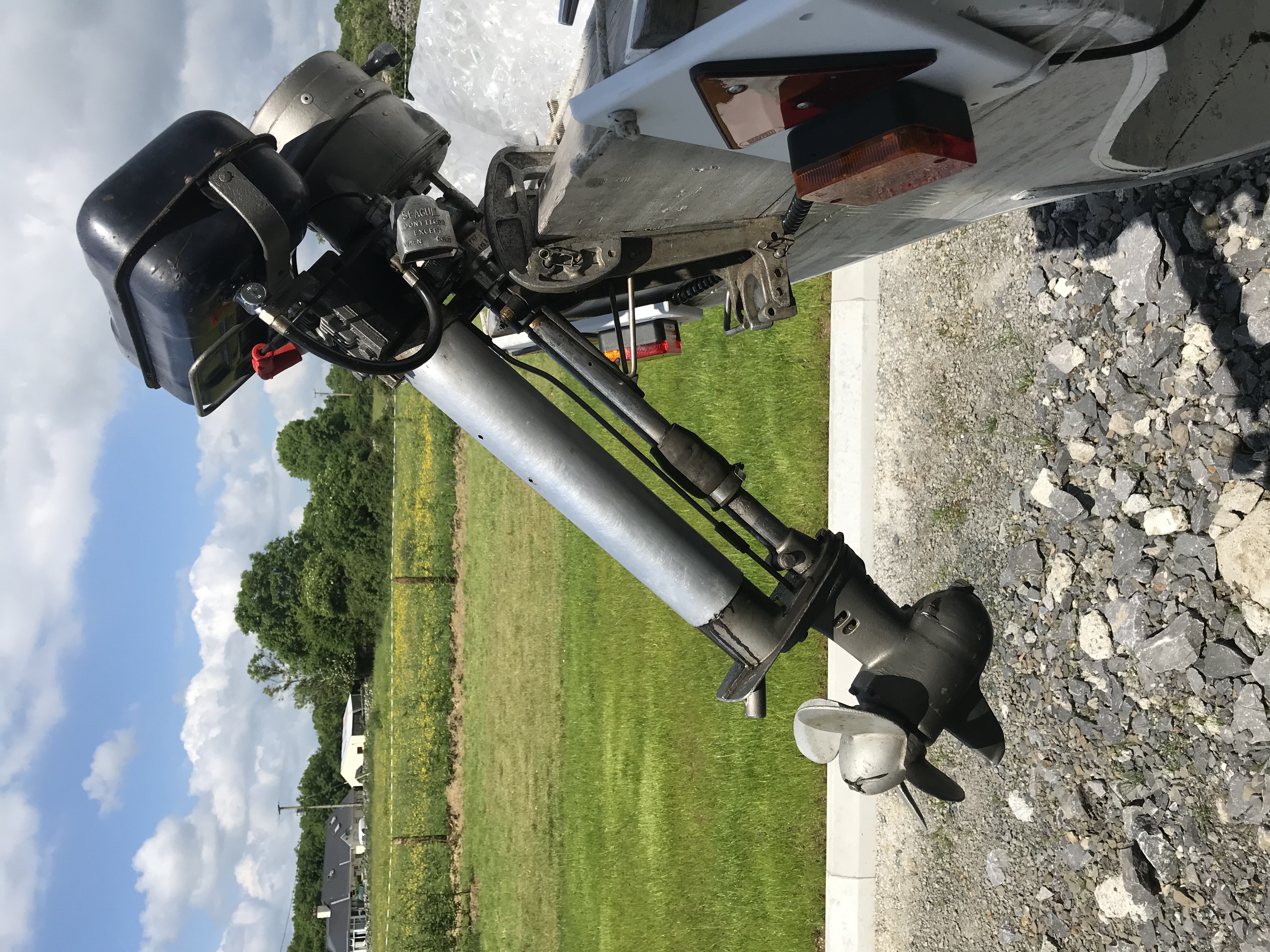

Does the prop have an internal or external spring?
A picture of the prop & a couple of pictures of both sides of the whole motor would enable us to give accurate answers.

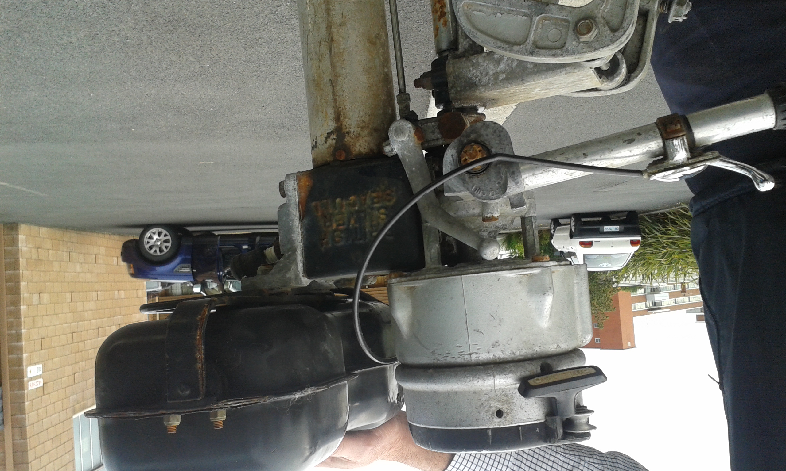

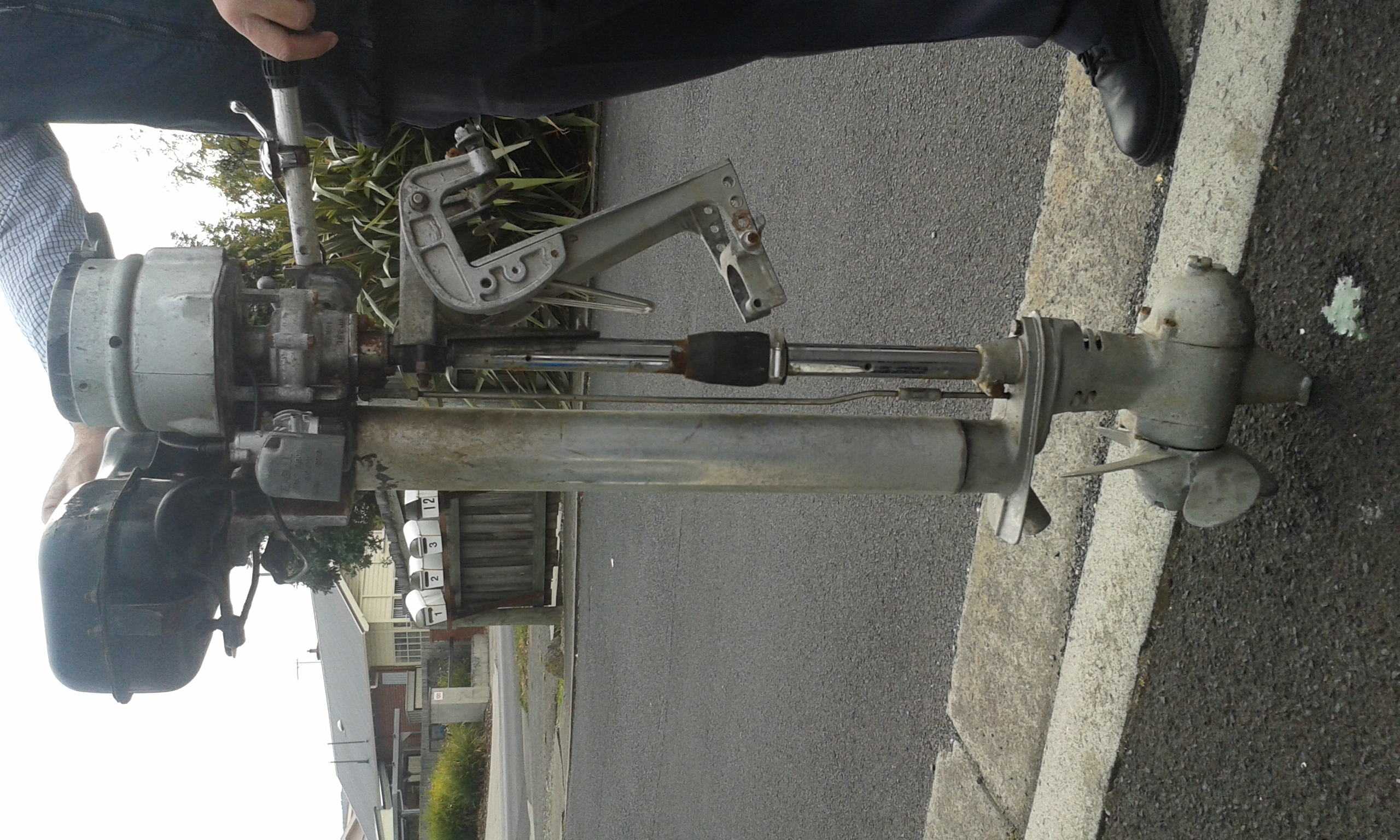

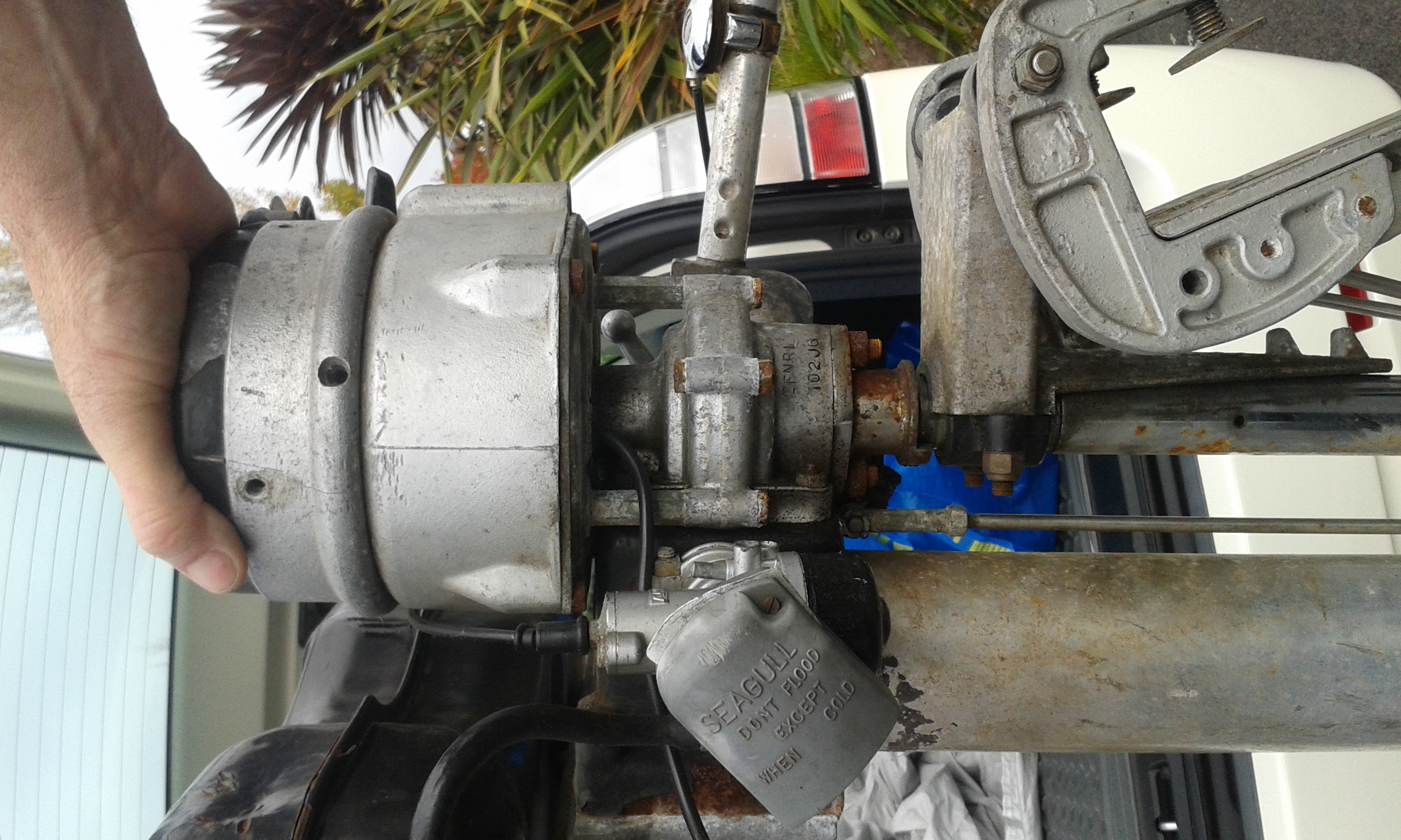

This is what the longshaft version looks like
This is a Tasmanian engine thats why the pictures are upside down, its
"Downunder" its i a lot better condition now.
This was the engine Adrian found for me.

The prop spring is inside the prop.
What I am after is thrust. Is there a better prop or is this the thrustiest?

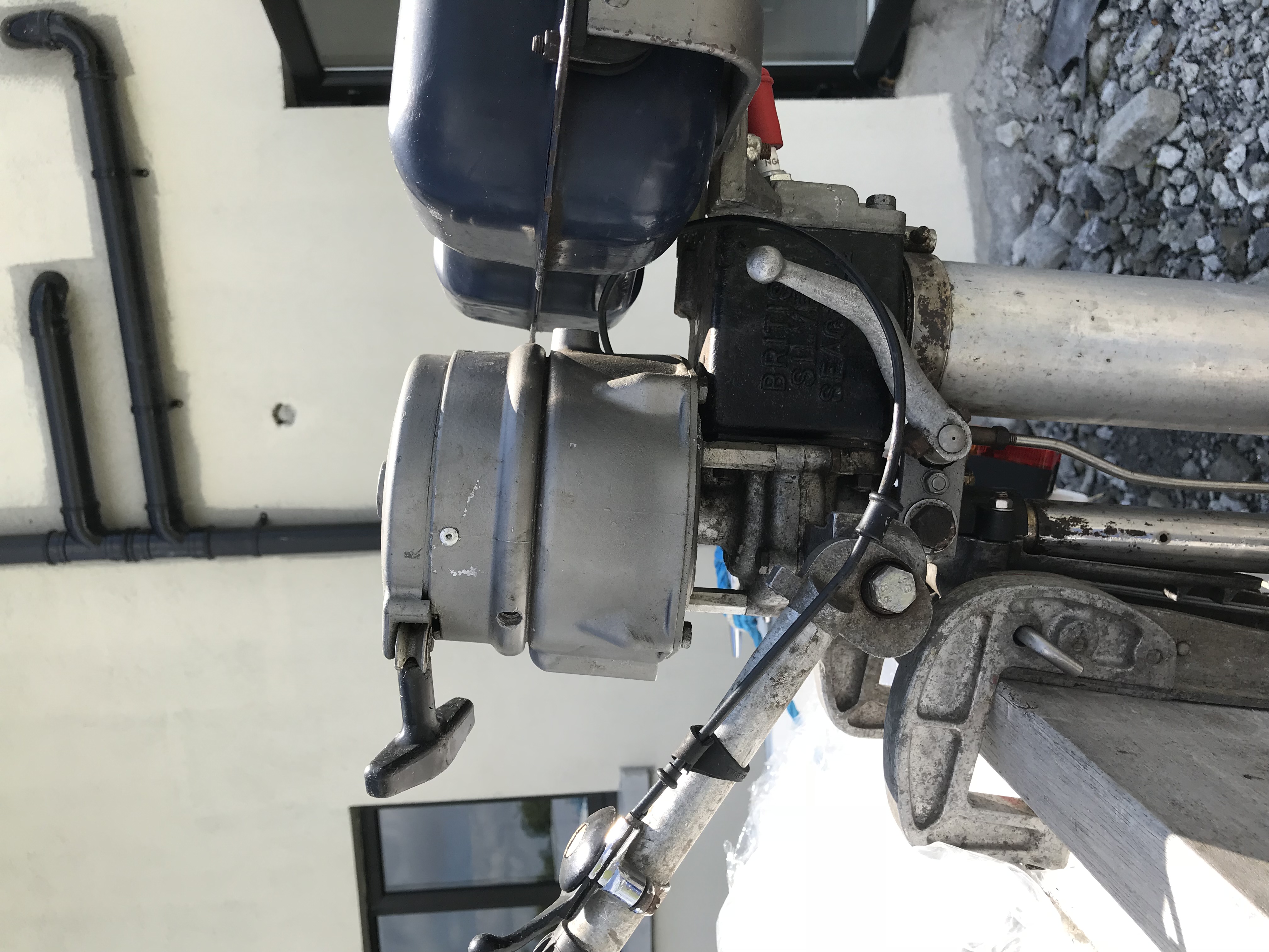

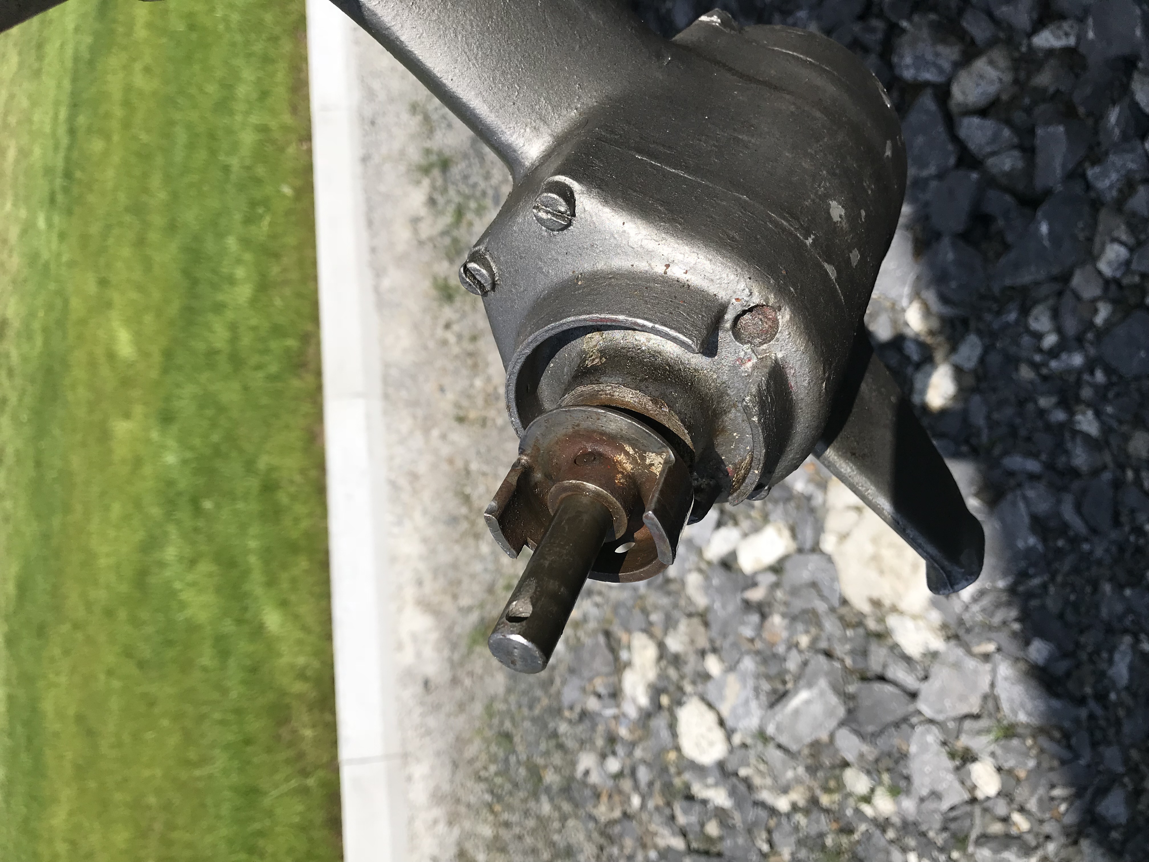

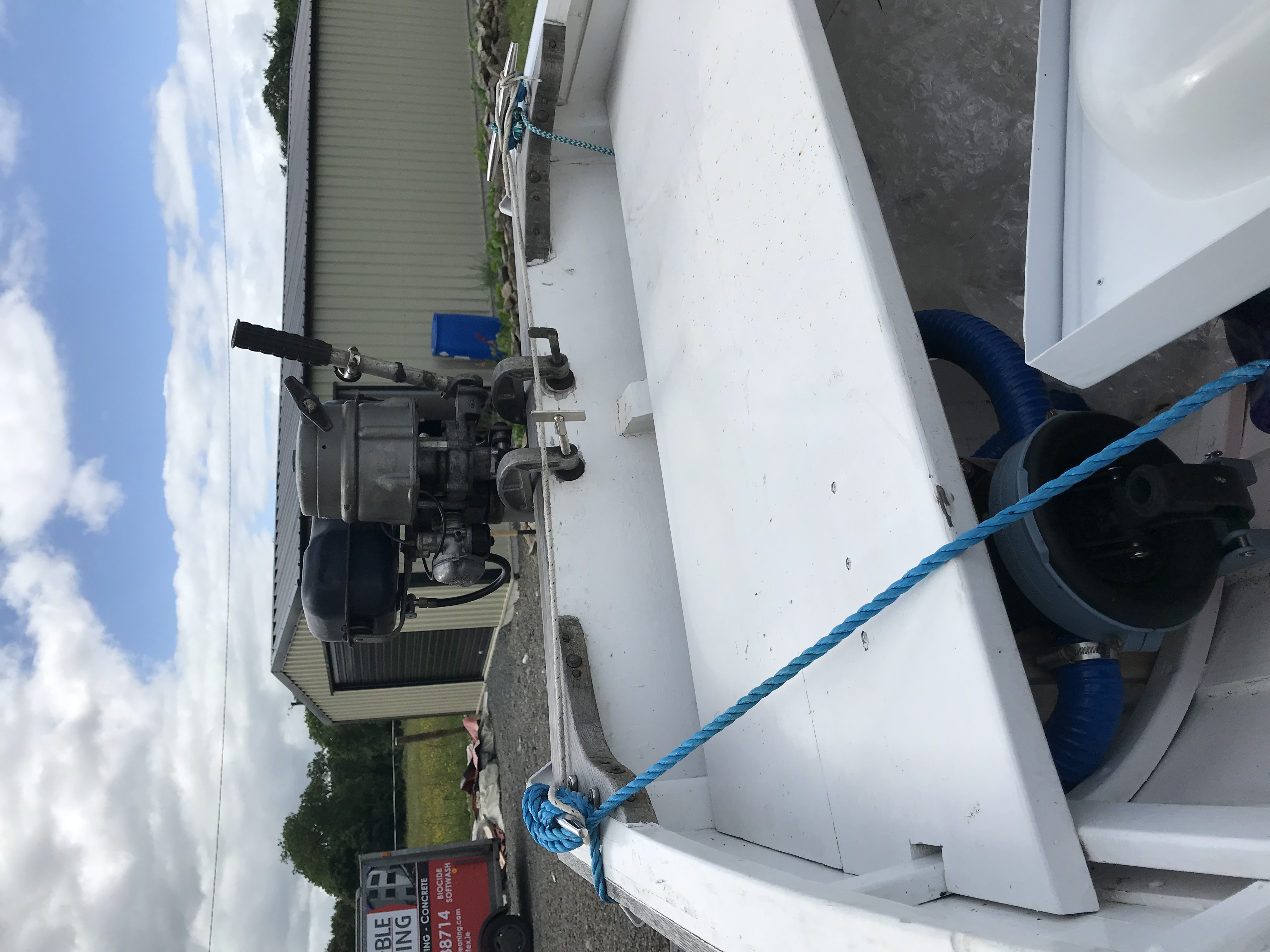

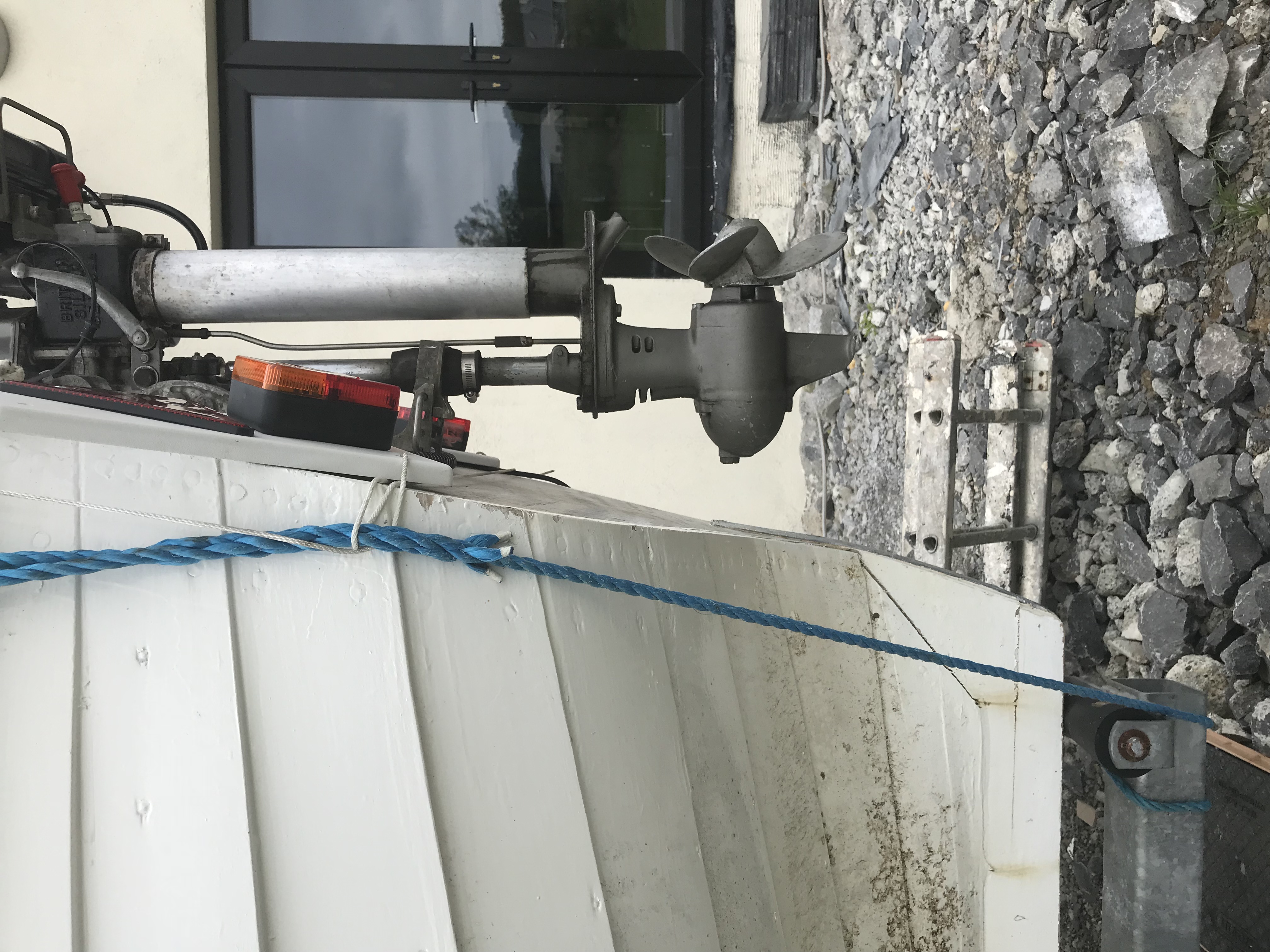

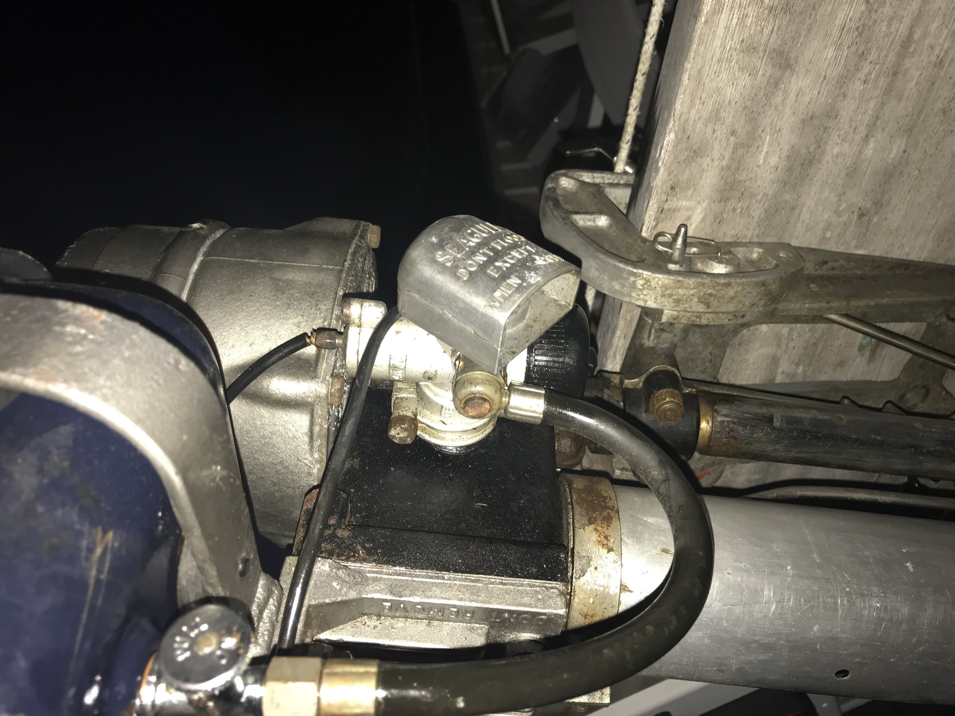

Some more pics

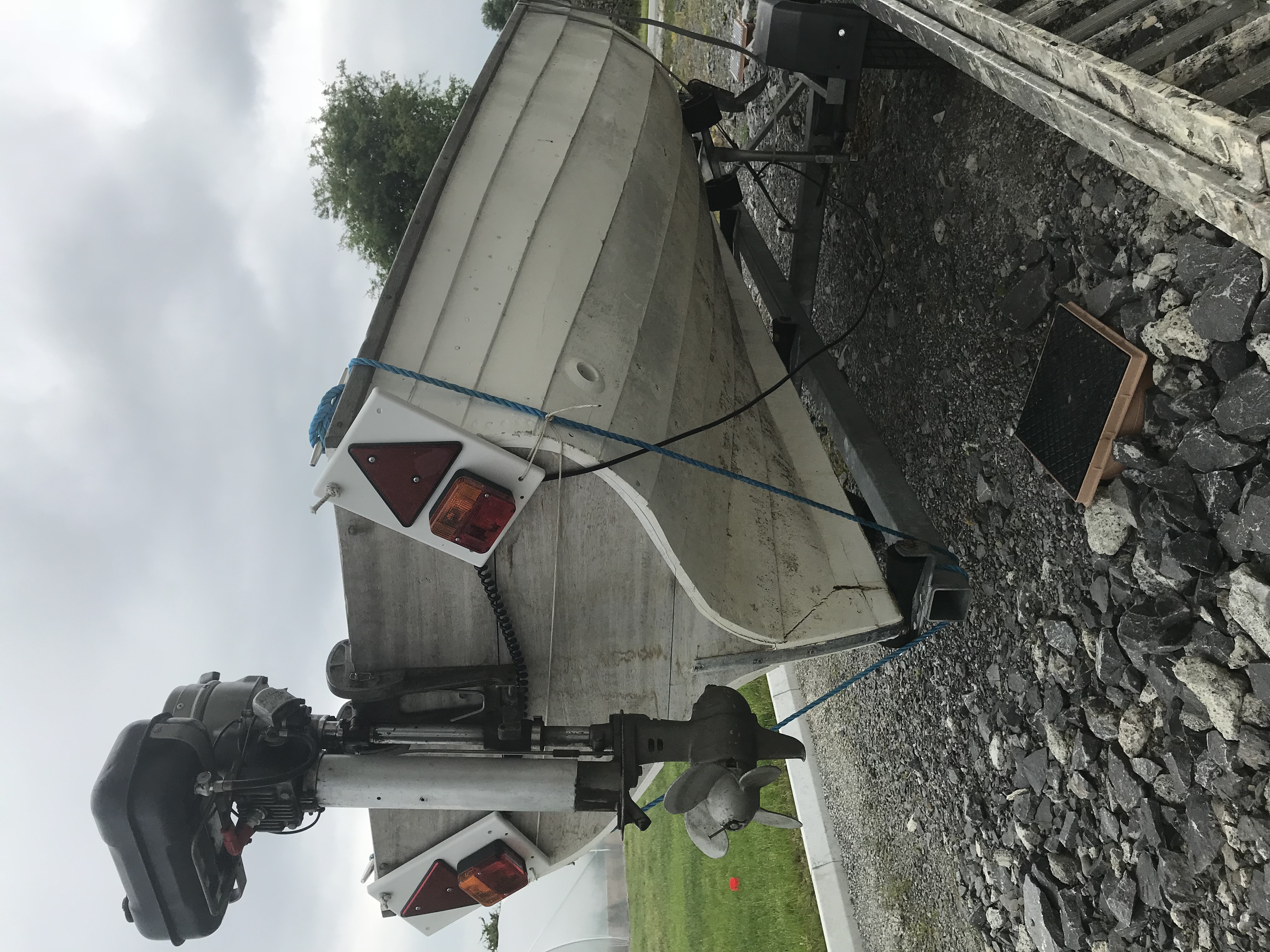

Take another pic showing us the motor in the down position on the back of the boat and indicate where the water line on the boat is.
Is it a case of not having enough thrust or is it more speed that you are really after?
Is the boat being used in salt or fresh water? If it is salt what is the tidal flow like?

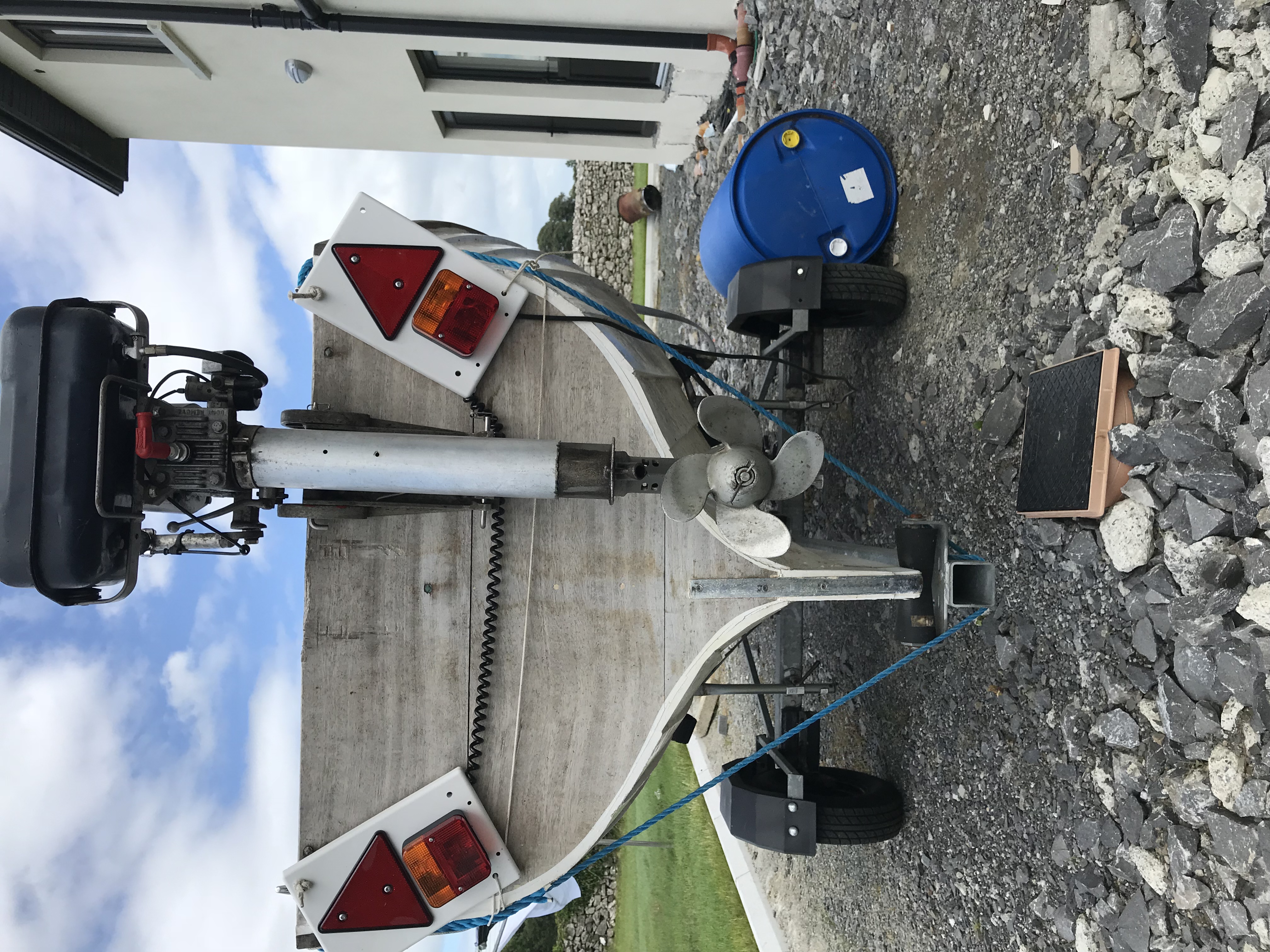

I will post a pic of it in the down position tomorrow, and you will see why I need it lowered.

Post by daydreamingdave »
As you can see the motor is a bit high. The idea is to place the prop behind the lower part of the Y transom so it pulls clear water.
If I extend it by 9” it will do the trick. That way the Skeg on the gearbox is just above the keel line.
I may need to do something to reduce back pressure.
I am planning to inject the water into the exhaust pipe but I may also drill a hole just below the new waterline.

Hi if you were in Australia i would offer to swap you a long shaft motor for yours, and you'd be sweet. try mounting the motor off center, and see how you go, that will give you clear water flow under the hull, for the motor, fishermen have been doing it for years.

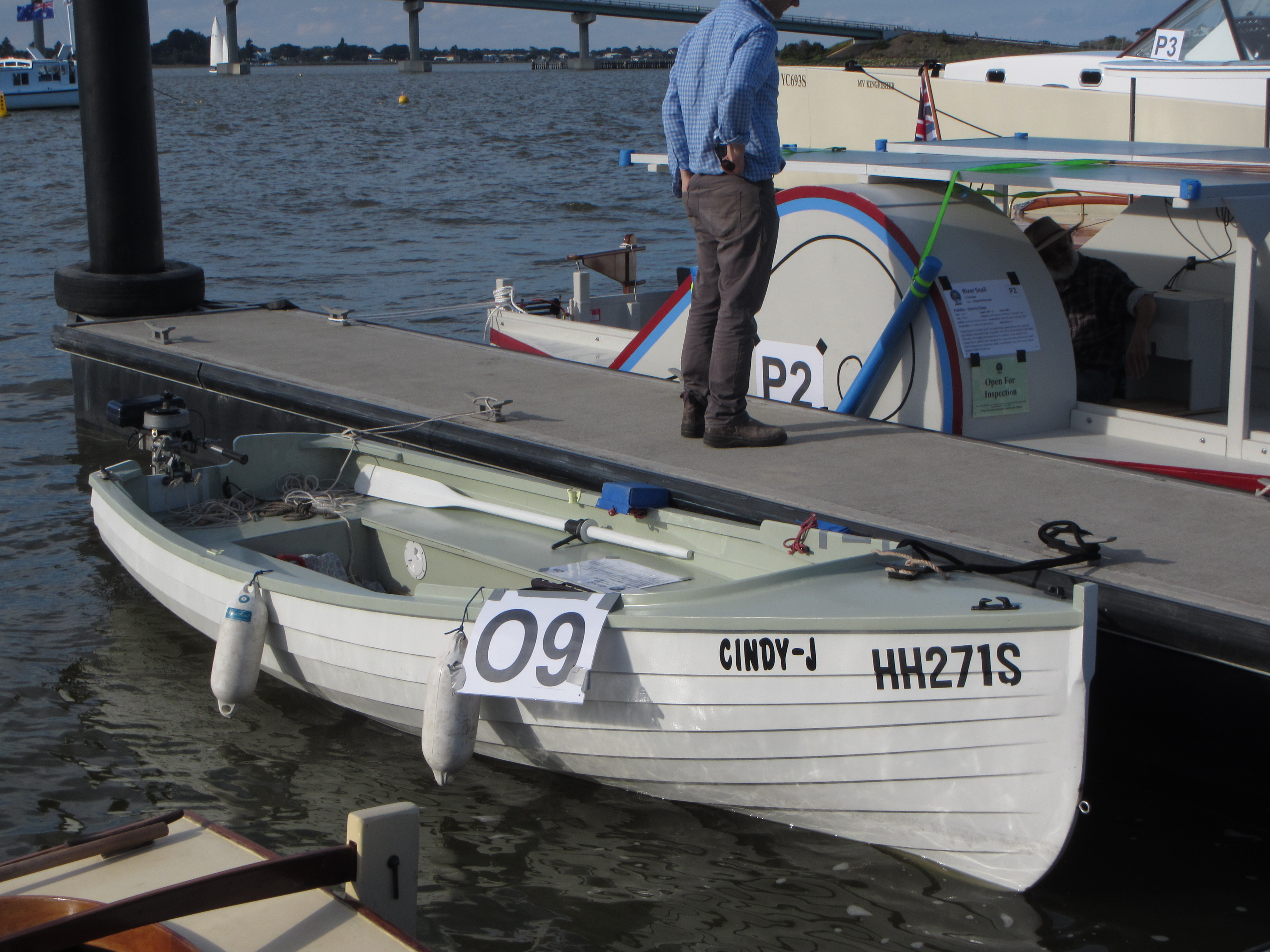

Here is what I did to my dinghy, I offset the motor and cut down the transom works a treat. I am able to run either short or long shaft motors.
